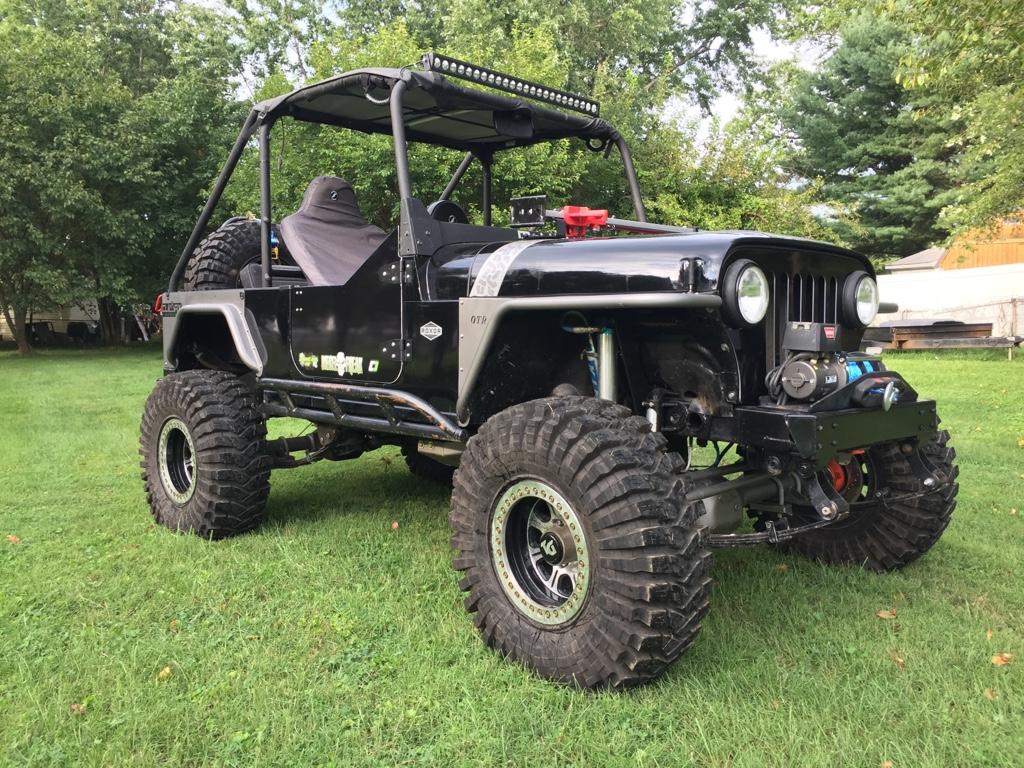

Welp that’s a wrap.... get it...
This was the last part of what I needed to get done before Moab the grill and doors were warped in gloss black for now until I get the full race wrap printed and stuck before hammers.

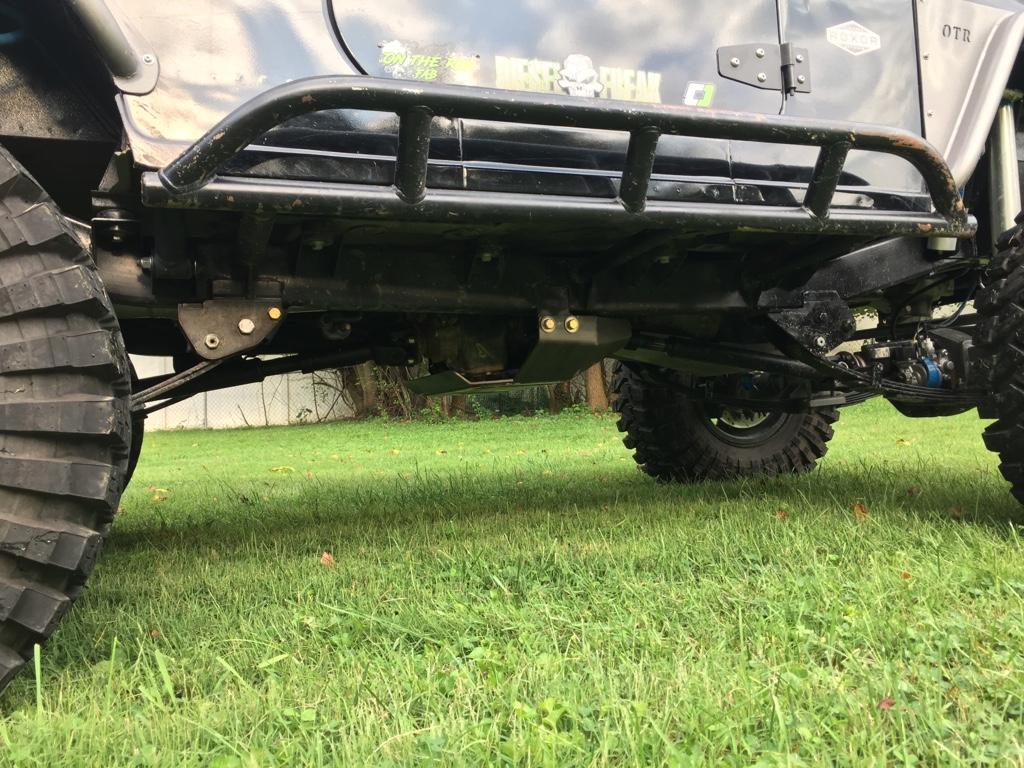

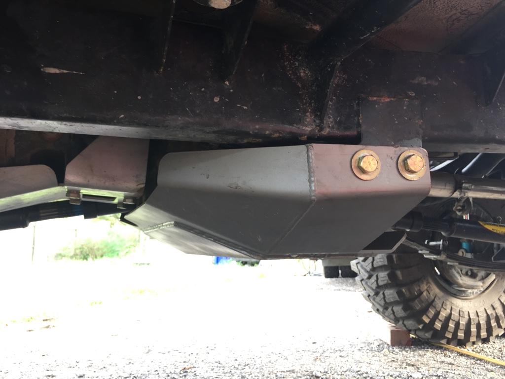

I do what to talk a little about this skid plate... the roxor crossmember is WEAK! Mine was so bent the skid plate would not go on with out some serious persuasion.
Once I got it bent back into shape (including using the winch to pull it 1.5 inches back forward) I got the skid plate mounted up. I decided that it would be an awesome addition to put (4) 1/2 bolts into the drop hanger.
This made a huge difference. There is absolutely no flex in the crossmember now. I pit my 3 ton jack under the belly and got all 4 wheels off the ground balanced on the skid plate with no movement of the crossmember. I highly suggest doing this.
