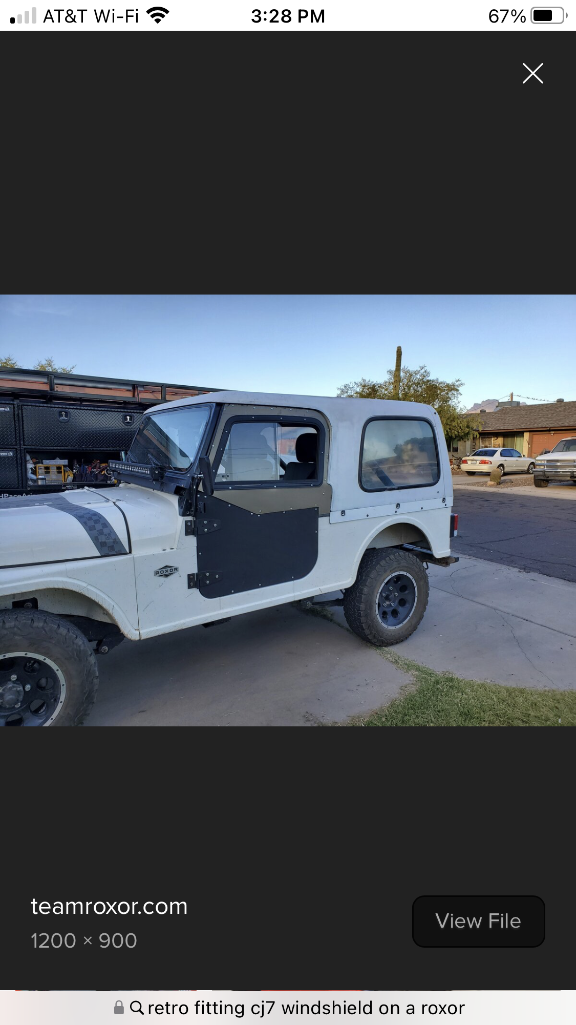

Could a cj or other Jeep full cab be used (or modified for use) with the appropriate Jeep windshield?
I remember seeing a guy on here, put a CJ or YJ hard top on a Roxor. he said you had to stretch the top a little, whatever that meant.
876
They are way off. The Roxor tub is MUCH closer to LJ length. It would take extensive modification to use a CJ7 or YJ top, not to mention removing the ROPS entirely or modifying it significantly..
I can only repeat what I heard.... I do not know one way or another friend, What I do know, there's NO WAY I'm spending 5-6K on a top...... May try to build one like they guy from Stanhhope, IA has at some point. But to be honest, I stay on the road way to much..... When I am at home, I'd rather load my two boys up and spend the time I have riding around in my YEEP with them.

No worries, I just wanted to pass on the info. I measured up the Roxor early for this stuff, and don't want anybody thinking they can easily go get a cheapy CJ7 or YJ top and modify it. It might be able to be done, but if you have that kinda skill, might as well make one fresh and not waste the $.
The width is dead on. The length and height are a really big amount of work to overcome. Also.. doors..

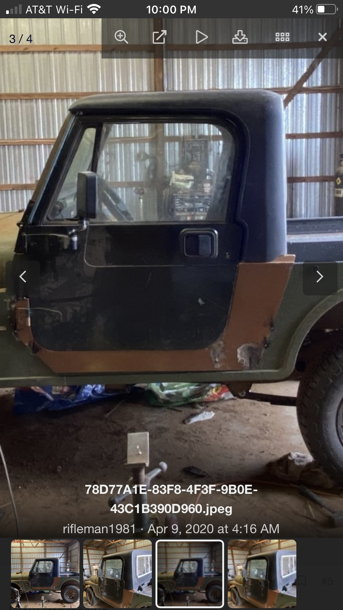

Has there been any updates to the possibility of a decent hard top available for the Roxor? Anyone fabricated one or modified a CJ or YJ top successfully that could share their experience? There has to be something better than the Hard Cabs option!
Saw a cj7 top and a cj8 scrambler half cab on the web. I’m currently working on a cj8 scrambler full size hard top. All the jeep hardtop conversions require some bodywork to install. But in my opinion they look better than the thin poor quality aftermarket stuff out there.

Your work looks great! And yes, sooooo much better than the after market options! Is all of the body work on the top itself? No bodywork on the Roxor? Also, are you using the same cj7 doors, or are those half doors with an upper and window fabricated? Would you consider doing on and selling it?
