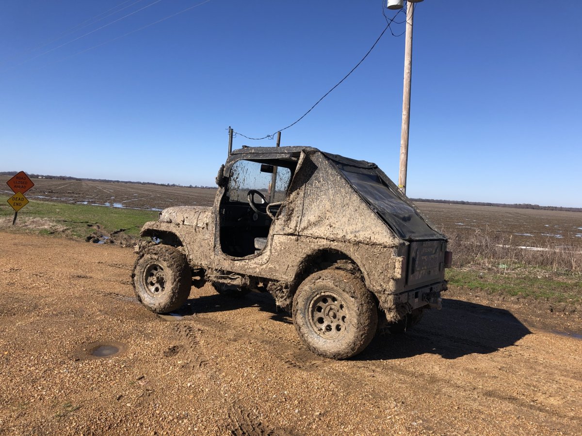

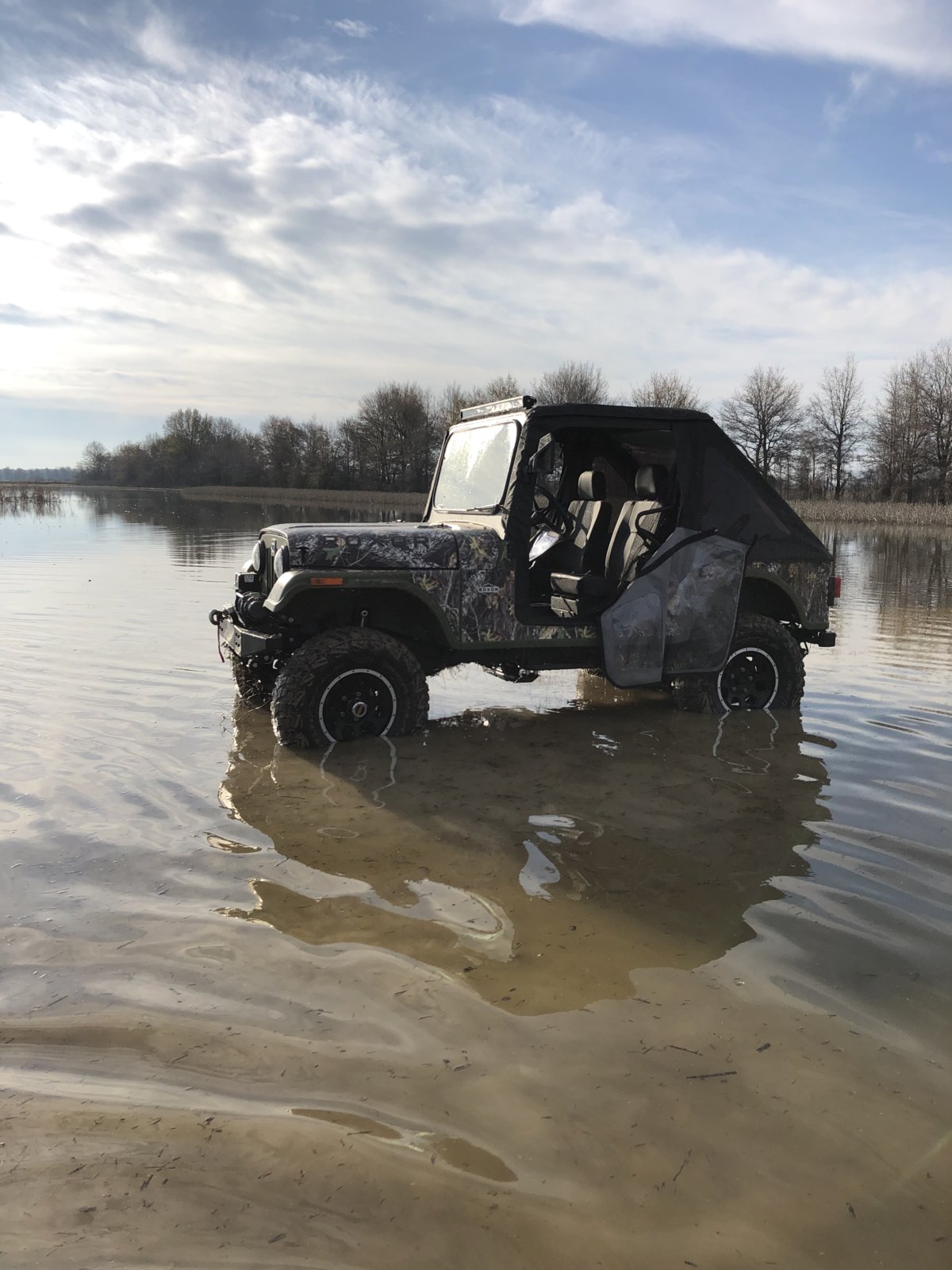

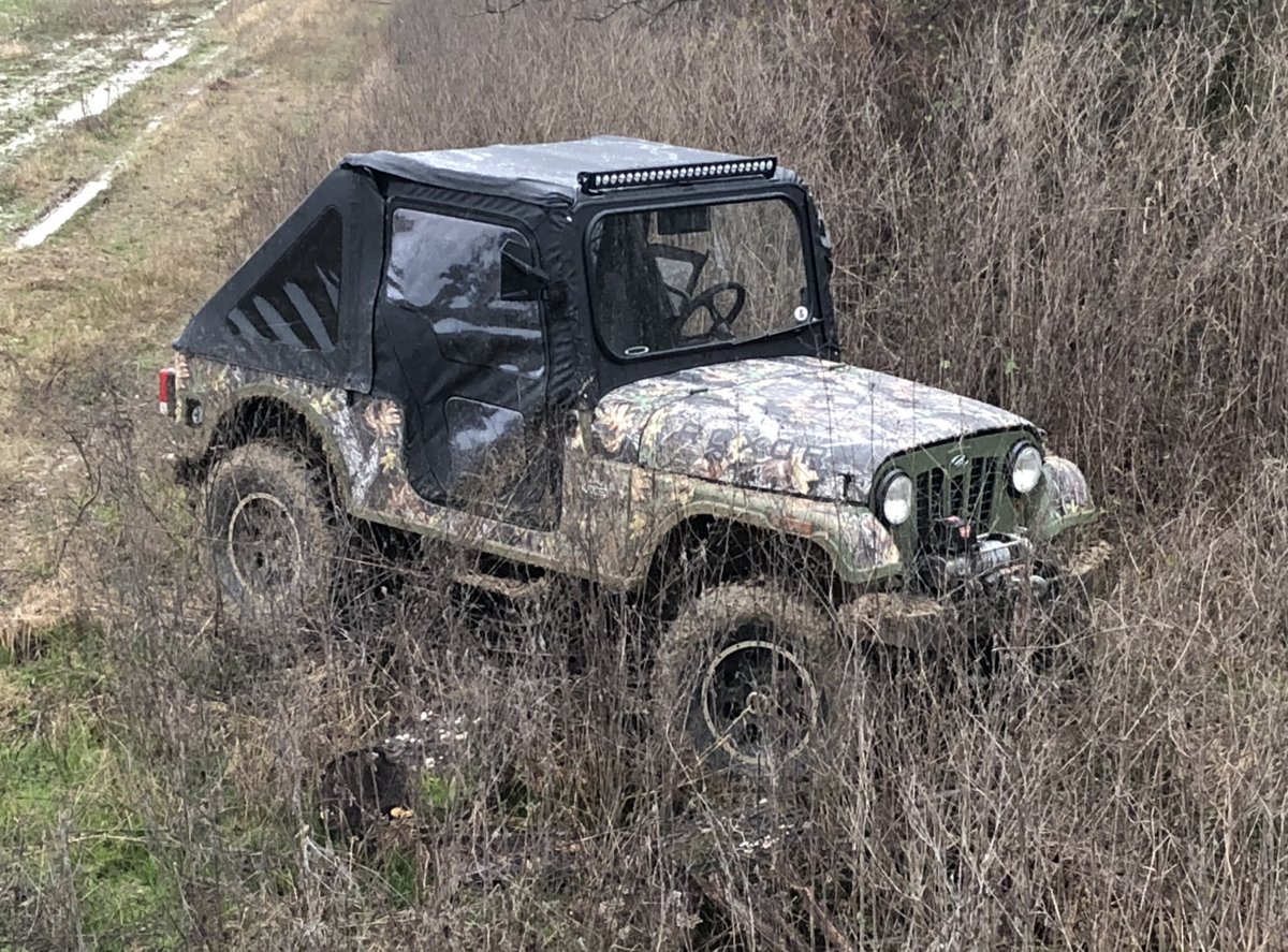

I need a squared hard top with hard doors like I need oxygen. I hunt in Ms and bought the machine to get thru the mud and stay halfway clean. The best top soft top does not work well in the mud due to the zip doors getting filled with Mud. I have heat and a windshield but the hardtop for the winter mud hunting is a perfect solution. Love my Roxor and she’s a bad dude in the slop.
13B6B0D3-186D-4D46-A417-259C57CB5FDB.jpeg 068903F5-BDC0-4DF5-B9BF-A8FCA292C205.jpeg C60BA44F-EC4E-4640-ADB6-116184772A31.jpeg
857
Dirty is it's natural state lol

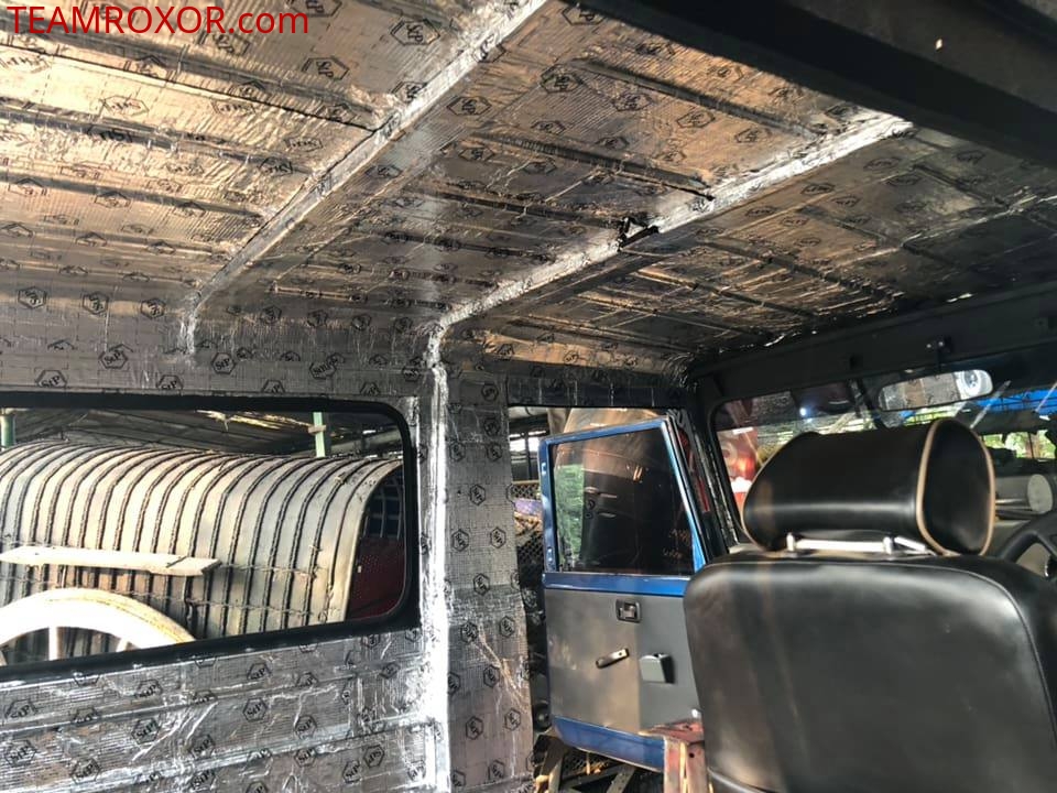

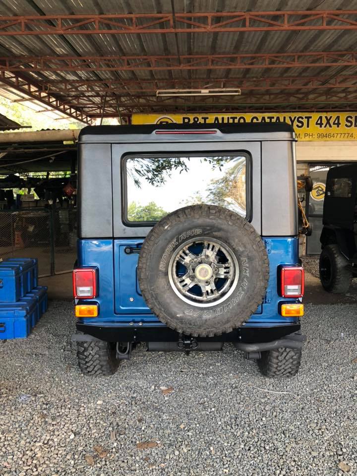

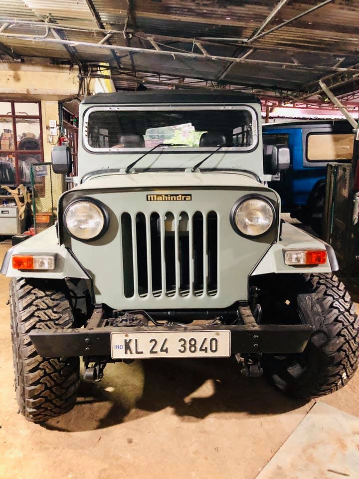

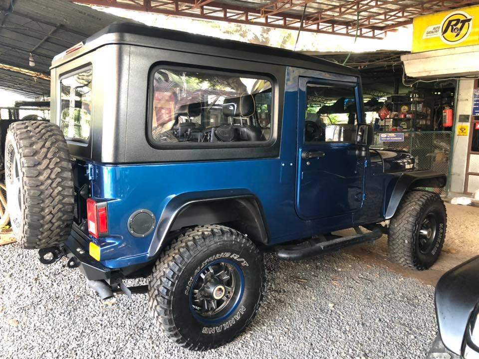

The best metal hard top I've ever seen for the Thar. I'm sure the US industry is more than equipped for this. This is by R&T Auto Catalyst, a Kerala, India based company. The only thing Roxor lacks is the bolt on B-pillar but it could be easily fabd. Check their page here for more. https://www.facebook.com/RTAutoCatalyst/

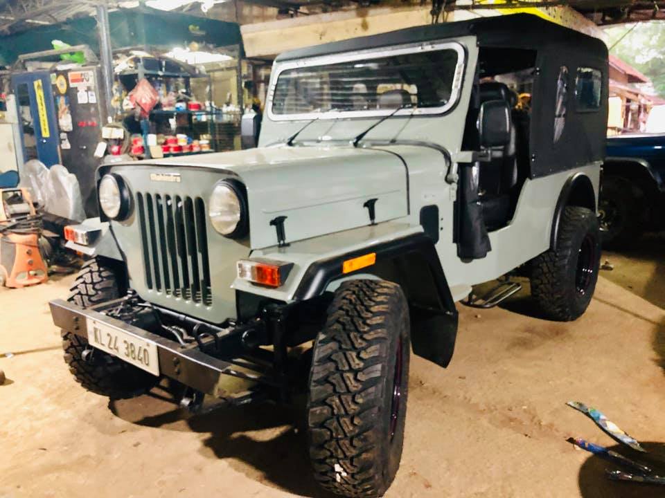

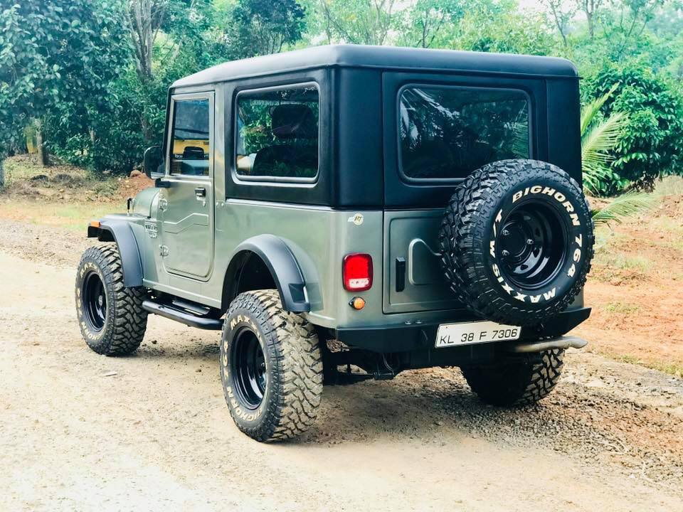

And some bonus for the flatty lovers;
857
Those are very nice, love the flatty, but our Roxors would require a Thar windshield (and ditching the ROPS) to run it I assume, no?
sandyx
Mar 22, 2018
247
You will get the idea once you have Thar doors in hand. Then the B-pillar and rest of the cab could be built around it. A 76+ CJ windshield could be matched with it. The hardtop you see above isn't bolt on so a full kit import wont be feasible. But everything be much easier if atleast the doors could be sourced. ROPS B-pillar could be trimmed down to just under the roof to keep it solid. It's all up to creativity.
1930modelA
Apr 11, 2018
35
Montana
I think that it would easiest to get the Thar windshield, doors, B pillar and cab and then adjust the ROPs as needed. That way the only think that is not a bolt on would be the ROPs modifications if needed.

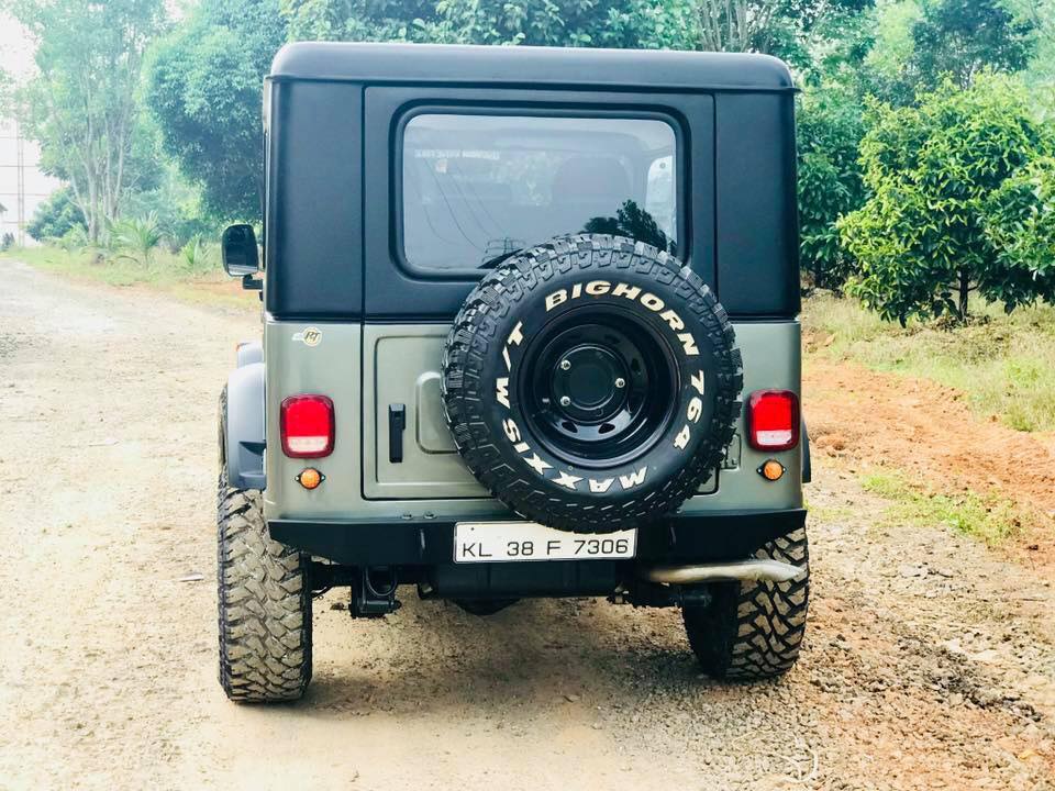

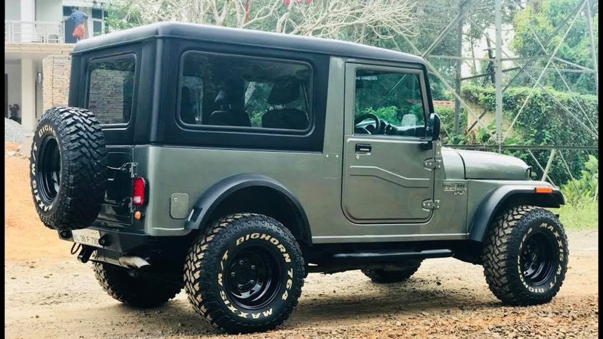

Manual slider is clearly visible in this pic. These are standard issue Thar doors. Motorised aftermarket kits are available as well.
No roll cage? Will the top support a roll over?
Roll cage is an extra fee option from the fab shop. Stock thar doesn't come with one. The B-pillar could hold a bit. Only those who would actually wheel it or value their life will pay the extra for a proper cage. Something like this below, the skin goes over it.

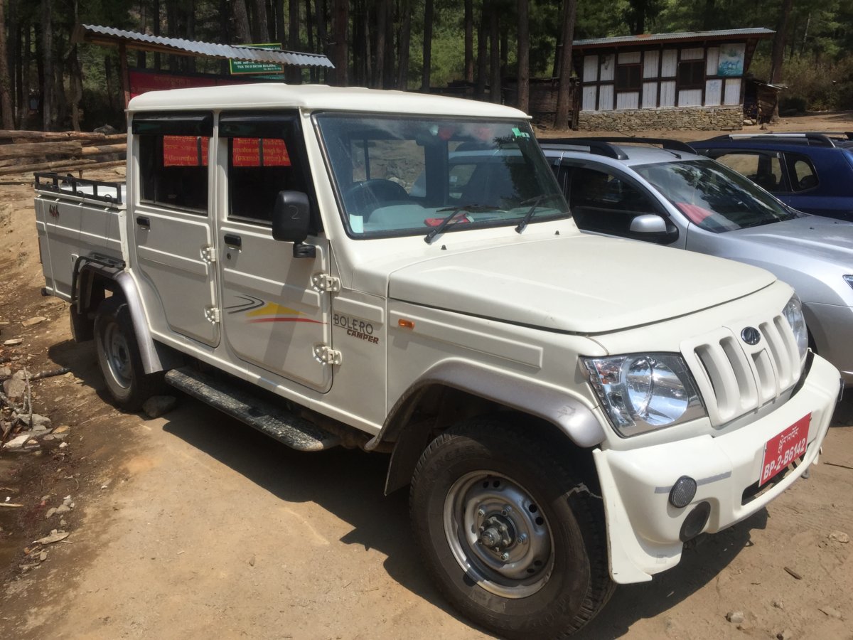

Someother thoughts I live in Utah, and I visit india often, not sure If i dont have to carry my wife's luggage this time, I will bring the junked MM540 or thar or bolero doors( as long as they are under 50lbs), should not be more than $ 100 and probably will do a giveaway.
I may be wrong but the bolero front doors also looks like direct fit. (I can be wrong on this one)
