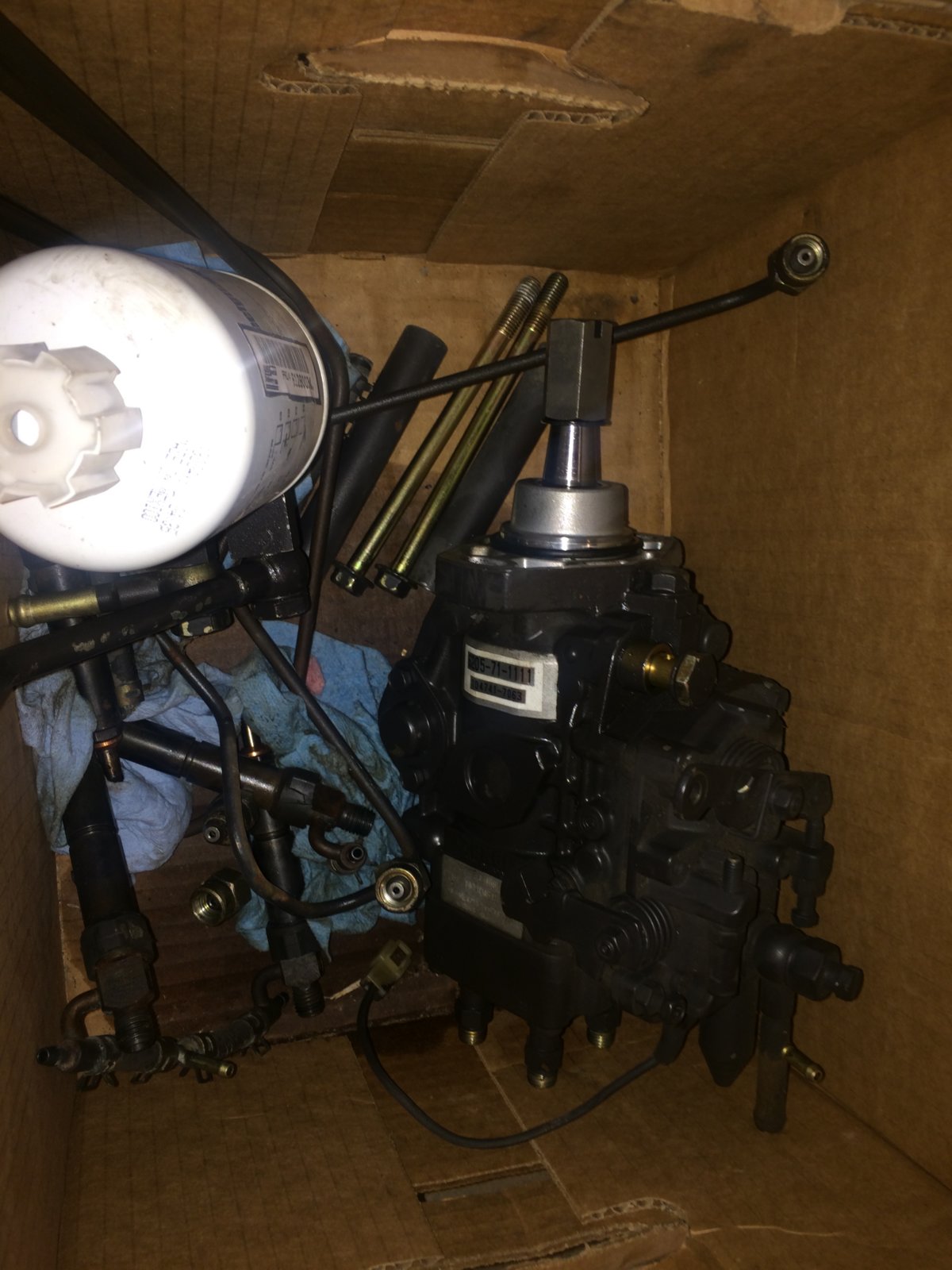

Stage 4 ‘tune’ ;)
Jimmyb
Mar 13, 2018
189
Is that a p pump from a 4bt?
872
Close. It's a VE pump from a B3.3T. This is my "Planned Obsolescence" delete kit.
