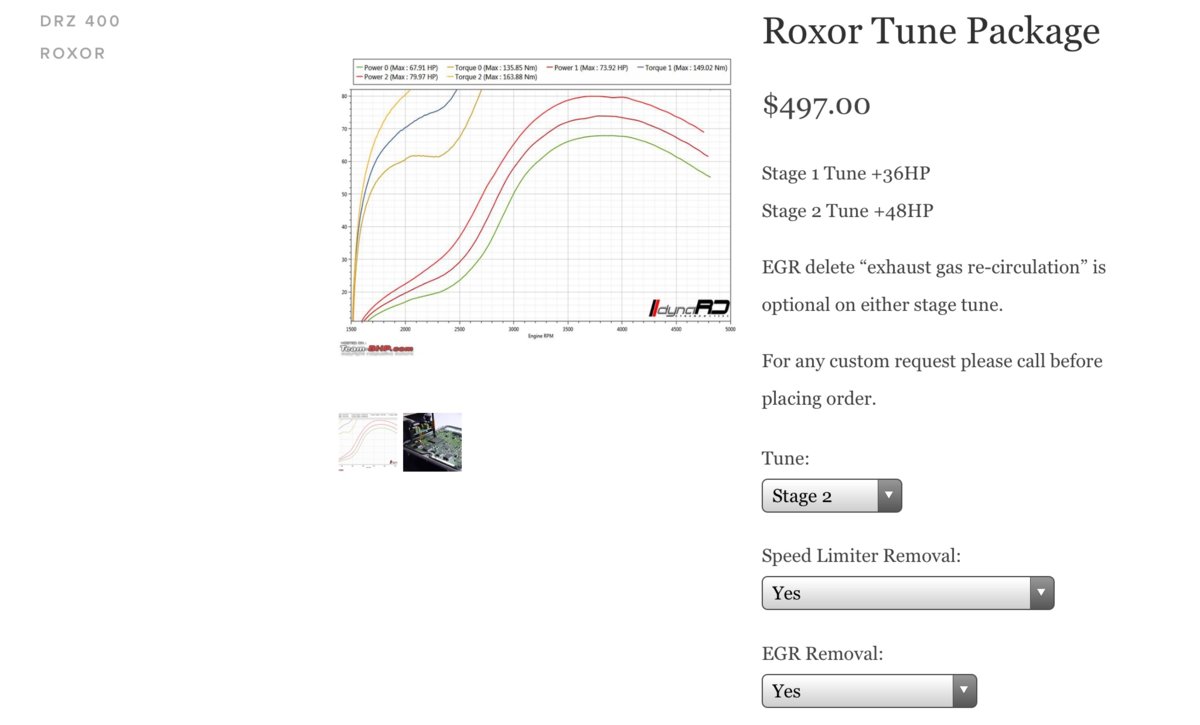

Dirt Legal also got into the Tuning for the Roxor. Stage 1 & 2, speed removal, and EGR delete. But i don’t know if outsource it, because their online store is links to the other sites for Roxor stuff.

OK but there is something wrong. The stage 2 shows 168.88 nm of torque, If i calculated it right that comes to about 120 lbf. But even if that is 168 lb.'s thats about a 100 less than the CP tune. I am i seeing this right?
Haerterich
Sep 19, 2018
130
Caledonia, IL, USA
738
Not only that but look at the RPM scale, I will not push a this diesel to 3750 rpm to get peek Hp. For 98% of us its torque that matters, Hp is nothing more than a calculation based on torque and rpm.

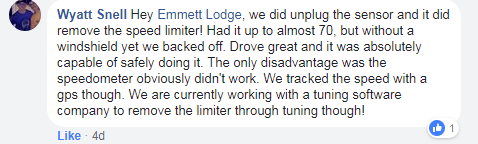

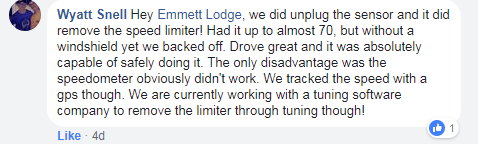

Speedometer is basicly useless above 50 or so from what I read somewhere......wont go higher even if its remapped. So disconnecting the sensor will work for me...I will get past the breakin point and do it then. Correct me if I misunderstood the artical I was reading on this.
Pulling sensor won't work anymore starting 2019 model year. It will go into limp mode. Meters are plugged around 55mph mark. Pull it out once flashed and the needle will go further. The unlocked vehicle is capable of 70mph+ on open roads.
