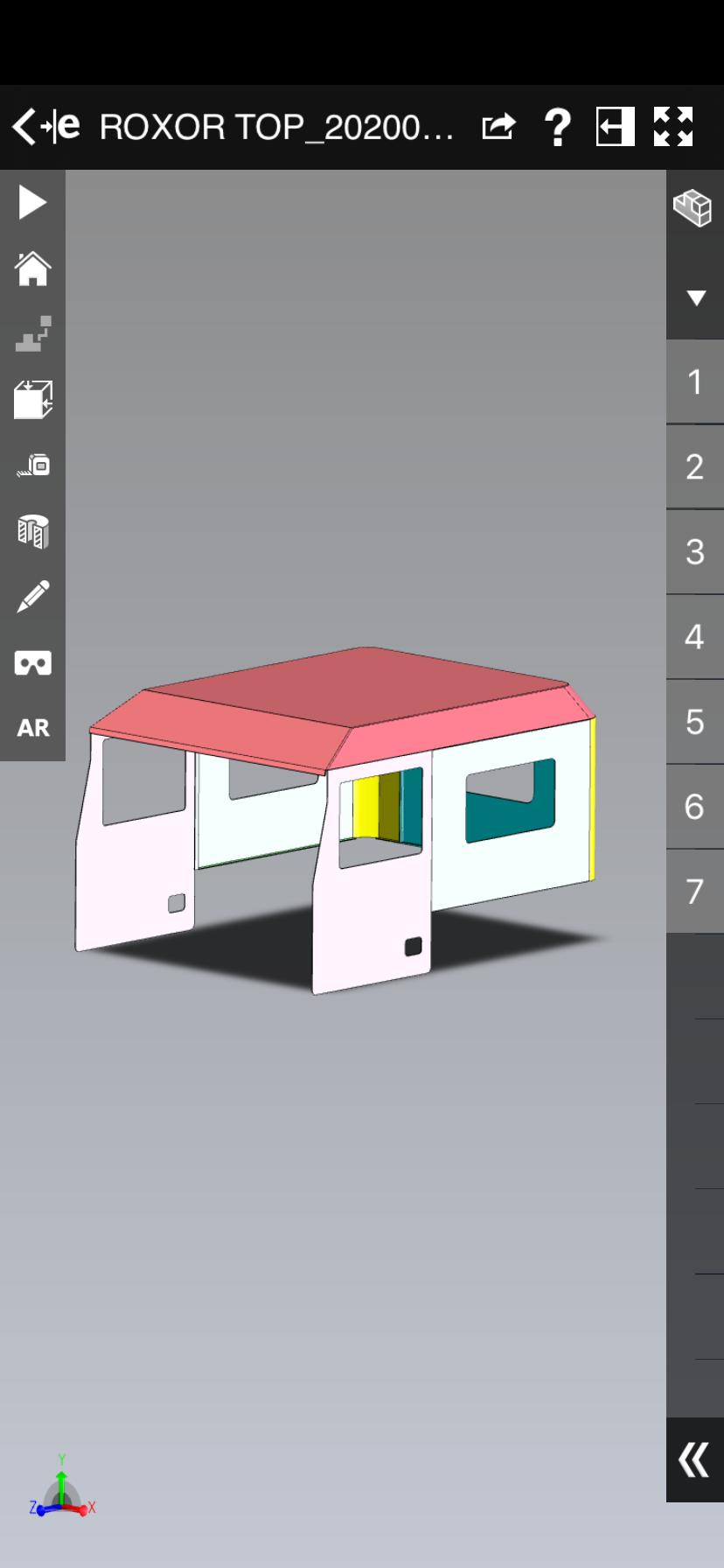

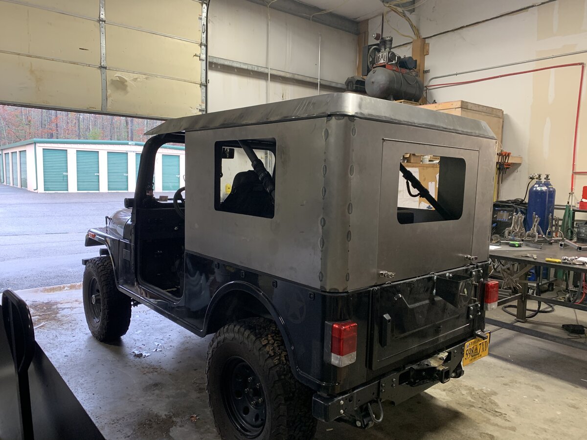

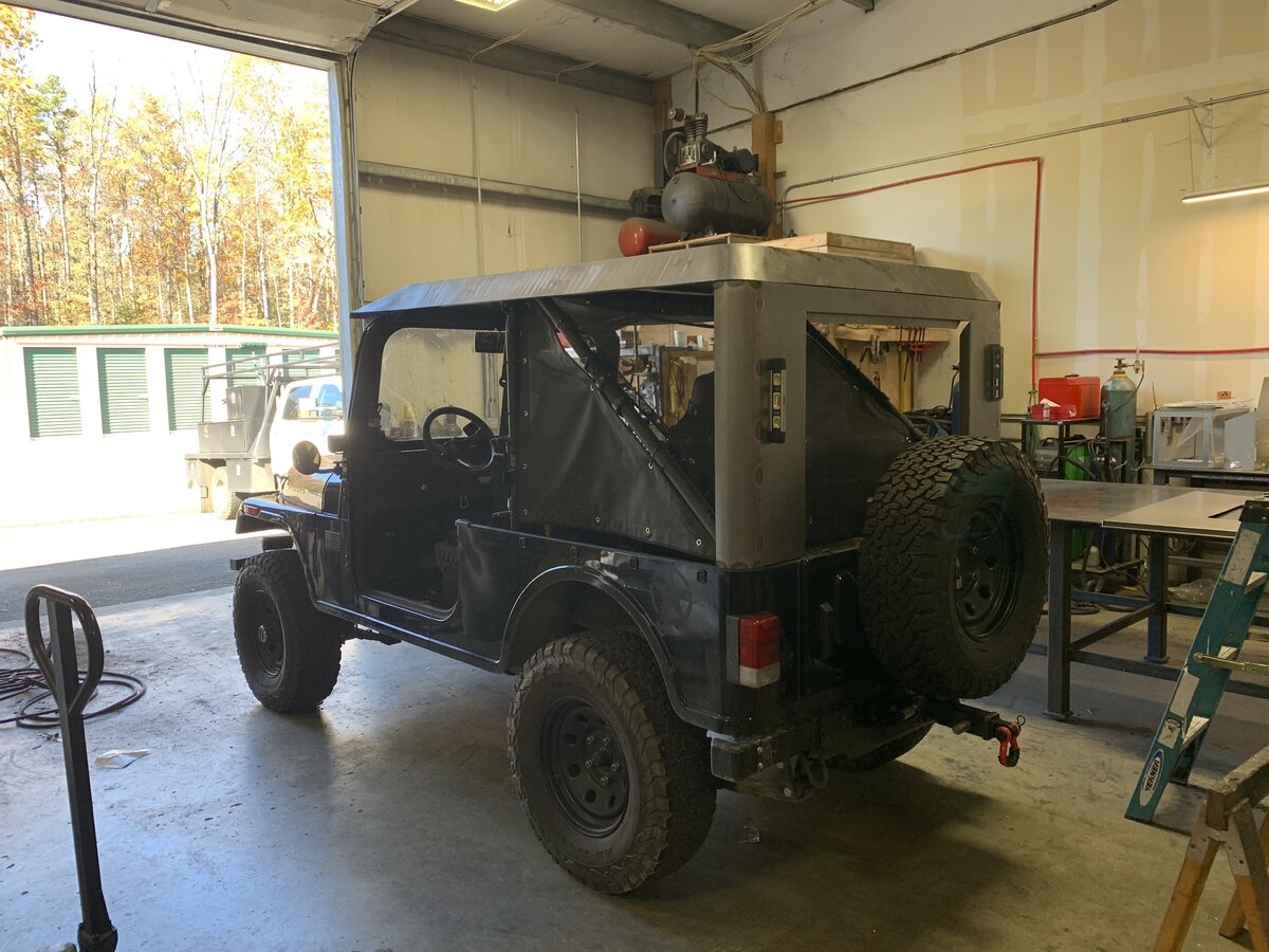

Working with a partner on an affordable steel top.
Looking to have first one done next weekend.
Most of this was modeled after a current existing custom top from another owner. Confident in the design. Will have more info soon.
2,266
PineCreek, that looks incredible, very well designed! Great job.(y)

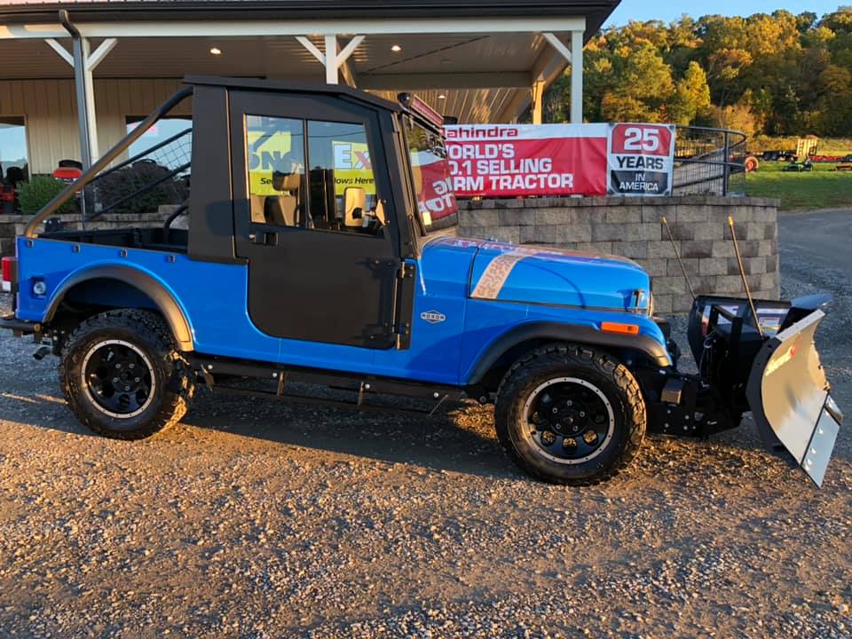

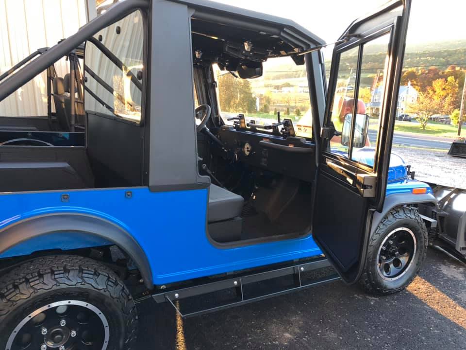

I have the DFK hard cab and really like it. It is very well made, I was very surprised by the quality it is better than I expected. It takes a little time to install it but everything lined up very well. It is also very easy to remove the doors/rear and side panels. I have just had roof and windshield on for the summer. The fold out windshield is a cool option. I would definitely recommend it.
Vetdawg
Aug 17, 2019
33
South carolina
I bought mine from dirt legal. Very good company to work with, I did call and order in person. Shipping was free to a business address so I would ask about that. I did order the windshield wiper and washer which work very well. Hope this helps.
It is listed as hardcabs roxor half cab enclosure on their website.
They have since updated the doors also. They made them a bit larger and moved the latch so it doesn't bust your hip. This also makes a lot larger window, reducing the blind spot by the B pillar. Much nicer doors.

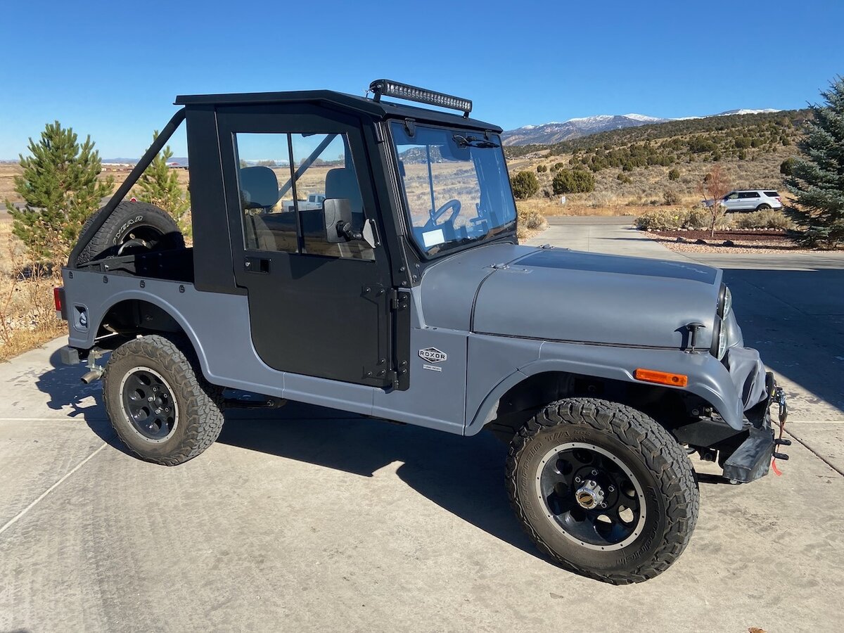

I just got my Roxor back from the dealer today after they installed the Hard Cab and wiper system. I drove it for about 30 minutes this afternoon. The advantages I see are:
1) Much quieter when the windows are up
2) No diesel odor with the windows up
3) At 40 degrees with the sun out, the cab stays warm enough I don't need to run the heater
It's not completely noise free like an automobile would be, but it's pretty darn good. It's also not without a bit of air coming in from the outside, but again it's pretty good.
The mirrors are okay, not fabulous, but certainly adequate. There does not appear to be a good way to install an interior cab rear view mirror without doing some monkey motion (my machine is otherwise street legal here in Utah). On the whole, I am very pleased with it so far.
