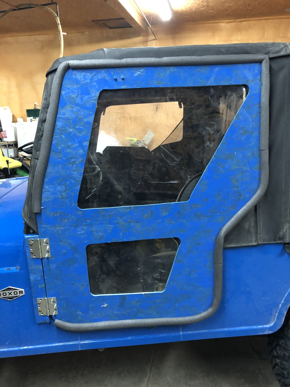

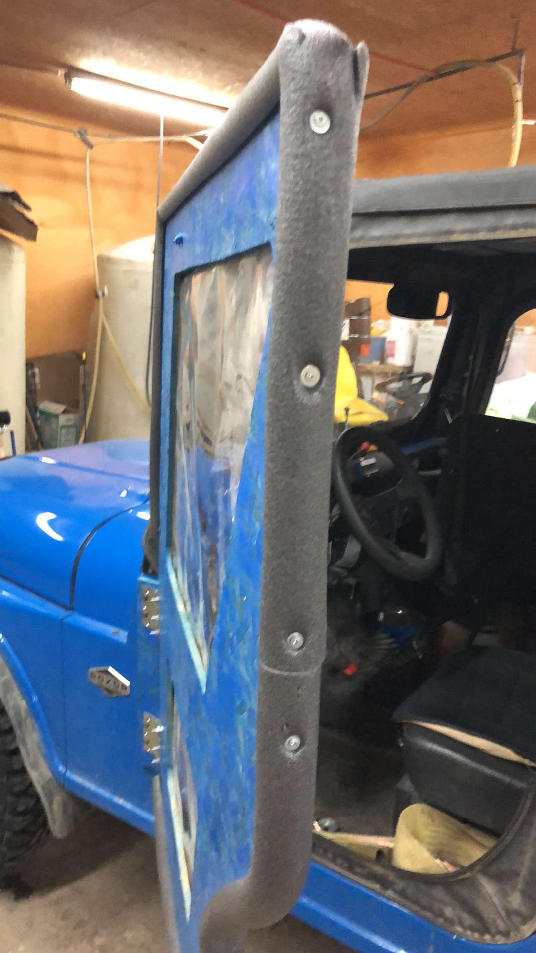

Sorry to hear you have joined the "Failed Zipper Club", there are lots of us. They replaced mine twice and I gave up and did this for $16 till something better comes along. I'm surprised they are still selling that soft cab.

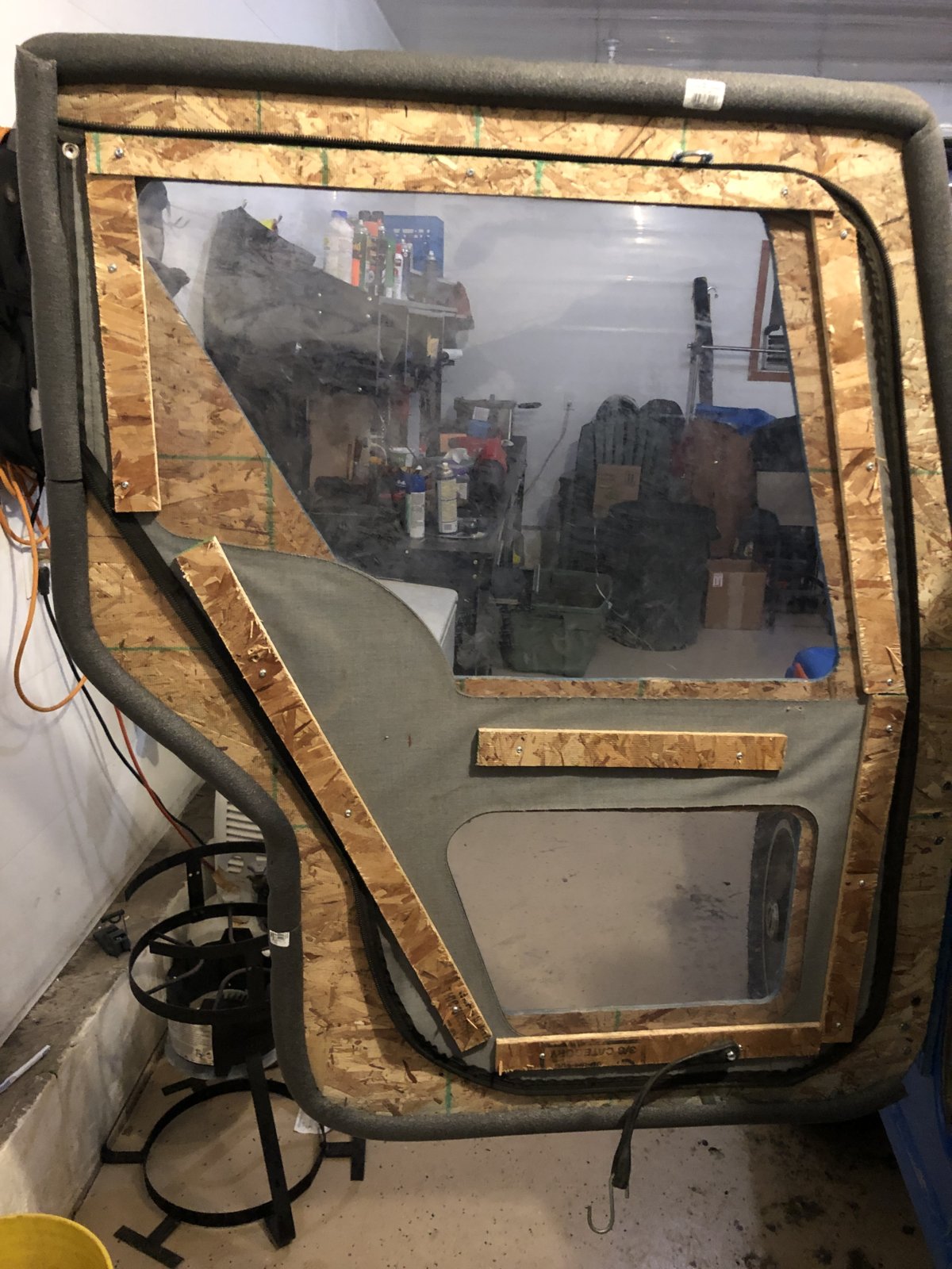

That is the failed door attatched on the inside to make my windows.
Half sheet of 3/8th OSB, 2 $4.00 hardware hinges drilled to match and some 99 cent pipe insulation and a can of spray paint. Remember, this is just temporary.

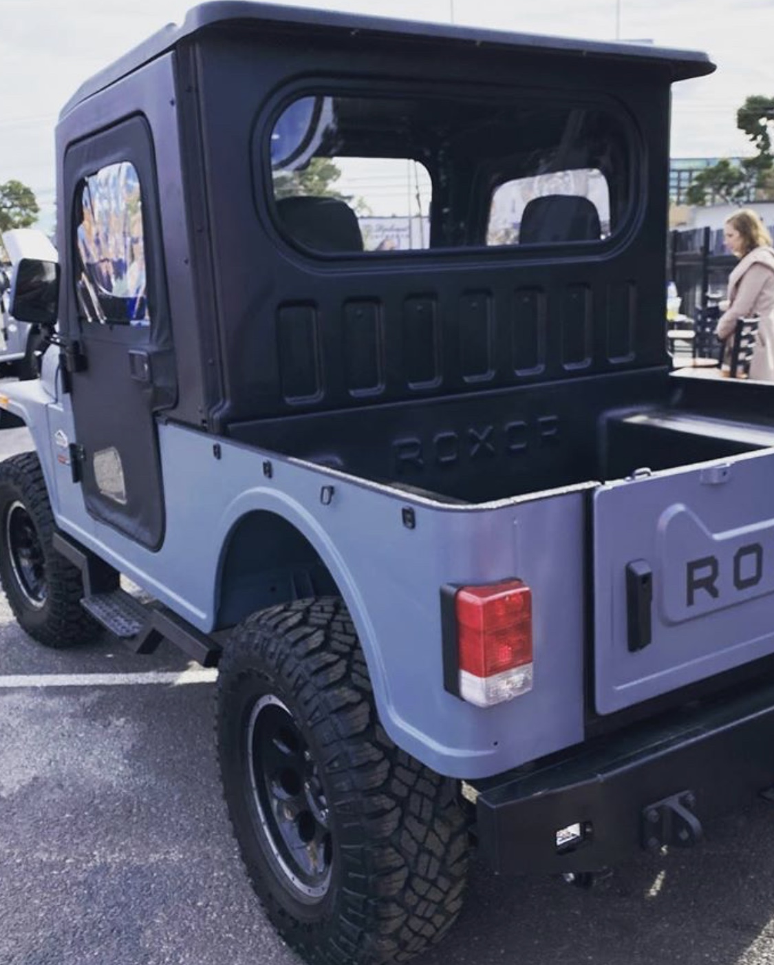

I think a better cab is on the way, it keeps showing up in pictures on Instagram from SEMA and the concrete show. I’m just surprised they haven’t stopped selling this one with the zipper problems. It’s not making owners happy when they fail, no matter how many times they replace them free.

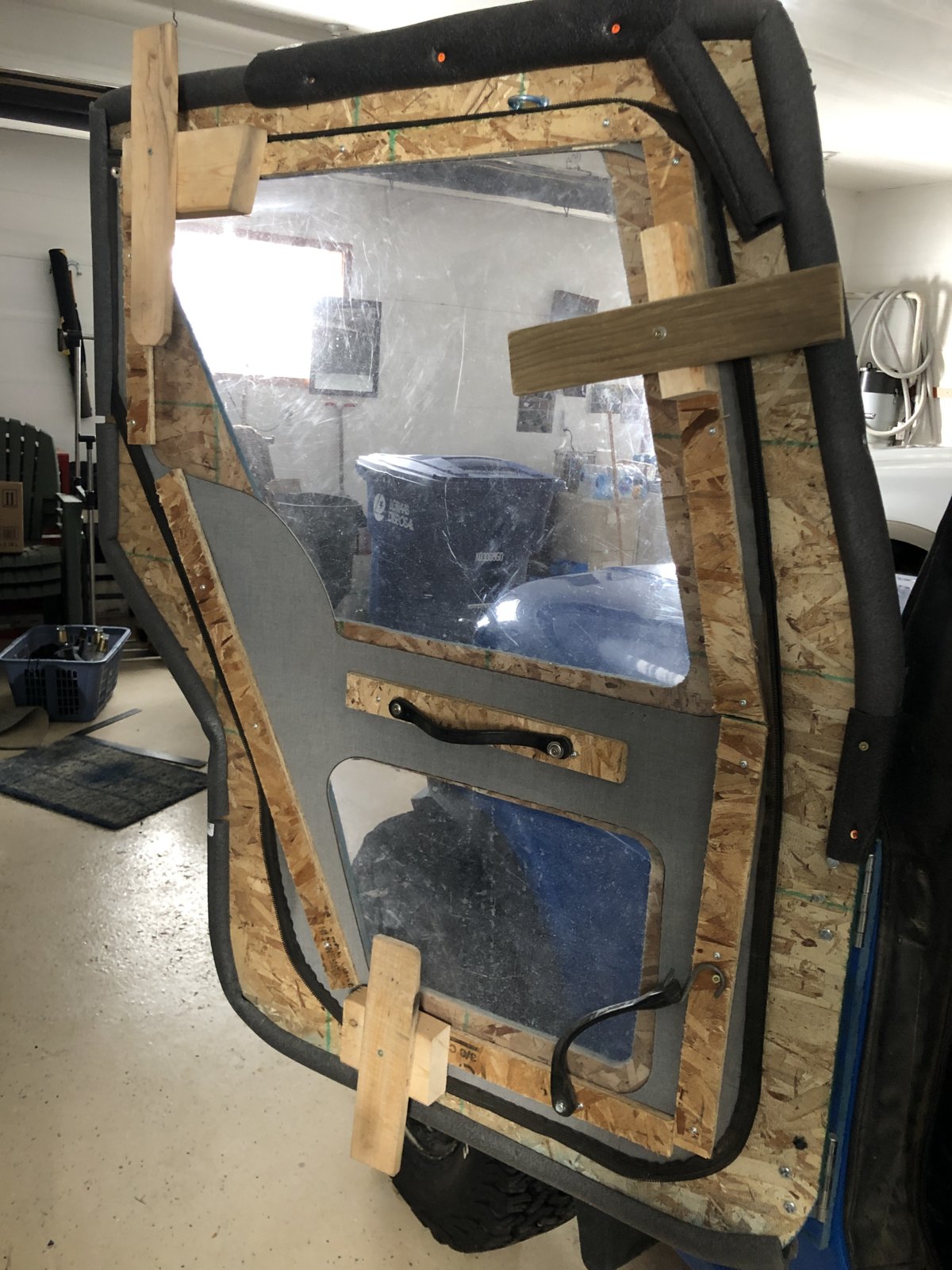

I put 3 “wood turn latches” on that grab the ROPs. They keep it snug. If you plan on something like this, I can get more pics. I left the piece that the door zips into on the Roxor.

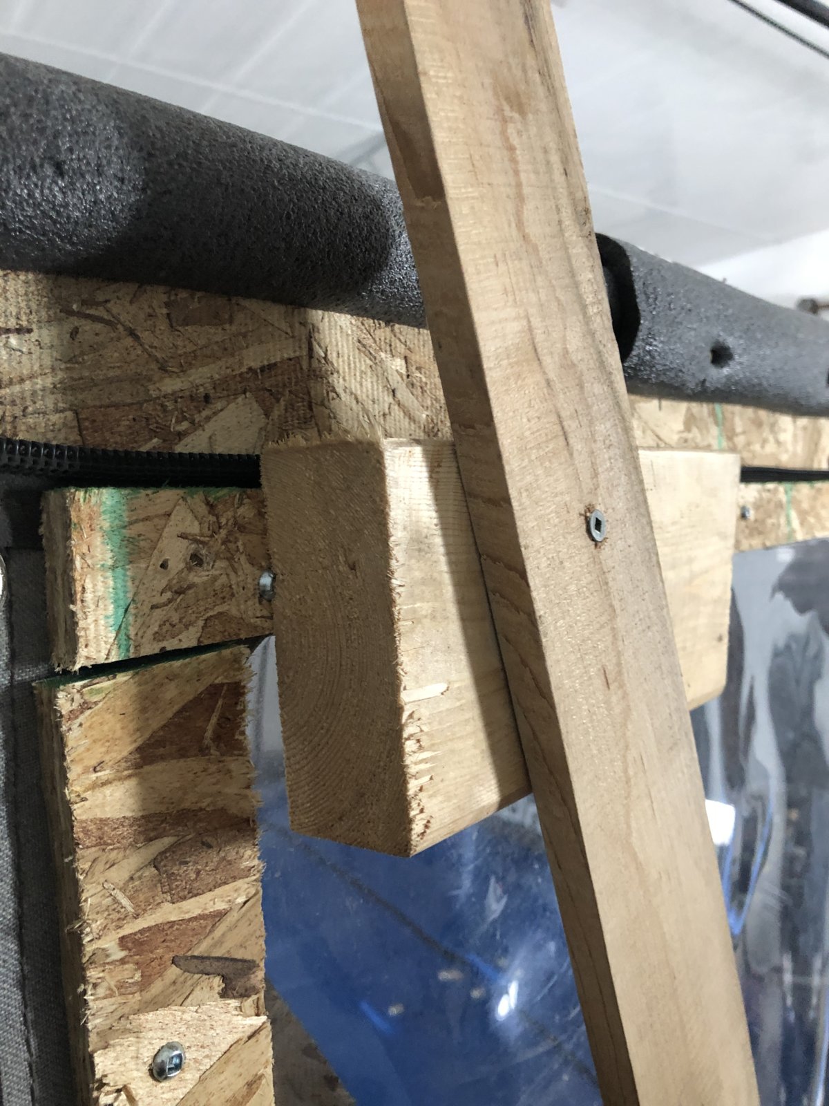

This is my latch system. I have one at the top and bottom and one on the front edge. They have a 2x4 mounted to the door, then the wood turn thingy, that is the perfect spacing to grab the ROP's. I usually just do up the top one till I get on the open road. it seals up good. I used 3/8th OSB so it could flex enough to close up nice, which it does.
