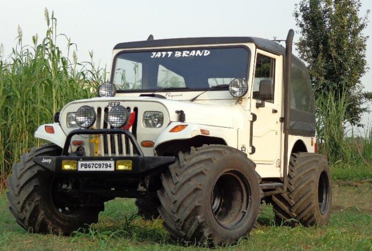

Can we get these Rims and Tire here in US?

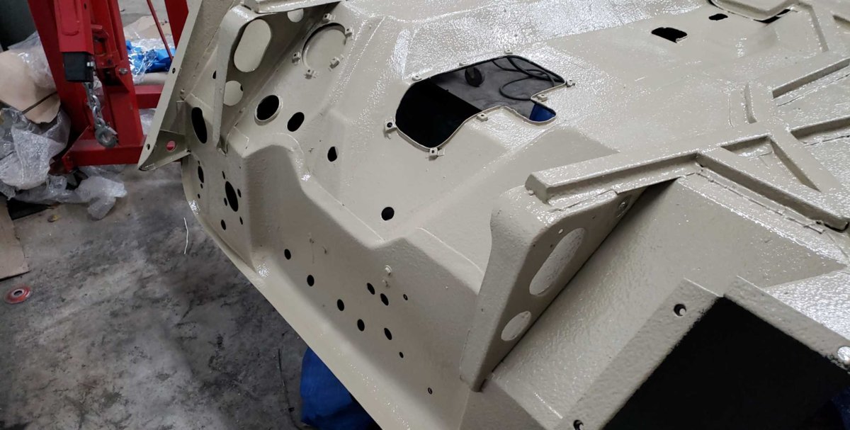

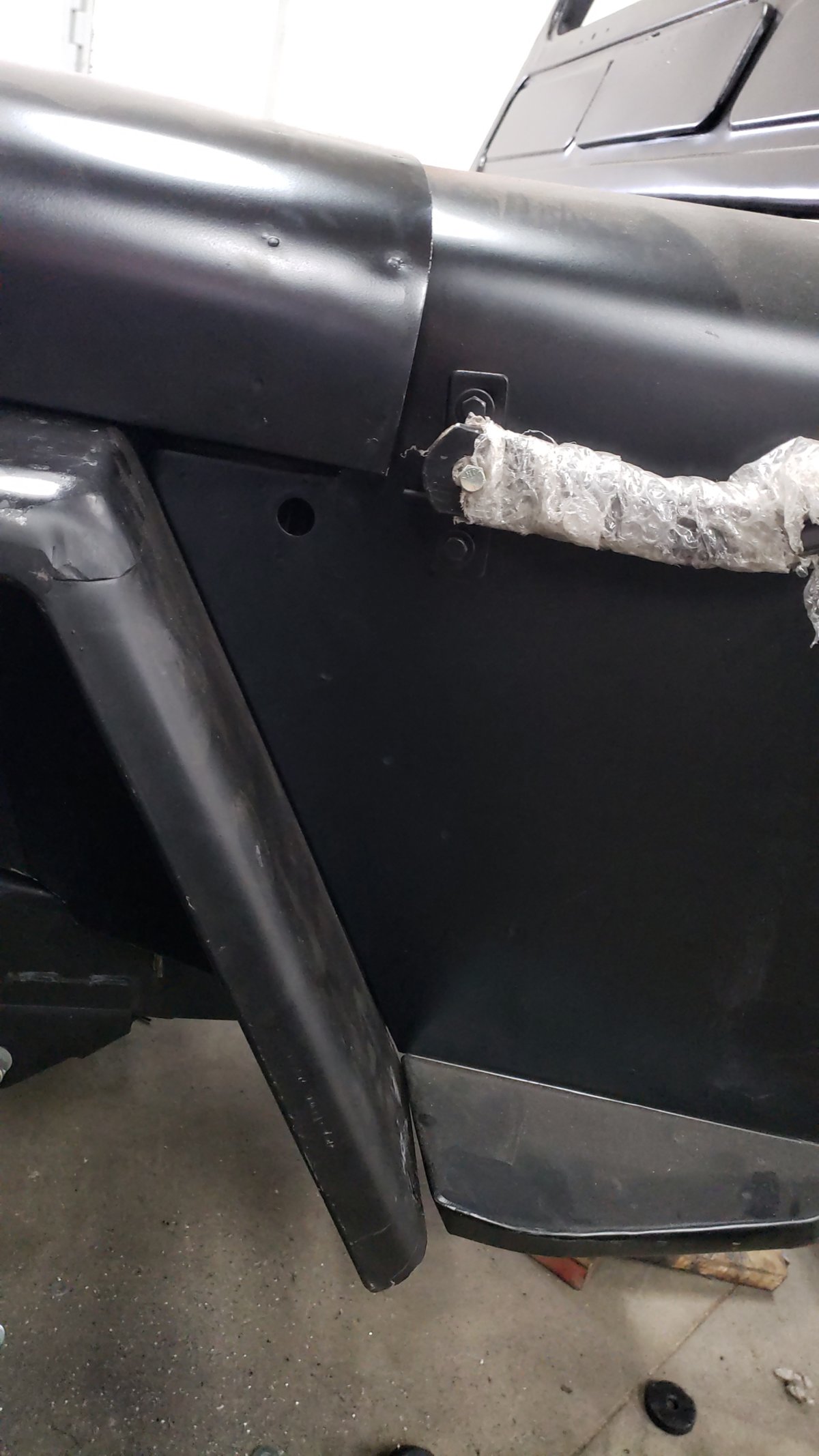

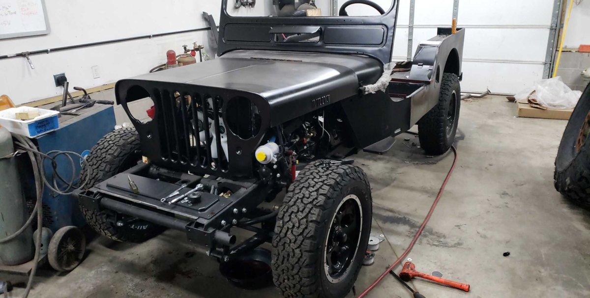

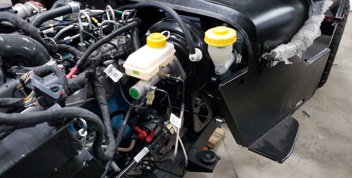

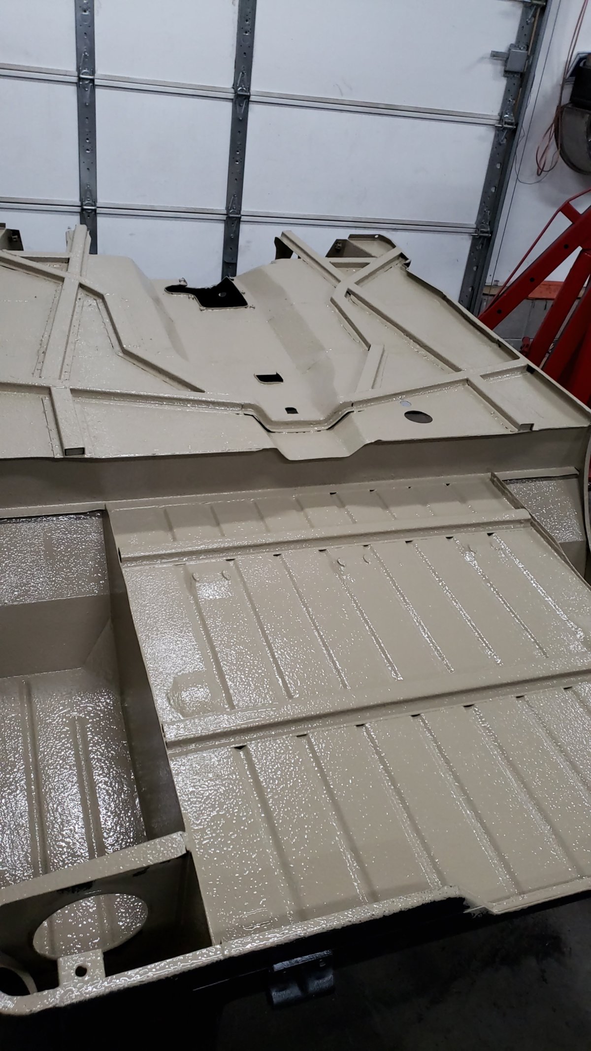

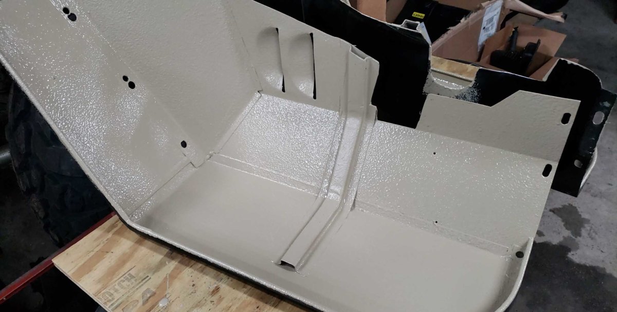

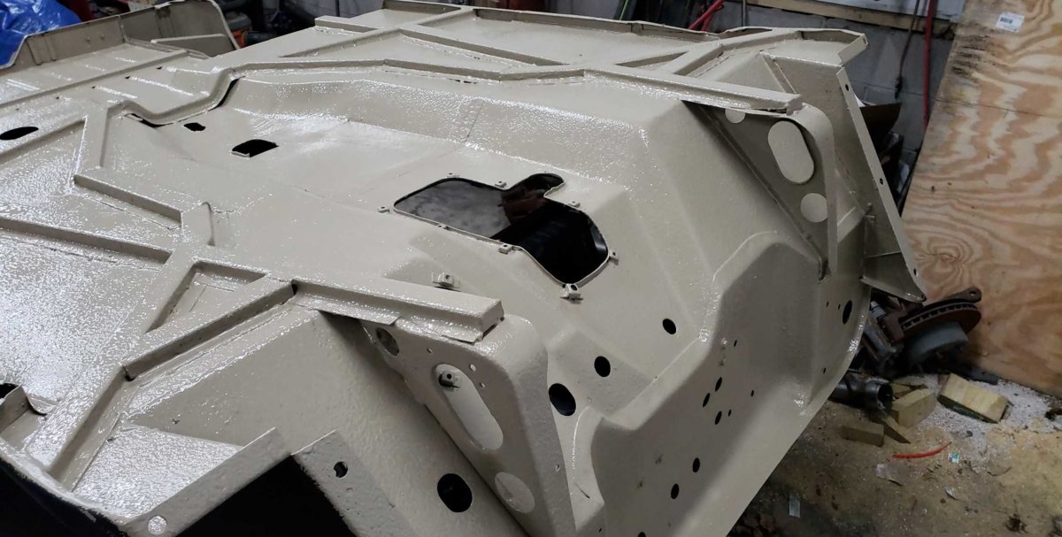

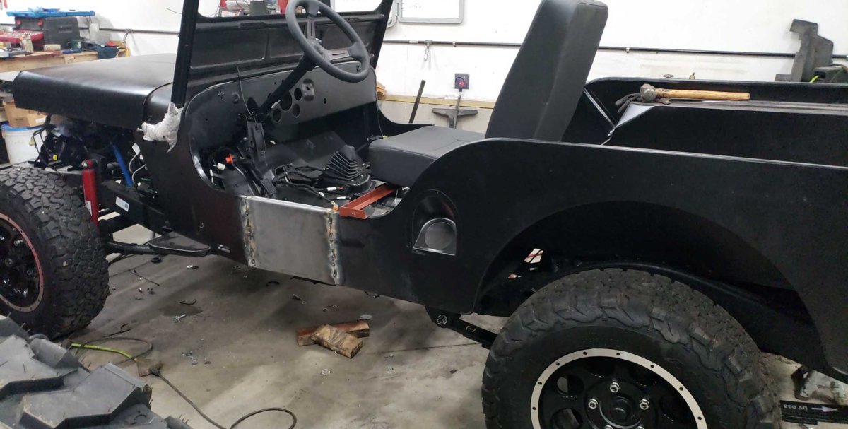

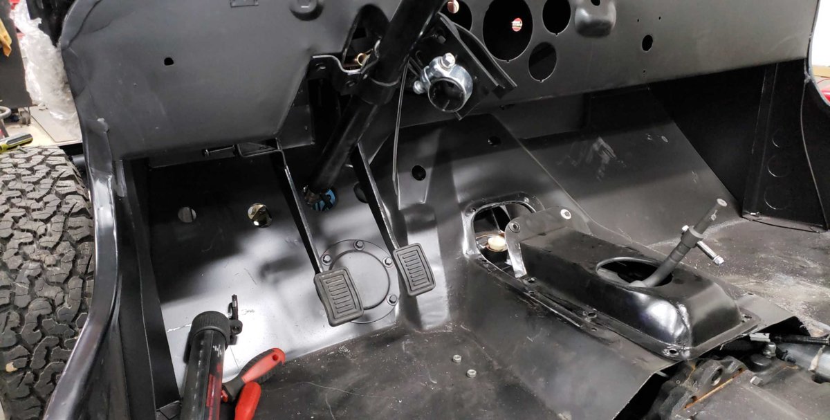

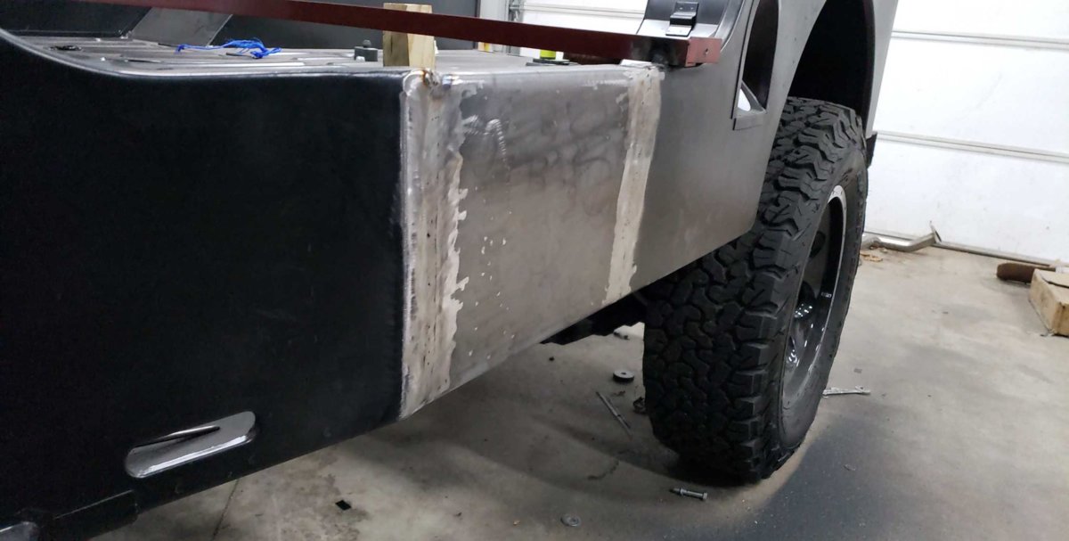

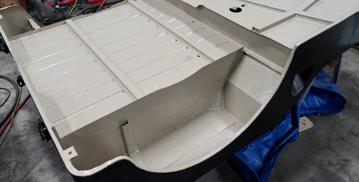

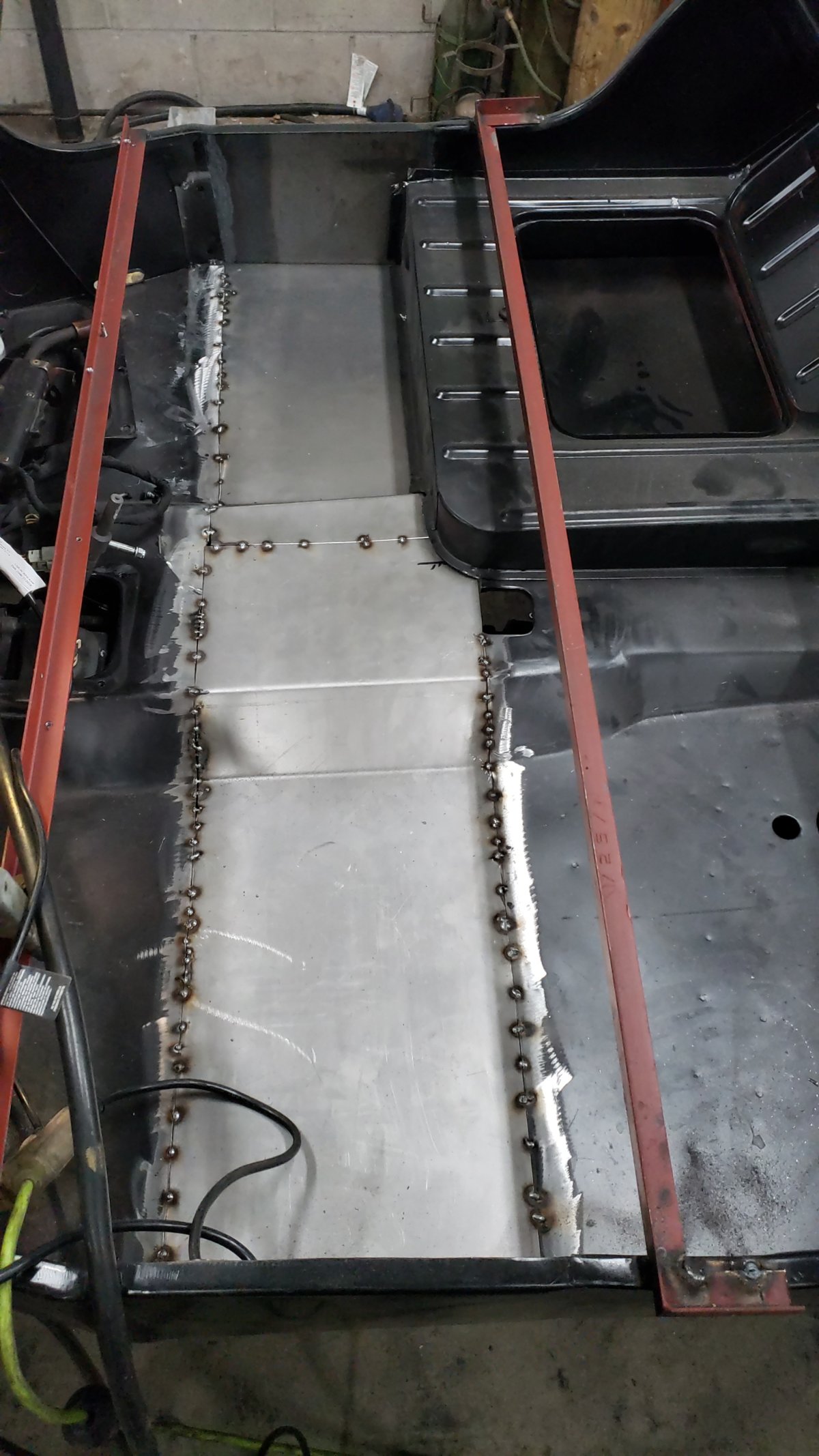

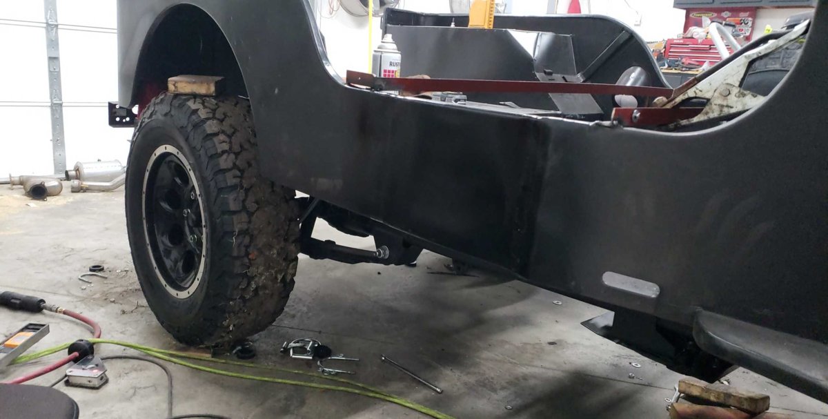

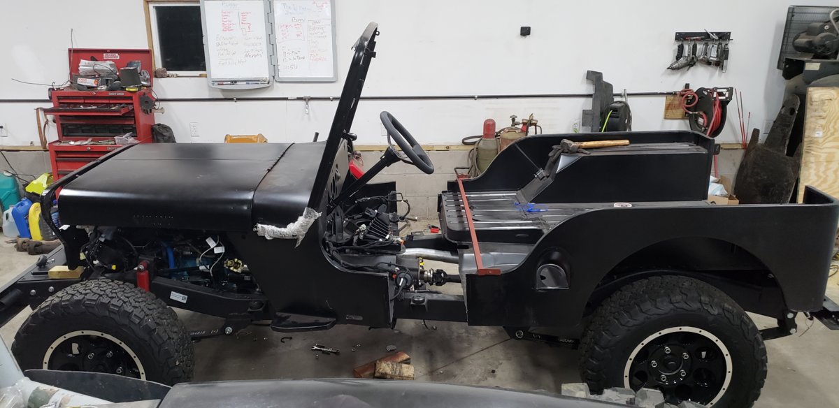

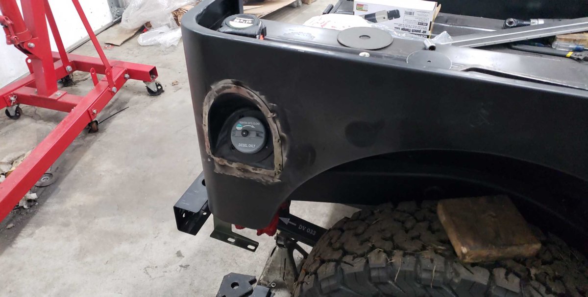

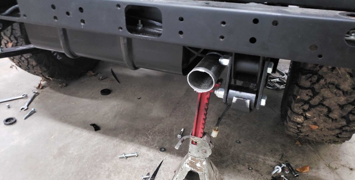

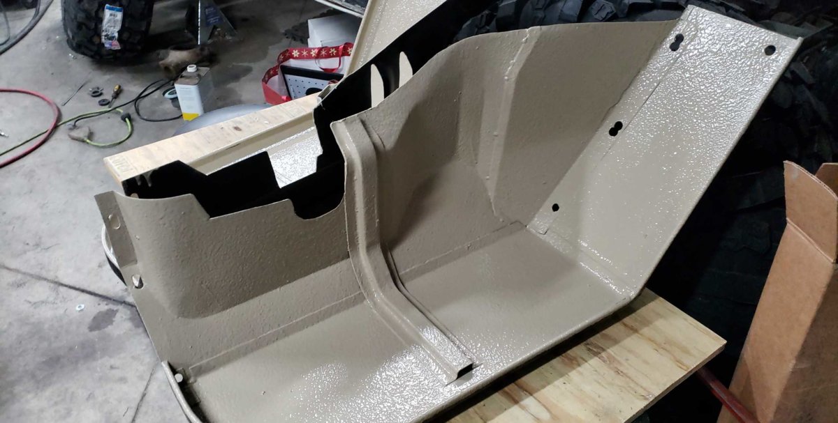

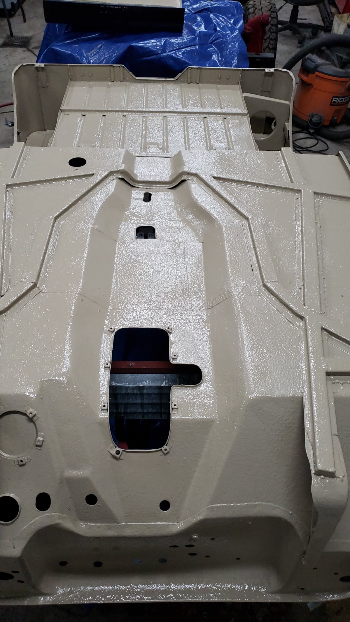

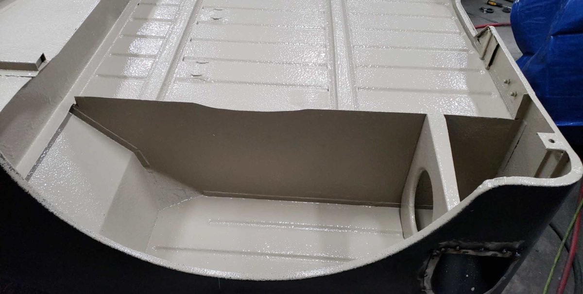

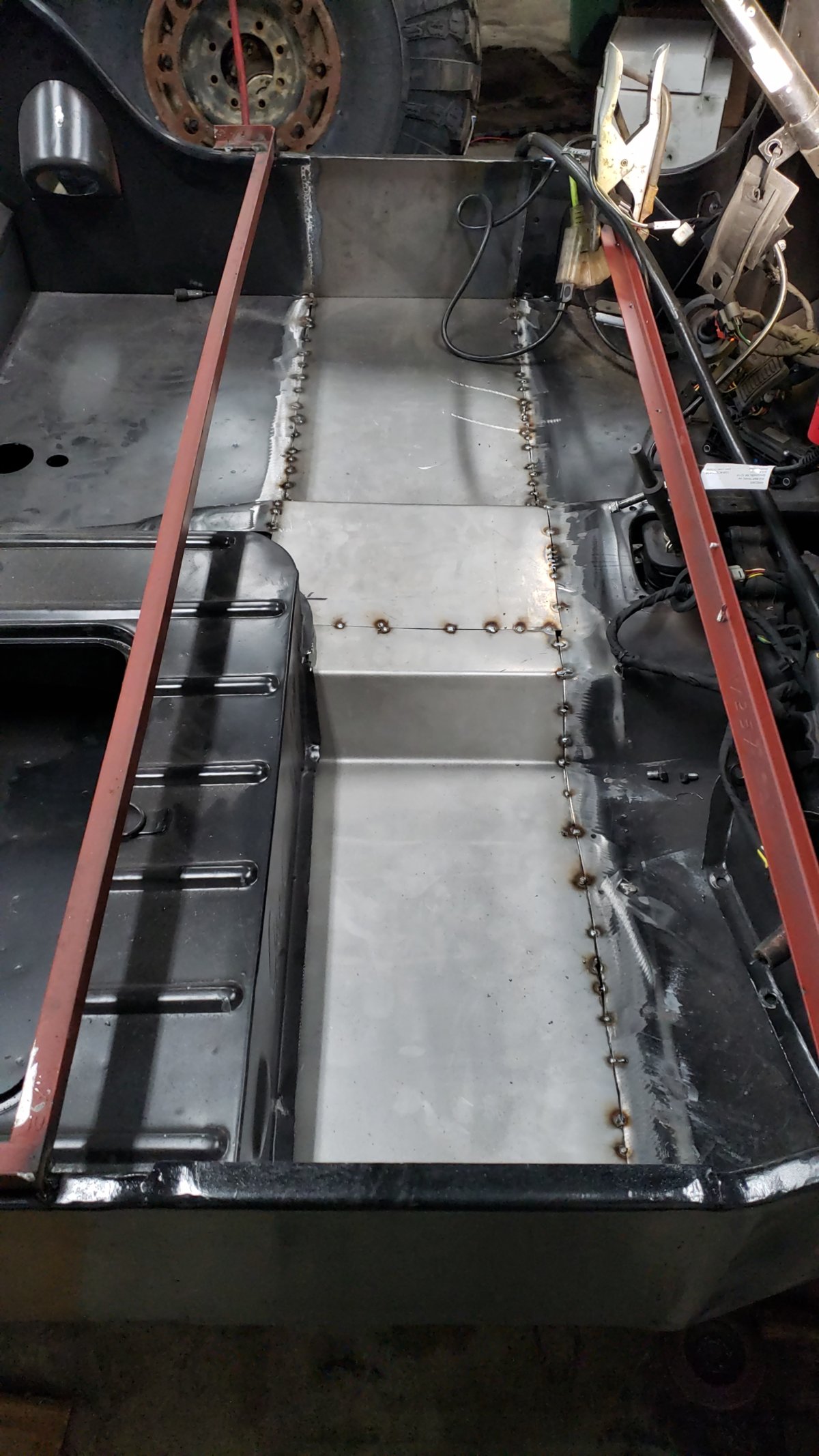

Got a few things done this week. Started welding the body back together. new 2.5 inch exhaust is in. Pedal assembly is mocked up and both the clutch and brake master cylinders are mounted. Modded the grill to fit the Willys radiator and ordered a bunch more parts. Lights and blinkers are on the way, Winch and Warn winch plate, Front and rear bumpers will get built soon, finish the floors and bracing and figure out the gauges. It should be ready for paint soon.

I looked over your project and all I can say is WOW. I can see you've had to cut and extend the cab because of the longer wb which means it's time for custom doors. I really hope it works out for you. Keep us posted.

It will probably never have doors. It will be spending its time in AZ and summers in michigan. So just bikini top. But a soft door or tube door is easy to make.

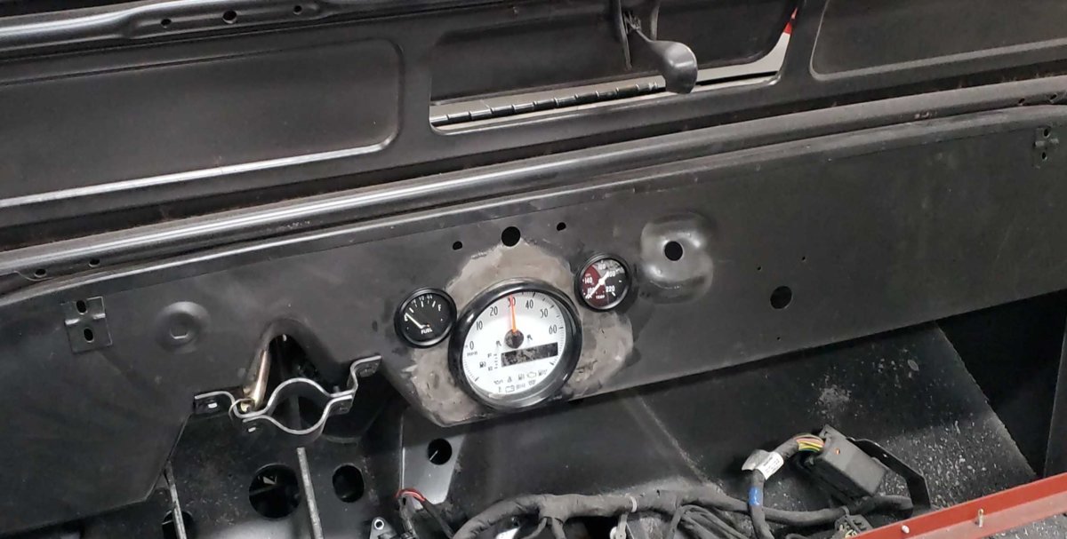

875
NICE touch on the Roxor speedo!
