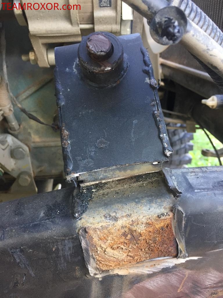

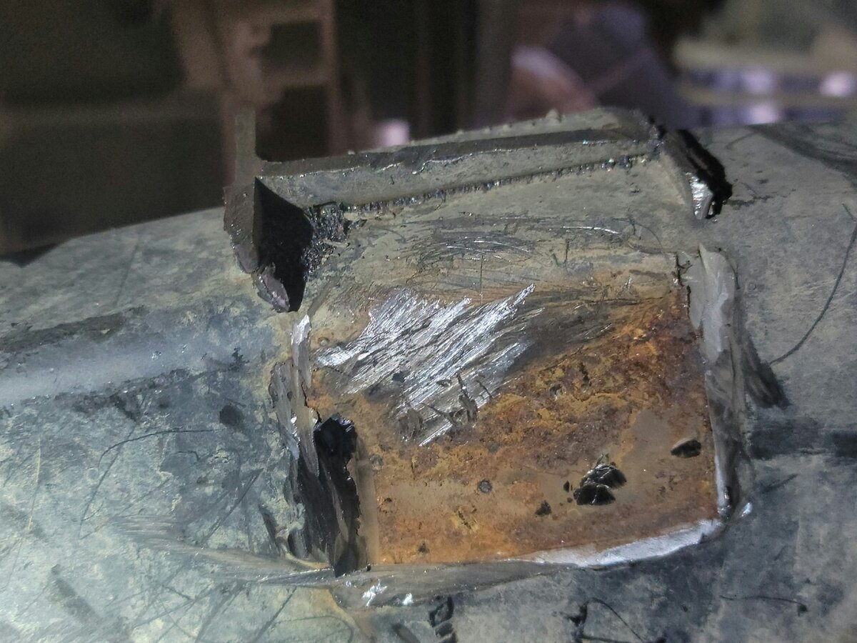

Just my luck, my brand new bottle of shielding gas is empty, and it's a holiday weekend. So instead of welding, I will start off with cutting I guess.
This is a picture Max took of his shock mount after cutting it off with just north of 100 miles on it. Zero penetration in the weld, but most importantly, the shock mount pocket being rusted. I have almost 1000 miles on my I think, and it has so far been completely submerged in mud and water at least 4 times in the past year and a half. Not to mention having spent a winter here in Alaska. So I will have my version of this photo posted soon..

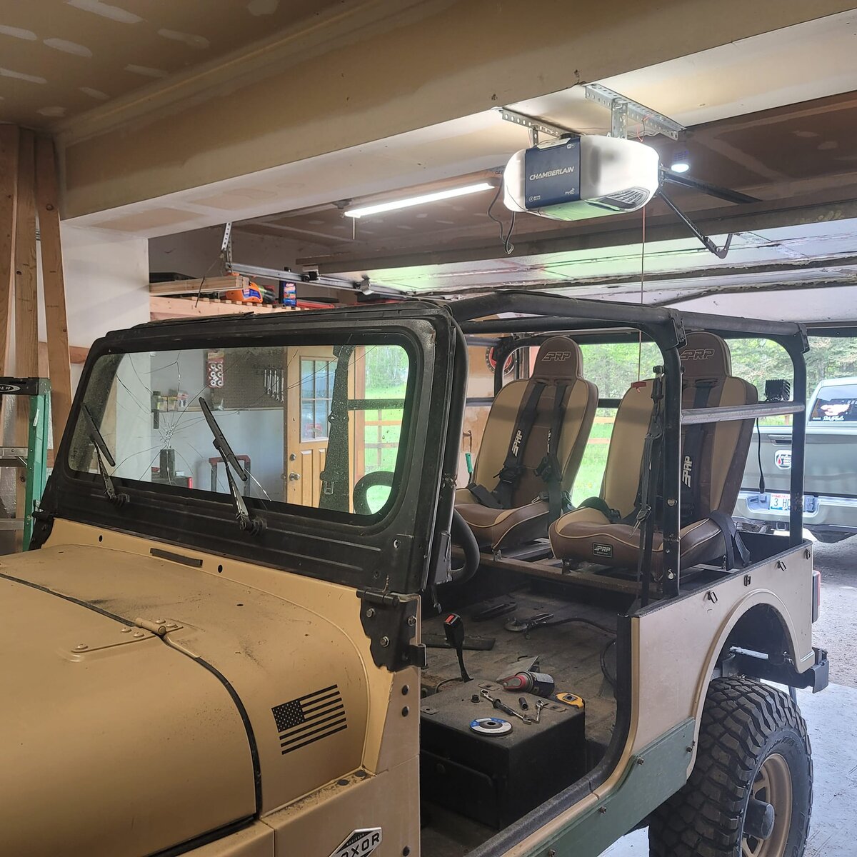

I cut 2" out of the ROPS, low and behold its DOM. So I sleeved it with 1 1/2" DOM, plug welded, and then fully welded it back in. Here's what she looks like currently. I will get it finished up this weekend.

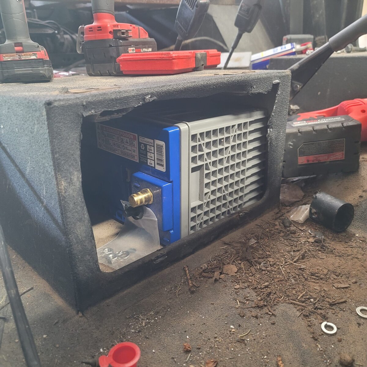

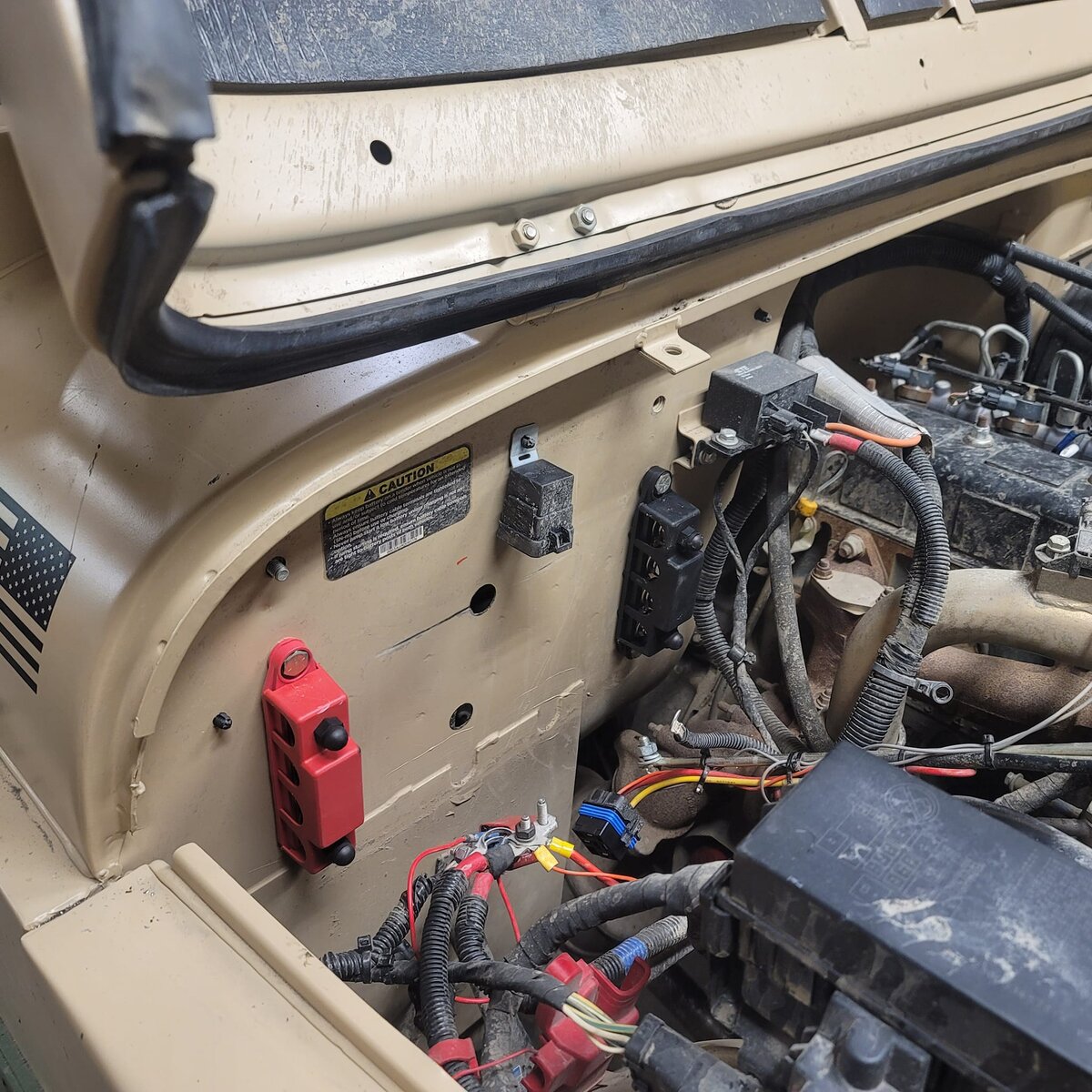

Ditched the factory battery tray. Nutserted the firewall, and installed the busbars for my front winch, starter cables and main feed wire back to the battery
706
Please excuse the ugly cuts. That's not how I am leaving it. It's a rough cut so I could get the battery inside. This is under the passenger seat. It will have a diamond plate aluminum hinged door to cover it up. Should have the wiring and mounting buttoned up this weekend as well.
706

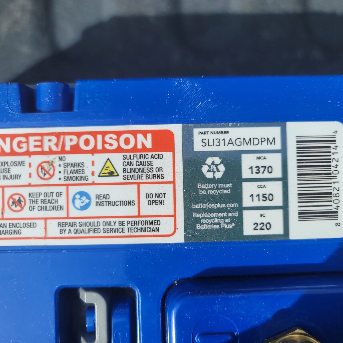

And here's my new Enormous battery. It weighs 75 lbs. Should have PLENTY of lead in it to keep the voltage from dipping when I am pulling the heavy brick out of the thick mud we have up here.

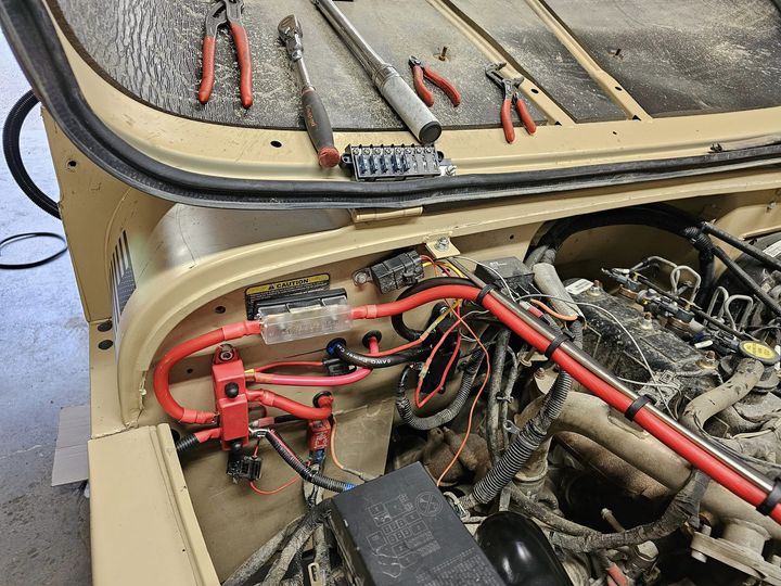

Under hood wiring complete (minus shortening the cooling fan power wire just because it's about 10" too long now.
Picked up more parts this week in Anchorage to finish the battery relocation this weekend. Everything is going to have its own fuse.
Battery-350A fuse
Front winch-300A
Rear winch-300A.
Notice on the hood lip there is a smaller fuse block. That's going to be my power distribution block for each accessory I am running inside the cab.
GMRS
Winch control front
Winch control rear
Front Locker
Rear locker
Windshield wipers
Additional Rigid cube lights for the front
I will have 1 extra spot on the panel for another accessory.

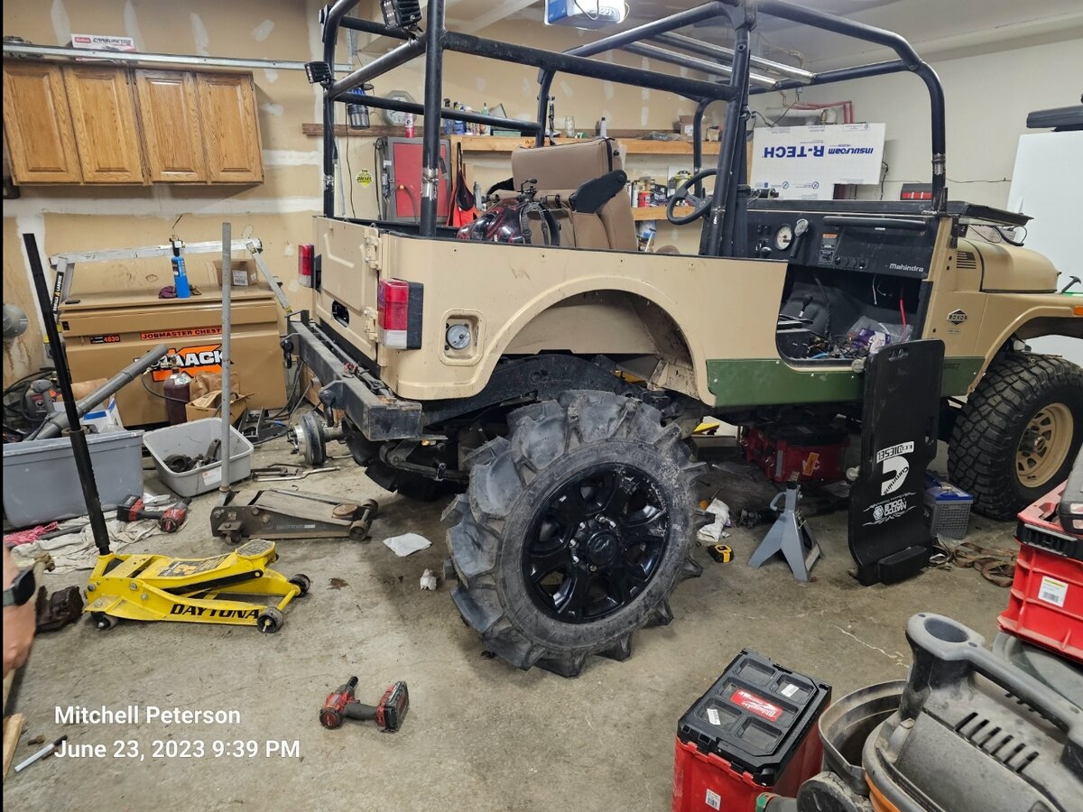

Exciting weekend starting soon. Axles are built. I bought the bullet and paid a driveline shop to do the work. $1600 for both axles. Steep, but done correctly. Should have the rear installed by this evening. Hopefully the front done Sunday if everything goes my way. Stay tuned for pictures.
706

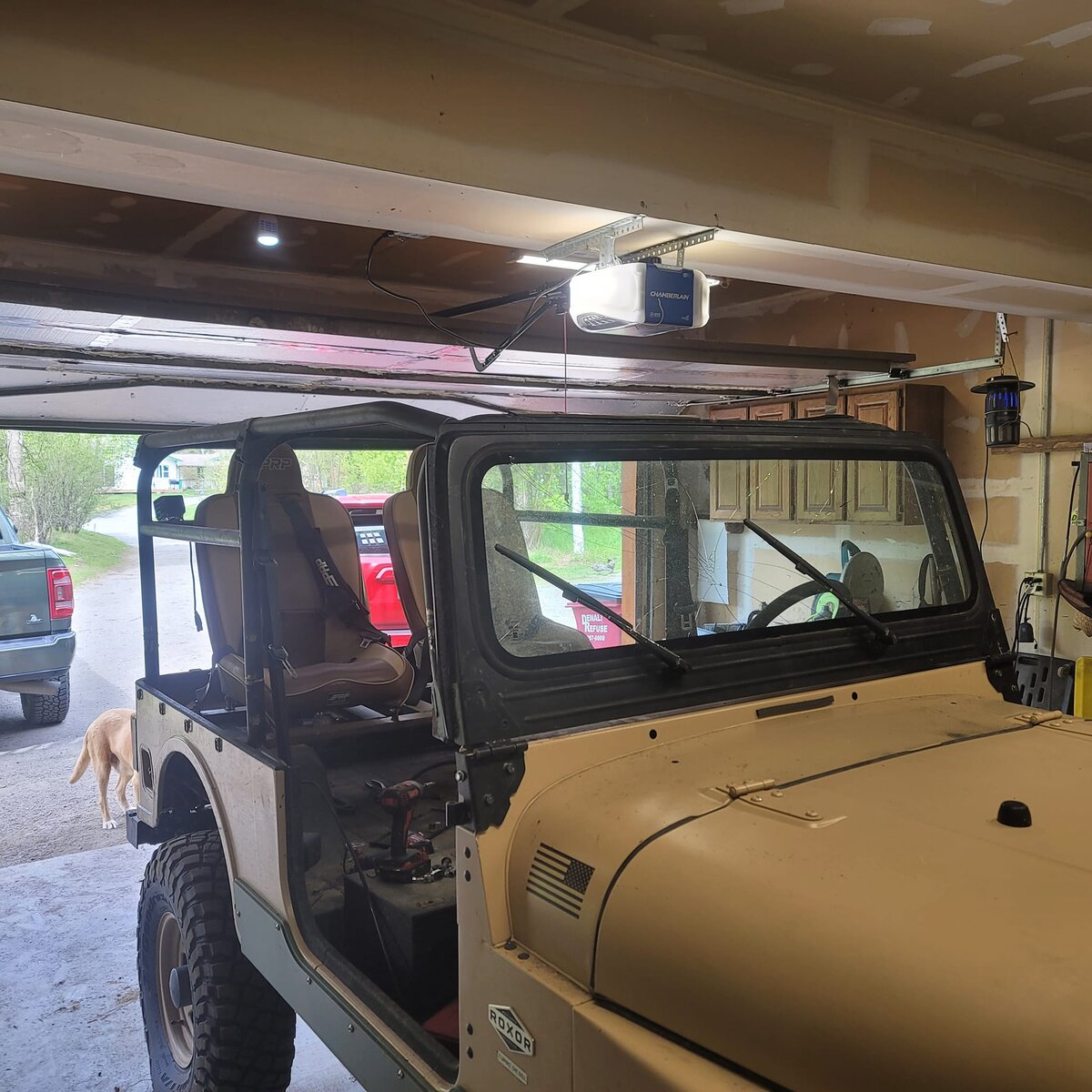

I have a set of 16" wheels to set it on to roll it out the door. Should be ok. As it sits now the cage contacts the lifting arm on the garage door by 2 inches. It's way too tall. I will have to get shorter springs. It's sitting at 7'4" with the 37s.
706
On the roller tires fully inflated, I'm sitting at exactly 72". I'll let the air out to get it out of the garage so I don't rub the seal. Need to get the last spring hanger on the driver side welded in before I can pull it out, back it in to get the front axle in. Parts are SLOW getting here from the lower 48. I've been waiting 2 weeks now for some front end parts to arrive. If they don't arrive by Friday then it's going in anyways.
