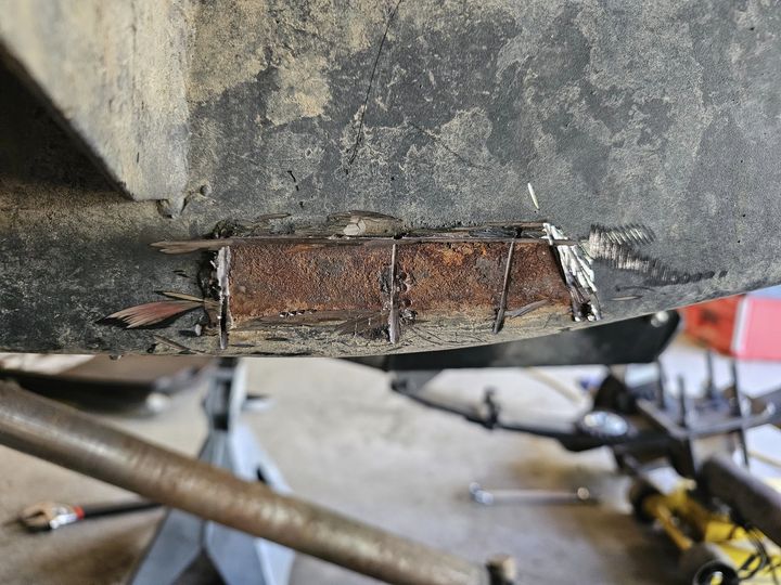

More rust pockets. This is the front axle, passenger side rear leaf spring hanger.

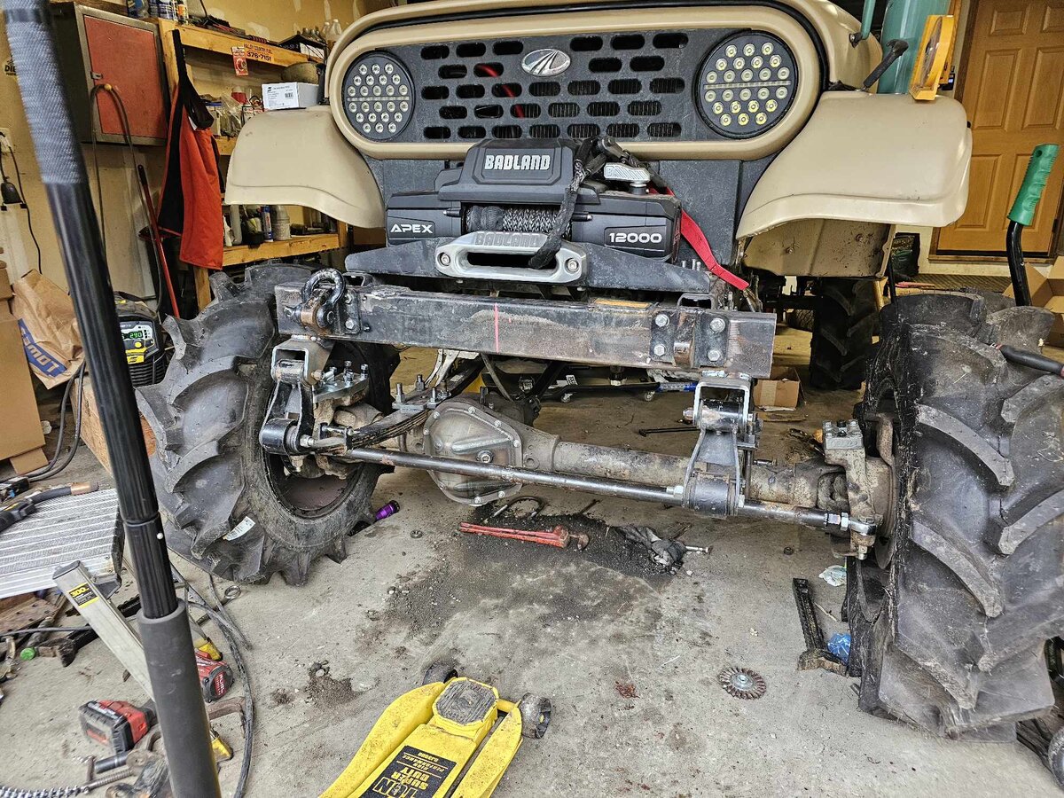

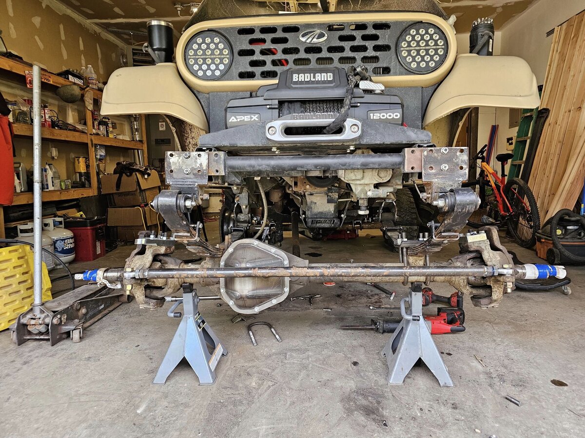

Front axle is finally bolted in. Moved the axle forward quite a bit. 6" over stock. Wheelbase is now 101". Once I get the new drop box built, I should have an estimated 2" of tire forward of the chassis.
Pitman arm was kind of a pain in the ass. I used a Rough Country ‎6610, which is a drop arm for 6-7" Jeep XJ lifts. Grinding out the 4 blind splines took way too long, and gave me a bunch of metal splinters. But, it's installed. Need to cut the DOM tomorrow on the bansaw at work, then I will have the steering completed.

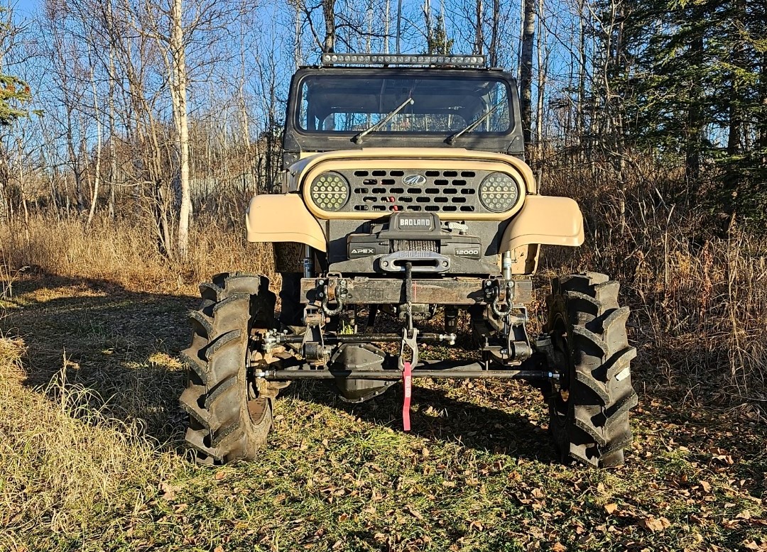

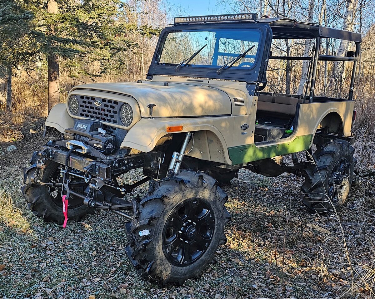

Front is sitting on its own now. I ran out of shielding gas. Once I get a fresh bottle, I will get the gussets and couple of other welds done. Still have to weld on the shock towers. Shocks will be here Thursday. Steering is 100% done. Drop pitman arm was a bit too long. But it's perfect. The drag link (not installed in this picture) is perfectly horizontal. I didn't plan that, it just happened. So I will have zero bump steer.
Still have a bunch of wiring to do, finish the cage tie in, build the seat mounts for the front. I don't think I am going to meet my arbitrary deadline of being done this weekend.

well ya wont have zero bump steer but you will have less then if it was diagonal.
How is the drag link clearance at full compression? Wrap your winch around the axle and suck it down. then steer left and right to check clearance.

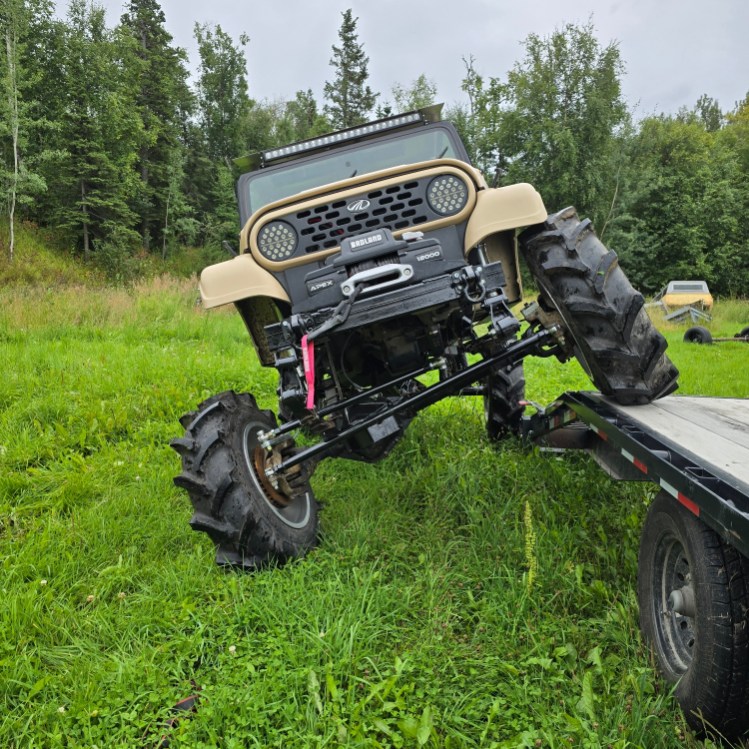

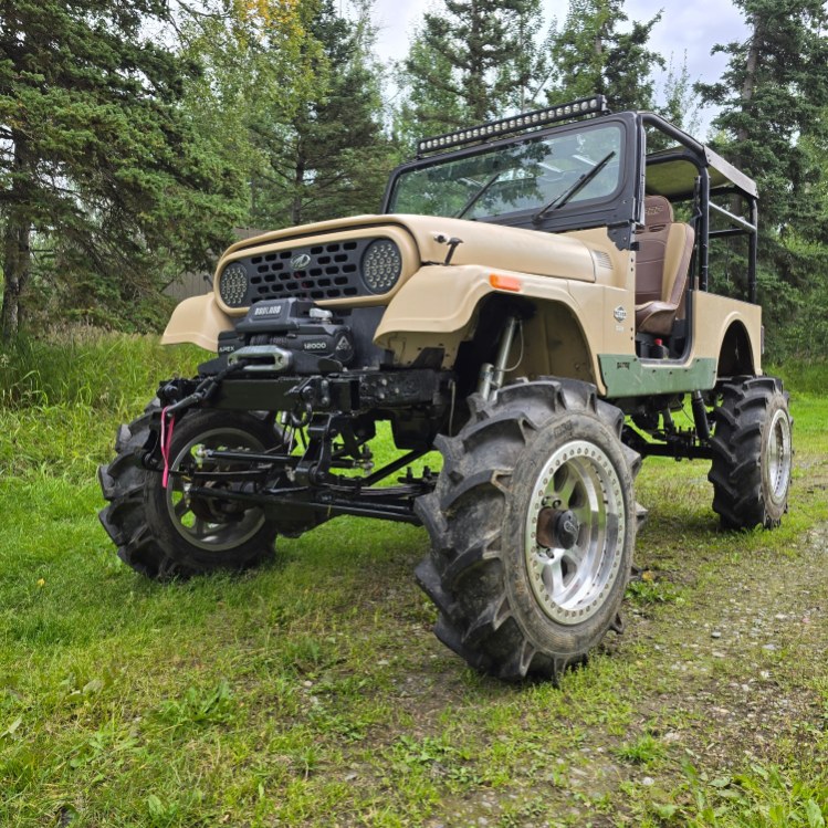

It's been a minute since I have updated. It's done. Took it on an unsuccessful moose hunt last month. It's too wide for my single car hauler trailer. The tread hangs off both sides. I have to drive 1 tire over the fender to keep from pushing the fenders out, and get the driver tire perfectly on the edge. If I am even a little to the right, the passenger tire is hanging off. Really going to be an issue once I step up to a 42" tire :LOL:.

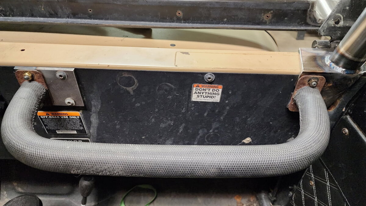

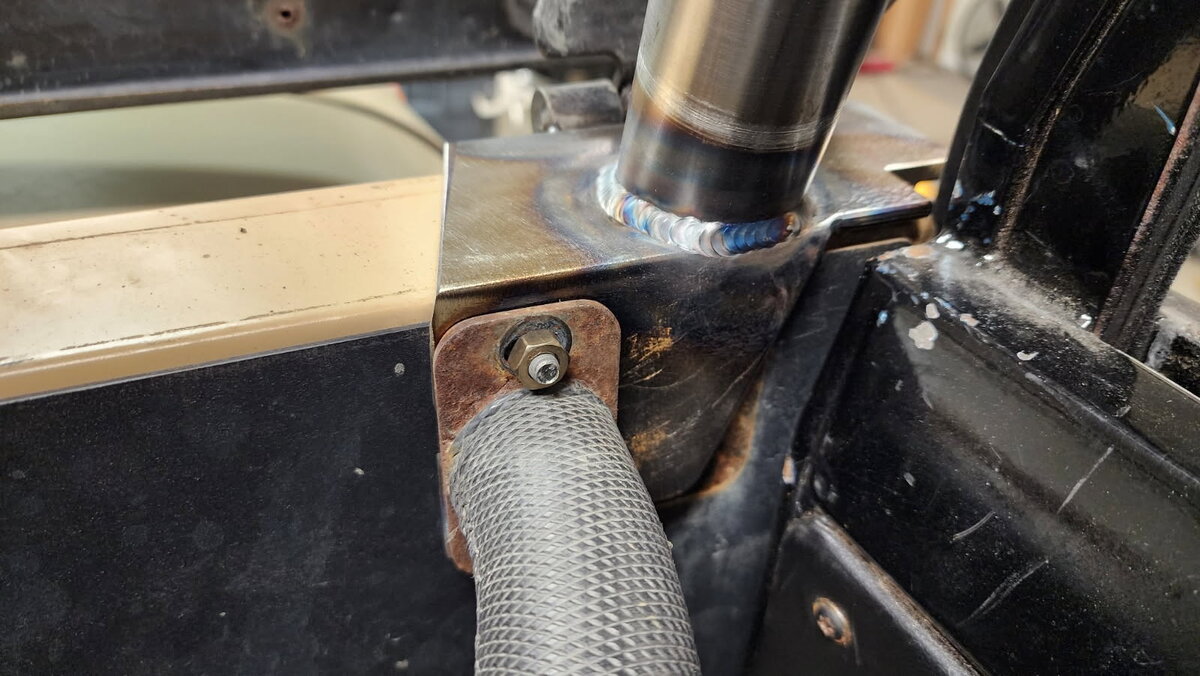

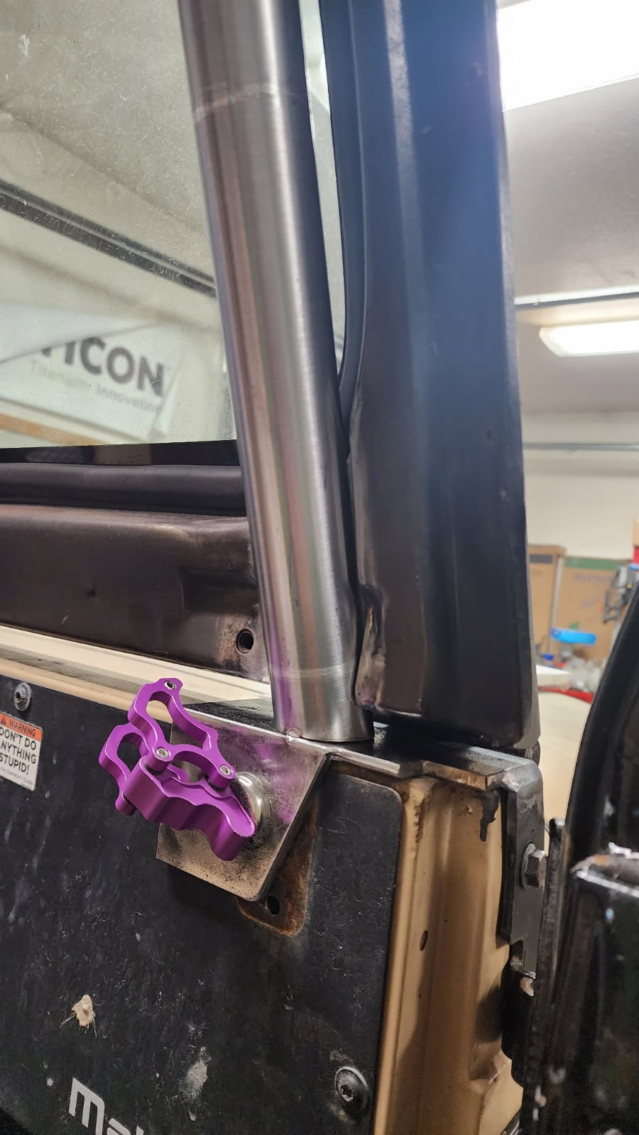

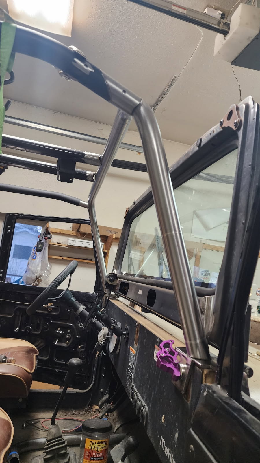

Front hoop is redesigned and complete to fit the CJ/YJ windshield frame. Windshield frame is frenched in to contour the cage. Used DOM steel, she is plenty strong and ready for a roll over. Doors are fit. Passenger grab handle had to move over to make way for the door.
