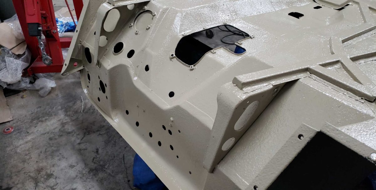

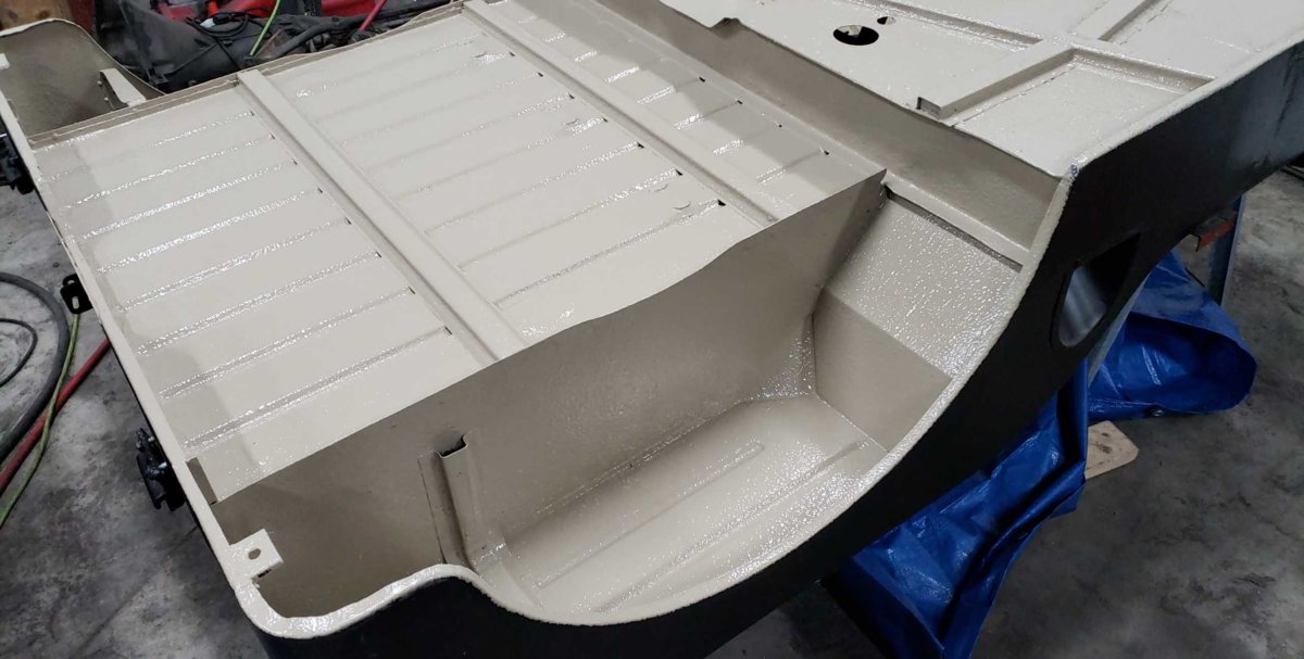

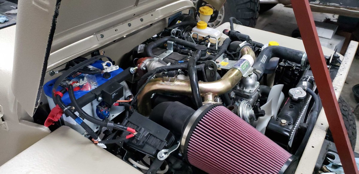

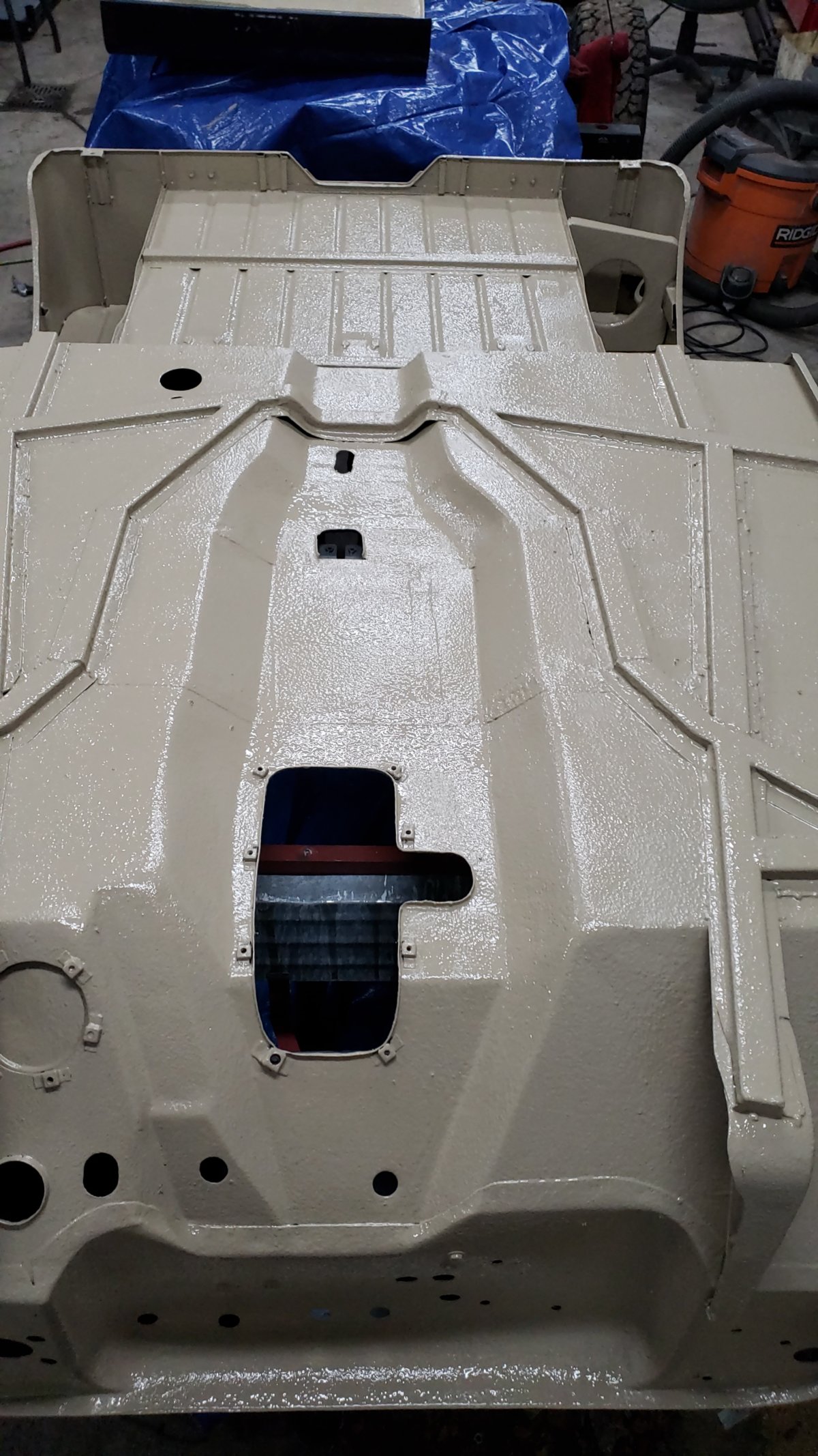

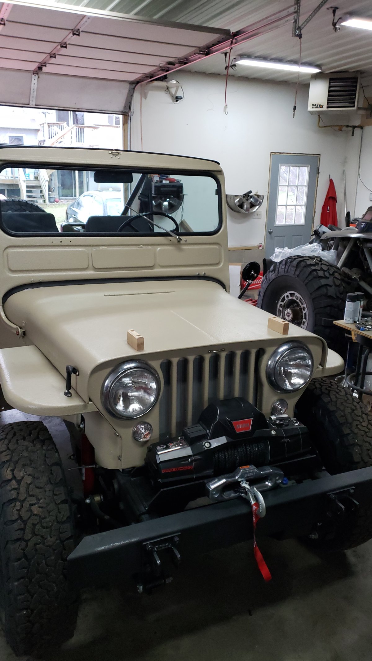

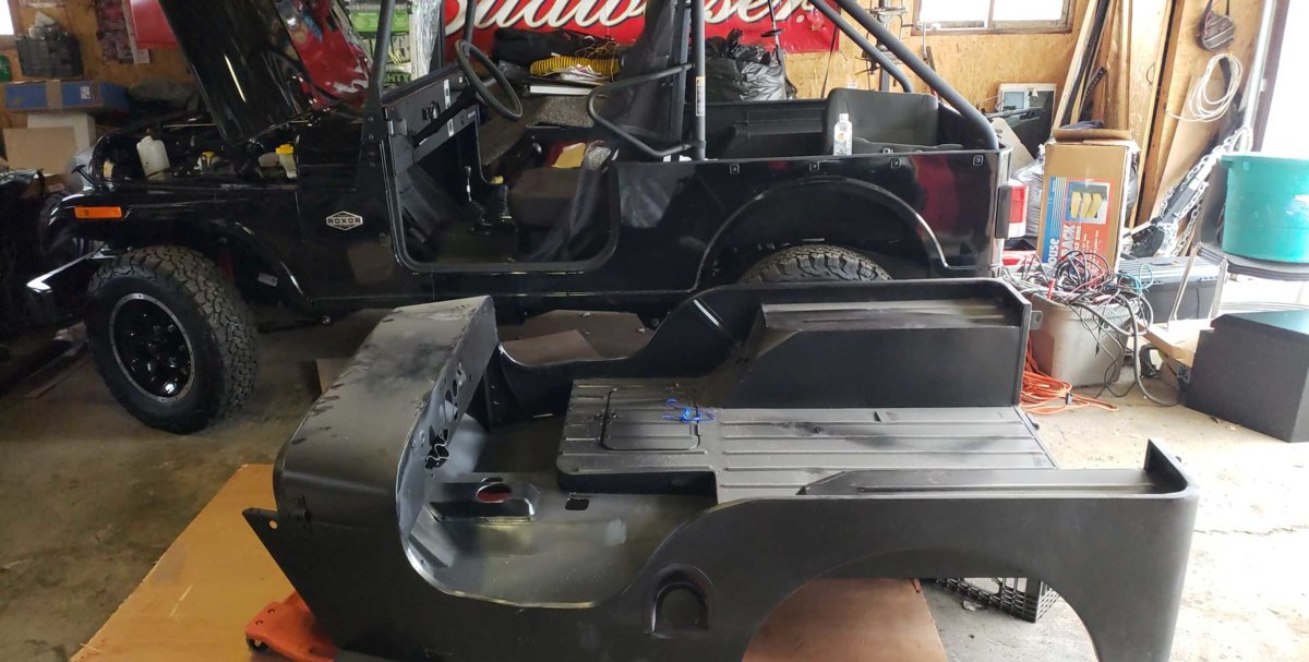

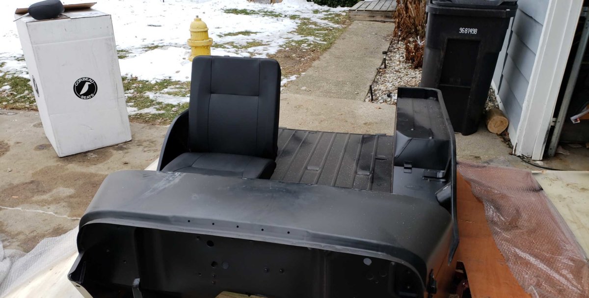

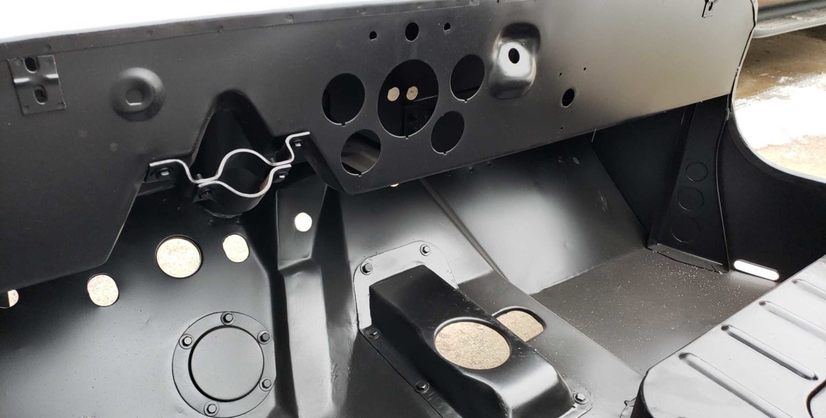

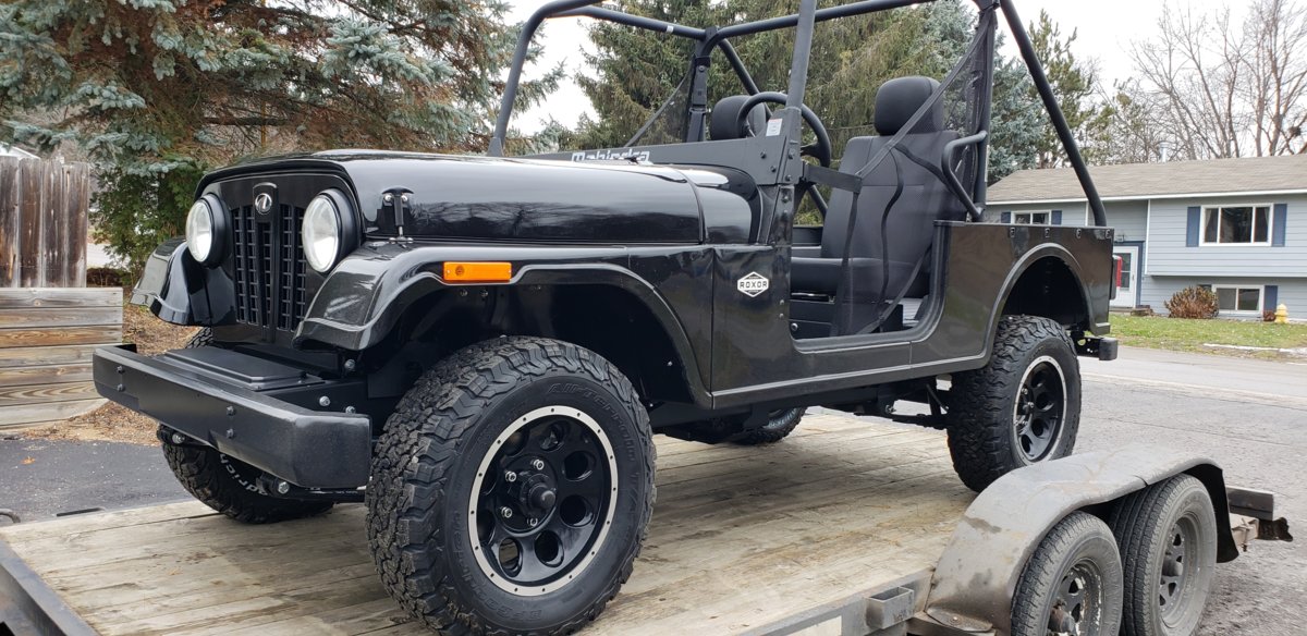

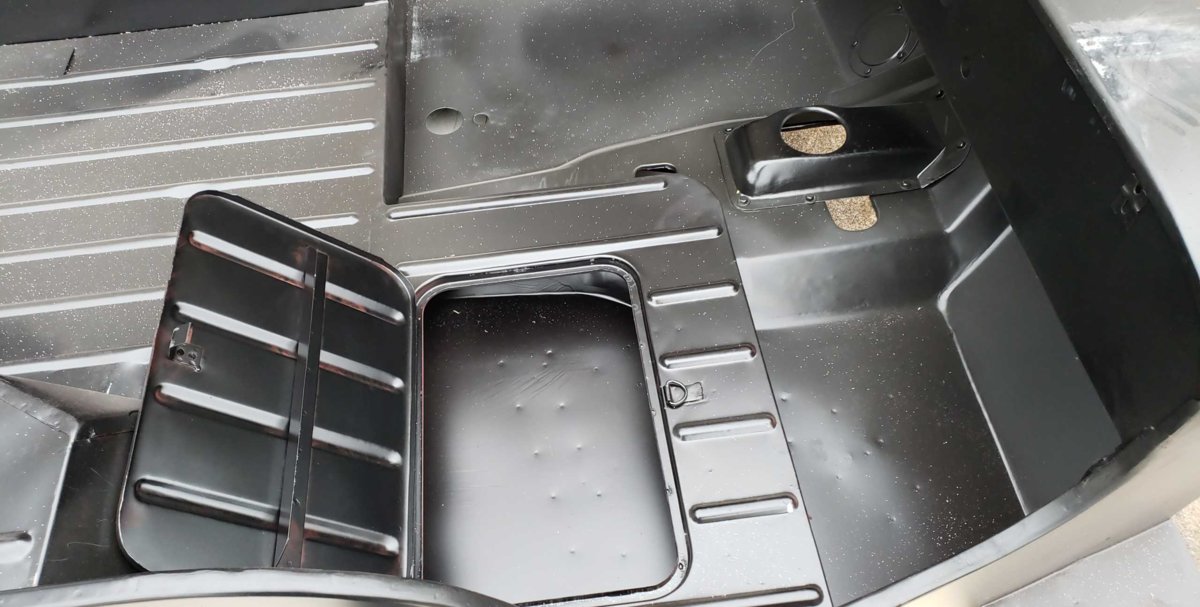

So a customer has a cj3a but wants a diesel version that he can drive every day and go wheeling. So I picked up this base Roxor and ordered a brand new cj3a body. Original style wheels. Egr delete. New taller tires. ECU stage 1 tune with top speed delete. Full blinkers and it will be street legal. Cutting to begin soon. View attachment 2028

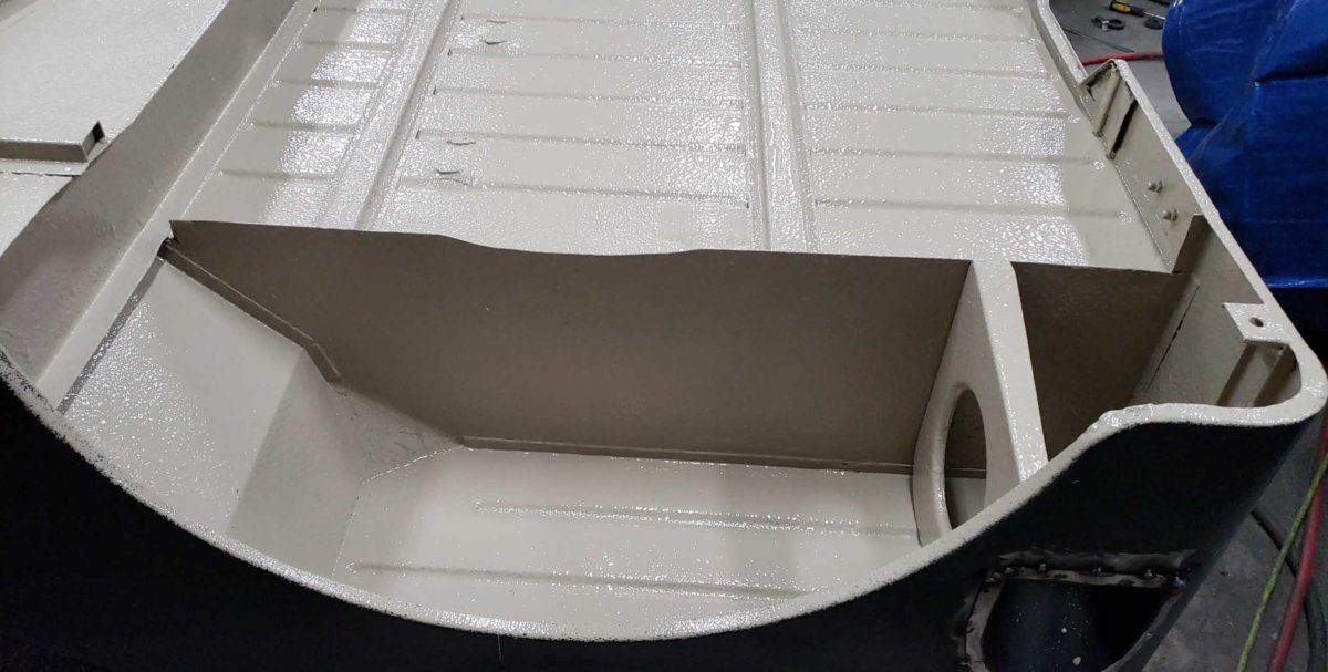

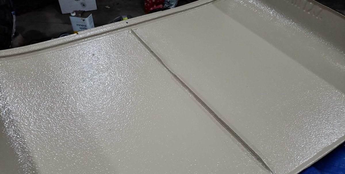

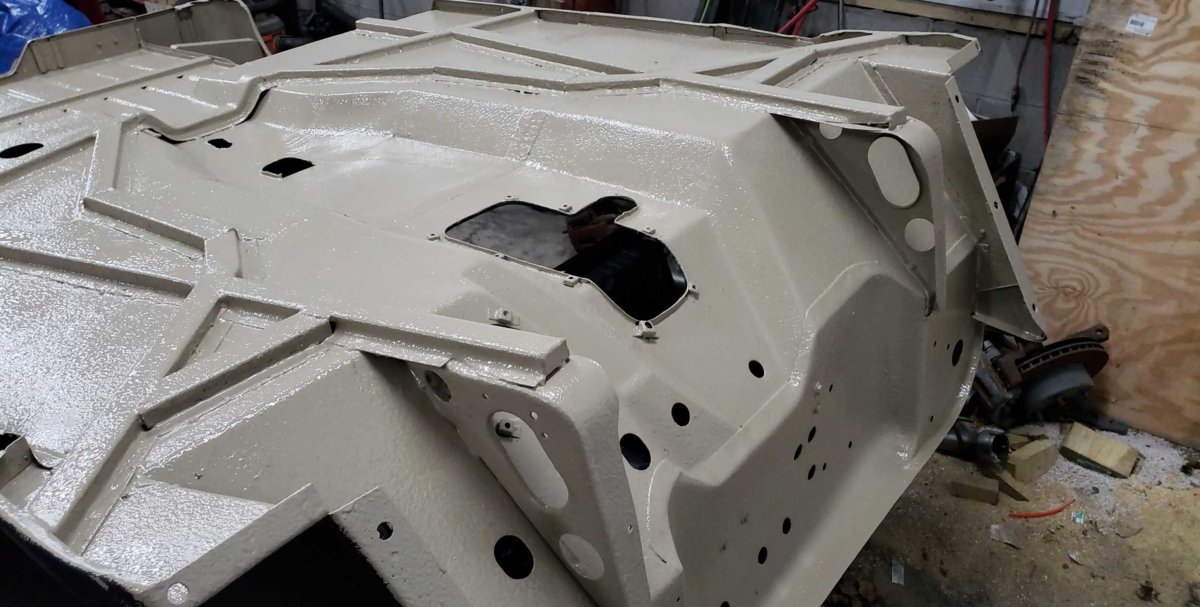

COOL FANTASTIC WORK YOUR ARE DOINGLots of parts showing up this week. Going to start ripping the body off saturday. New tune and EGR delete are in and functioning. 2.5 straight exhaust is here.
View attachment 2164View attachment 2165View attachment 2166View attachment 2167View attachment 2168View attachment 2169
Nice work! What do you plan on doing the Roxor body? I have a great frame of a 64 CJ5 that I would slap a Roxor body on. Kind of the reverse of your conversion.

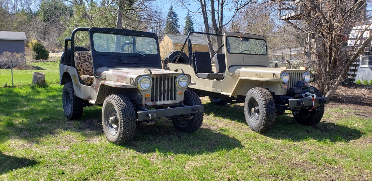

The jeep is all done with a whole summer of driving but we did talk about shortening the frame but we need more room for the 6 foot 3 driver anyways so it was perfectCOOL FANTASTIC WORK YOUR ARE DOING
I SEE YOU LENGTHEN THE TUBS ON THE WILLY'S JUST WONDERING WHAT IF YOU SHORTEN THE ROXOR FRAME AND REAR DRIVE SHAFT. I DID THAT A FEW YEARS BACK ON A F 450 TO PUT A DULLY BED ON IT 10 YEARS BEFORE FORD DECIDED TO MAKE A F 450 DULLY
its actually going on a cj7Nice work! What do you plan on doing the Roxor body? I have a great frame of a 64 CJ5 that I would slap a Roxor body on. Kind of the reverse of your conversion.
Nobody yet has had a clue.Wow! Amazing job on the bringing the Willoxor to life...I think you will fool/confuse a lot of people, as well done as it is.

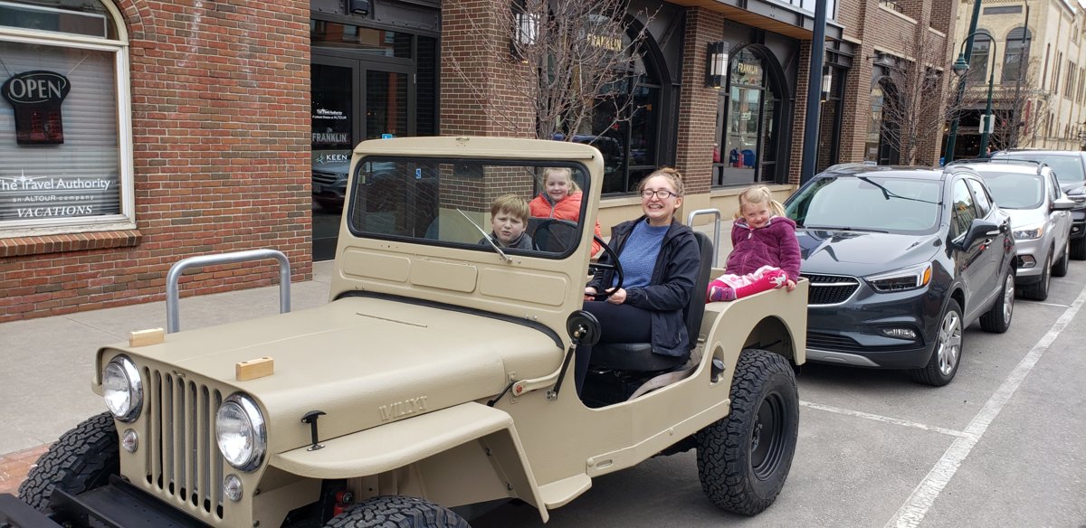

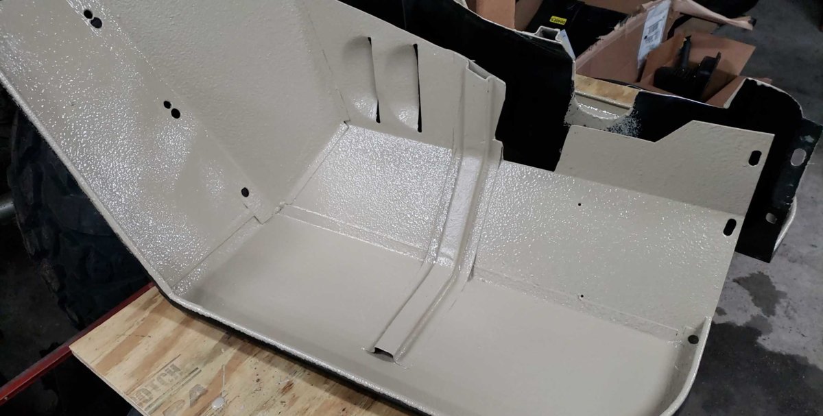

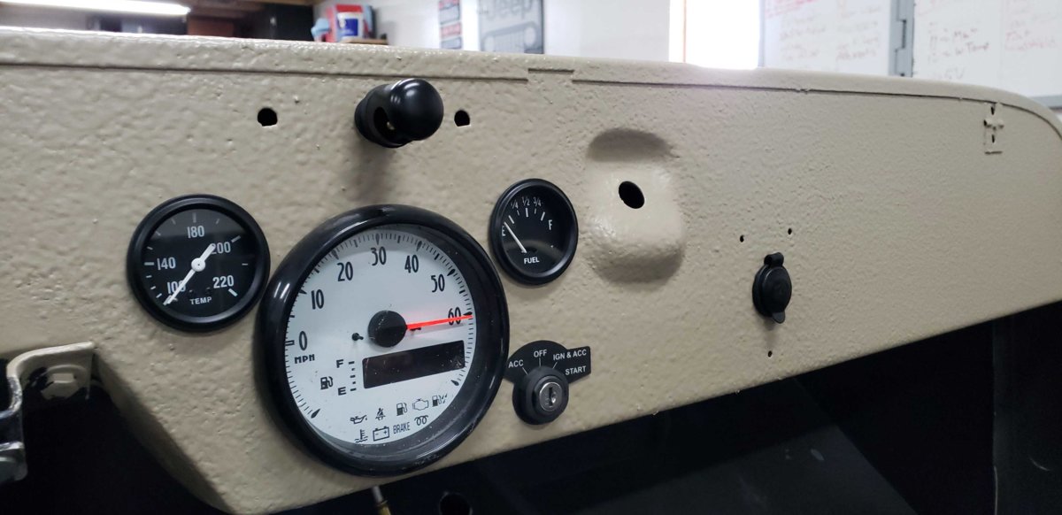

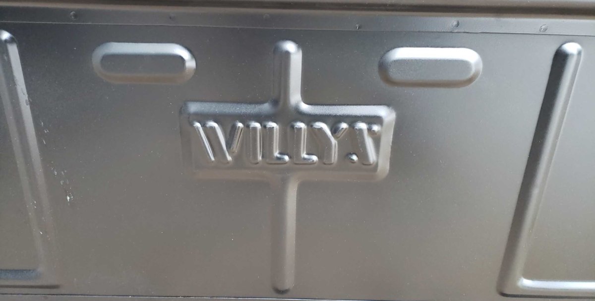

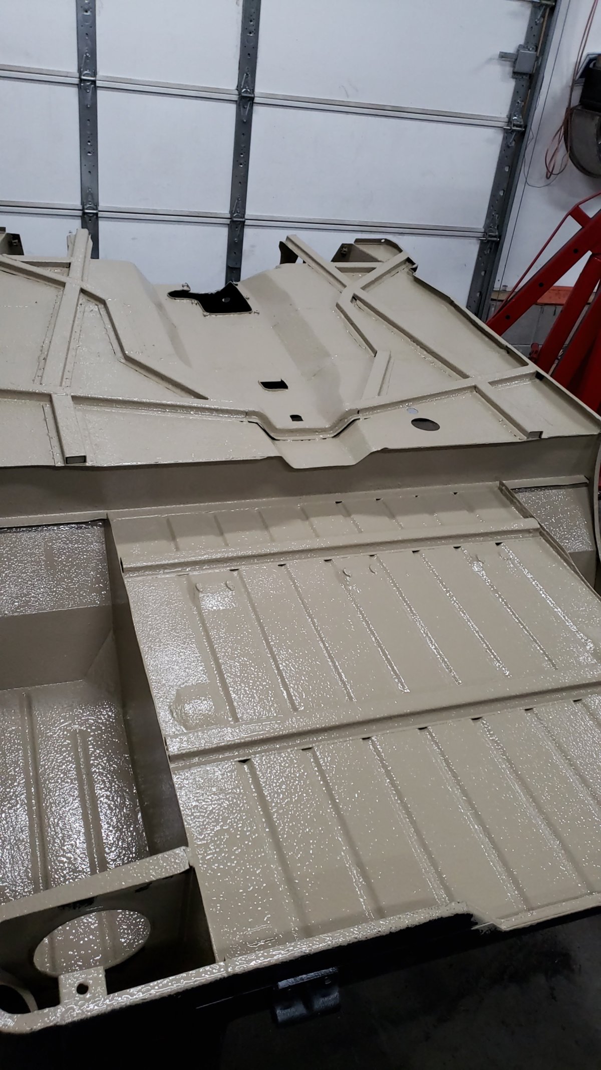

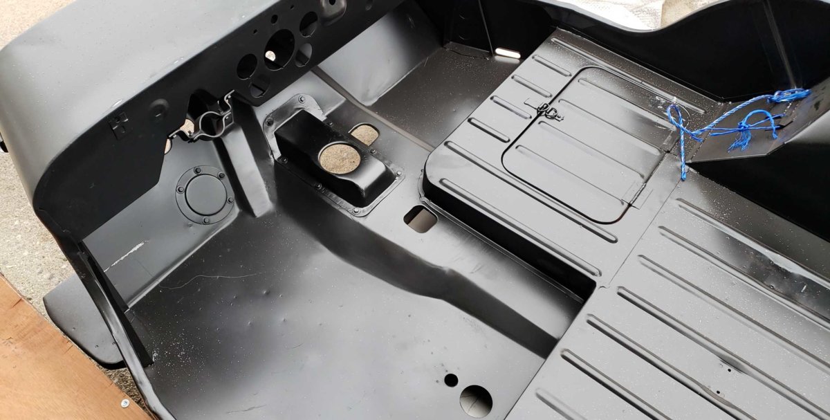

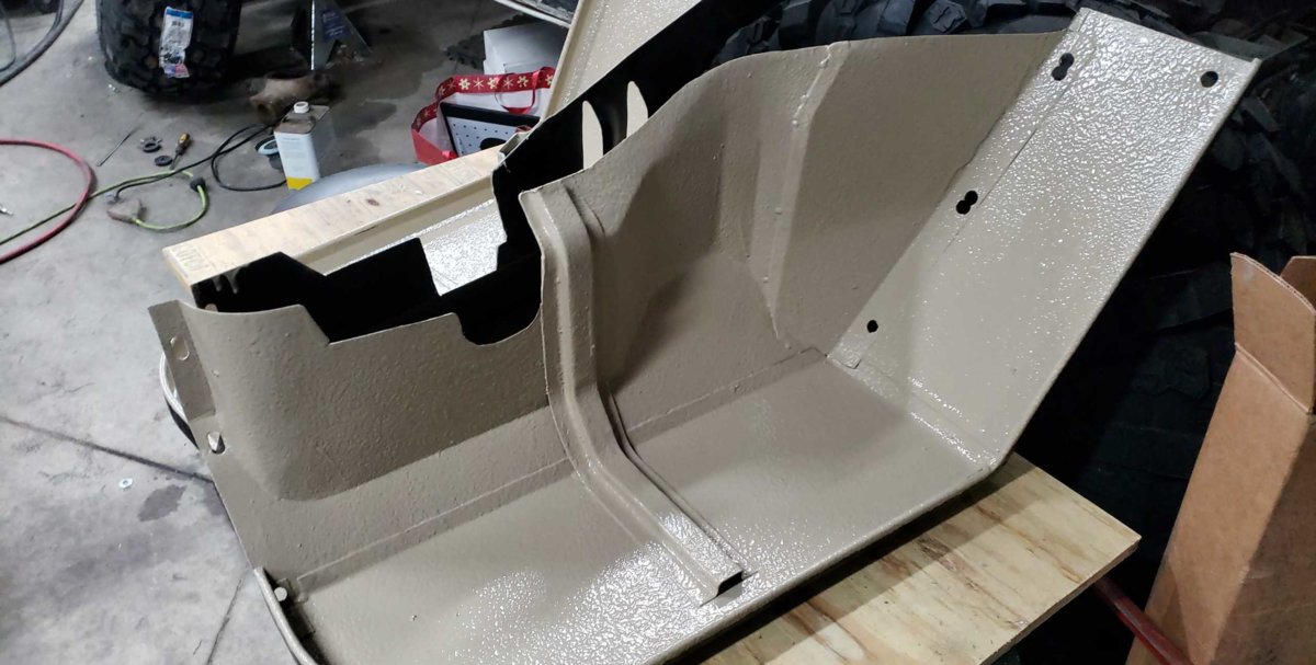

Sorry guys. Didn't realize I left you hanging. Its turned out amazing. Bade a little roll br for it. A soft top. Dropped in the chromoly shafts 30 spline front and rear with the full floater rear along with 4.10s and elockers. Thing is really fun to drive. Has like 6000 miles on it now. As always anyone is welcome to message me with questions. I will do my best to help. Now for some pics
