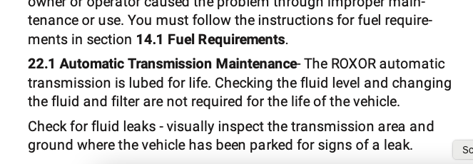

Bought new 2019 Roxar AT about a year ago with automatic transmission.. What type automatic transmission fluid do I use? Are there any compatible brand name fluids than the GL-4-SAE 80W90 listed in the manual? I suspect this may be for manual transmission??? The folks at O'Reilly didn't know..Its a 180mi round trip to the dealer I bought from..I would like to order online maybe Amazon. TIA
Why do you need fluid?
It will not be the same fluid as a manual, that's for sure.
In the manual it says that transmission is serviced for life. That kind of makes a person wonder. lol

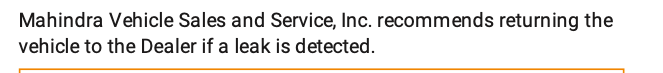

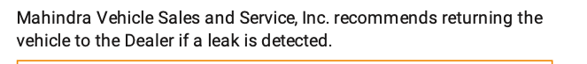

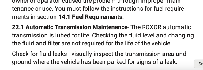

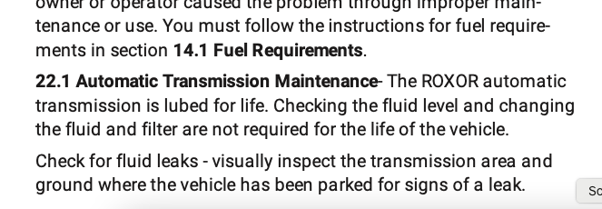

View attachment 8633View attachment 8634
View attachment 8633 View attachment 8634
Yep..but the service department where I bought it apparently did NOT perform new vehicle service check when I bought it.? Dip stick barely shows any transmission fluid at all..Took it out for about a 10 mile run when transmission started making noise..checked and found very low..Now to find some comparable automatic transmission fluid to fill it up..

If there is problems with it, Roxor warranty will not cover it unless the work is done by the dealer. Just a heads up. If you take it to the dealer and the transmissions toast, Roxor will replace it under warranty, but only if it is done at the dealers.
