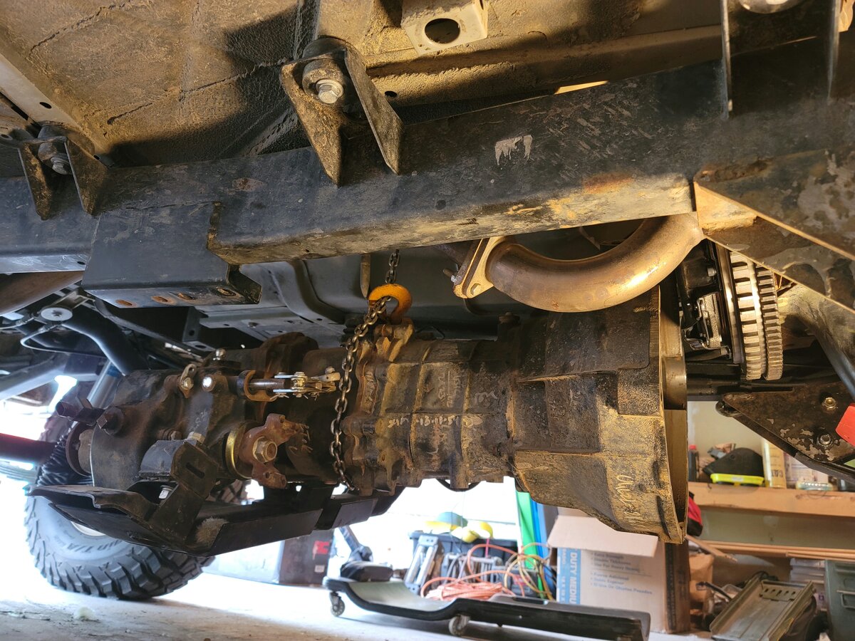

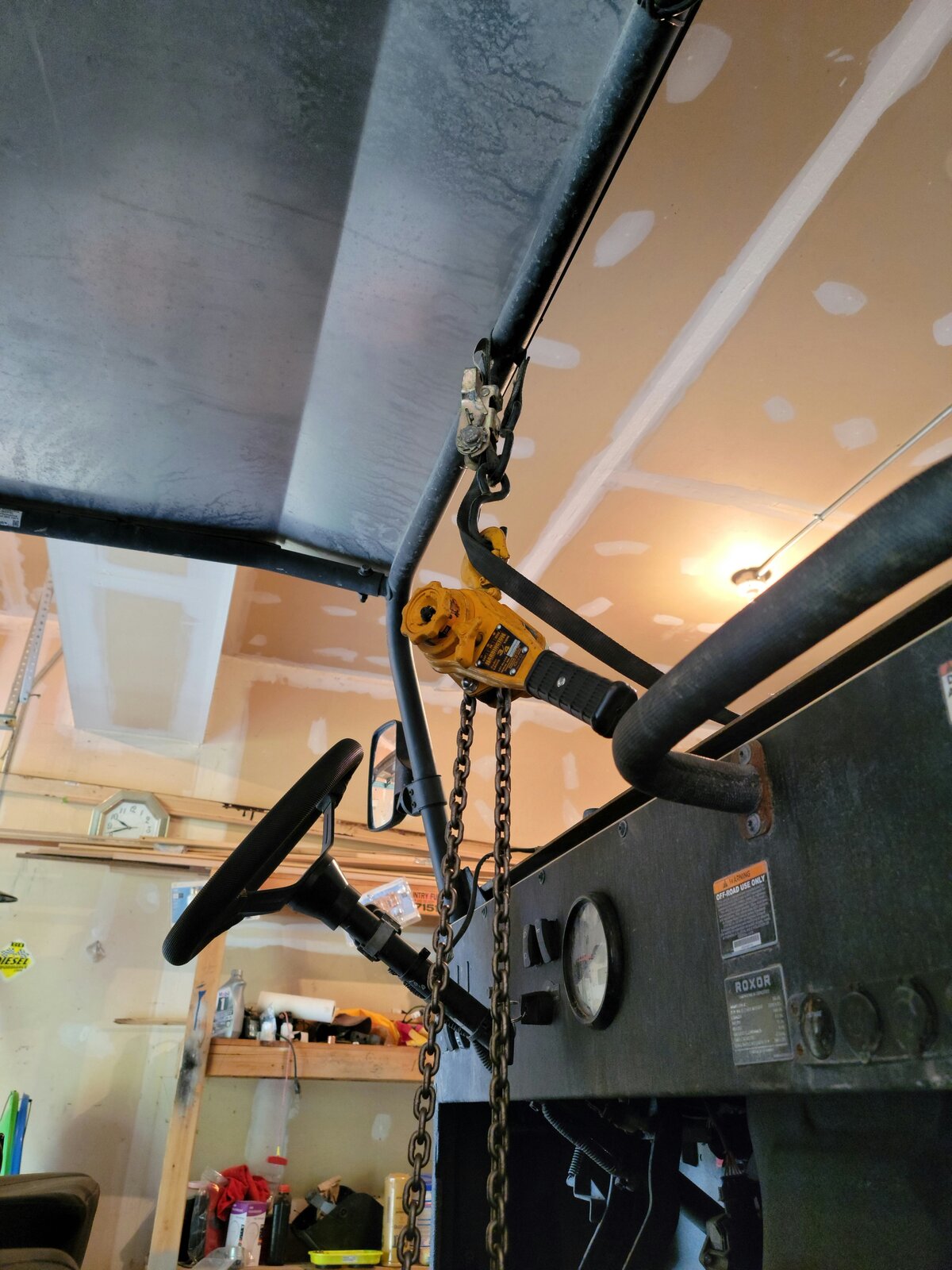

Finally back home. Time to get this thing back in. So much easier this way than fumbling with a jack. Took about an hour and it was in.

@Colderweather86: nice to see that suspending the transmission works on the Roxor. I watched a video recently where someone did that exact same thing on an old, old Jeep.
By suspending the transmission, is there anything you did not have to remove compared to dropping it on a jack and rolling it out from under the vehicle?
709
No. It was all the same components. I took it out with my floor jack. It was much much easier with the chain hoist.
