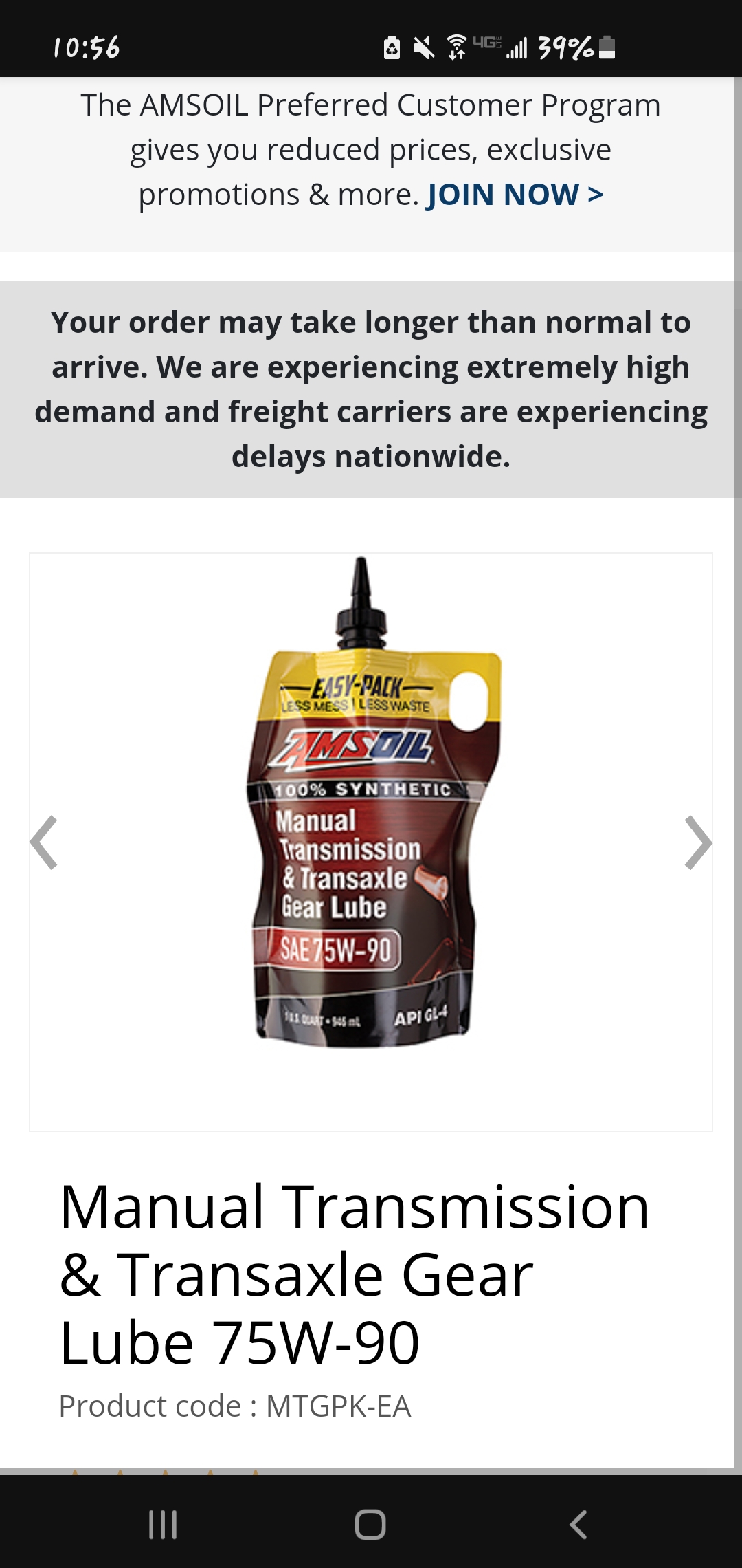

Amsoil sells some of their product in squeeze pouches. Great idea, I think. CJ2ROX and the othee Amsoil guys on here can provide more detail.
809
If you go amsoil they have containers you specifically buy that don't require a pump. Actually quite genius. Hate dealing with pumps, less waste and less messy
