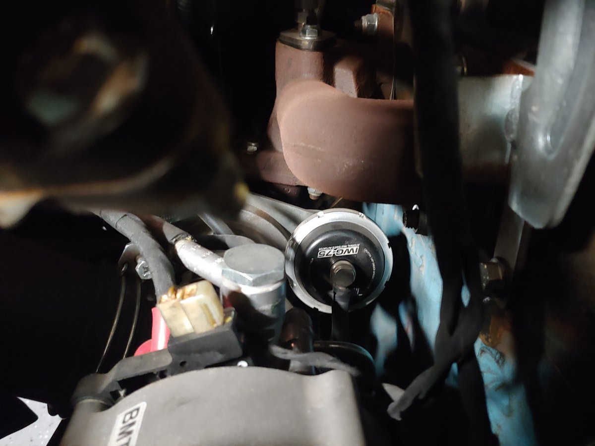

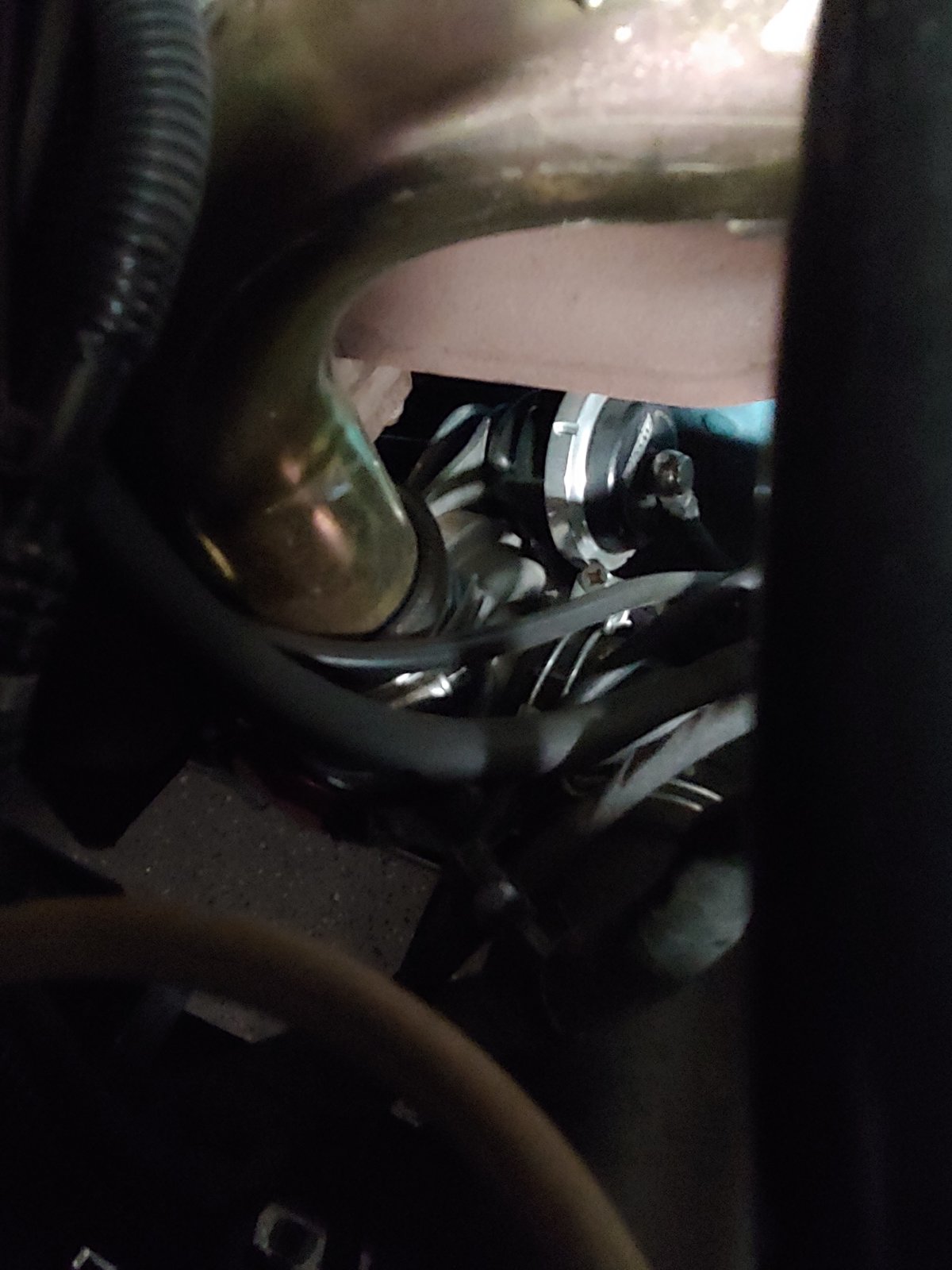

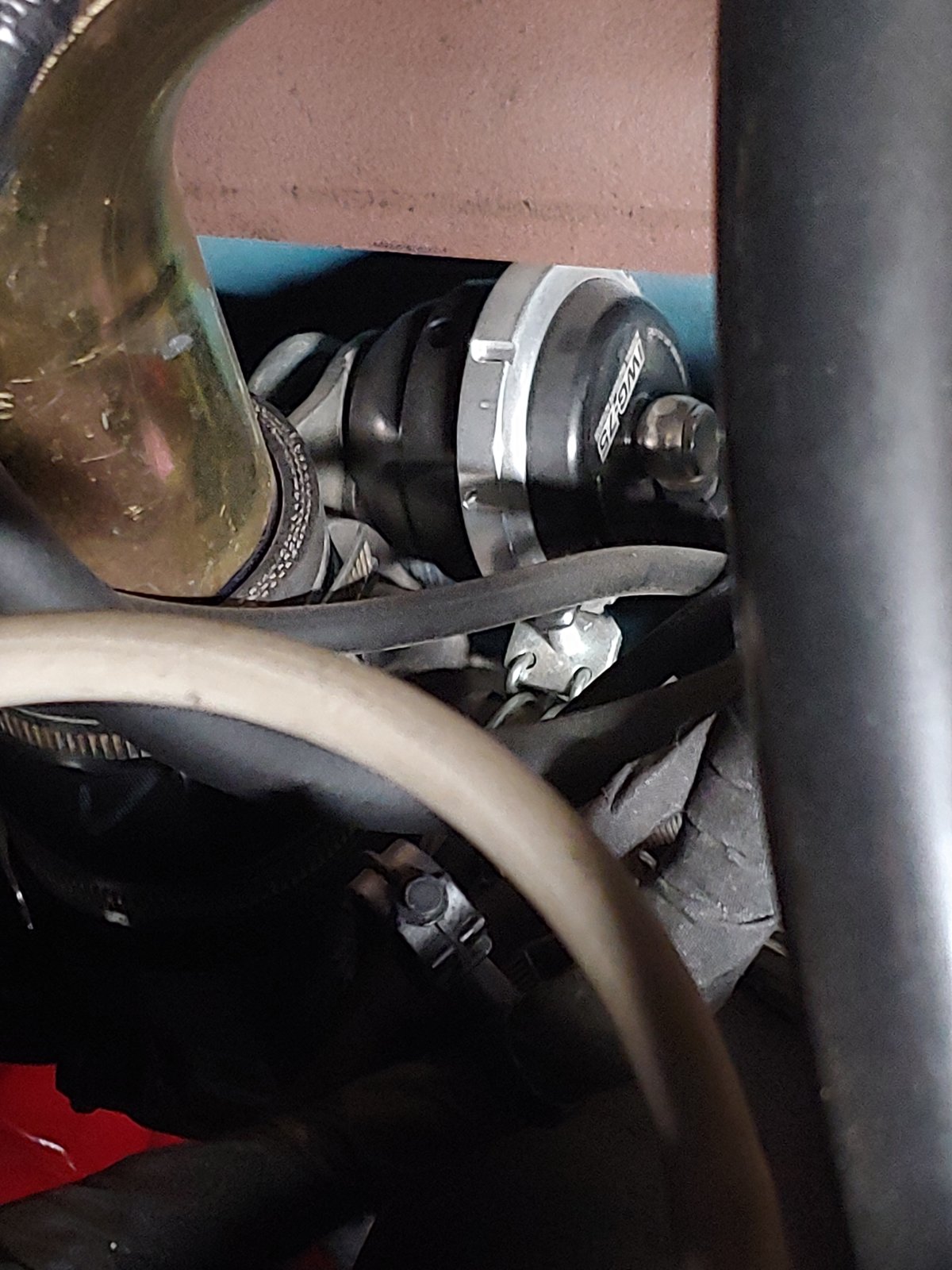

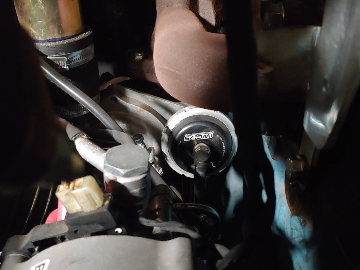

Sure, I will take some in a little bit, let me know if there's anything specific you want a pic of.

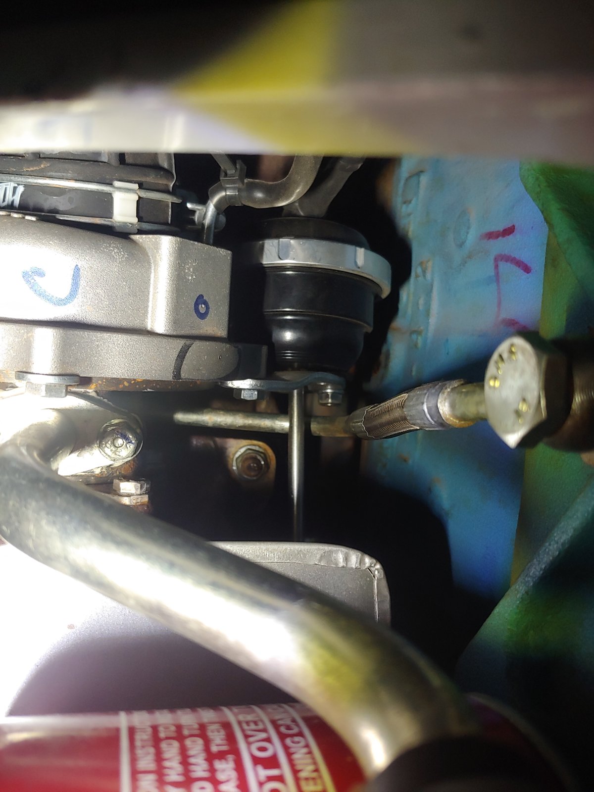

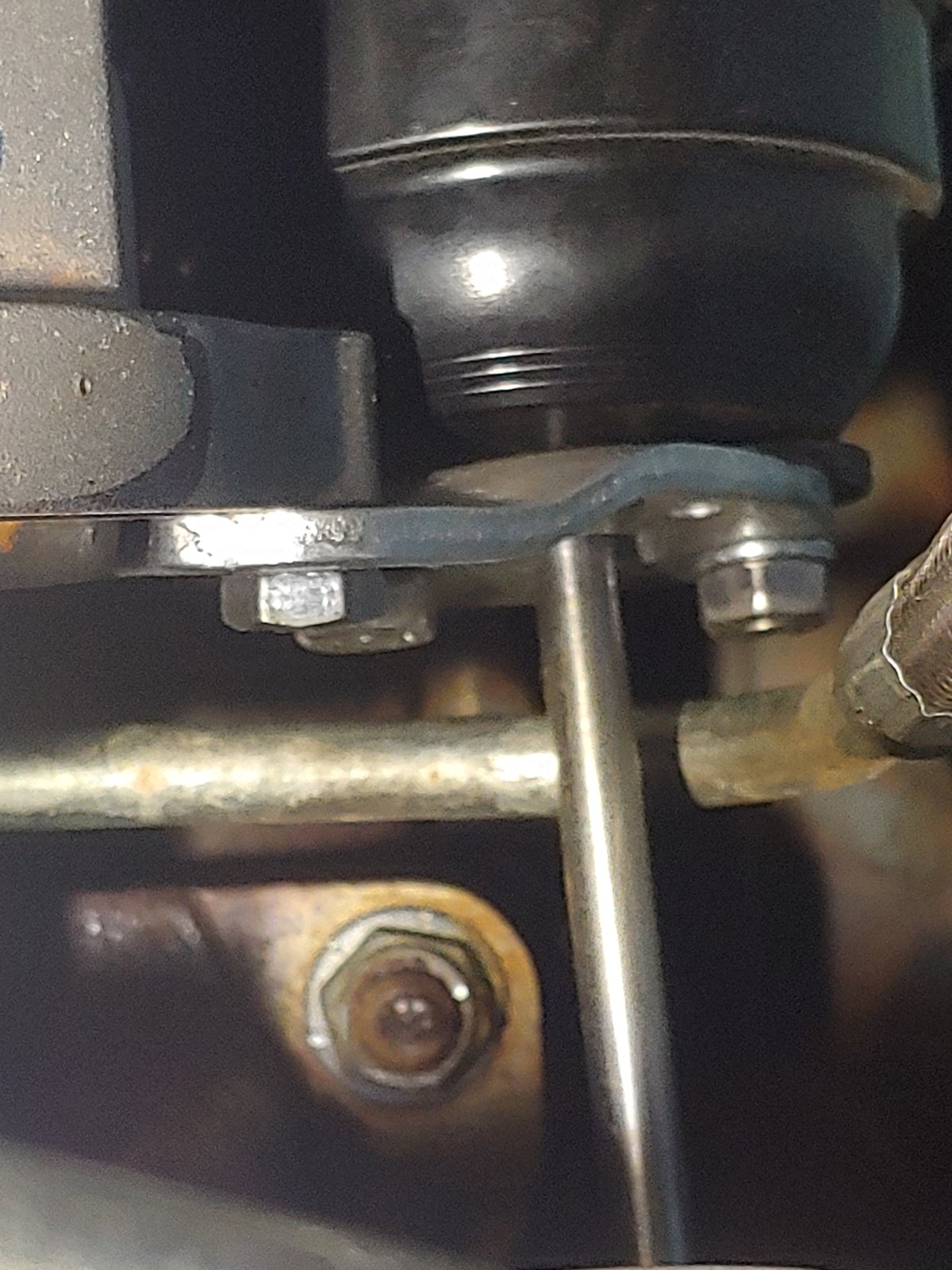

Just looking for a way to connect it to the turbo. I bought the universal iwg75 7 psi wastegate actuator. The back rod is much longer than the stock wastegate. I don’t have enough thread on the rod to move the lock nut far enough forward to connect it.
2,272
Ok, Ill take a picture of the back of it and post it. Sorry for the confusion.

1686

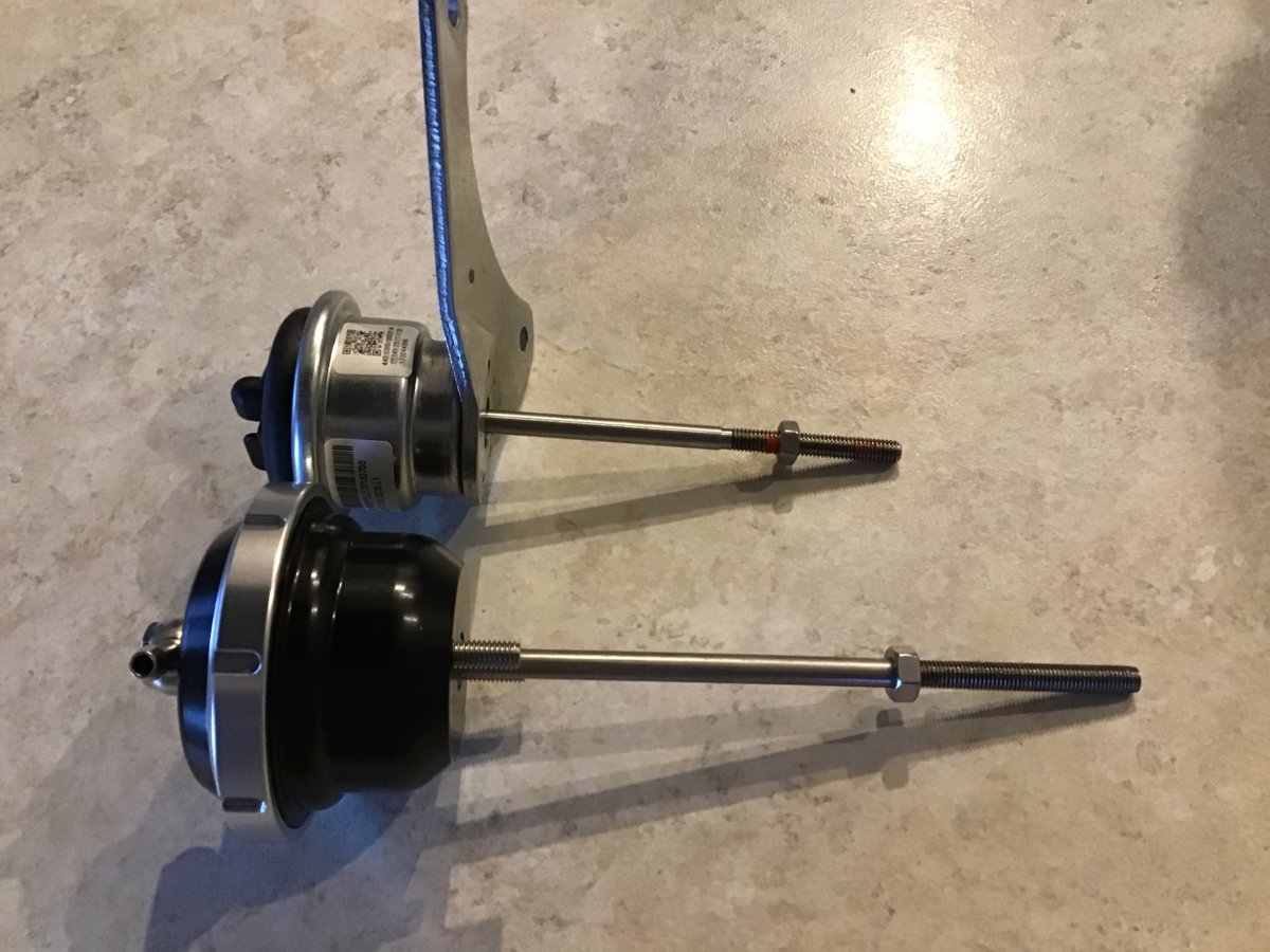

I did the same as for breaking the nipple off. Mahindra will only sell the complete turbo unit and its approx $400.00. I ordered a real nice aluminum one through WISH.COM. Cost $13.00 shipped. It is adjustable. Really son of a gun to take off. I had to remove the oil shroud in which wouldn't go back on when re assembled. Before removal I marked the threaded shaft with a sharpie for measurement After removal of waste gate, and yes the metal clips will drive you crazy on threaded end. I had to cut the round holder with a nibbler to match the diameter. I used large washers and drilled for mount. Measure the marked thread and install nut. Reinstall. Takes fabricating but I installed a boost gauge before running engine as to monitor the pressure in case of adjustments. None were required and I have a wonderful 16psi. Also you can hear the boosted turbo from the exhaust, and did make a difference in power. Took about 3 hours and a lot of cussing and a little blood, But that's what being a diesel mechanic is all about. Keep on rollin

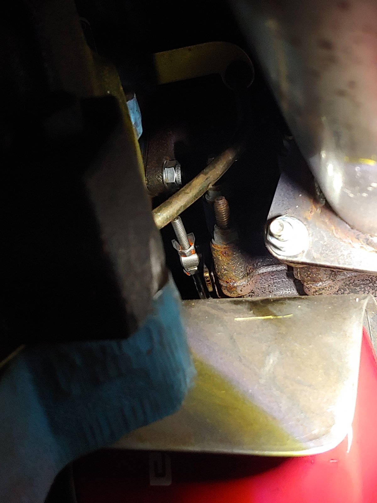

Sorry for the delay, here is the reverse side. Part of the rod is threaded and I tried to get as good a pic of the fabricated plate as I could. I hope this helps some more.
