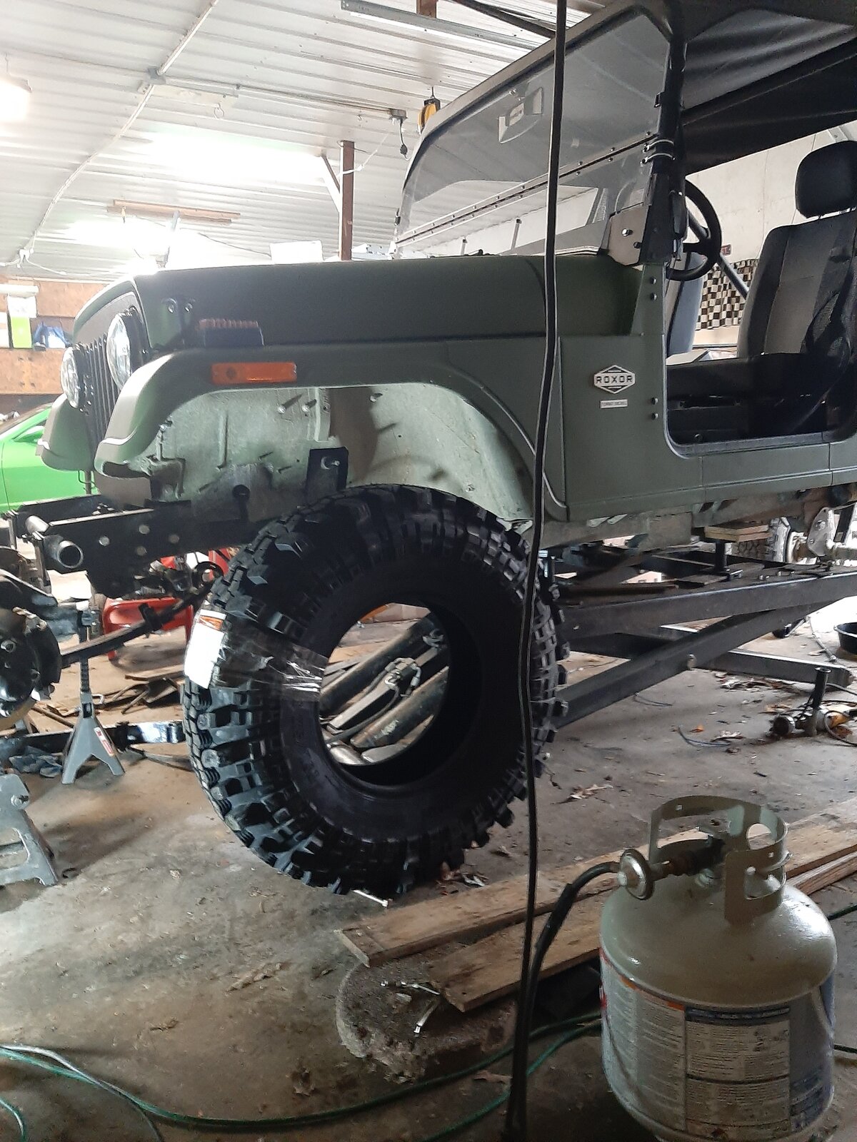

Then as I'm trolling forums I learned that "the blem list" is a thing. I really don't mind buying off road tires that are scratched or whatever. I'm gonna do way worse to them anyway. My welder should be available next Sunday for the long travel kit so maybe next Wednesday I'll be hitting the trails, without a winch, by myself. Probably leaving the dog at home for this one.

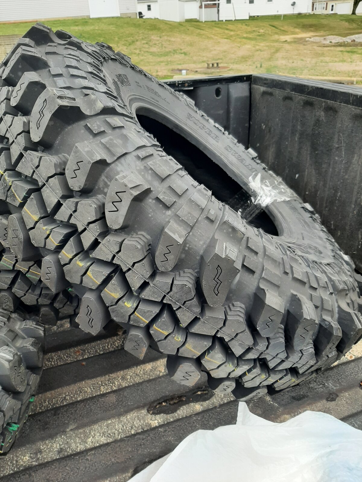

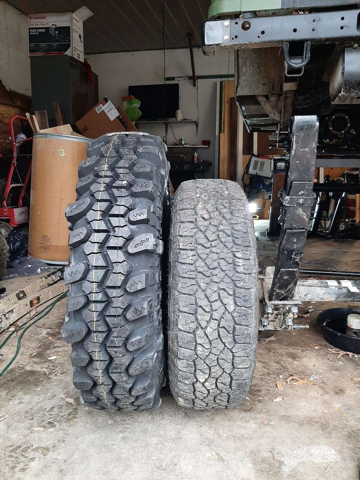

So I start scrolling through intercos blem list and wouldn't you know it, they had 4 TSL SX-II 35x10r16 on the blem list for $100 off retail. The tire is discontinued but they had 4 left! WHOOOOOOOOOOOO!!!! 35s baby! Gonna get that diff sky high!
