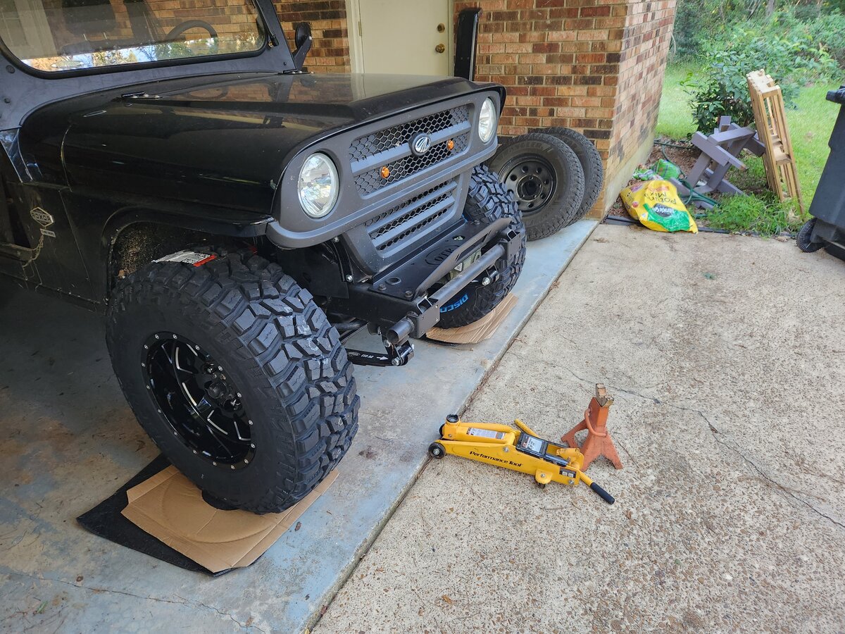

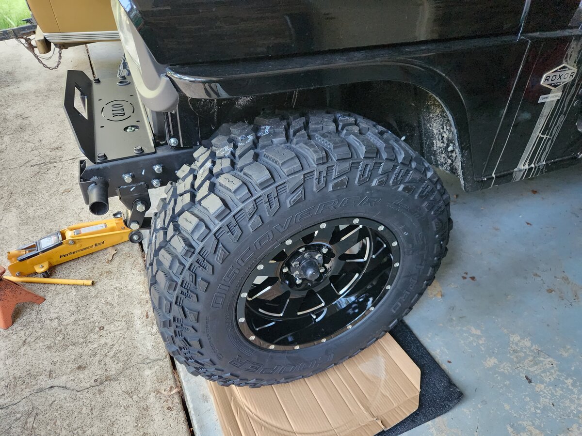

I have a 2022 with 35 inch tires with 2 inch spacers and no lift at all. I don't rub with normal driving but I do rub just alittle when on trails. If I had 33's it would be ok I think but soon I will add the 1.5 inch lift all around and will see what that does.

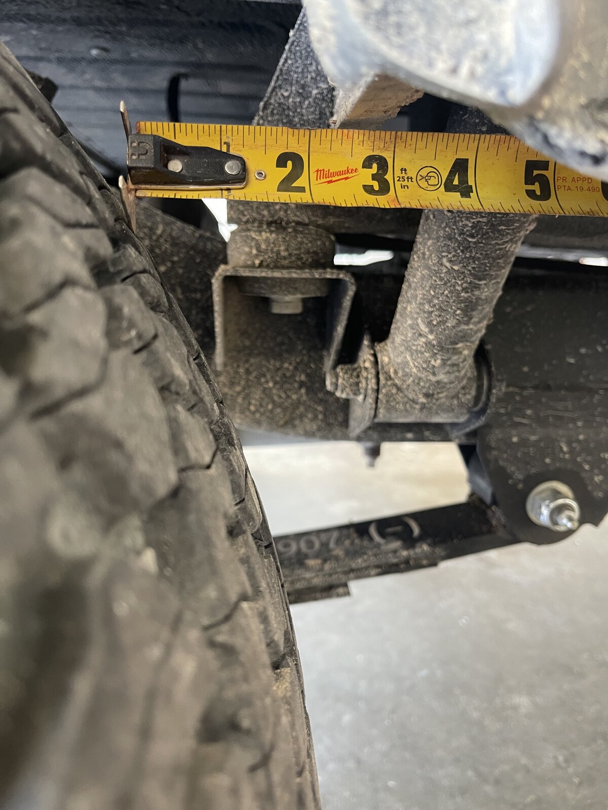

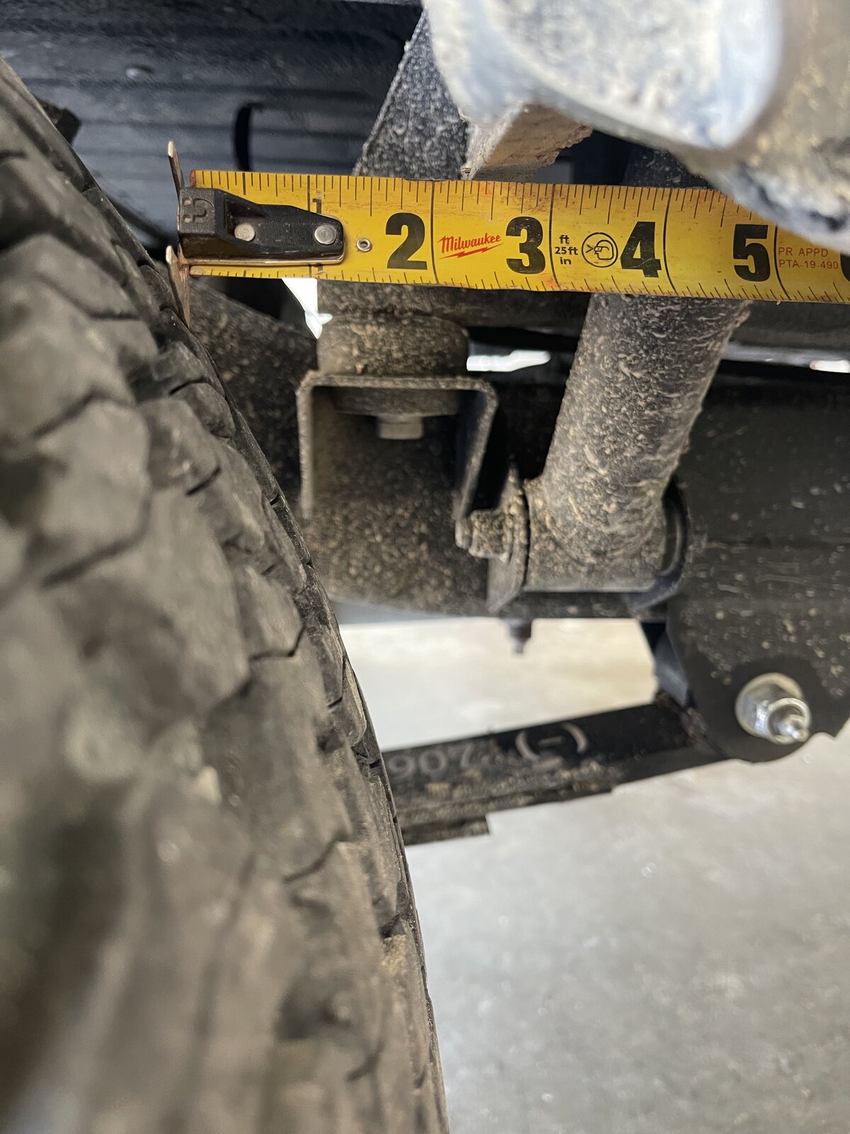

Were the rears close on the forward edge of the wheelwell? Do you happen to have a decent picture of the clearance you have?

It’s got about 2.5” with the leveling kit on. It was closer without and got pretty close to rubbing a few times before it was installed. It’s even closer to the outside of the wheel well
