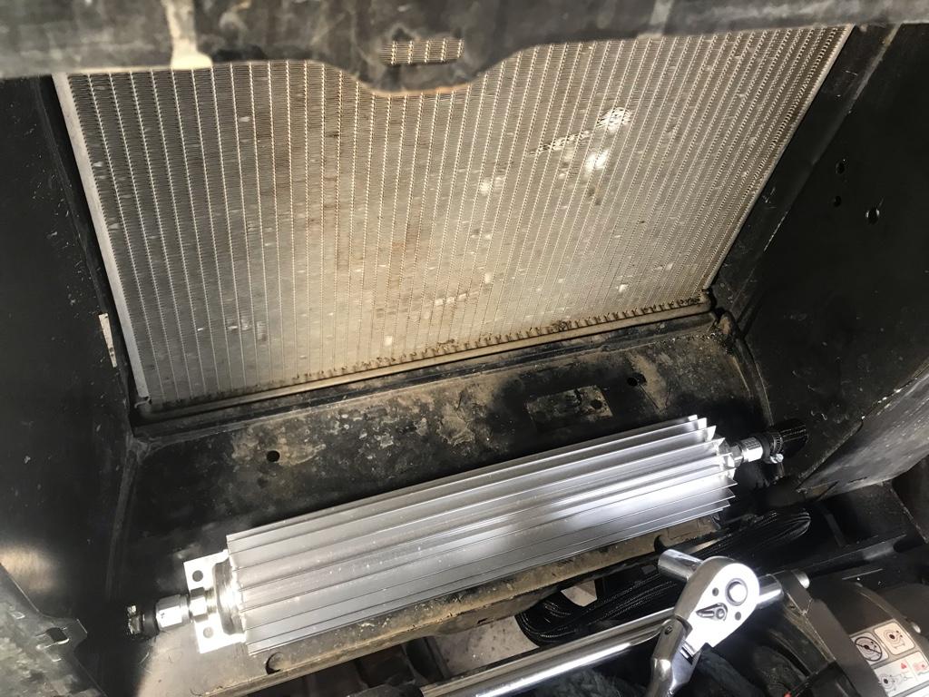

Lines run for the box. I need one more fitting to complete the system. That should be here today. The cooler fits nicely behind the grill. There is room for an inter cooler should I decide to go that way in the future.

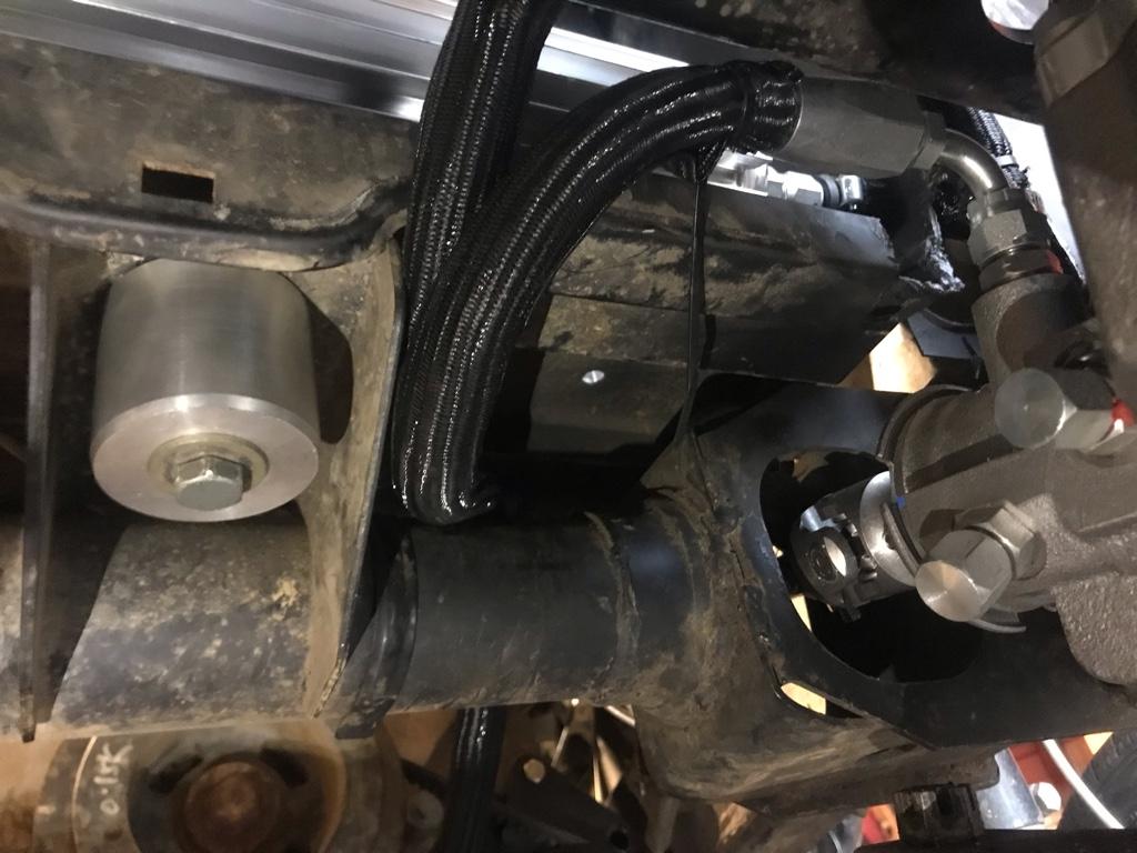

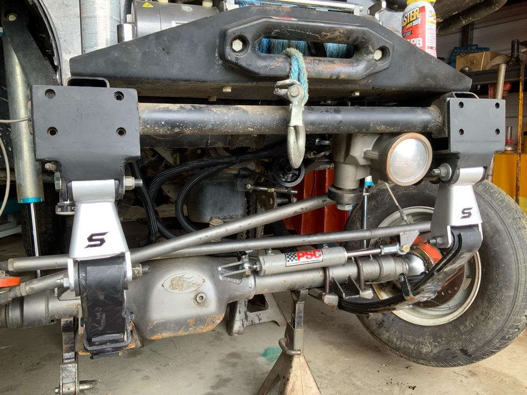

Hydraulic assist steering is done. It works wonderfully. It will turn my 35s with one finger sitting still, yet still give wheel feedback for a non tractor like driving experience. Worth the headaches and many, many pennies.

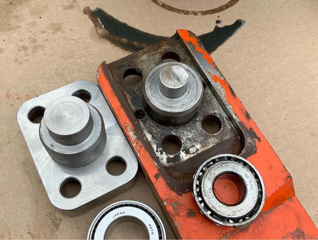

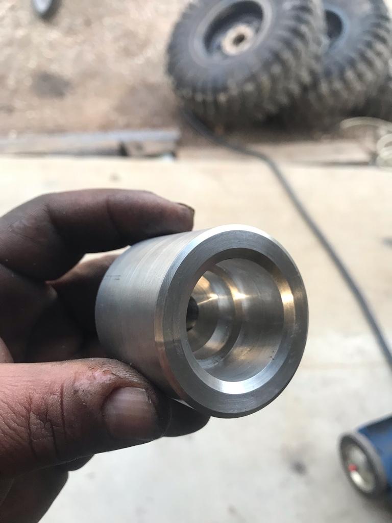

I had to replace an axle seal so I figured it was also a good time to upgrade some other parts while I had things apart.

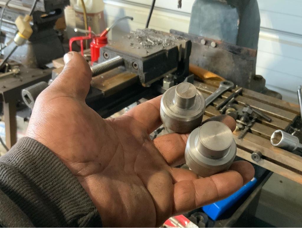

Upped the king pin size from factory to about an inch pin on both top and bottom. Also installed ARP studs for piece of mind. I think the housing is my weakest link now and it’s not weak at 1/2 an inch thick tubes.
Factory vs the new pins and bearings.

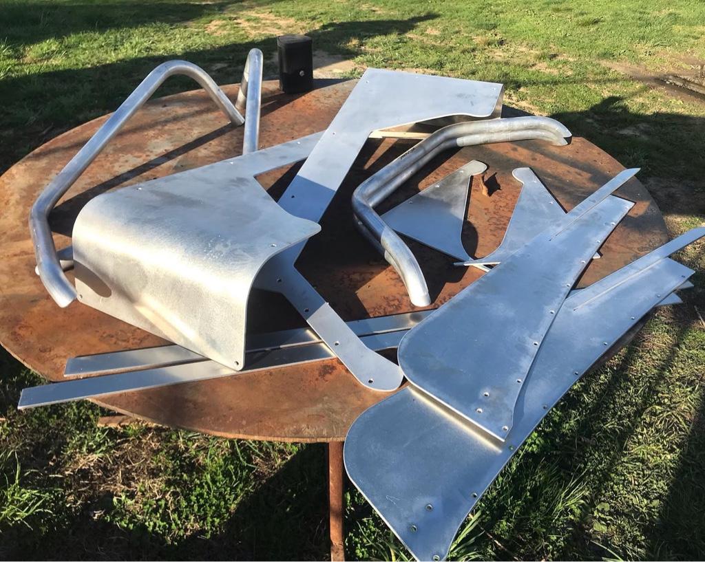

I had something super freaking cool show up today!!! I asked on On The Rox if they were able to make a set of custom aluminum fender armor kits to replace my steel set and they delivered! And quick. I can’t believe how fast they were able to switch gears and get these things pumped out for me. Made to my spec, .250 wall tubing and thick 3/16 plate. Now I need to practice my aluminum TIG skills before I touch these babies.

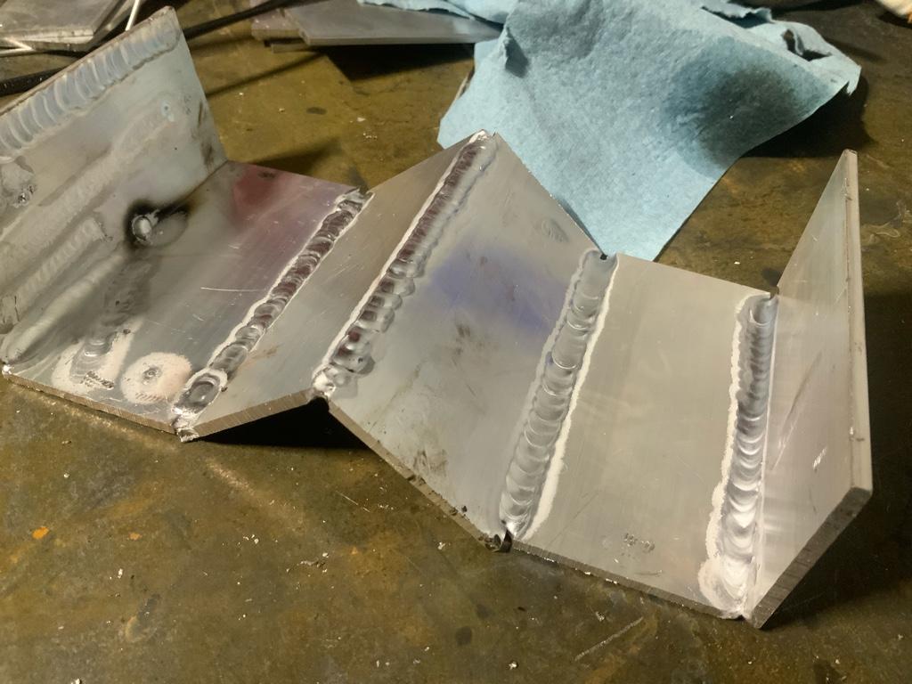

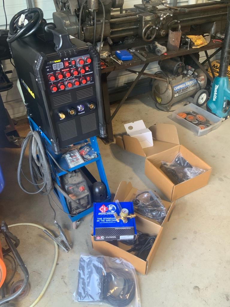

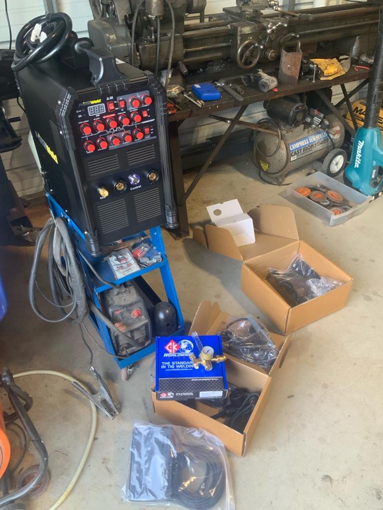

Welp got my first tig machine in the mail today. I think I’ll be hiring someone to get these fenders done. There no way I’m going to progress fast enough to get these things looking good for my Moab trip in a couple weeks.

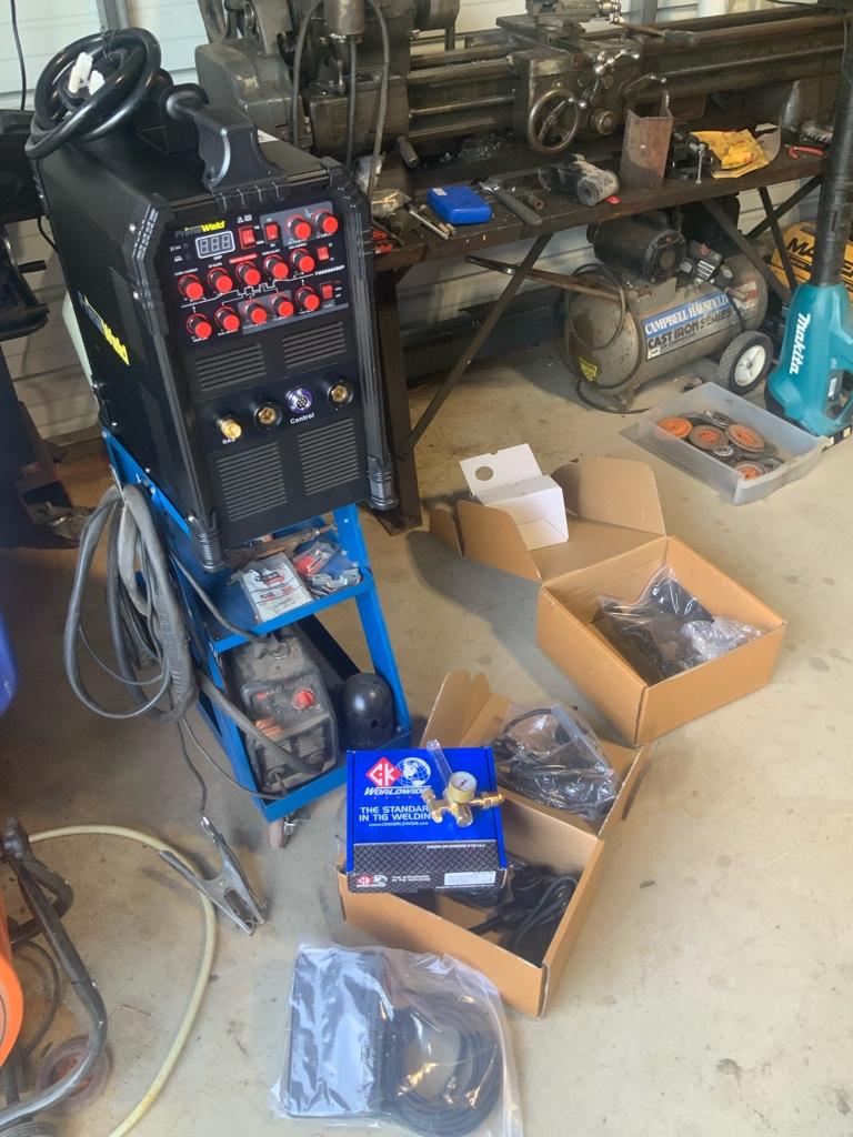

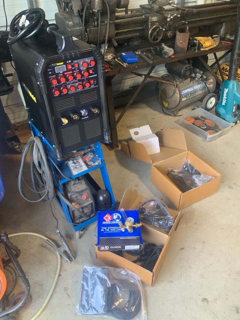

How much aluminum have you ever welded Max? If you just started with Aluminum, it's not awful bro. If you been welding aluminum for years, I'd say yeah.... probably outta hire it out.

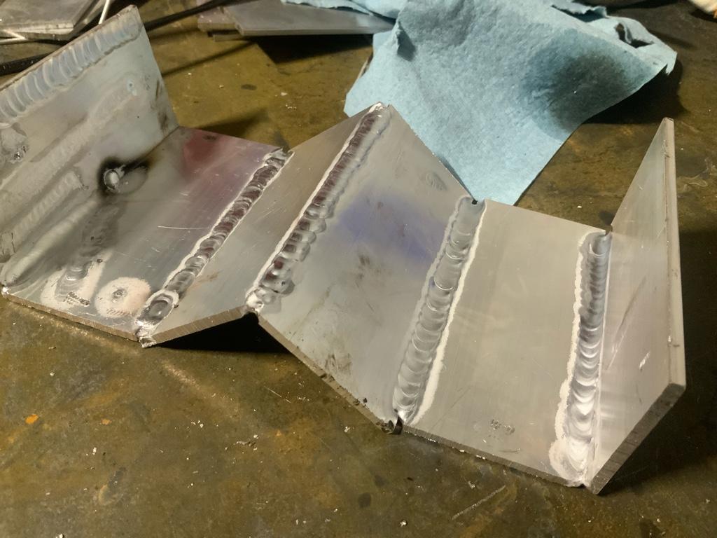

First time picking up a tig torch since shop class in high school 15 years ago.

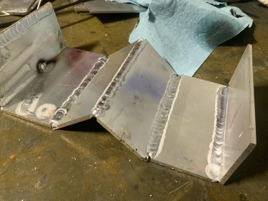

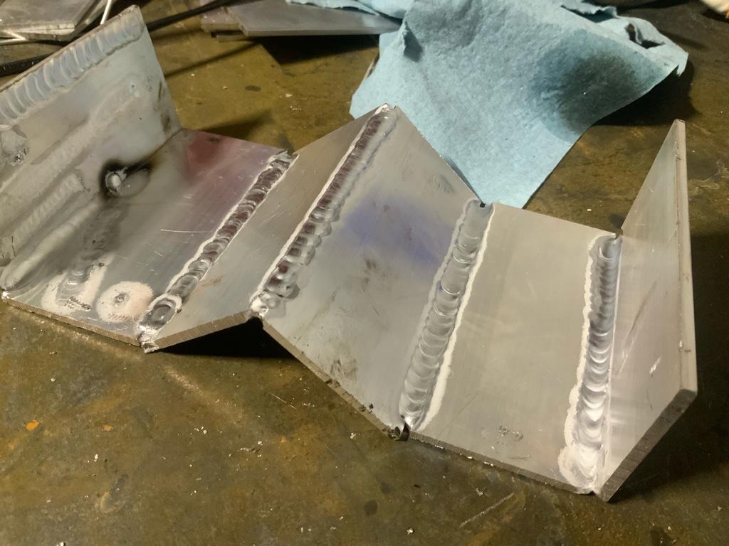

Well bud, I'm a CWI and API Inspector (mechanical integrity specialist) and I'm guessing you may be between 25 and 30.... so if you haven't touched aluminum in 10-15 years, I'm betting you will master that craft in the near future. But for the time frame your dealing with... might outta spring for case of beer, a handle good wiskey, a few large pizzas and get a fellow over to slick it on out for ya. ?
Wow, first time I tried to weld I almost welded my fingers together. Looks great man. ?
