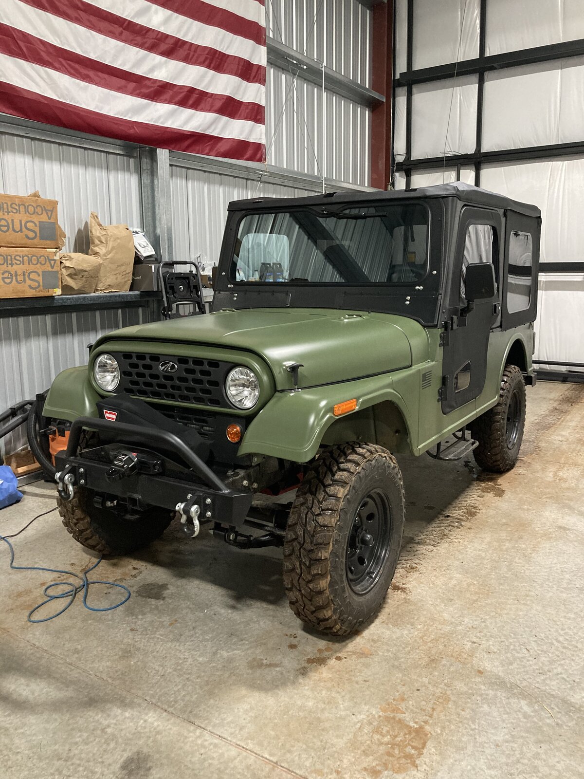

Different strokes, different folks. I couldn’t wait to get the full ROPS so I could install the full soft top for 4 season use as well as provide more safety to the back seat, when occupied (rare). I’m very happy with the oem full soft top.

Looks good Mpm! I think I would rather go with the soft enclosure mainly because of storage issues when not using it. I'm wondering that since I already have the bimini top could I just get the sides, doors and rear or perhaps leave the binini top on and have this new enclosure go over it. I just use my Roxor for occasional use on secondary/rural roads.
