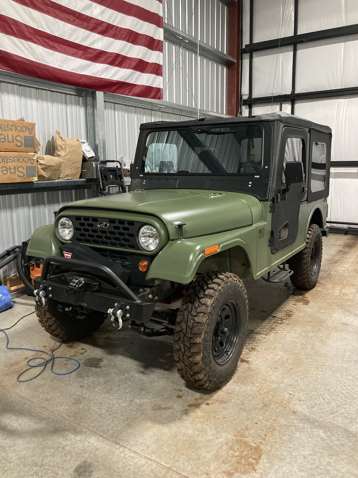

Different strokes, different folks. I couldn’t wait to get the full ROPS so I could install the full soft top for 4 season use as well as provide more safety to the back seat, when occupied (rare). I’m very happy with the oem full soft top.
Mpm did you get the soft top directly from Mahindra or through a dealer?
I got it from Sherwood Tractor Parts. I ordered it in October 2020. Unfortunately, I’m getting the impression that this full soft top isn’t available anymore. It’s made by bestop and was shipped direct from them. Maybe you could contact bestop?
