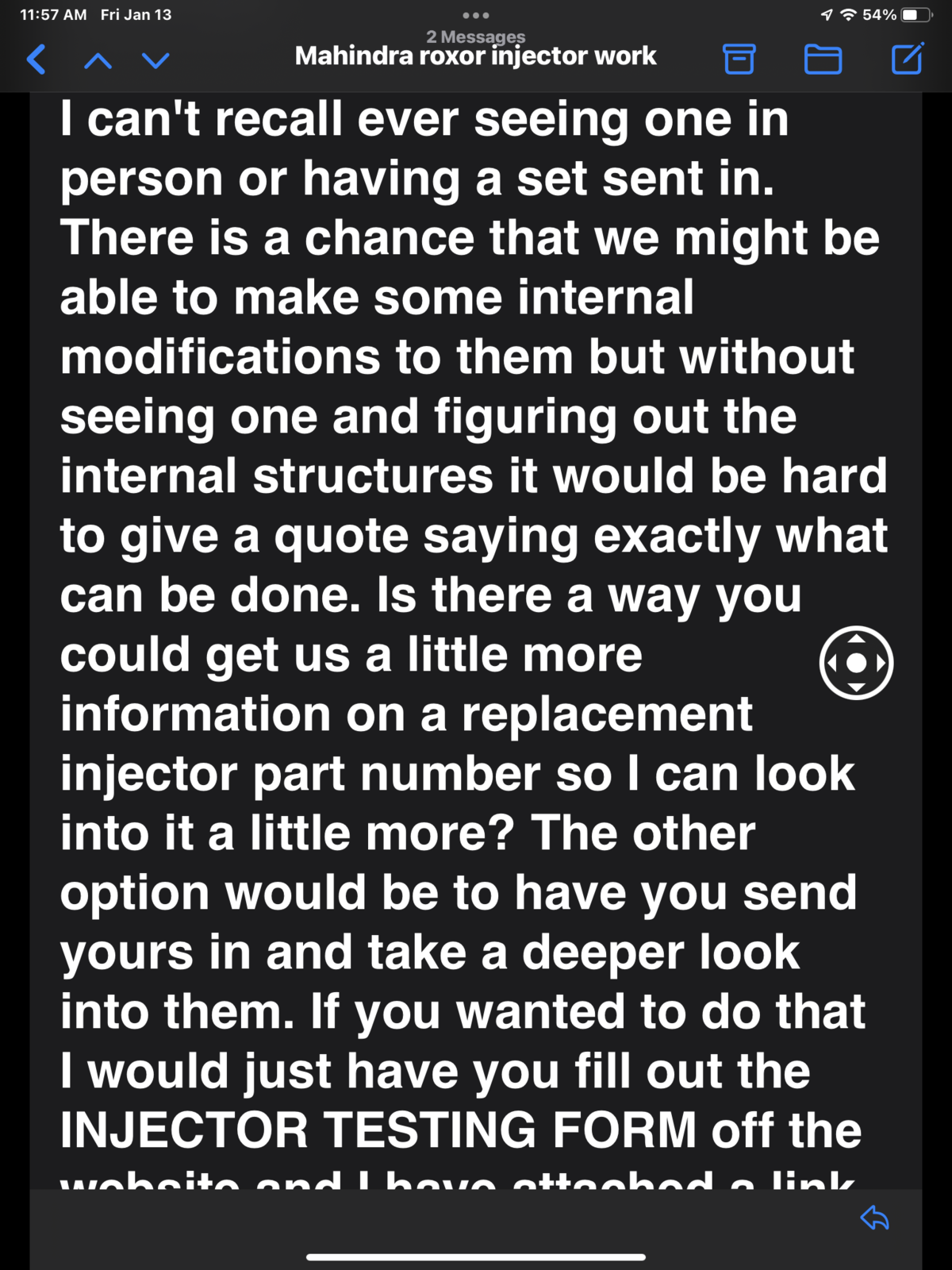

Instead of going through all of that I want to try and get my injectors modified to push more fuel. I emailed dynamite diesel products and they seem willing to give it a go but they are wanting more information on our fuel injectors before he tells me what can be done and at what cost. The other option is I take my injectors out and send them to him Which is a possibility but either way I’d like to know more about our fuel injectors. Who makes them and what the part number is would be a great start. I think I have heard people say that we have some Bosch components but if anybody knows for certain I am all ears. I have also followed dynamite diesel long enough to know that they would appreciate knowing more about our injection pump too. At the very least know what type of rail pressure we run.

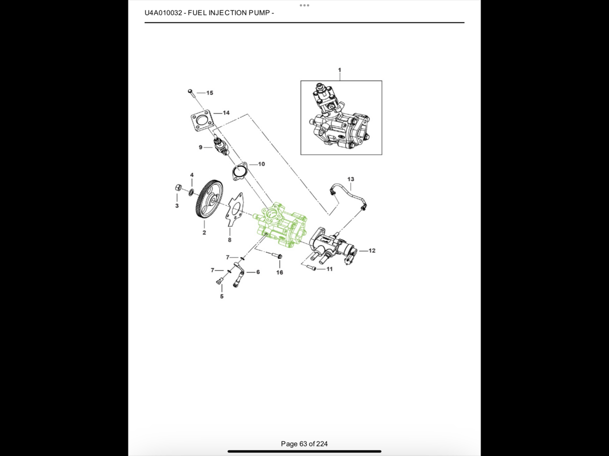

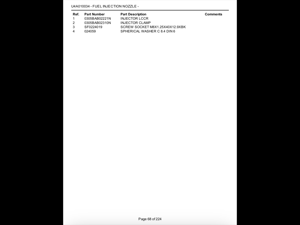

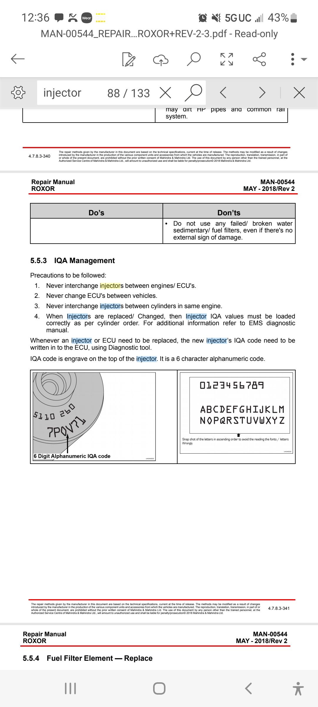

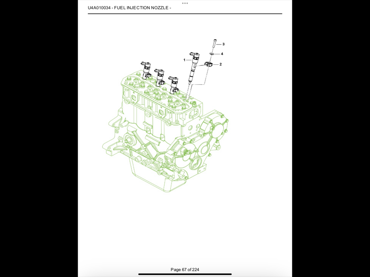

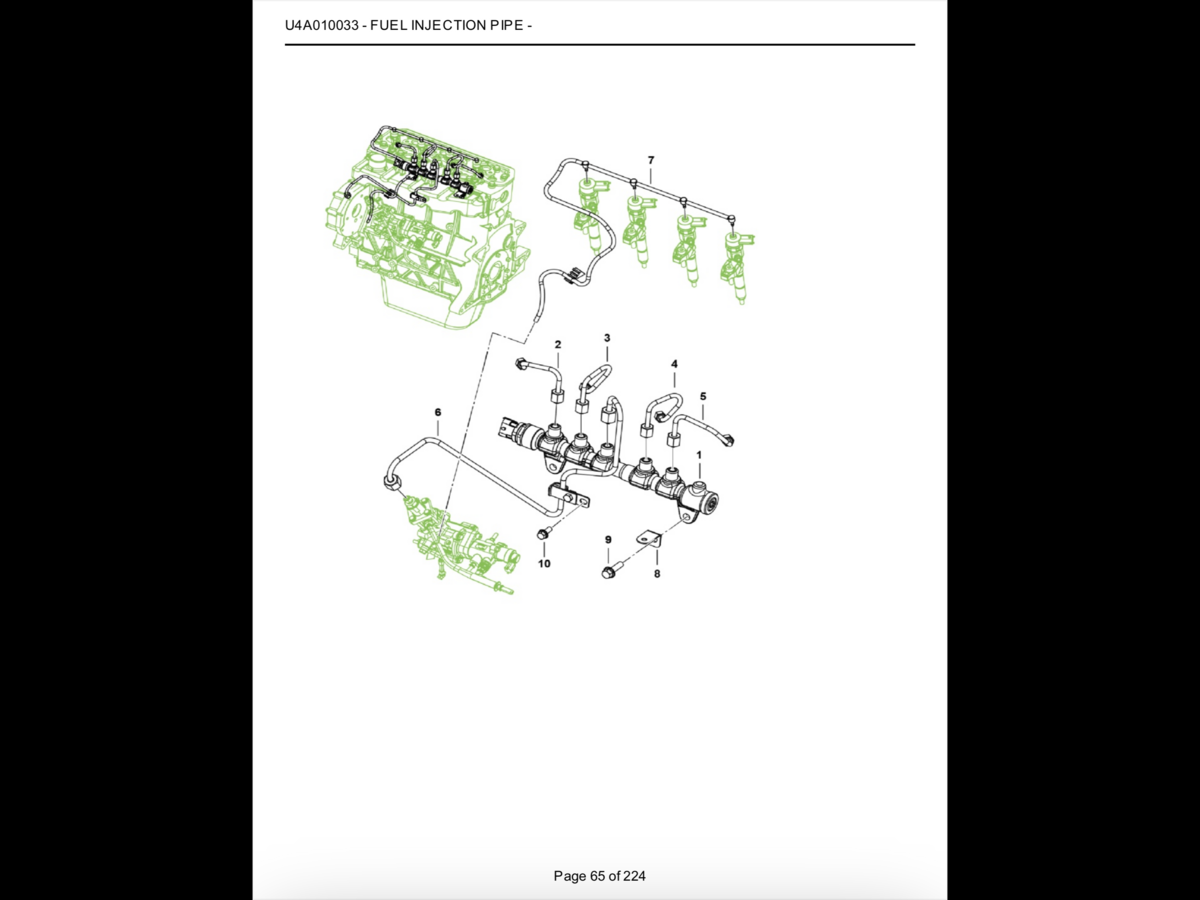

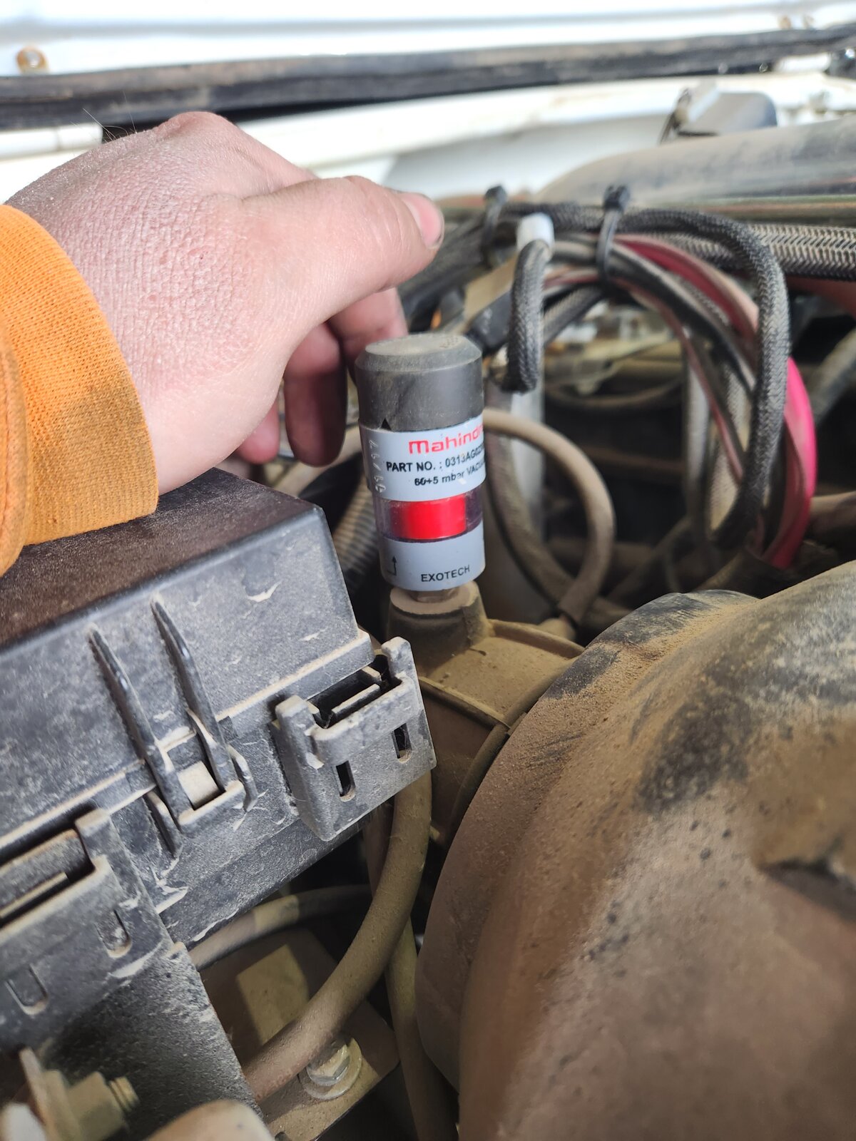

Does this help???
Yes bosch as per the manual that's what it said

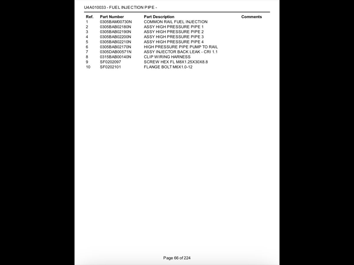

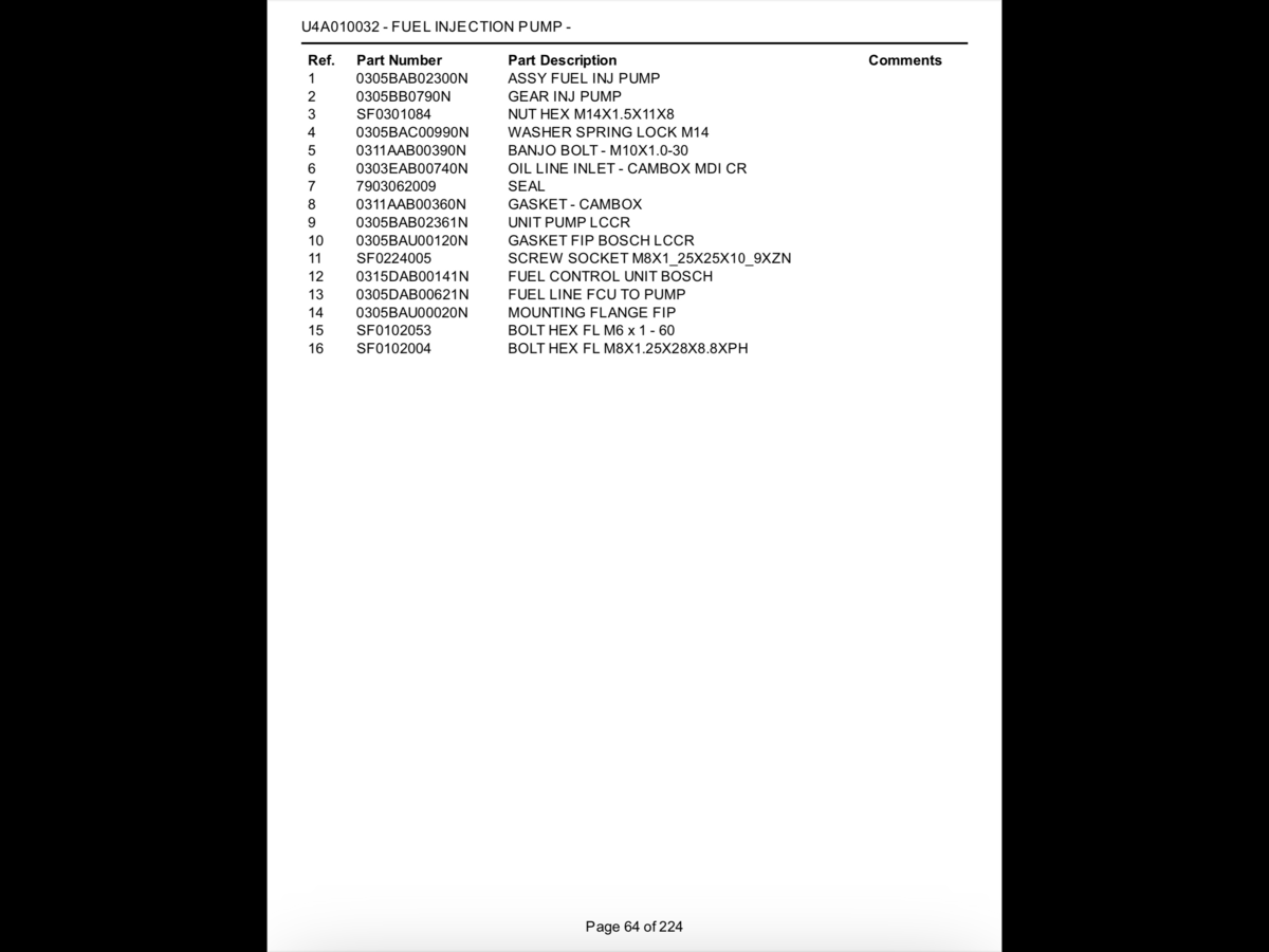

1,287
Part numbers look to be the same as what my parts manual shows

Not sure if that is the same as a part number or not. I was able to find your post with the manual though. That is still an extremely helpful link. Here’s the response email I got from dynamite diesel

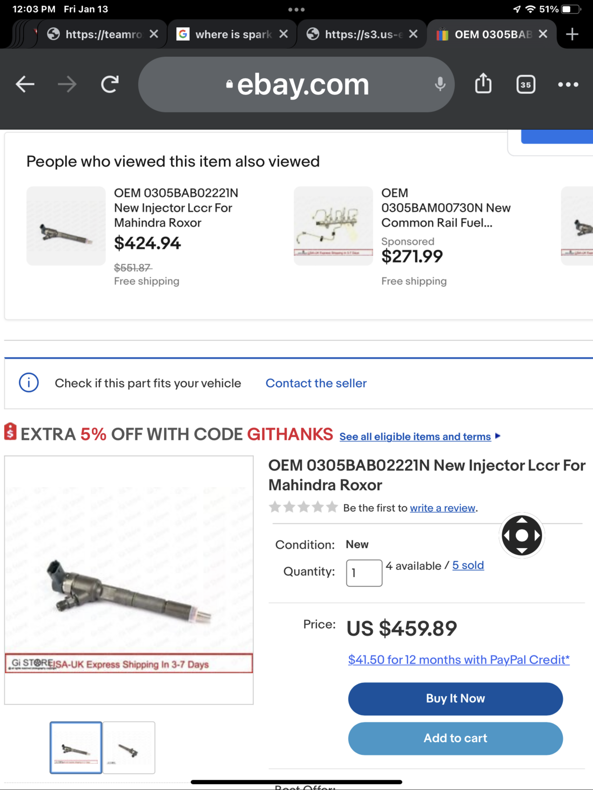

I thought the eBay website for the "roxor" injector is some cheap made knock off? I did see that link
