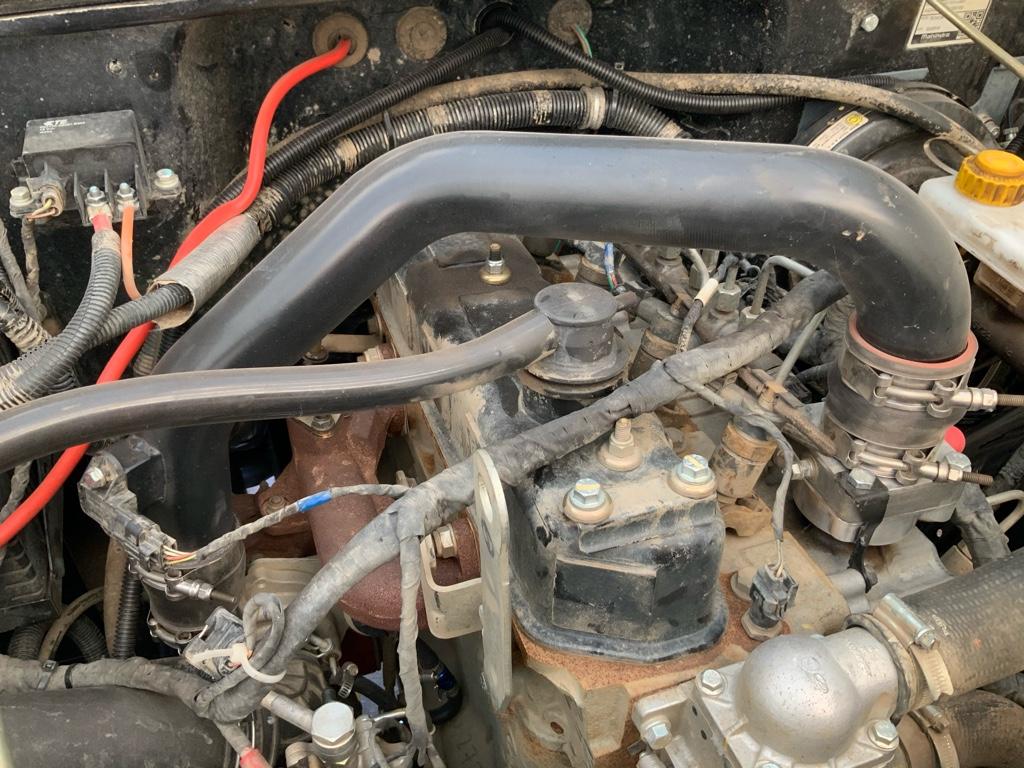

Did this upgrade awhile back. Gonna install an intercooler to help with temps. This setup was great when it wasn't 90 to 100 degrees outside but my intake temps get hot at 60 mph getting to and from the trails. Heat soak is also an issue as once everything gets hot my intake temps never drop below 165 degrees.

A video I made on how to install the Air connection upgrade. Hope you enjoy!
Where did you get the new pipe? I see diesel freak sells the intake connection kit but I don't see the intake pipe you're using.
2,292
It is from Diesel freak, it should be on their website, they are good folks
796
I installed the intake piece last week. When I removed the stock elbow, it wasn't sealed at all. The rubber fitting wasn't my issue, it was the 90° elbow. The worm clamp wasn't clamping down at all. I swear I picked up over half power with just the Diesel Freak intake piece. Before it was take me a good 30 seconds to get up to 55.
