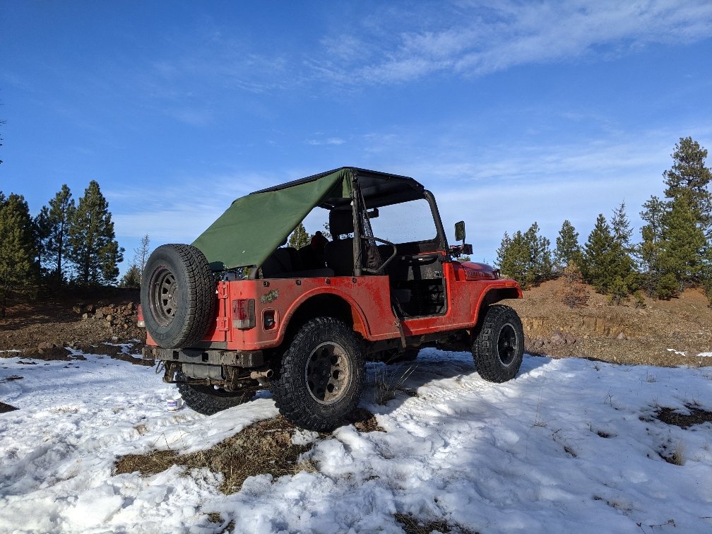

This is my 2018, stock suspension, on Falken 235/85 16s. I haven't had any problems with rubbing, used for light off-roading.

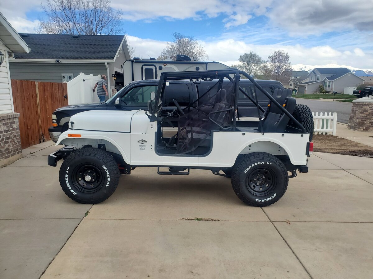

I run the 235/85R/16s on stock suspension with no problems. But with the sway bar disconnected, I got a mild rub on inner fender that was insignificant. I also chopped the front bumper to a shorty so couldn’t say if that would be a problem. Brake lines were fine when sway bar disconnected.
