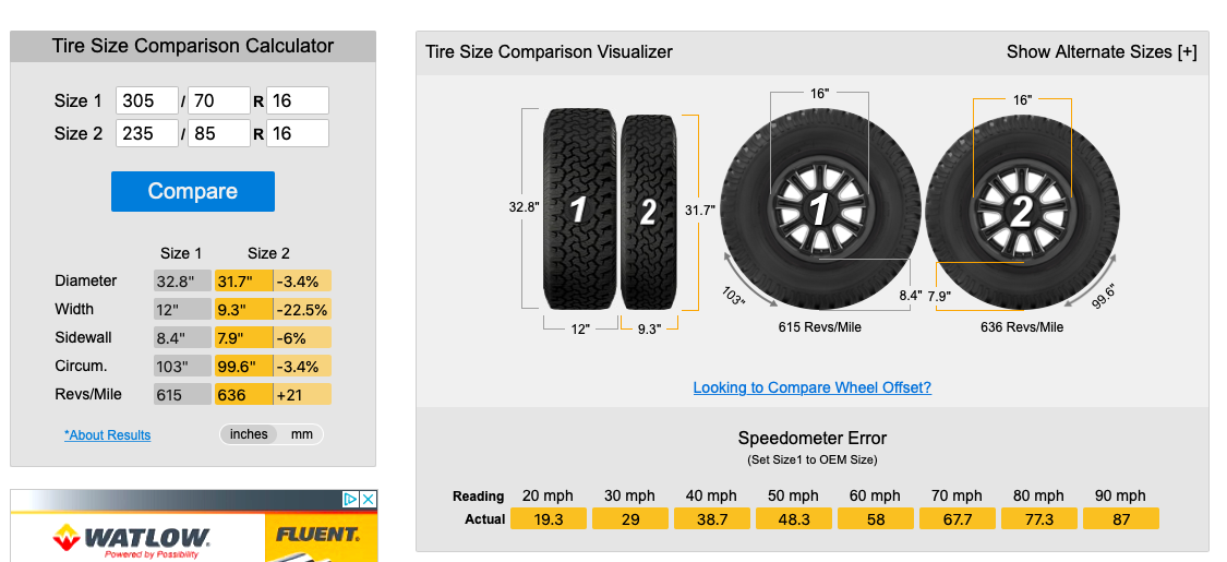

Can we run a 305/70r16 on the stock steel wheel with spacers? Any advantage of that tire size over the 235/85r16?
I don't have an answer for you on that, maybe someone will chime in, but here is a visualization of the 2 tires and a link to the webpage I use for this.
I personally like tall and narrow tires. I have better luck in the stuff I drive in, I want to cut to the bottom, I'm not looking for floatation.
Tire Size Comparison

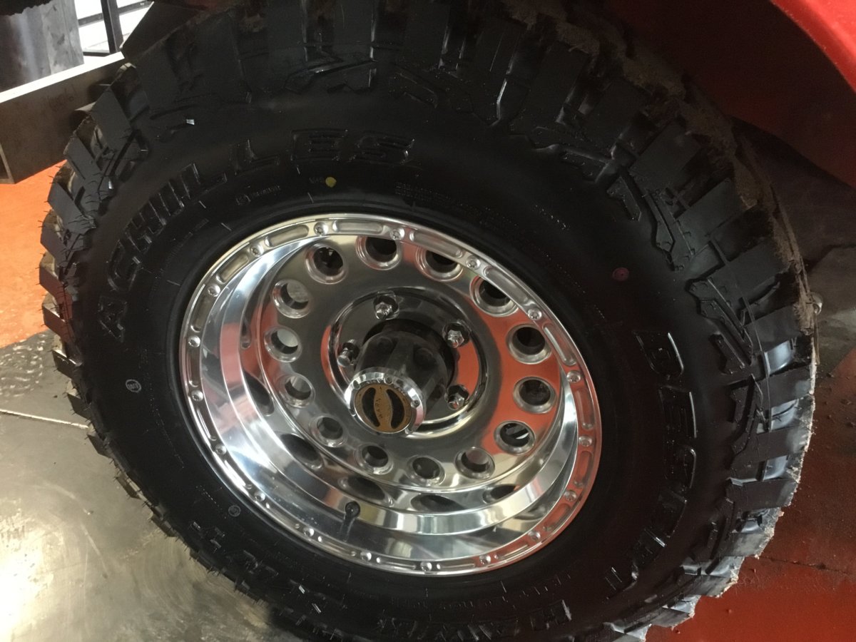

A lot has to do with the sprung weight. ( vehicle plus cargo ). True floatation tires will have flexible sidewalls , like turf tires. I agree with Bister , tall and narrow is the way to go for a small vehicle like the Roxor. Twelve inches is too wide for 9” rims..........but then sand dune travel , 5 lbs of air in flexible sidewall 305 tires may work better , again depending on the overall weight of the off road machine. ( air compressor required ) .
I am experimenting with installing a 10” wide alum rim using the 235 85s over the 9” stock black rim. I think my overall height will actually increase 1/2 to 1” inflated........will see once I can get proper lug nuts which have been on order for three weeks !

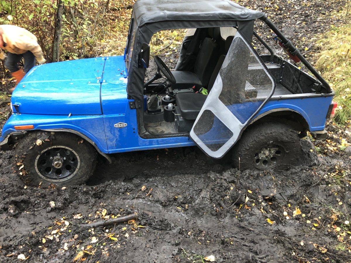

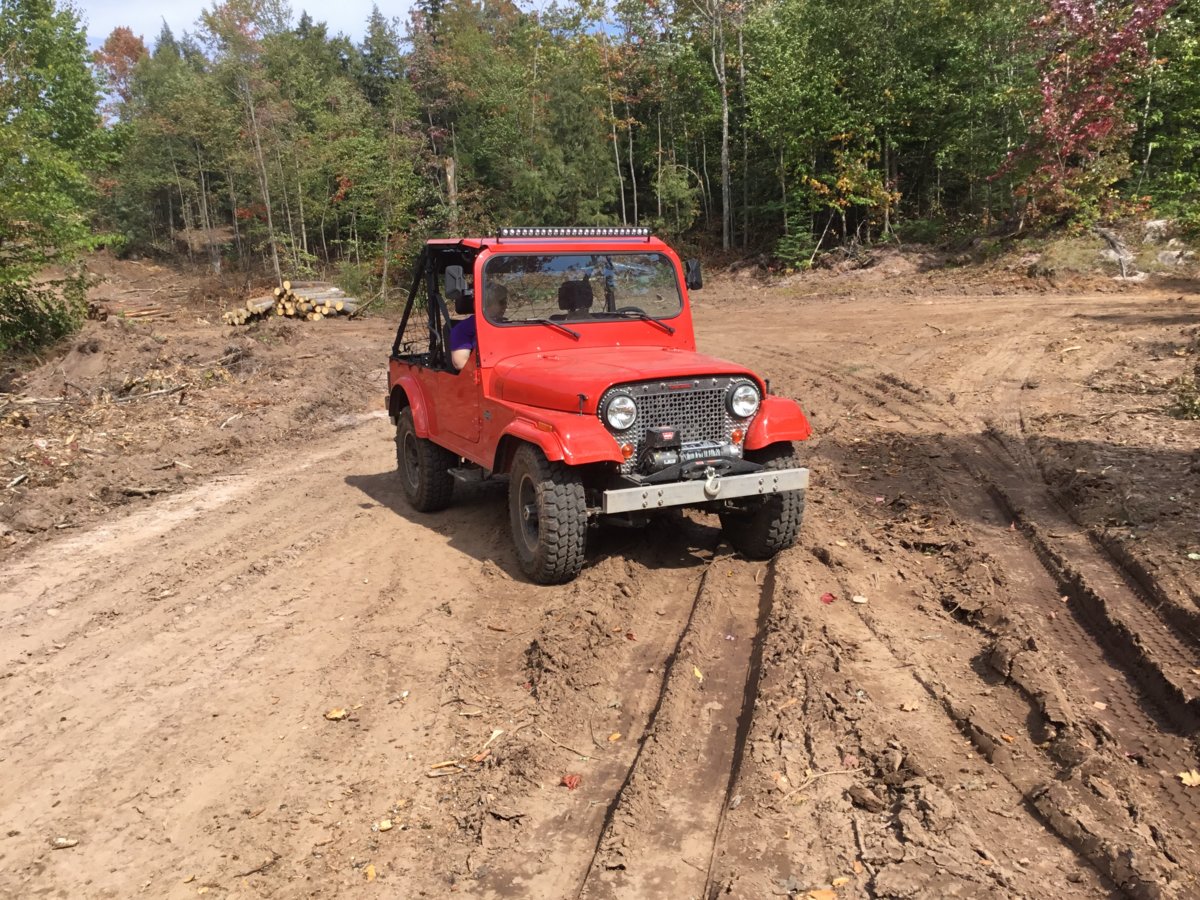

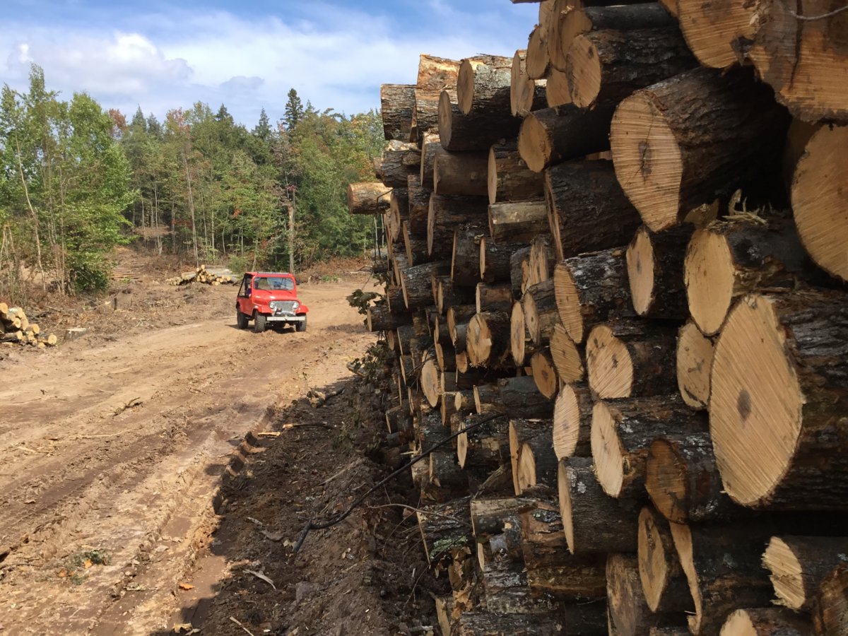

Another Saturday in our woods......sad to say yes loogers have been back,cutting all summer, atlest they left most of the white pine and cedars. .......last week this was a pure mud hole !

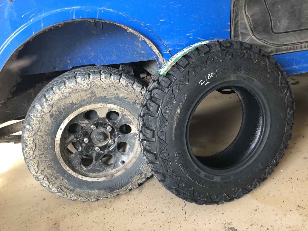

The 85s are amazing., There is lots of logging going on behind my place, this is where we ride so mud is a real issue. I can attest the tire difference is a big deal between the stock MTs and the 3” larger 85s. I bought mine on line , Desert Duelers made in Indinonesia. Last week I followed A Ponssie Harvester 8 wheel drive with tracks thru the mud ....a pc of cake ,!

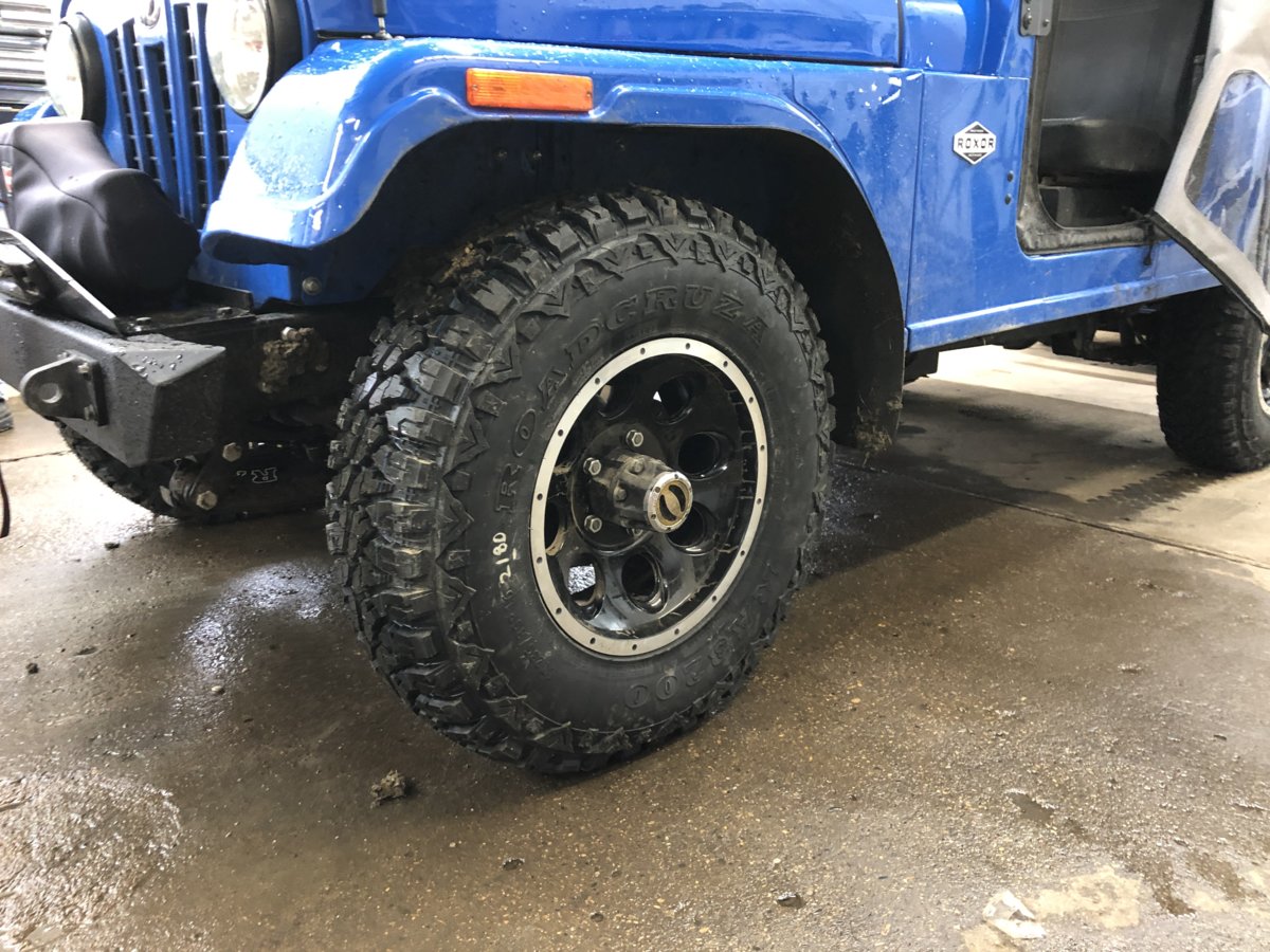

Its raining here so my buddy that should have been taking the rest of his crop off got my tires changed for me today. Then we were for a ride in the rain and idled anywhere we pretty much wanted to in my trails in the valley here. Places I wouldn’t have or couldn’t have gone before. Even the dirt road I had trouble climbing in the wet, we idled up without spinning in low range. Love them.
097B0746-1022-4589-82E4-5A8BCBB53187.jpeg4FD1DDAE-1483-45DD-BA84-6D40D69B2904.jpegF47E40D3-3218-44FC-BACE-161DACFEC604.jpeg
My buddy was with me, we drove into this hole, turned around in it and drove out. Should have recorded more. We never would have done that with the Ko2’s. These are also 2.7” bigger overall. The extra clearance helped I’m sure. I hate the way the camera flattens the land. There are also rocks in that hole, that's what I was hitting when I had to back up a bit.
