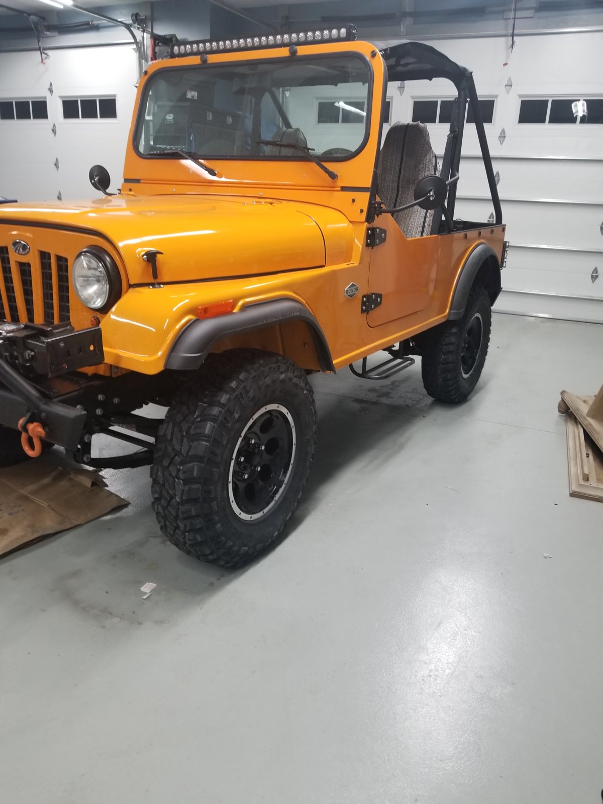

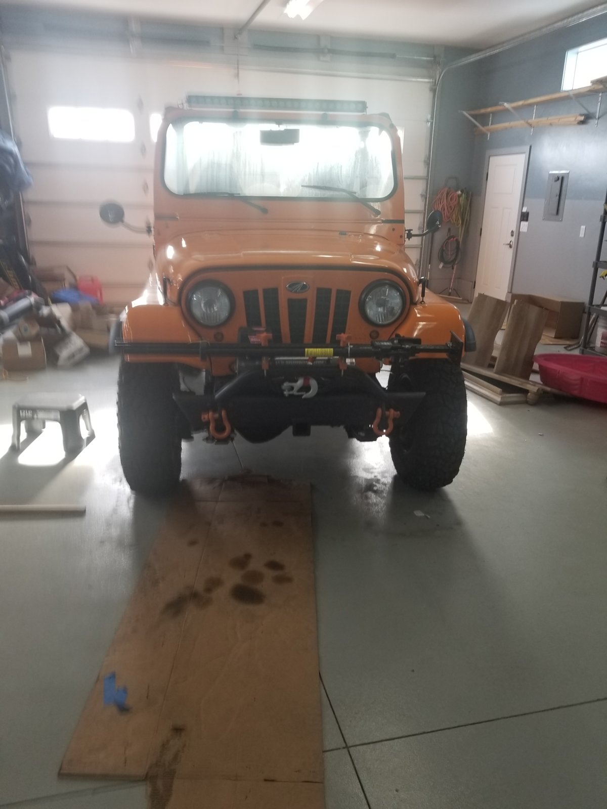

I just put that size on my Roxy last week on stock rims. I ended up using 2in bolt on spacers to solve some rubbing issues. I have added a leaf and had springs re-arched to give a 3 1/2in lift in front and 2in lift in rear.

I just put that size on my Roxy last week on stock rims. I ended up using 2in bolt on spacers to solve some rubbing issues. I have added a leaf and had springs re-arched to give a 3 1/2in lift in front and 2in lift in rear.View attachment 2203View attachment 2204

@quickshot Do you think you needed the full 3.5in lift in the front and 2in lift in the rear to fit these tires without rubbing, or do you think you could have gotten away with 2in in the front and stock in the rear?
Second question, what did you do with the shocks? I know some folks run 1-2 inches of lift on Wranglers while keeping the stock shocks, and many folks replace the shocks for longer versions if they're doing 3.5 inches like your front. I need to lift my springs, and I'm undecided how much is needed. Thanks for your help!

The front shocks were maxed out with the 3 in or so lift. I threw them away, they are cheap shocks anyway. I have the turn limit bolt turned in as far as possible to have the greatest turning radius. Without the 2in spacers, I was rubbing. The stock rims either had to go and use rims with different off-set, or use the spacers. I like the spacers. It moved the tires out---- it just looks better with the narrow width tires. I'm going for the old school look, lol
Without out the lift, I don't think the tires would fit in the front, maybe in the back they might.

235-85-16s are 32in height tire which is quite a bit taller than the 235-70-16s ( 28.9in tall). stock Roxor tires are about 28in or so in height. I went with the 235-85s so that I could still use stock rims but get a little increase in clearance (with also a small lift). I didn't want to jack the Roxy way up.

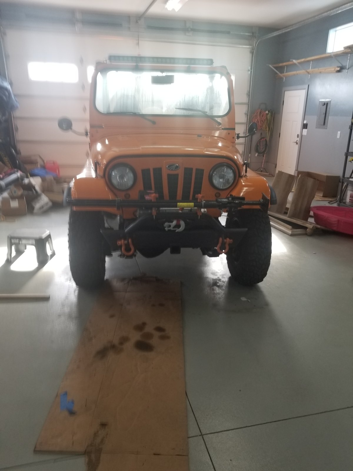

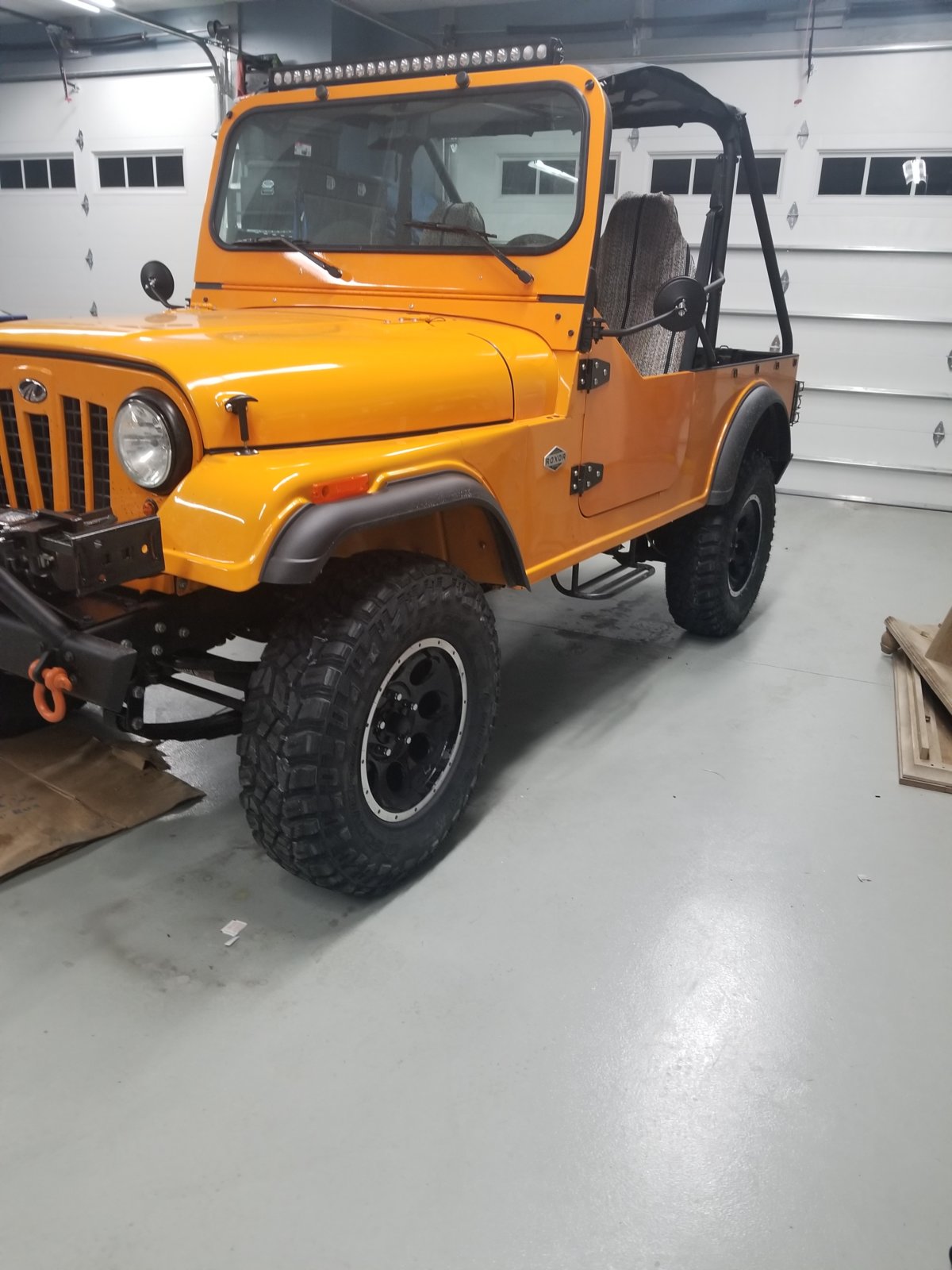

Who’s doors do you have ?
