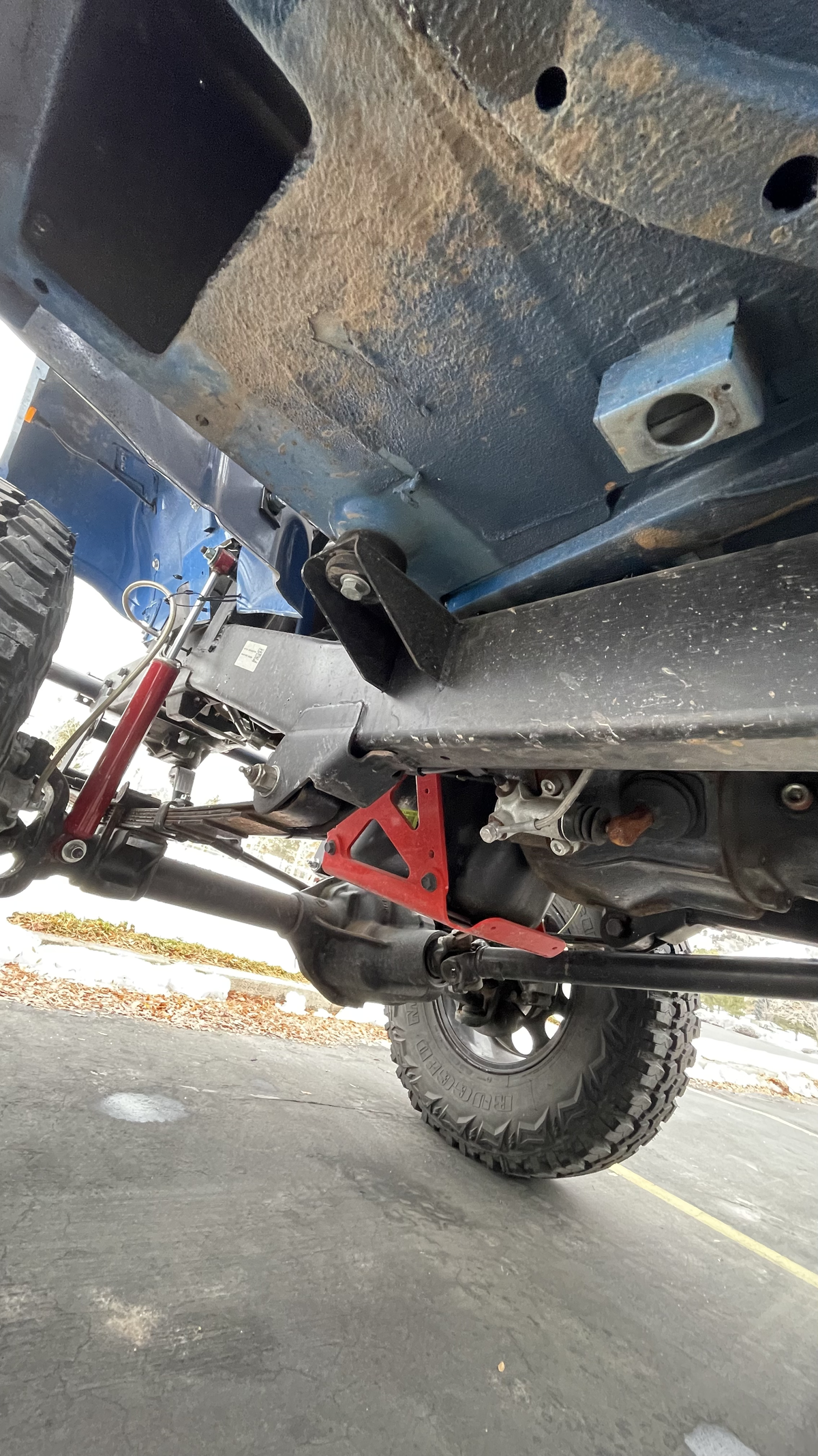

I am not much of a mechanic and was wondering if these will work if I have a 5 inch lift? I also enjoyed your video and will be doing the wheel flares also.

He’s most likely running stock length shocks as the BMF spring over mounts just raise the shock mounts back to the stock location
1,303
The stock shocks don't have the exposed (chrome) rod. The red color is what got me down the wrong track. These are not stock shocks on the picture.
Your correct. I didn’t look at the pic earlier. That’s not a bmf spring over kit. Someone welded on new perches. Those shocks are definitely longer than stock. Best bet is to measure those shocks extended and collapsed and then look in the book to see what is close.
