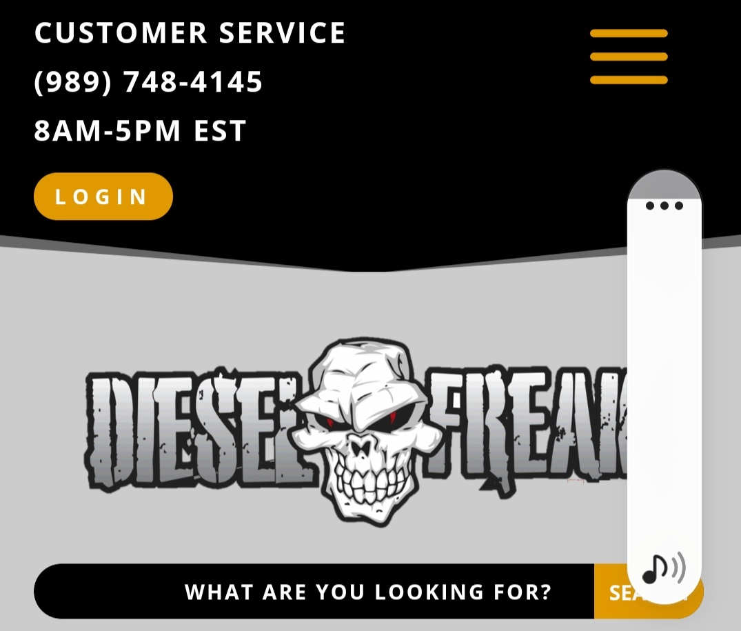

Looks like I am buying a 2022 Roxor. I will be using this for Hog Hunting. A regular SXS does not work so well because we have miles between fields. So far accessories should include a Rear Locker, Roof, Fold Down Windshield, and a Rear Seat. I am told disconnecting the Speedometer will disable the speed limiter. Any suggestions?

Here you go.

I would re-consider disconnecting the speedo and opt for tune by Diesel Freaks instead. Well worth the money. A stage one tune turned mine into a little rocket. Also, do you need a fold down window? I think it is overpriced for what you get. I installed a CJ7 frame on mine and like it very much. Check out On the Rox and Ceeco for some accessories.
