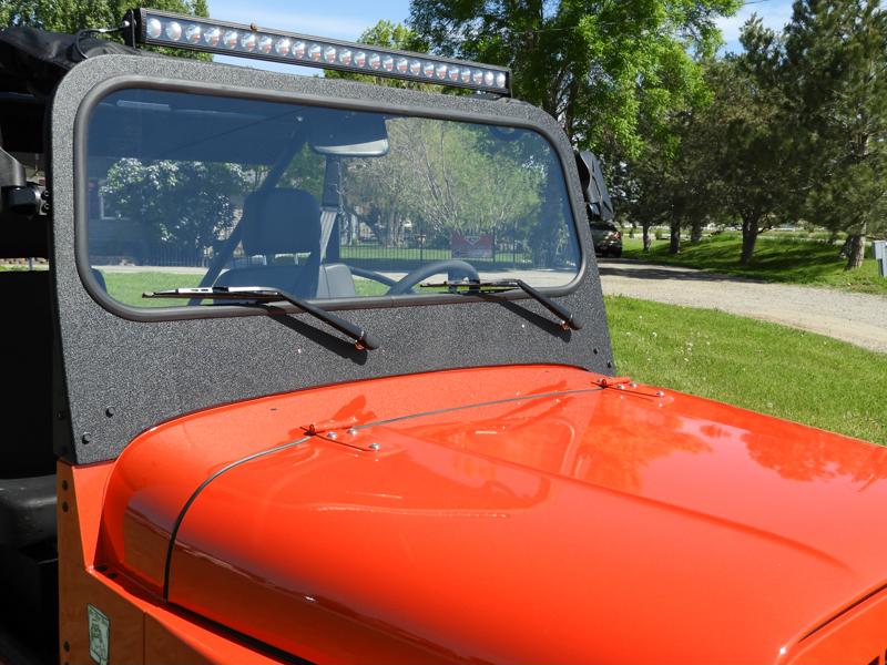

Hey everyone! We have our windshield with wipers designed and built on our Roxor! We have a few more cutout that are ready to be assembled, and powder coated as well. We will get those to powder coat towards the beginning of this week. Send us a message if you are interested in getting one! Thanks!

Hey everyone, we apologize for being stagnant, we had overlooked our notifications. Pricing on our powder coated windshields are as follows: Bare Aluminum windshield frame is $375. In Wrinkle Black Powder Coat, $425. Bare Aluminum with the marine grade Wiper Assembly, $775. In the powder coat, $825. I will also go in and add all of our products to the product and accessory thread as well. We are also developing a fold down windshield frame as well.

Hey rhyan, the glass is .030 safety plate laminated glass. So DOT approved in most cases. The correct windshield gasket is a C.R. Laurence part number, 10248. We can also sell you the gasket for $30.00. The glass is a custom size, but should be fairly inexpensive if you have a reputable glass shop cut and install it. When paying for the glass cutting, seal, and installation from a glass shop here in Montana, the cost varied between $150-$200. If you already have the seal, the cost should be around $120 and should not exceed $200 no matter where you are, unless it is a special order glass for that shop. It is a very easy piece of glass for a shop to cut.

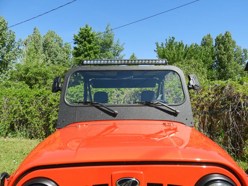

I purchased the On The Rox windshield kit some time ago and finally got around to installing this past weekend. The install was a breeze. Fits great, looks great! Would recommend to all. As far as the glass here in Arizona, it cost me $225 for the glass, gasket and install in the frame. Sounds like that is right in line with what Wyatt is saying.

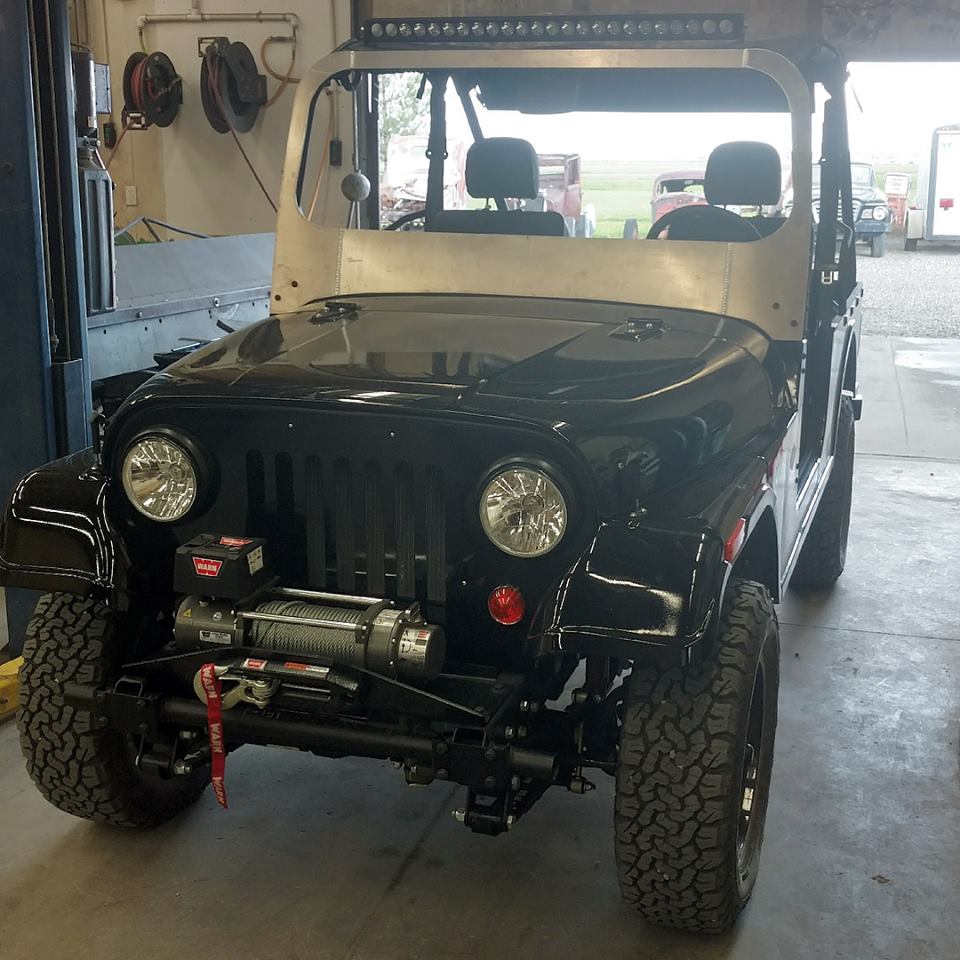

For my Rhino, I had a piece of 14 gauge sheared to the size I needed at a friends large local manufacturing shop, then used a zip disc and jigsaw for the rest to make my glass one. I’ll be doing the same for the ROXOR, but this time I have a plasma cutter I can use. That’s going to make thing easier plus less curves, to cut. Then I took it back and they powder coated it for me and to a glass shop for safety glass. I just need to talk them into making frames, but they would need a 100 orders before they would even look at running it through R&D and the plant. Lol
I think I’m going to make a lexan half windshield of some sort for summer for the ROXOR.
They made my roof and rear panel also.
My doors are lexan and a 3/4” tubing frame and just lift off.

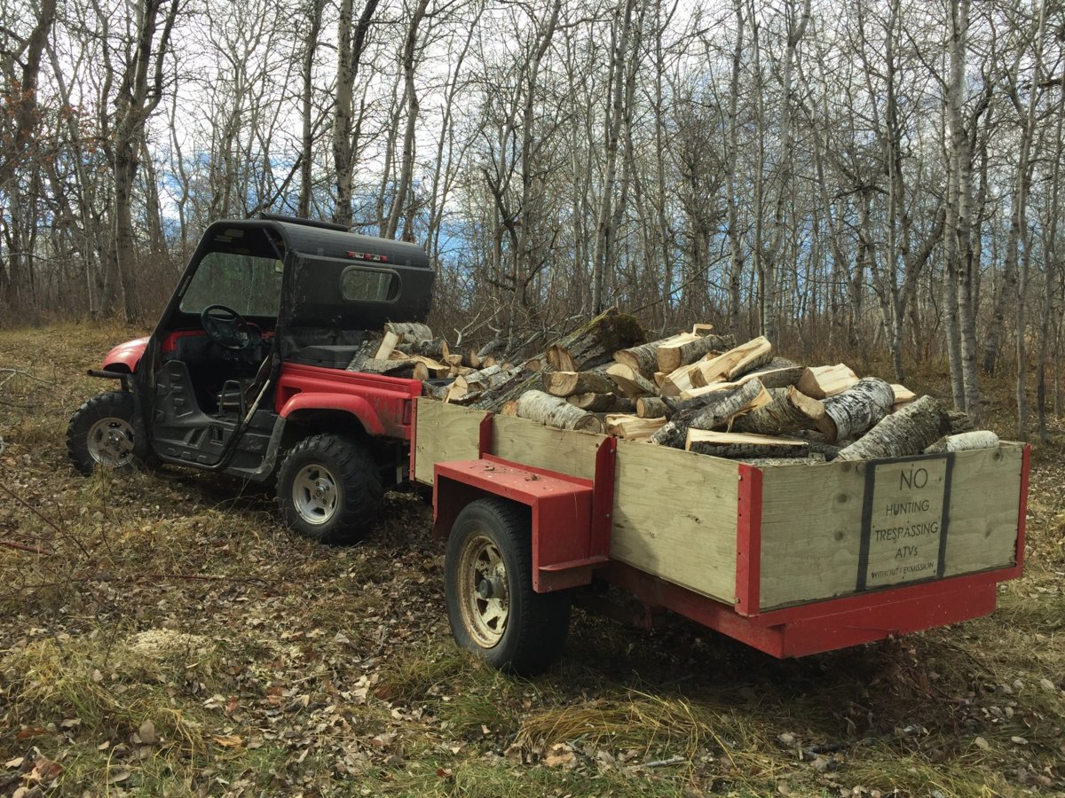

The ROXOR is going to haul this wood home so much better.

Thanks very much for the feedback! I am glad you were able to get that installed with no issues. Moe was one of our first windshield customers!
