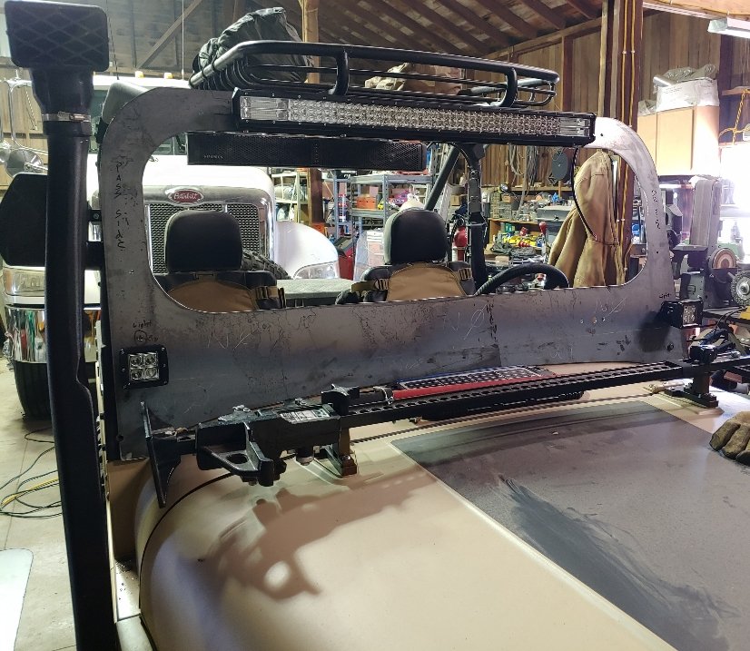

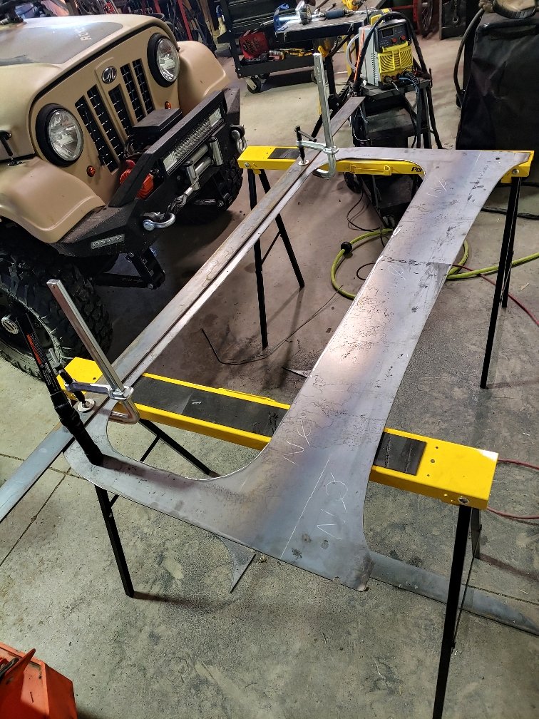

If you dont like the cost of the aftermarket options (like I didnt) you can always build your own. The thing that got me was all of these companies cutting 1/8 steel or aluminum and selling it for $1000+ and wiper kits for $500 all without glass
Materials:
1/8 cold rolled steel-$65.00
Single blade Wiper kit-$35
Powdercoat-$75
Dot 1/8 glass w/gasket installed-$250
Gasket and edge trim-$70
Total-$495 (I already had LED lights)
Materials:
Powdercoat-$75
Are you going to be selling these you think and how much do you want?
Will they work with the OEM cab etc? Will it come with glass?
How much is shipping?
I think some folks might be interested if you can sell them cheap enough.
echo3delta
Apr 14, 2020
34
Great Bend, KS, USA
Mr. Bister,
I dont think I will be selling any right now (I do that all day at work as a welder/fabricator LOL ) but anyone that wants a walk through on how to do it Id be happy to help. Ill put a CAD file together with the measurements and post it here sometime this week.
Its really a pretty simple process. I did mine in my shop with a plasma cutter, but if you take the drawings to a weld shop they could do the cutting for you way cheaper than the aftermarket options. Biggest deal is to make sure the glass cutout is square.
Should fit the OEM cab, id need measurements and pictures of the cab to answer that for sure though.
Mr. Bister,
Should fit the OEM cab, id need measurements and pictures of the cab to answer that for sure though.View attachment 8646

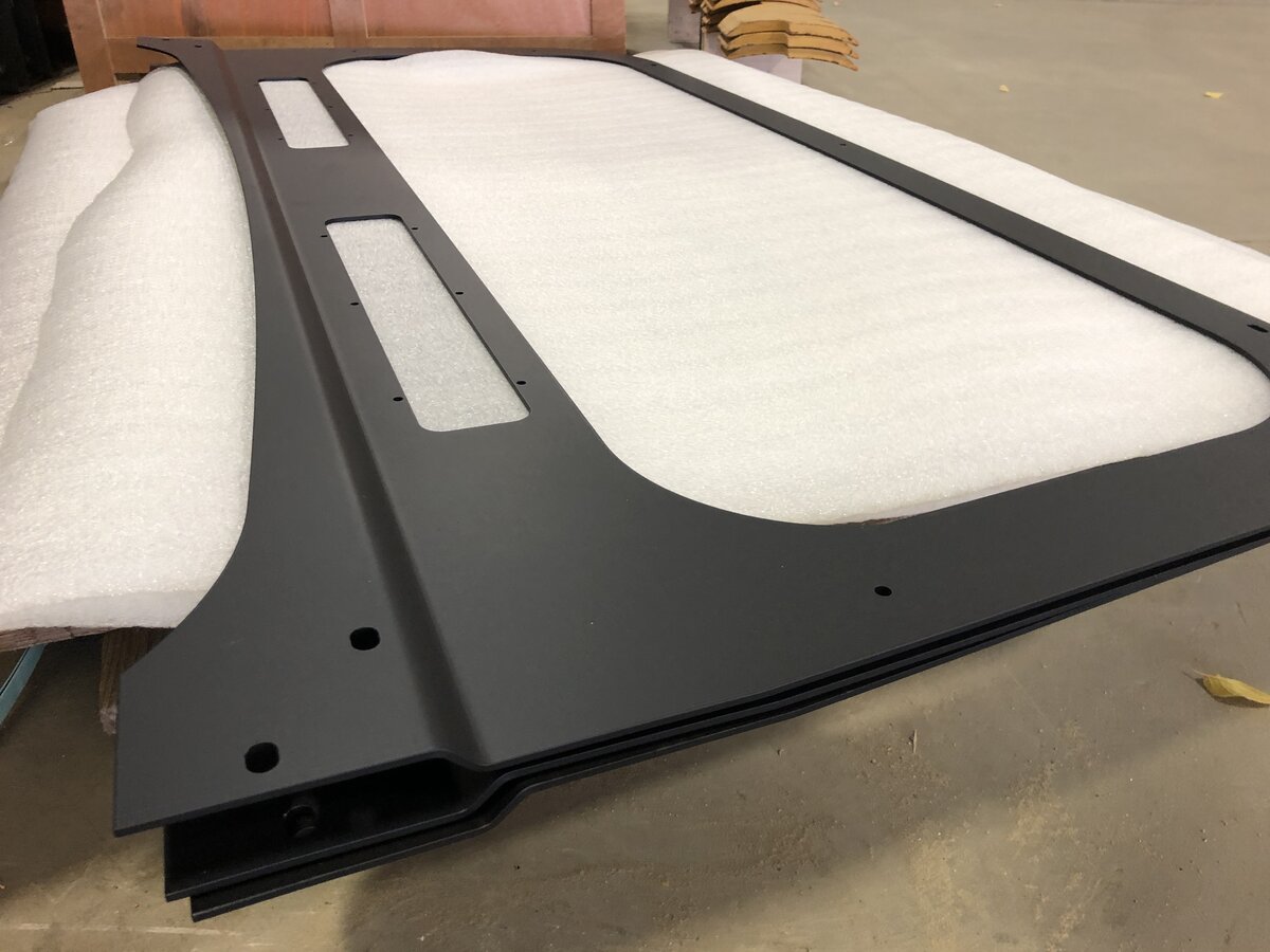

We get frames made also for our Roxor's at the dealership I help. We don't sell them cause shipping, glass, clamps, foam, profit would bring them up to the same price as the others unless someone wants to buy 4 at a time just painted. These cost us $350CDN ($275 US) laser cut, formed and powder coated.
They match the OEM ones perfect so they work with the cabs etc from Roxor. I have seen other windshield and they all need modifying to work with the OEM stuff.
I was just enquiring in case you made them for sale for others.
This is one that we make that takes an Arctic Cat vent so you get some air movement.
