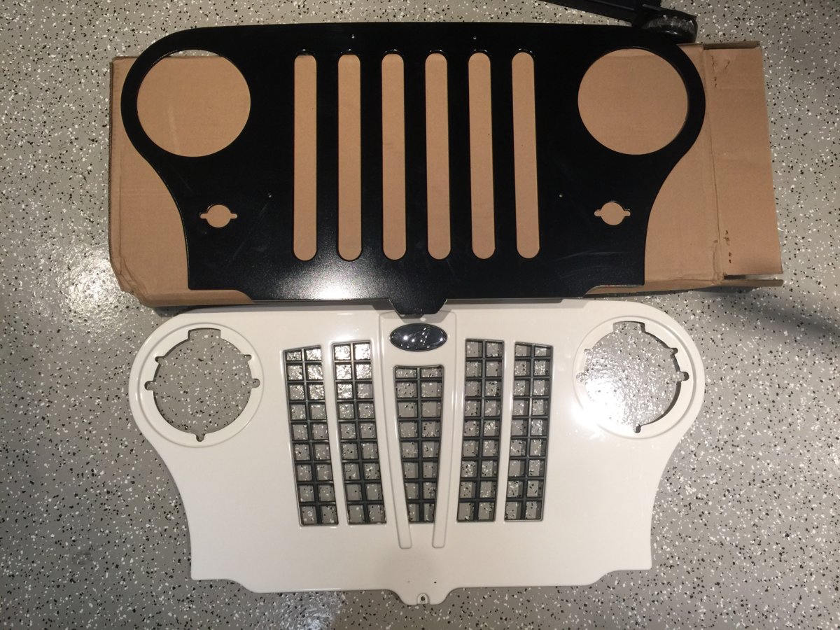

Good deal. I received my frame today and grill. Waiting on blinker kit and lift Did your windshield come with a gasket to seal up the frame to the ROPS? I still have quite a bit of things to come in. Here's a pic of the grill
