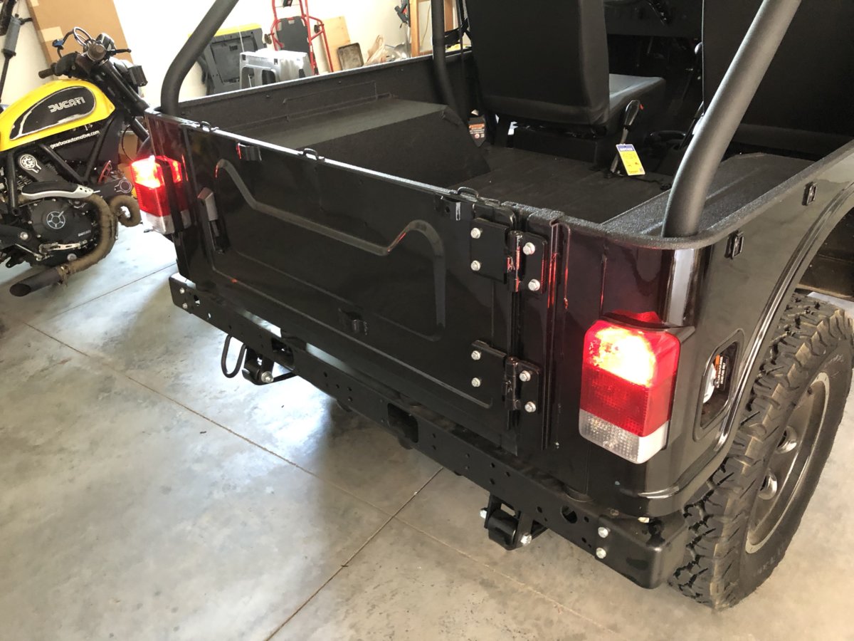

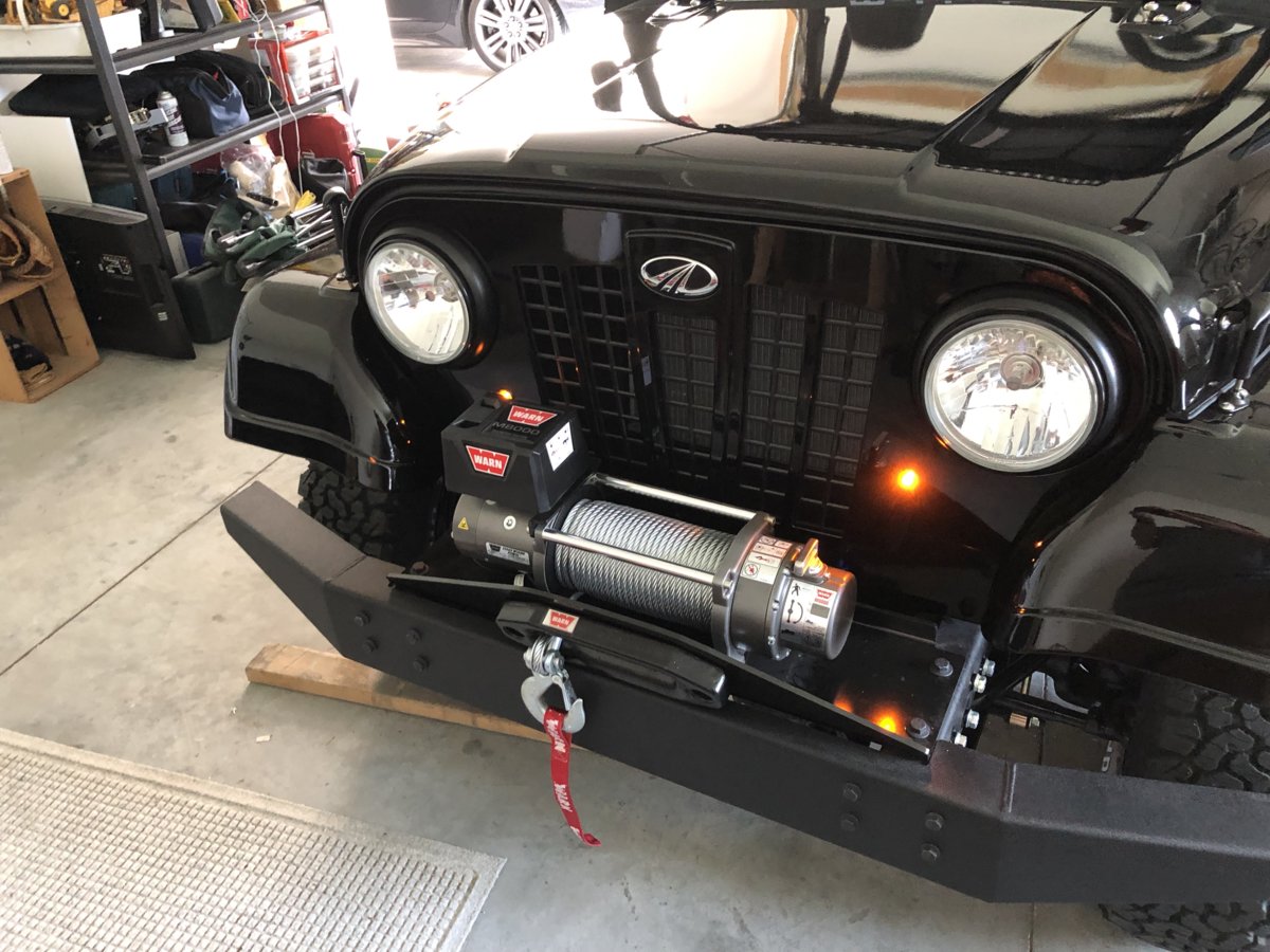

This weekend I installed a DIY turn signal install.
I used the Grote 48072 switch and harness.
I tapped 12v hot off of the plug that's dead-headed in the dash panel labeled something like "LED LIGHTS - REAR"
I ran separate wires from the engine bay back to the rear light housings.
Used the 1/4" amber LEDs that most use.
Notes:
- I need to find a schematic for the switch. I can get the blinkers to work or the light indicators on the switch to work but not both.
- I traced the stock signal wire for the left rear to the engine bay, Mahindra just ran a jumper from that to the right rear for some reason. I didn't use the stock wiring but did use the stock bulbs.
- The Grote lever handle is HUGE. like, baseball bat big. I need to make a better one.

I used one from a big rig. It had front and rear light wires. I used the rear wires and ran them to led indicators I put in the dash. Some have the lights in the signal stalk but you had to run a ground and I think a wire to the flasher unit (pilot)
https://www.grote.com/wp-content/uploads/2014/08/48072-WIRING.pdf
Yes, that's the exact wiring diagram I used (no brake circuit). The blue wire is supposed to power the internal indicators.
I'll do something similar to you if I can't get it figured out; I'll just tap into the signal wired and put some LEDs in the dash. might do that anyhow because it's hard to see the switch's indicators in the sun.

View attachment 3951View attachment 3950
I had the same problem. You need a better ground for the switch. Try this flasher on amazon https://www.amazon.com/gp/product/B00JXLHE8S/ref=ppx_yo_dt_b_search_asin_title?ie=UTF8&psc=1 It has a ground on it.

...I ordered the one from the earlier post and it worked great.
Right you are, fixed the issue.
It's very strange though, when I first installed the new flasher it didn't work. I removed the ground lead and it started flashing, regardless of the switch position. After messing with it a while, it started working correctly.
Makes me wonder if there are some programming options with that flasher.
838
There is a GREAT spot for a ground on the clutch side of the pedal support. I used that. Threaded 10mm nutsert IIRC.
I'd love to go back through the wiring I did and make sub-harnesses with the plugs on it so cutting the stock harness was not required.
