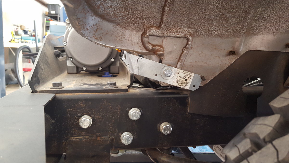

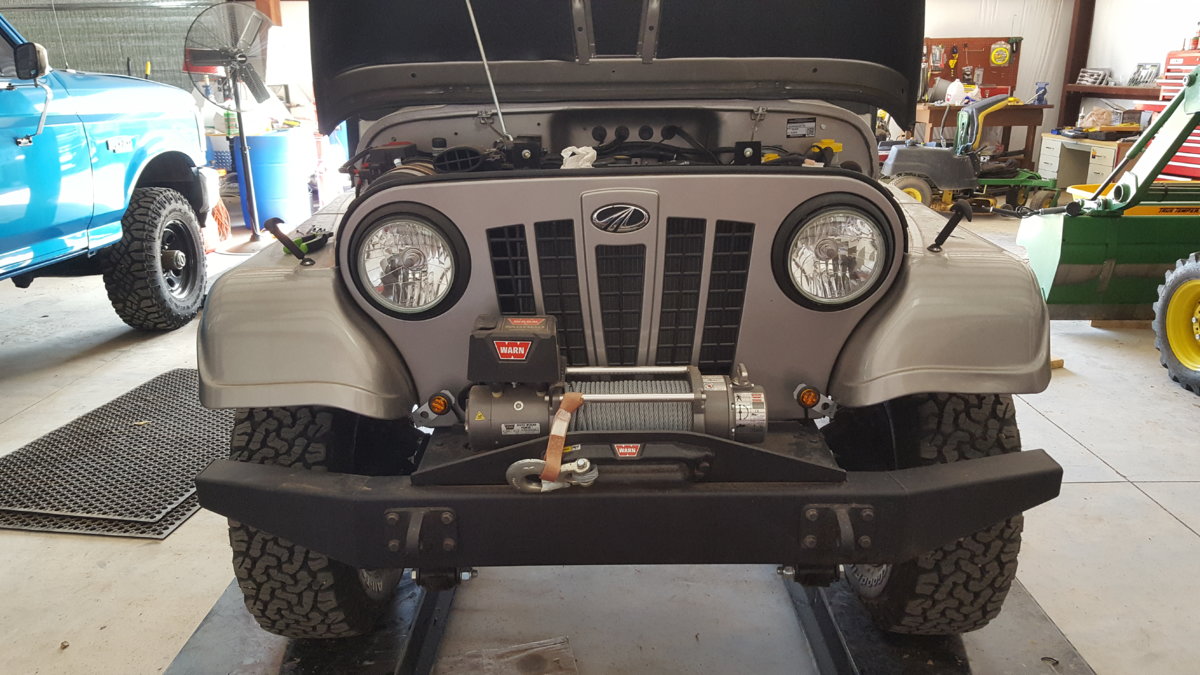

I didnt want to cut holes in the grill, so did a temporary (or maybe not) work around just to get the lights up there for now. Used some simpson tie downs, or something similar, I had laying around and drilled open one of the holes a little larger to accommodate the light grommet, then used an existing hole and bold inside the fender wheel well to affix it to vehicle.
Thought Id share
