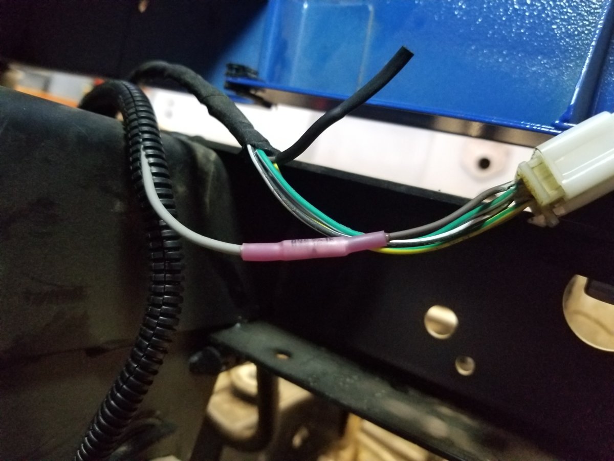

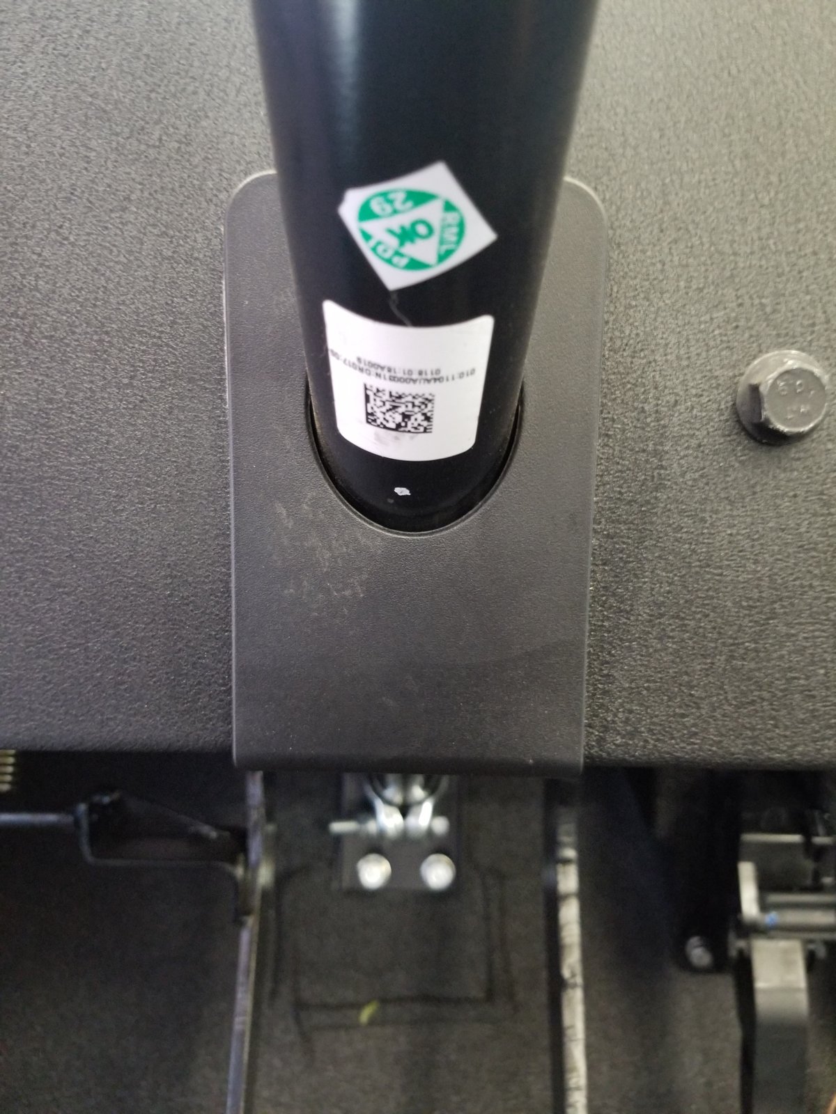

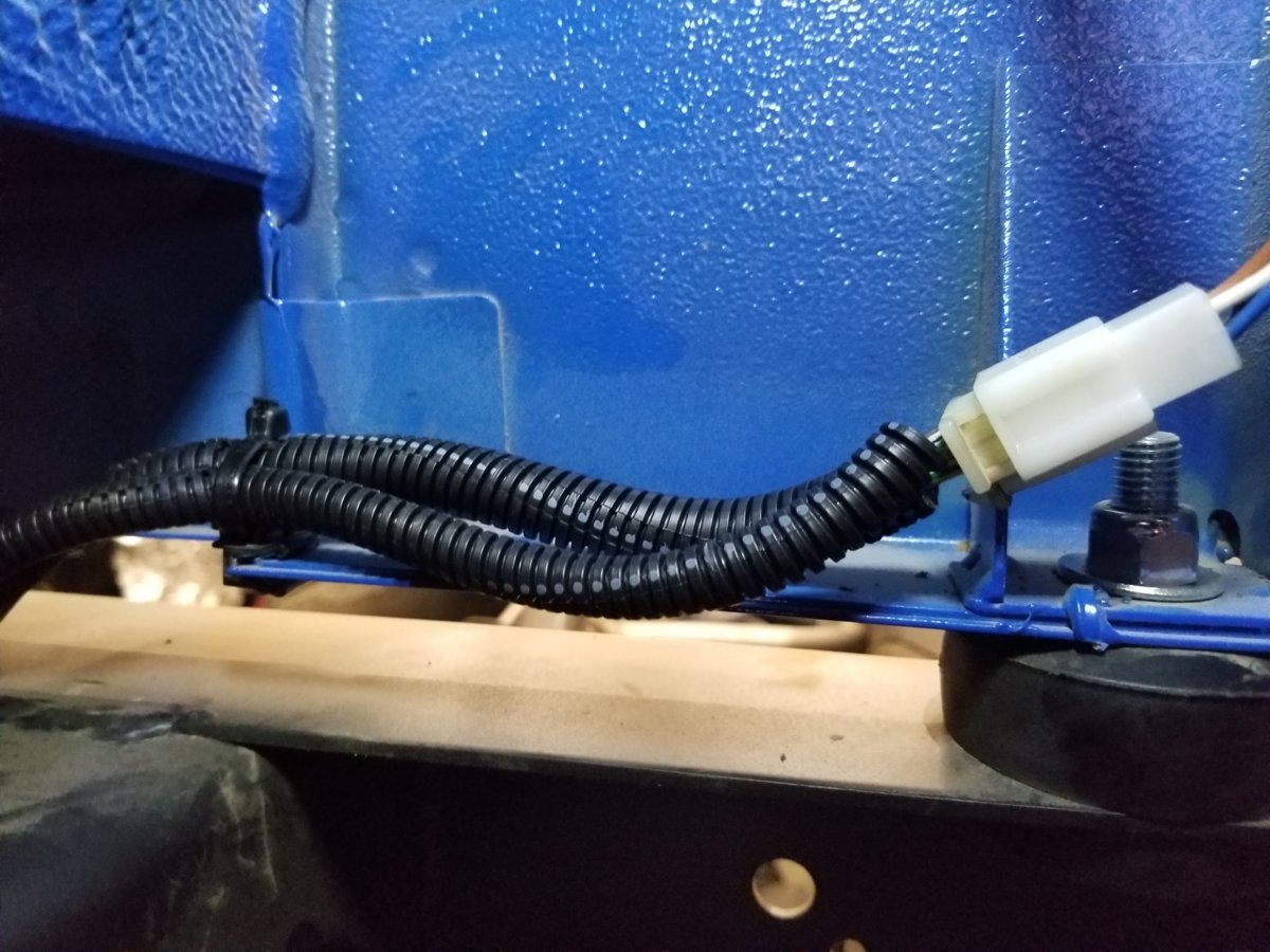

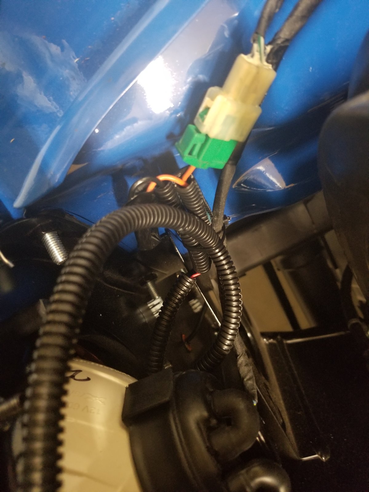

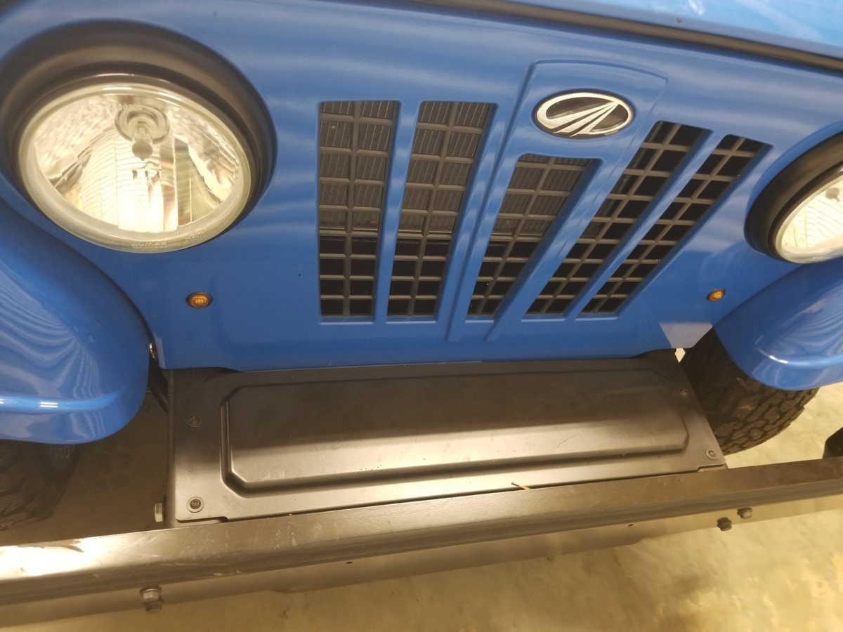

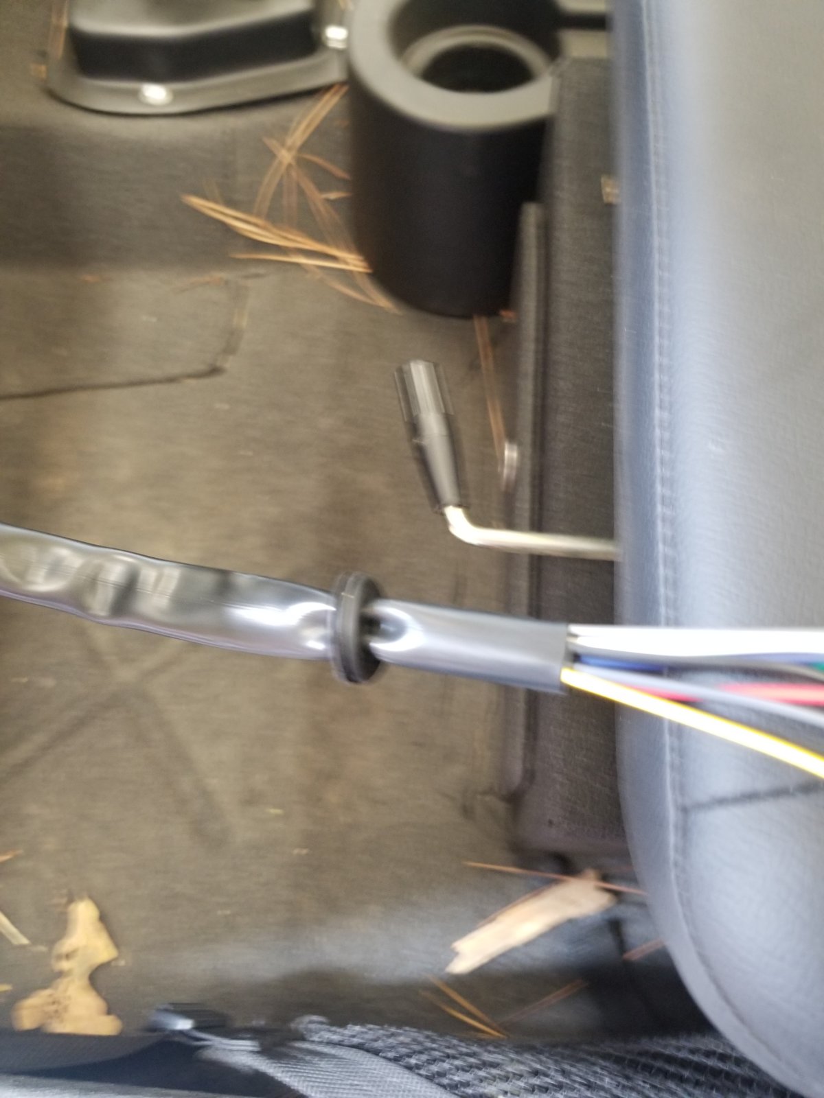

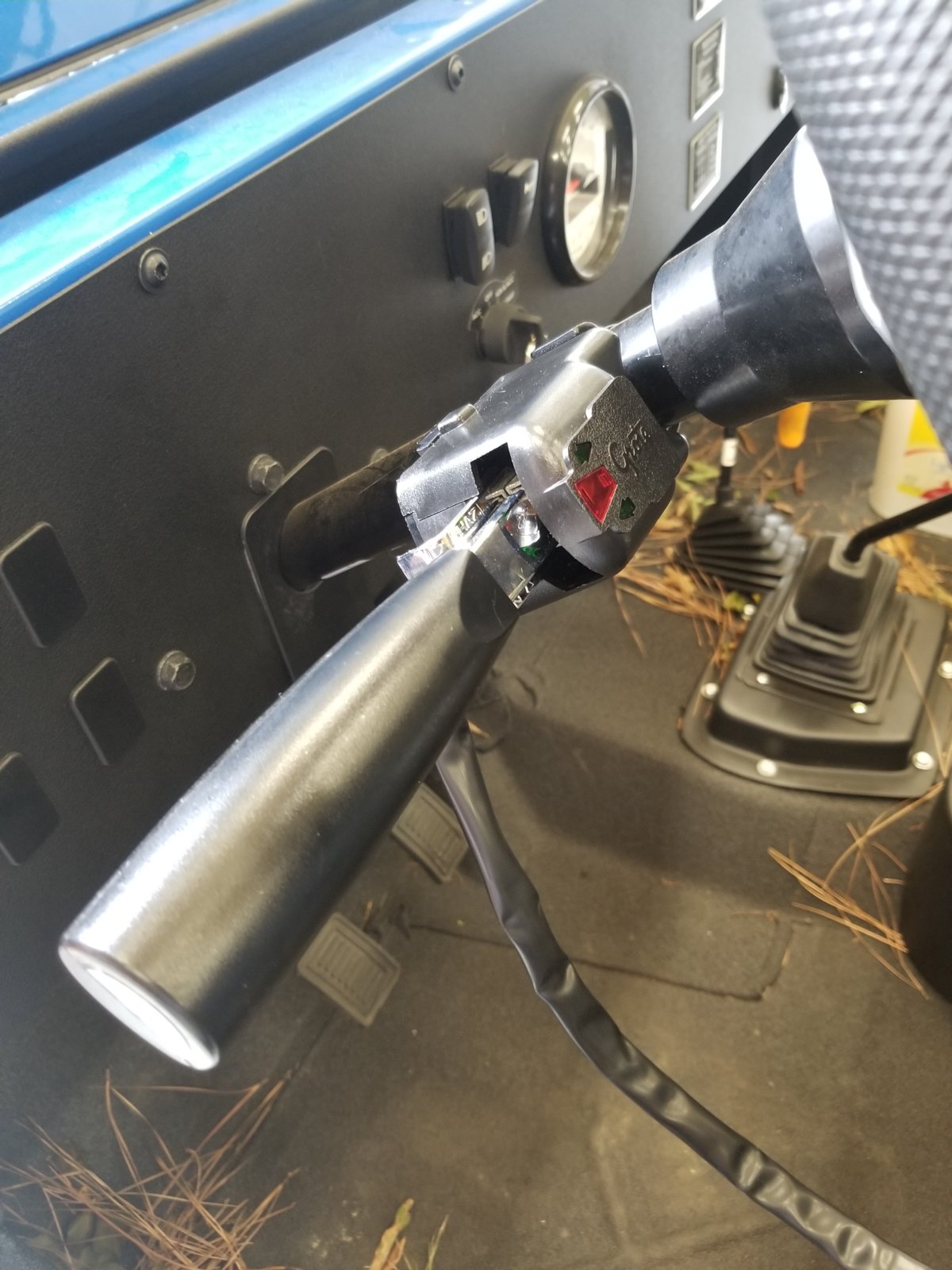

I finally got around to installing turn signals. I based this off of some of the other products for sale, but I have enough experience doing wiring so, being cheap, I came up with my own kit. I differed from other instructions in that for the front marker/turn signal lights I tied into the harness for the side marker lights instead of the vehicle harness. Additionally, I used a LED flasher as standard flashers don't work great, if at all with LED bulbs. The Grote 48072 turn signal switch kit comes with the switch as well as the harness you need to hook it up. It also comes with a wiring diagram on where to hook everything up.
The key harness in the vehicle is the one that comes off of the brake switch.
Other than wire and a flasher I purchased at a parts store, these are the parts I used.
-Partsam Pair 3/4" Mini Marker Clearance Light Turn Signal Light 1 Diode Amber Light,3 Wires https://www.amazon.com/gp/product/B019BT79NG/ref=oh_aui_detailpage_o03_s00?ie=UTF8&psc=1
-Grote 48072 Turn signal switch kit
Pictures below.

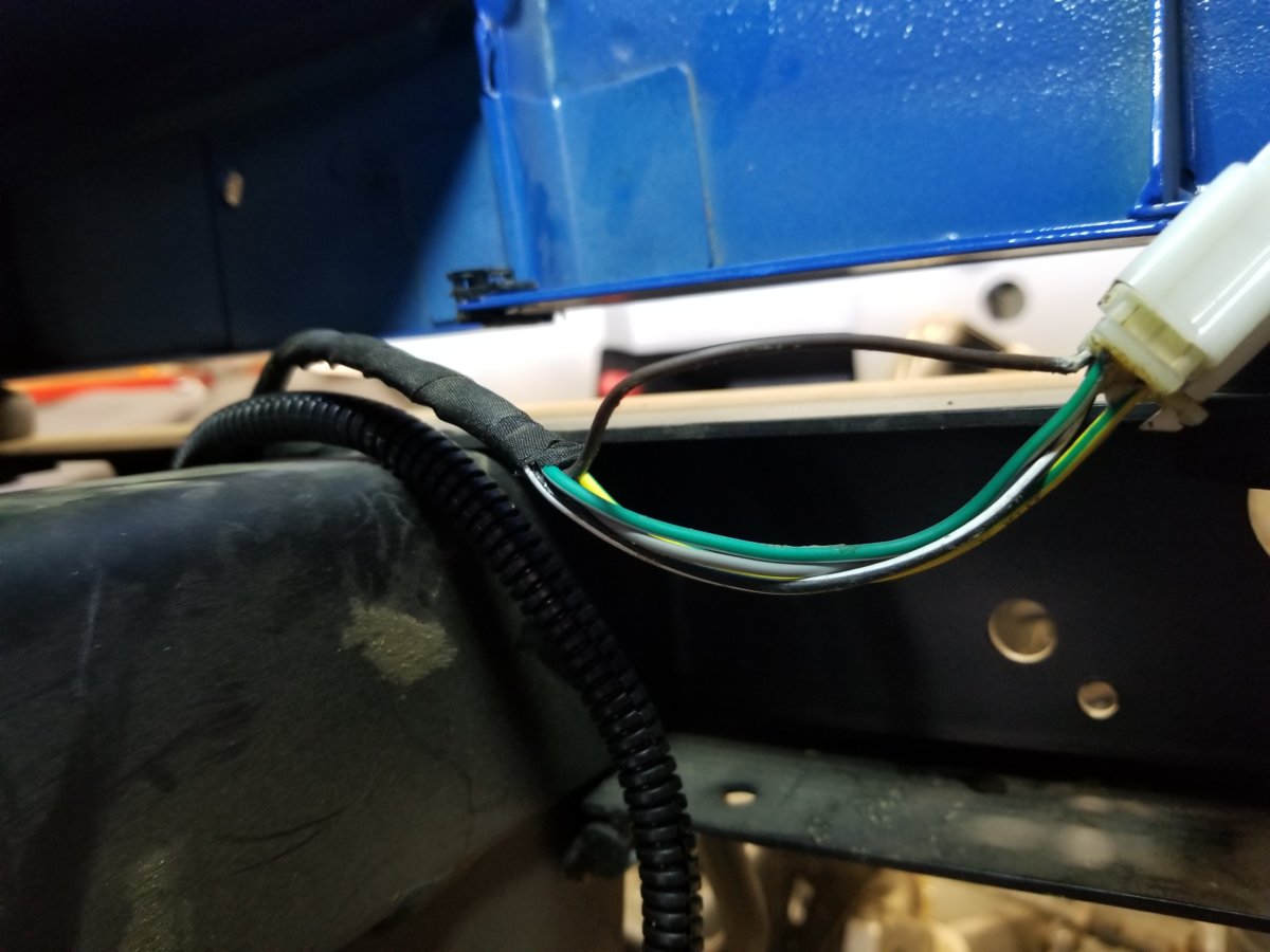

I left the stock wiring alone and laid down a new drop with wires I had on hand. I saw trailer light wires available for $10 at autozone which would be ideal. I followed factory harness route.

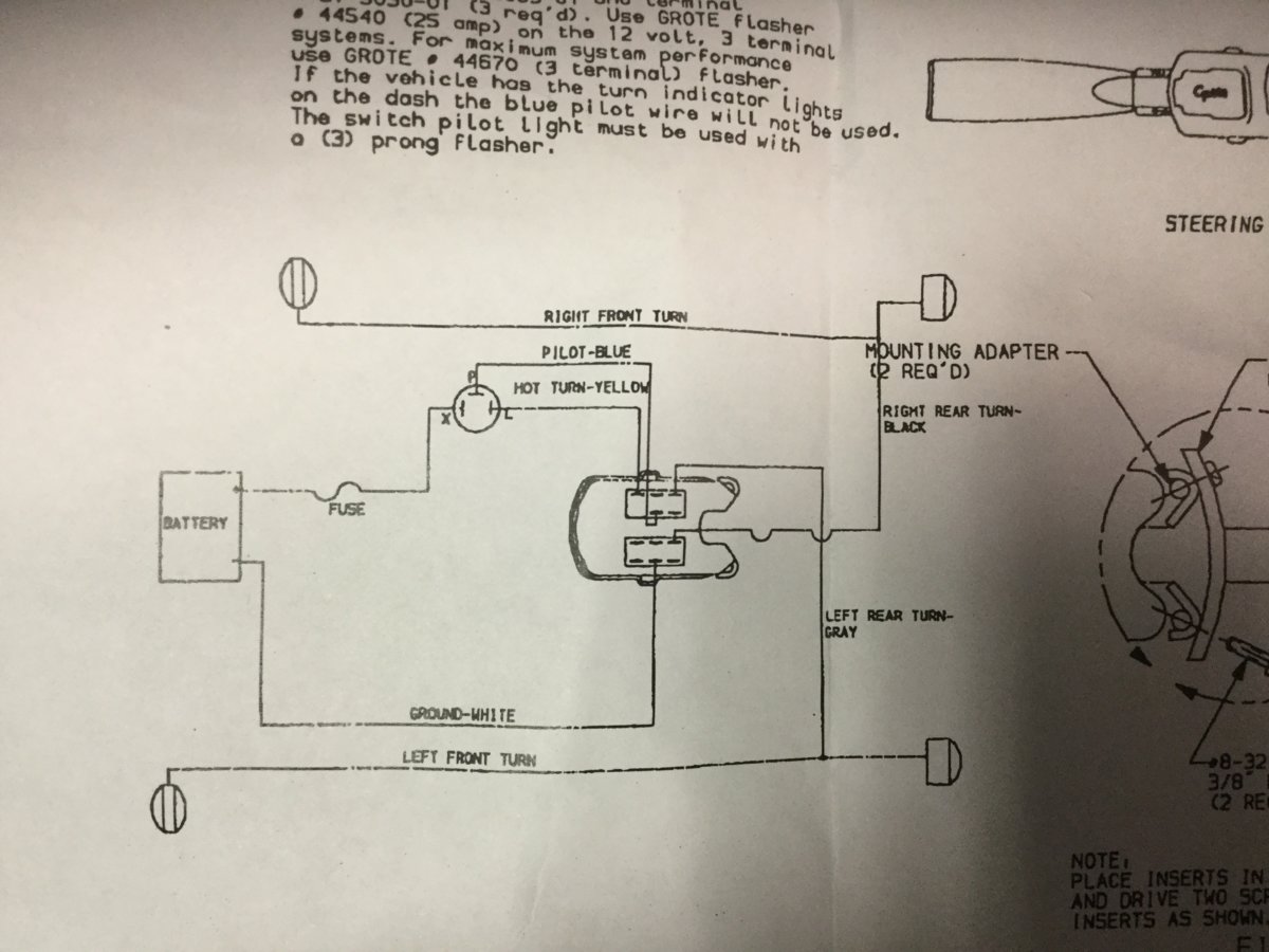

Hey guys, I’ve installed car amplifiers, capacitors, and speakers in my Trailblazer before, but for the turn signals im stuck. I can’t get the Grote turn signal to light the leds lights inside the turn signals. The diagram has both the right front lights and right rear light attaching to the black wire. Well each light has a positive and a negative, so I have 4 wires to attach to a single black wire, it didnt work. I havent tried grounding the negative wires to the frame and attaching the positives to the black wire. Any ideas or duh’s ?

I used a 900 switch but it’s very similar.
From what I am seeing you need to wire the positives from the right signals to the black wire and the negatives to the frame.
I utilized the factory rear signal so I didn’t have to ground it and I grounded the new front signal to the bottom bolt that holds in the headlight.

I grounded all mine to the frame if that helps

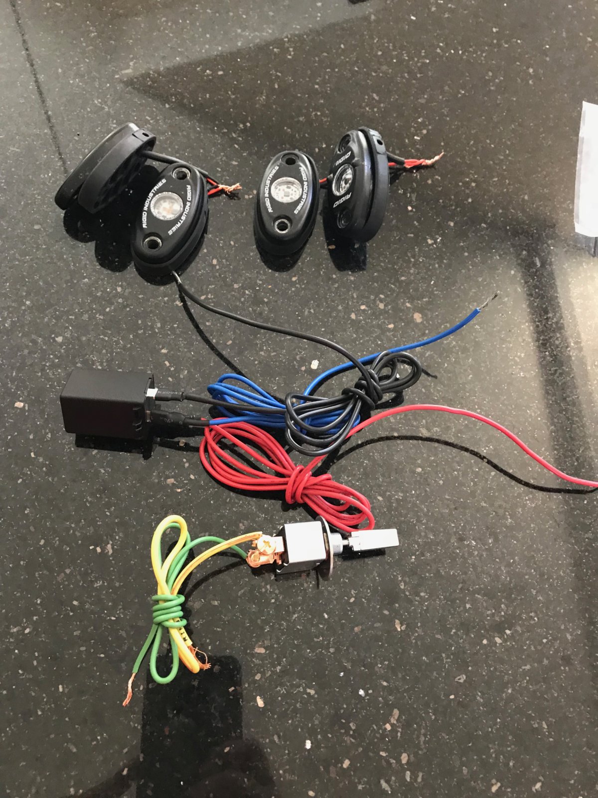

Ok. I’ve done some update on my turn and 4 way flasher using a EP34 flash relay, a on-off-on and a on-off rocker switch, two amber LED lights and I tapped into the two unused incandescent lights already in the tail lights. The Switches cost around $10 to $15 and the flasher unit was around $15z. So around $35 to $40 for above mentioned, whatever you want to spend on the 2 amber front lights, wire, connector, and shrink tubing. My a series amber Rigid lights cost me nothing as I already had them laying around and they were given to me. The EP34 flasher is both LED and incandescent bulb compatible. I can vouch they work fine. I already had the wires, connectors, tubing. My cost as it’s now is around $60. I’ve seen amber LED 3/4” hole for around $8 ea. So I can’t see someone going more than $100 for this set up.
It’s simple and cheap. Just some applied knowledge, not that we wire up turn signals on a daily basis. And many can learn from my mistakes such as water proof that flasher relay. And better splice points.
So I’m going to say, I’ve seen the XTC and other turn signal kits. Honestly they are way over priced to the point I see them taking advantage of their customers. If that’s harsh then so be it. No sense in sugar coating it. So if adding $150 to $200 more just to avoid a few extra minutes of work is worth it then rock on. These kits still require you tap into a power and ground, the work required to lay out the wires is the same amount of work as just doing it yourself. My splicing work is way solid and weather proof by using uninsulated crimp connectors, a good crimp tool and shrink tubing to seal it up. So you might learn something new and I don’t have a problem sharing my knowledge.
My set up is simple and requires just a simple learning curve to have the 4 way flashers on and darn near exact function as the $300 kits. I say darn near because I can do without back lit switches and one turn signal has to be on to make the 4 way work. It’s not rocket science.
