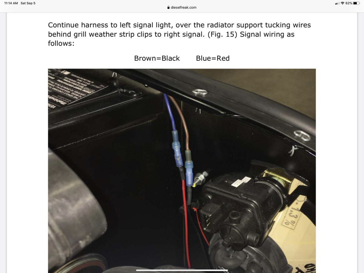

When installing the Willy’s turn signal column mount Everything worked great. When i turned on the headlights the passenger side would not blink properly (Dim). Any feedback would be great. Going to check the ground first and see if that will fix it.

UPDATE: After going over all of the install to make sure we didn’t miss anything and testing the wires we decided to switch the wires on the passenger side (instructions say) black with brown and red with blue. Once we swapped blue attached to black and brown attached to red the problem was solved.
