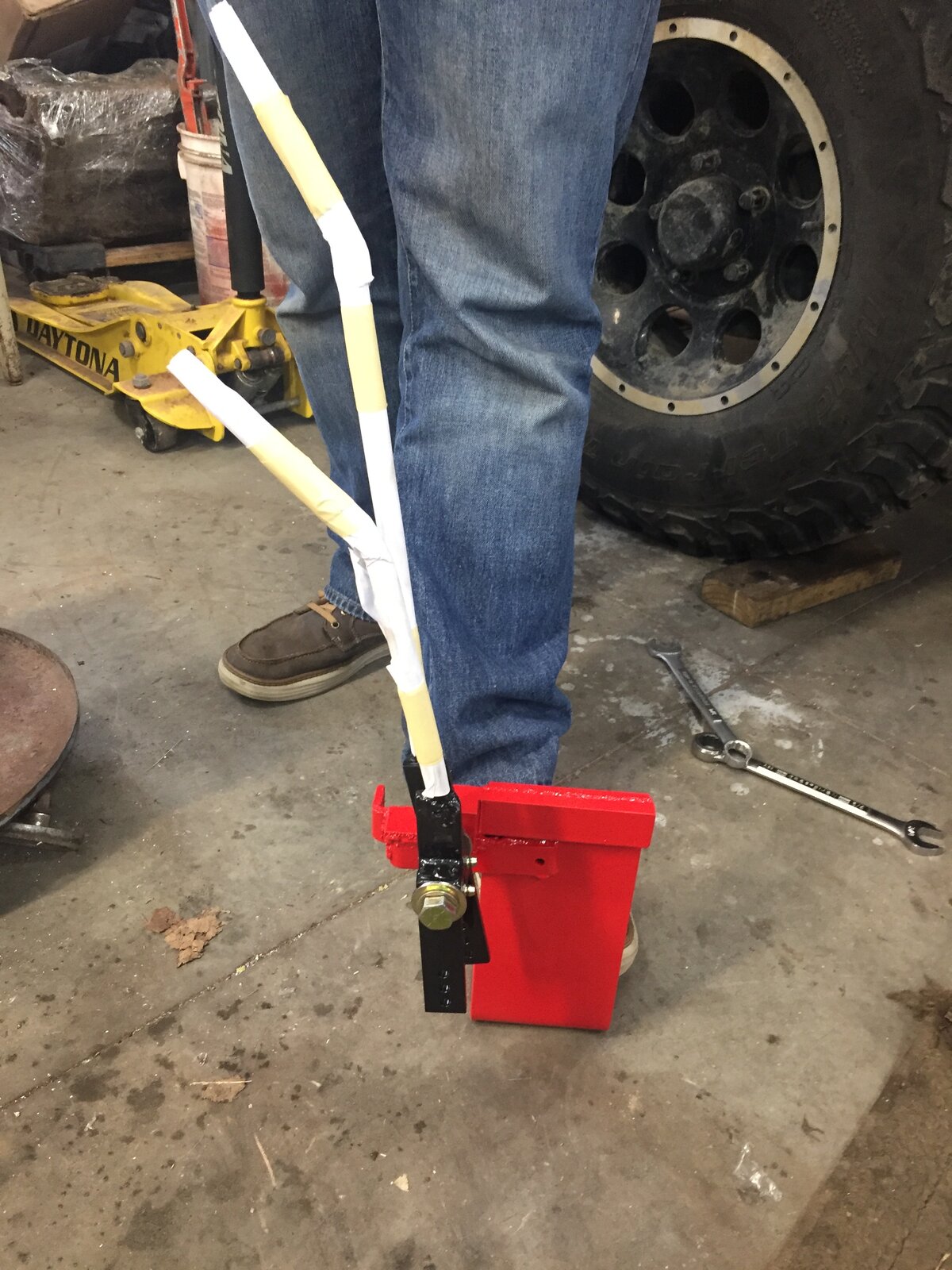

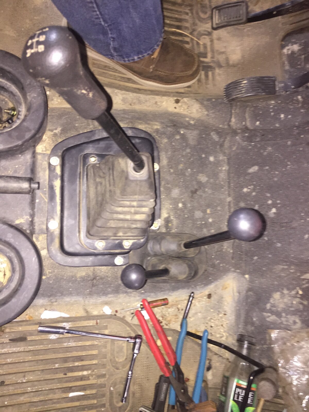

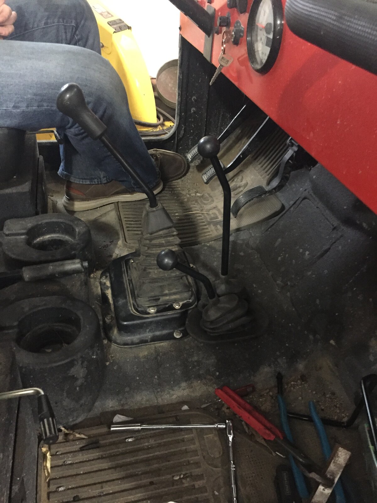

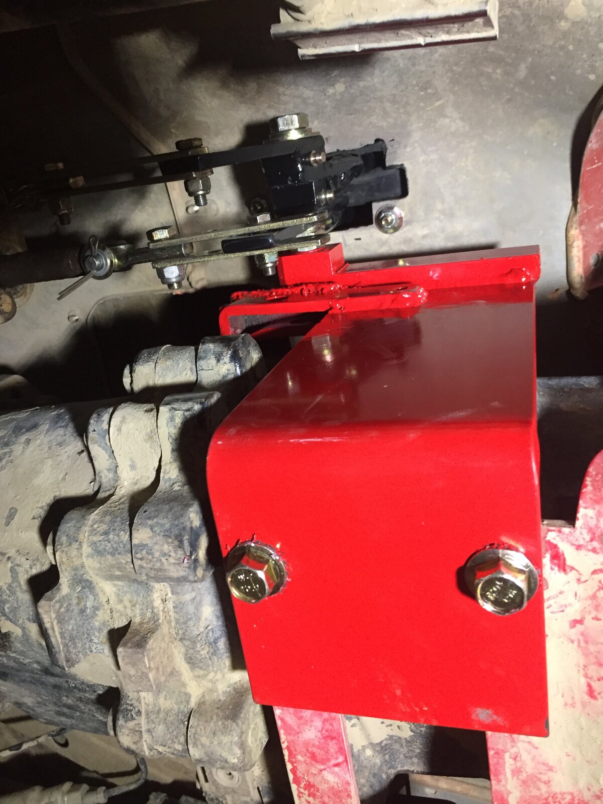

OK just finished install on a twin stick. My son and i made two for both are Roxors. And no, a twin stick does not allow you to have 2wd-low. To have that option you need to remove the front output housing so you can remove the "Rod shift" as it is called in the Roxor part catalog. Item #48. Look up dana 18 lock pin removal and you can find some good video no this. Yes we removed it not hard at all and the dana 18 gasket fits, cost like $2.00.

Have you ever needed 4 fwd, reached down and graded that single shifter. *hit its in neutral, now i am stuck. Well with the twin stick that problem is gone. And for a $2.00 gasket and a little time you can remove the "lock pin" in the transfer case and now you have 2 wheel low and high, or 4 wheel low and high. And with the added height of the shifter i can put it into 4 wheel drive with two fingers. Try that with a single stick. Plus it scars people who can't drive a manual trans, "LOOK THERE ARE THREE STICKS" LOL

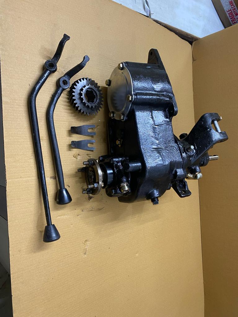

Ok guys, bear with me here…… I just rebuilt the Dana 18 T/C in my 1964 CJ-5. In that process, I acquired a donor unit from a cousin. So I’m looking at changing my Roxor into a twin-stick. I know that the shift rods and nose piece are different from the Jeep unit. I’m REALLY tempted to jump in and swap out those parts to accomplish this, but I’d like to know if there are perhaps any other differences that could bite me in the butt. In my experience, I’ve gotten into the most trouble in my life by getting into something without knowing all the facts.
Any help out there?

Hi ,Just in case you are stuck let us know we have complte parts available for two shifter T-18
