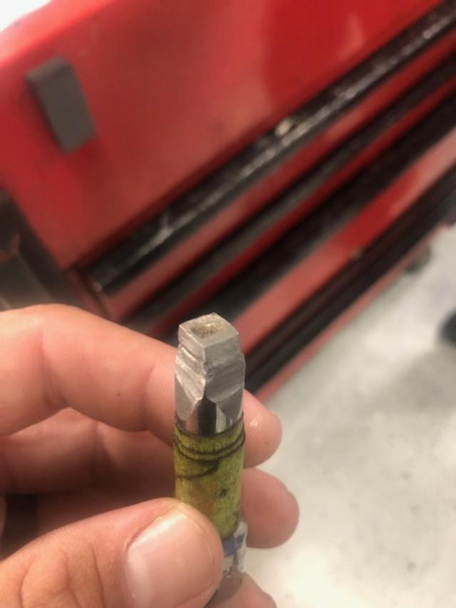

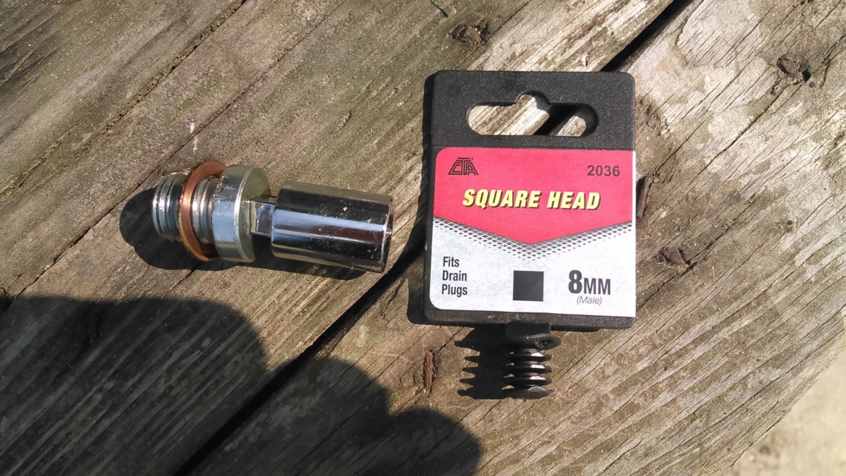

I am sorry your request I received said square plug.
The drain plug takes a special fabricated tool. If you take a 3/8 extension and grind down all 4 sides to fit that is what we use in our shop. Please see pic below.

My transfer case plug also an unknown square drive. I have since welded a 19mm nut to plug and cut out a soft copper washer. BLAM! Solved. Until I find a suitable plug.

I have it on good authority that the transfer case is an 8mm square drive plug- I'll post when the one I ordered from amaz comes in - it was just over $3 delivered with prime- I will most likely get it Friday .

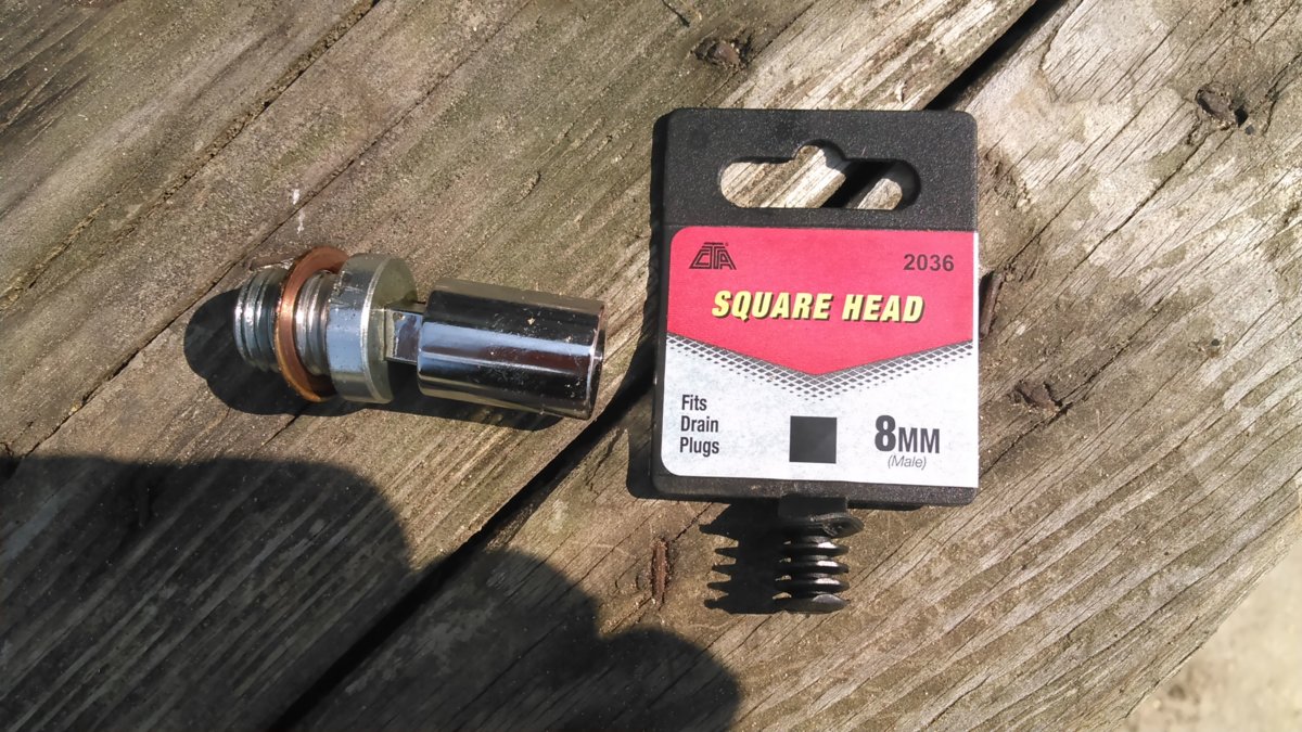

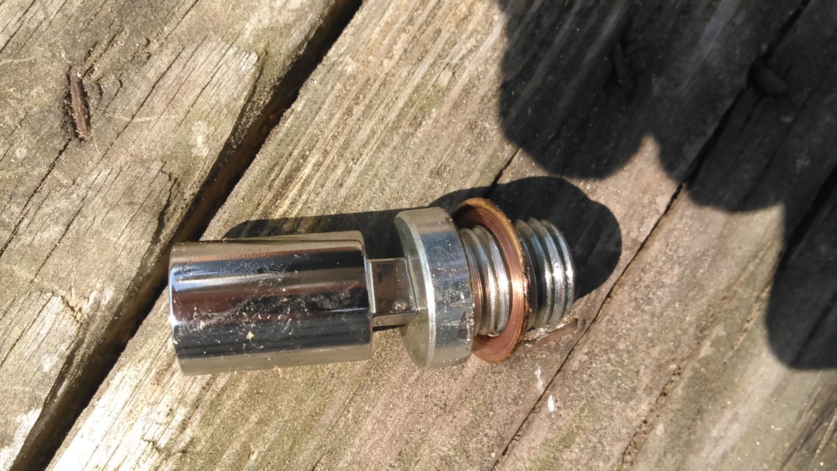

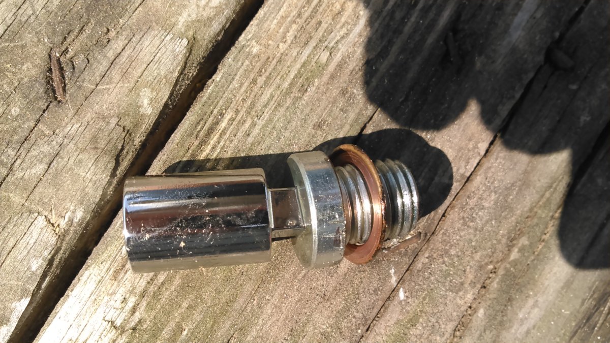

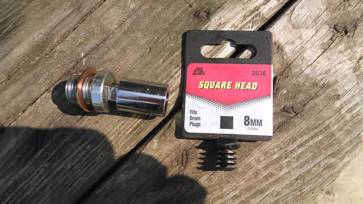

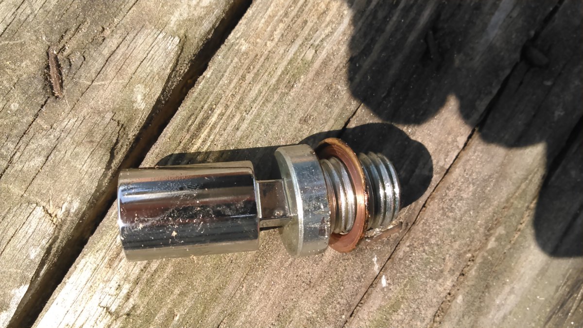

I got the 8mm square drive today and it worked well. If you don't have an extension to adapt, this may be the ticket.
I did contact by message Mr Maki so hopefully will hear from him. Thank you !
