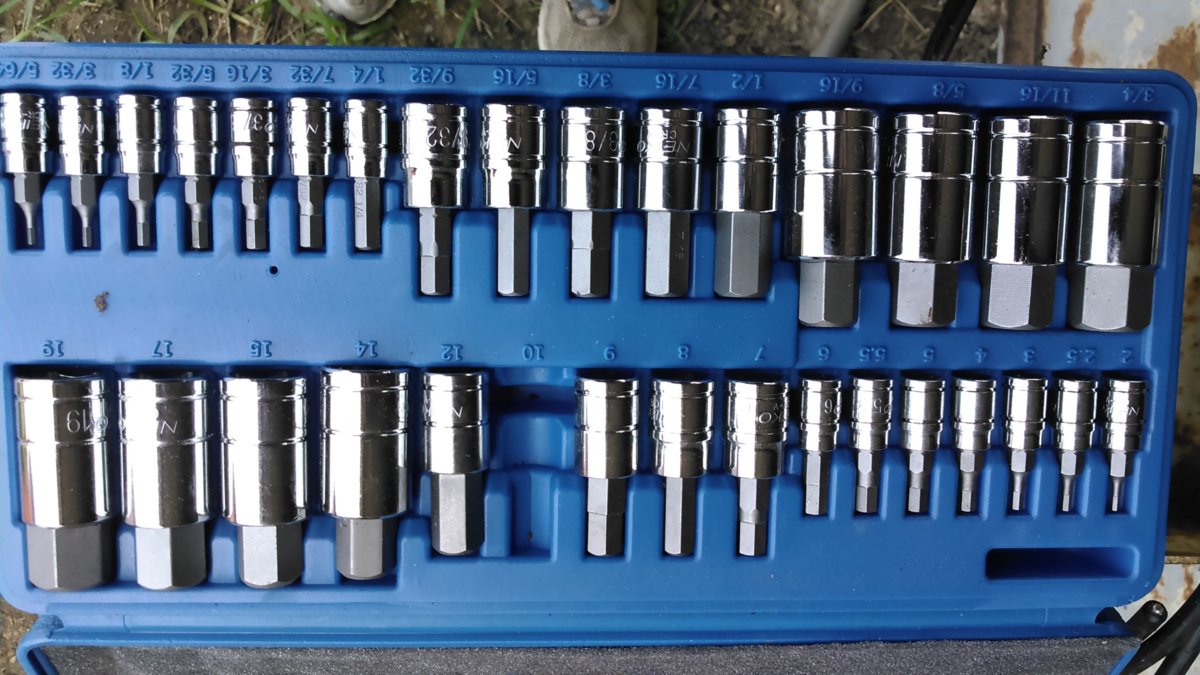

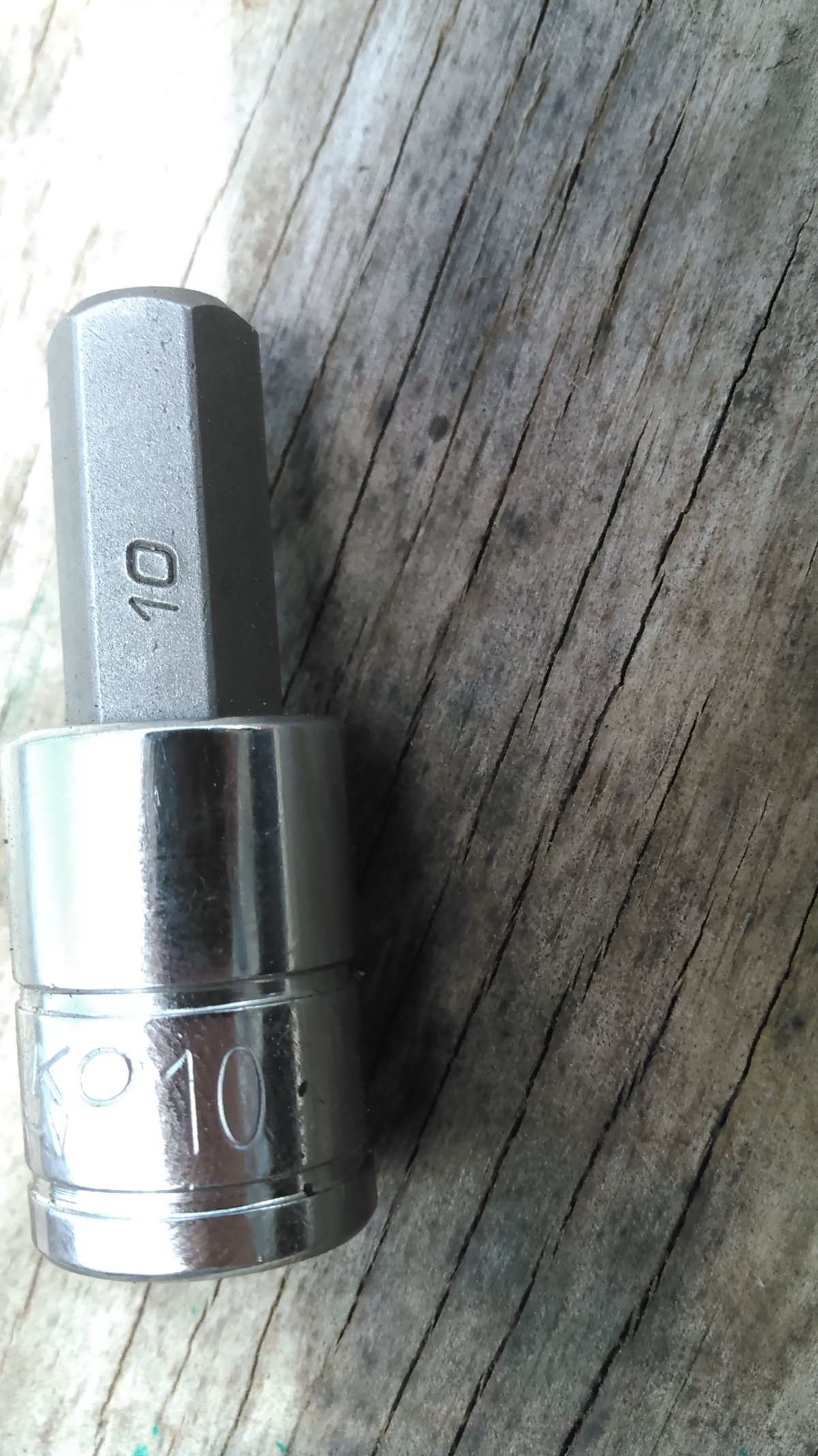

I just went down to the barn and removed my front plugs with a # 10 metric allen . The plug on the drain has a magnet and there was a blob of gunk on it so I would suggest members not forsake the recommended change. Mine has about 400 miles on it maybe a bit more...
My b-i-l bought the set a few months ago and they are so very much better than the ones L shaped.

A similar set is on amaz on for around 30 dollars.

View attachment 4262View attachment 4263
As you probably know, that "blob of gunk" that you refer to is actually ultra fine break-in shavings from internal parts that are made of steel. (Gears,etc) held together with gear lube when they come in contact with the magnet.
Very common during the new mechanical break-in process. You will find that same issue on all four boxes - front and rear diff's, transfer case and transmission - as well as the engine - although much less so because of the engine oil filter process. So, while you're under there you should probably service all 4 units and "gitrdun" You'll feel better and your ROXOR will too!!
