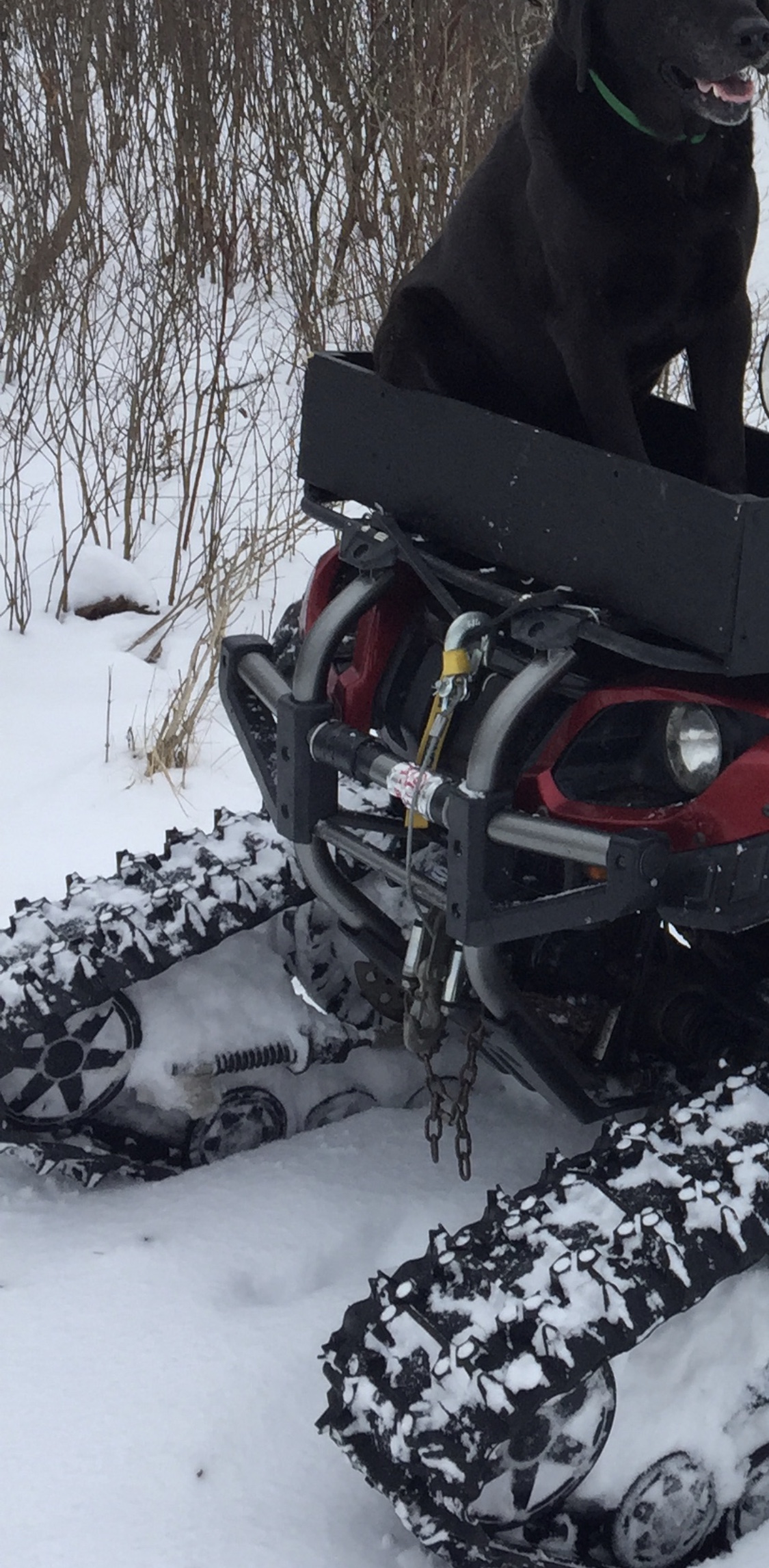

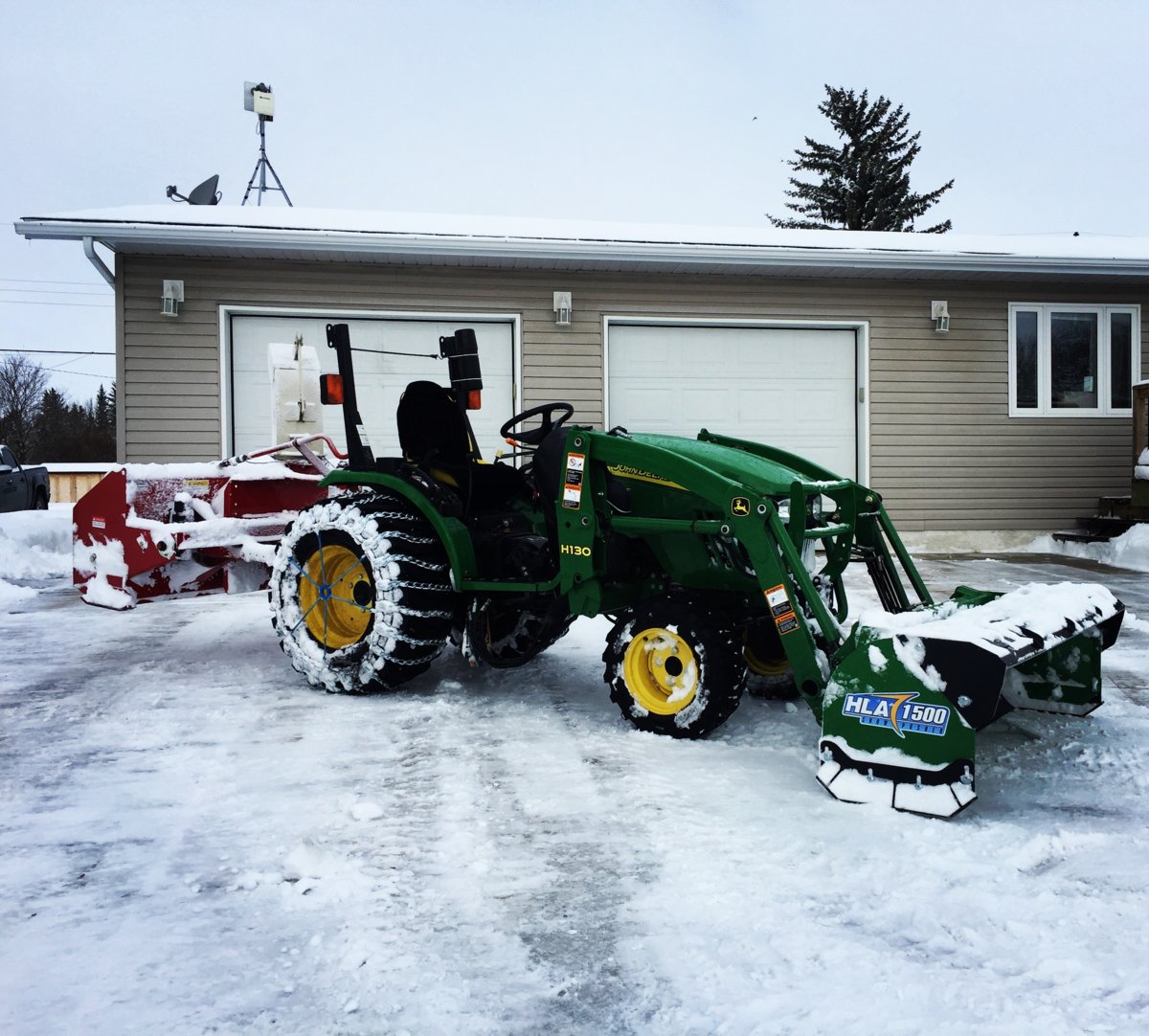

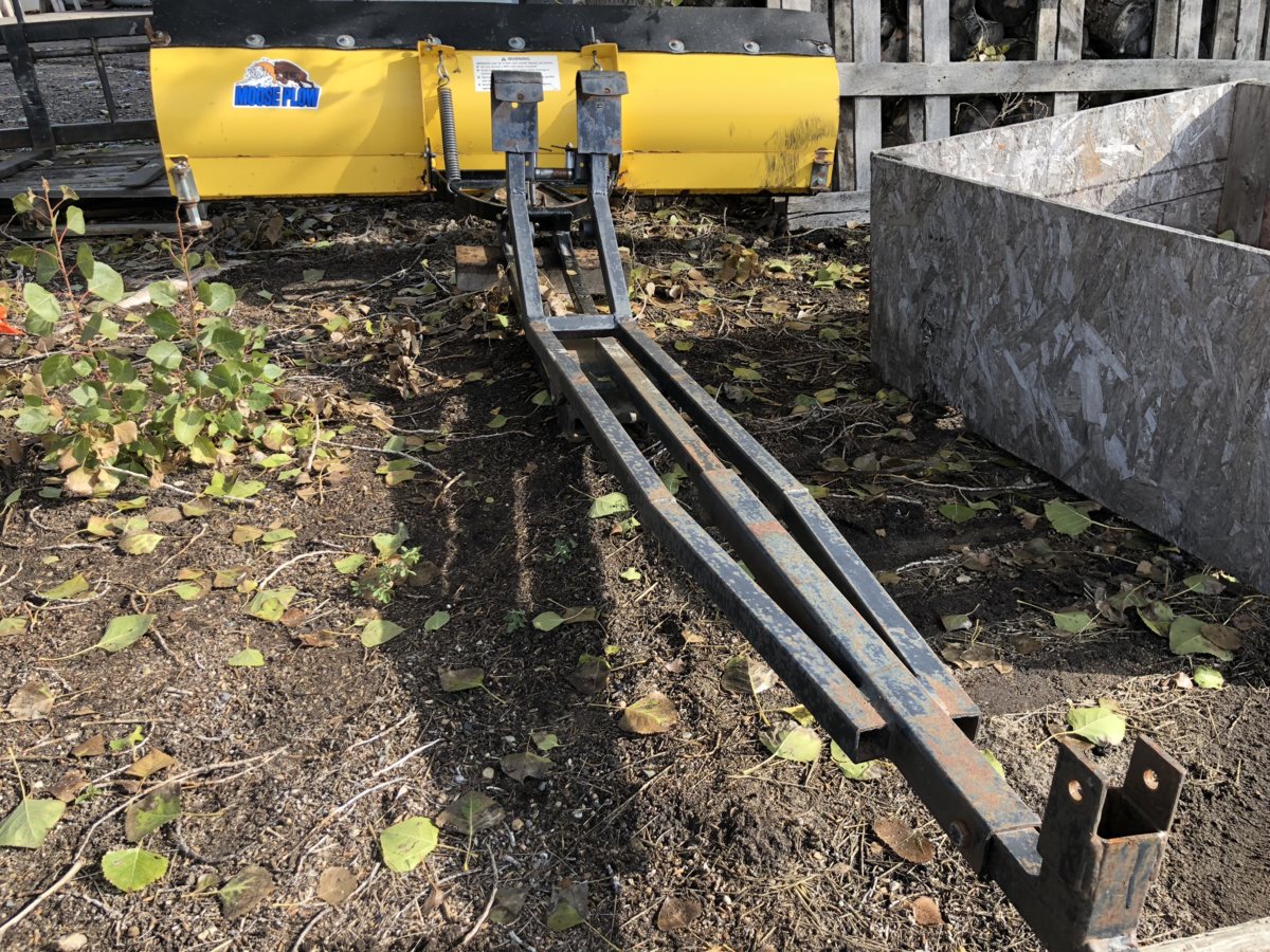

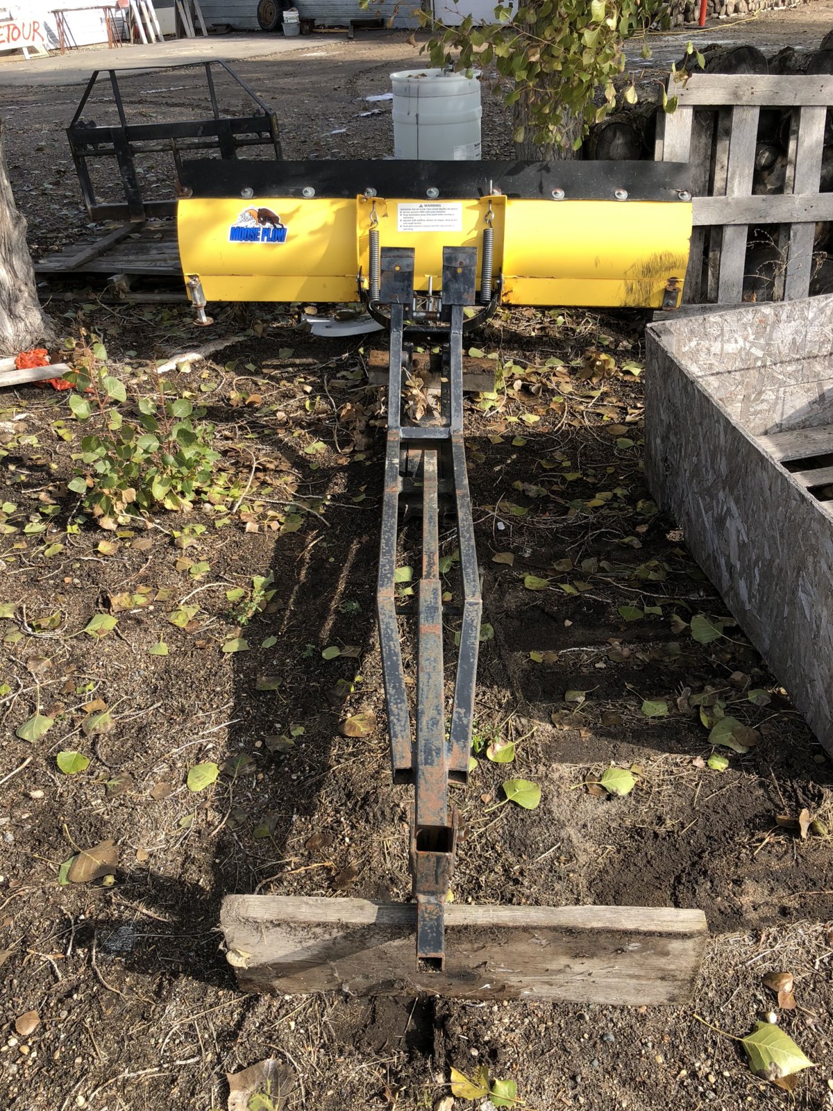

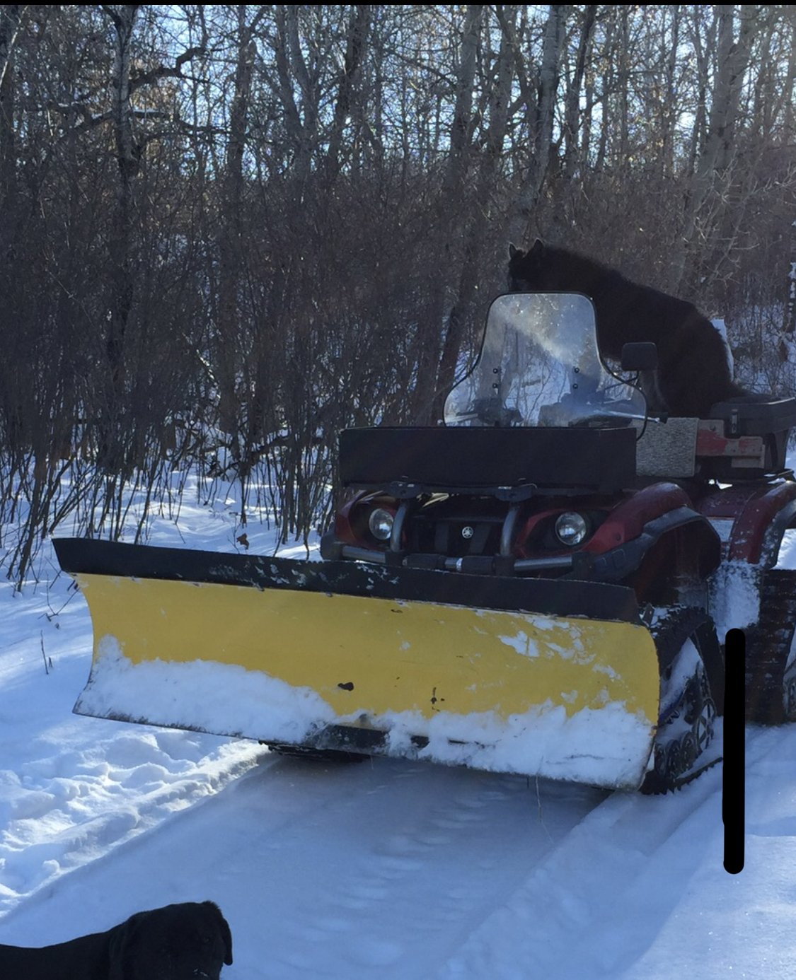

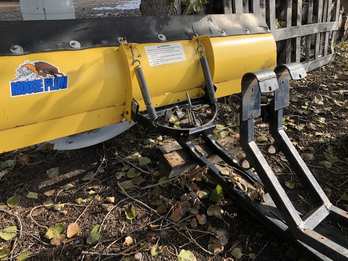

This is the 72" plow that I use on my Grizzly with tracks, my brother made it quick mount to fit 4 different units, so now it will be 5 units. The whole frame that mounts under the unit is homemade and comes off with the plow. The only thing that stays on your push unit is the 2" front mount to hang the plow on, which could be removed if you wanted when the plow is not needed. Originally it came with the light plate to mount it to the frame of a Rhino. You just need a 2" pipe the right height for the front and extend the push tube to the rear hitch and slip in a pin. I'll have to extend the tube for the Roxor. You drive up to it, lift the front on to the mount bar, hook up the winch and lift and it lifts the rear mount into place, pin it and go. On the Grizzly, the mount is the front bumper. If the snow gets too much for this, then we pull out the big guns, my "little" tractor with blower, snow push bucket and tire chains. The plow is mainly for the road to the cabin. Tractor is used around the house and shop in town.
