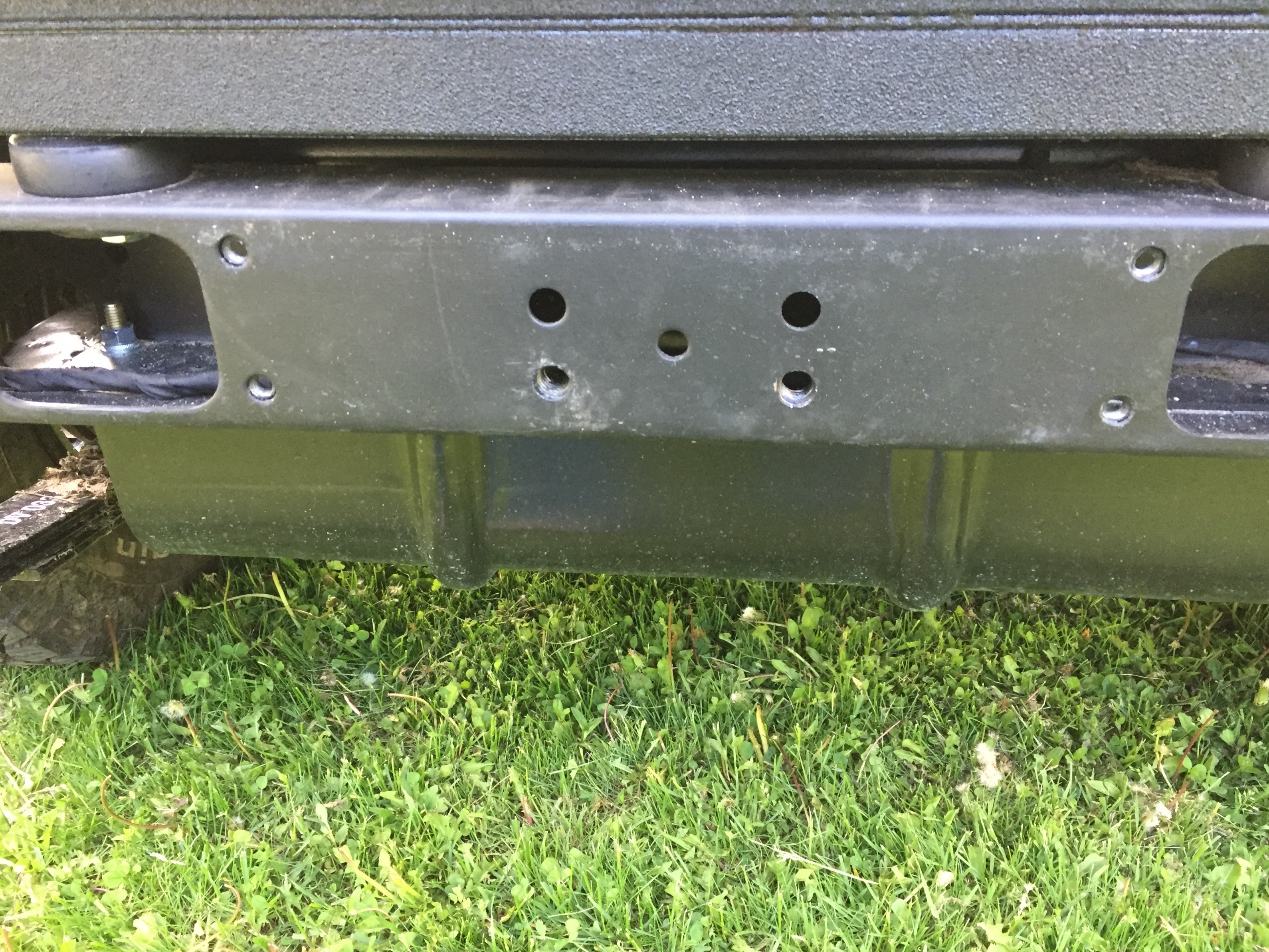

I can see adding the extra plate to the bumper if you want to pull 3000lbs. That back bumper doesn’t look the heaviest. Especially if you are tugging to pull someone out.
Haven't looked at the mounting steel at the thickness, Is it so thin they believe the need for the steel mounting plate to reinforce?
Just looking at the picture, it looks like that plate extends right out to bolt onto the frame mounts.

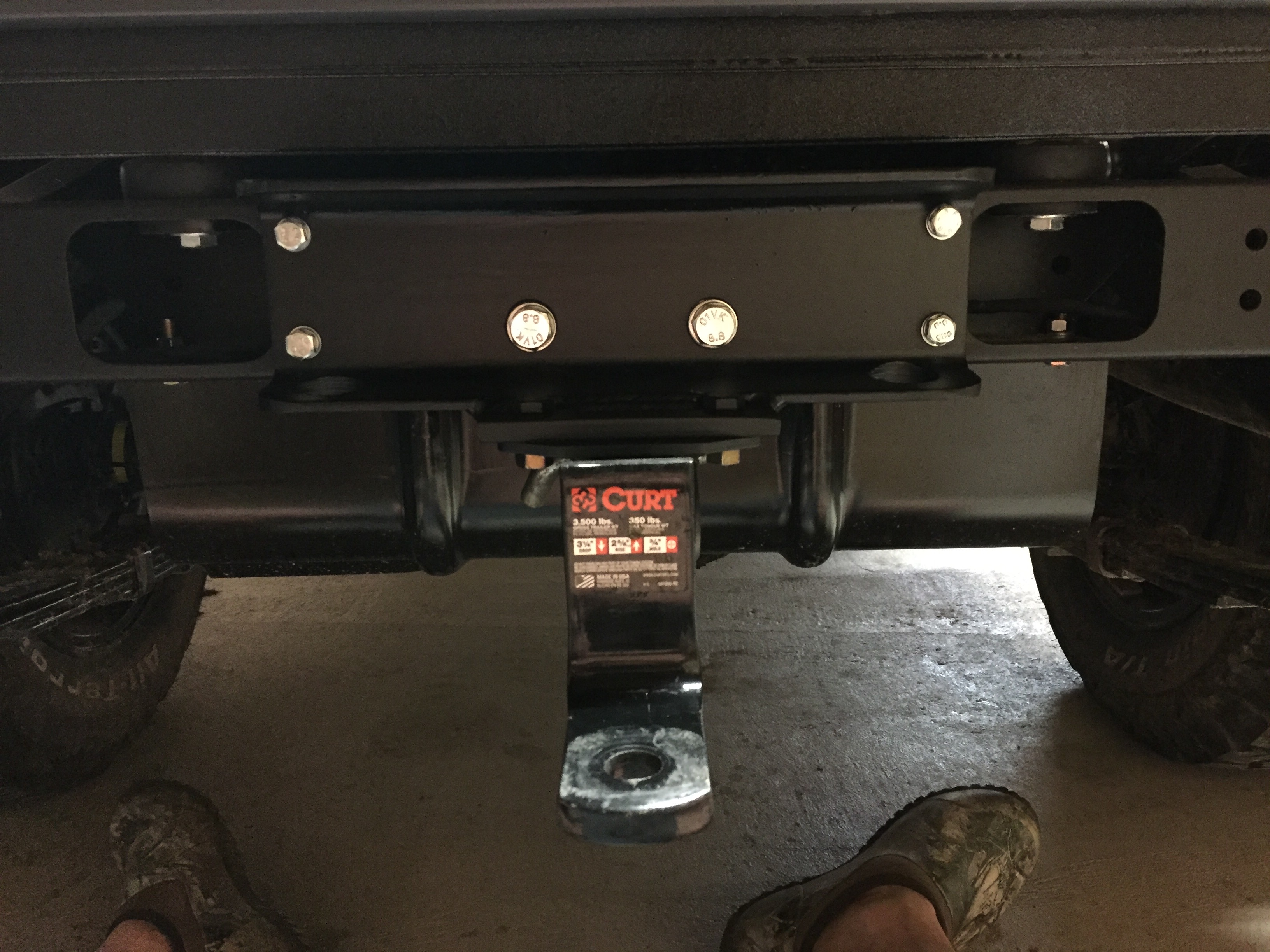

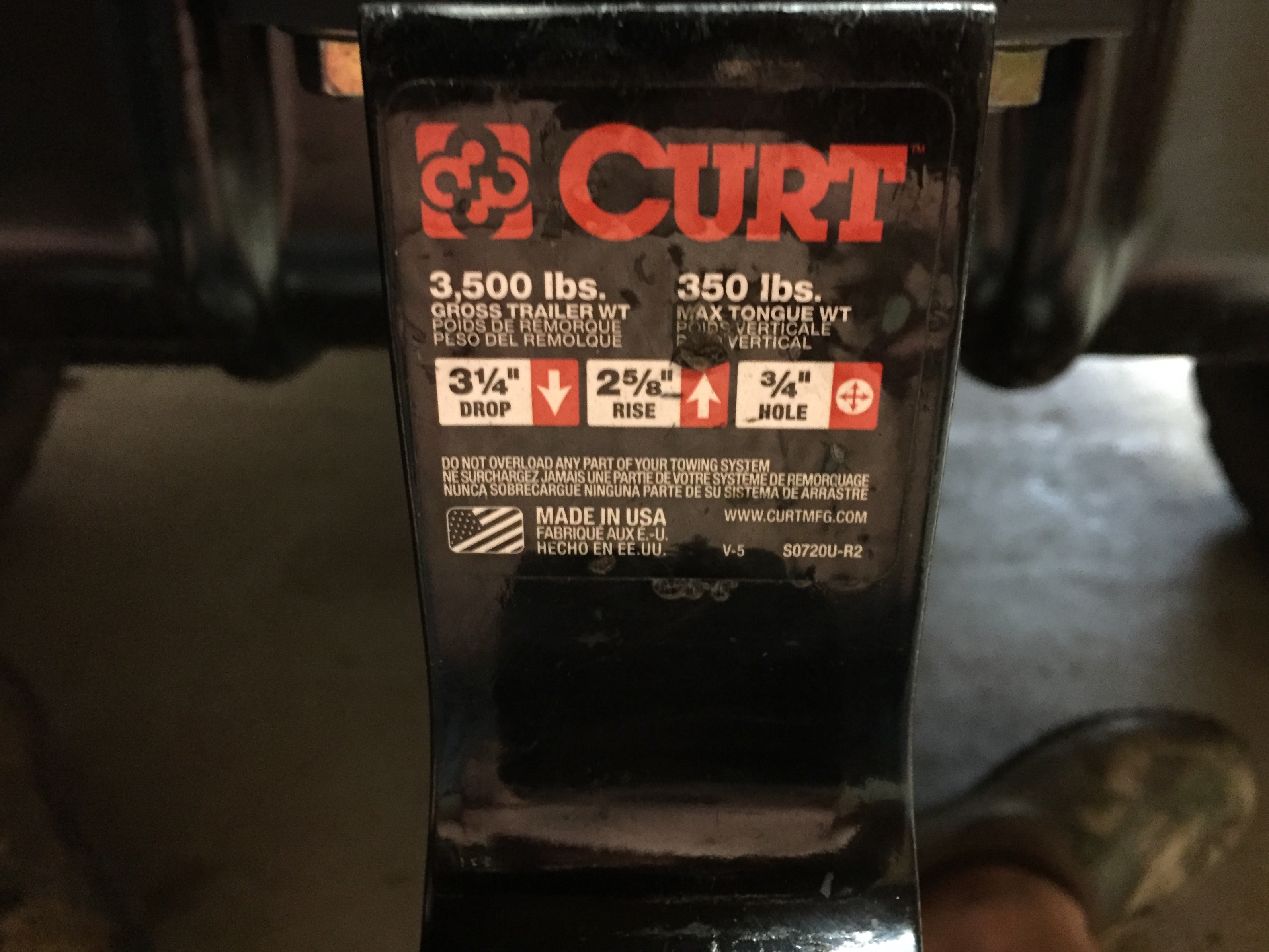

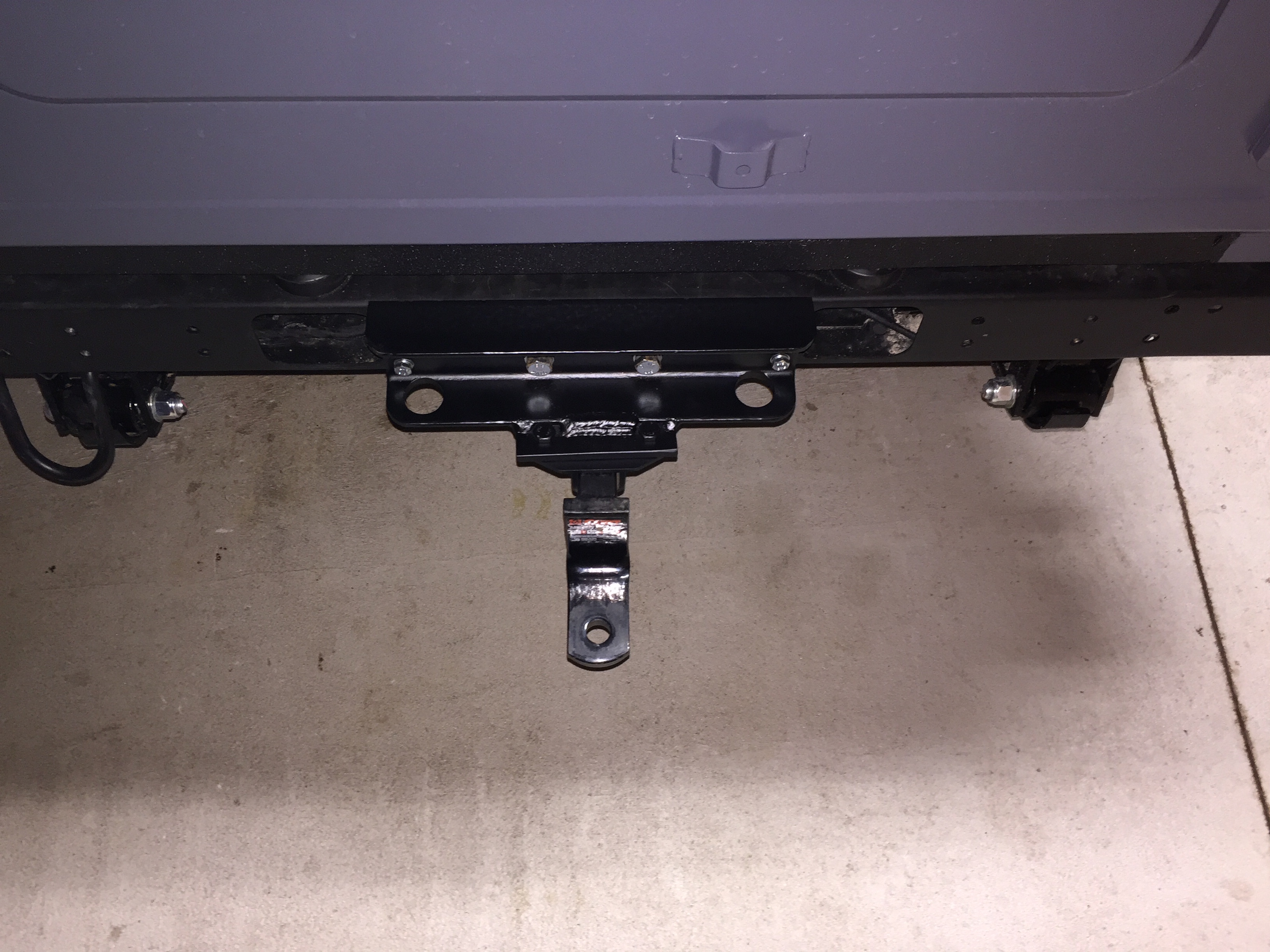

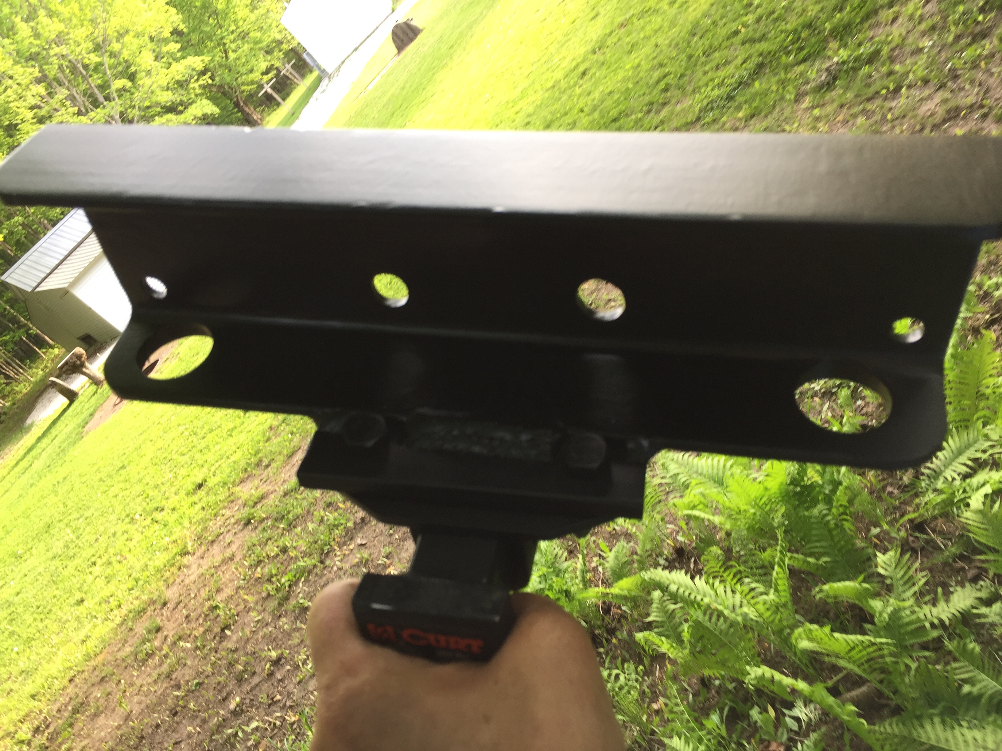

I made a hitch up from some old 4” channel I had laying around. I drilled for the existing 6 holes in the bumper that have nuts already on them. $20 invested since I already had the hitch.
View attachment 448 View attachment 449
3513ED1E-81D2-4967-BBB2-34D25D5369C8.jpeg FA60C7D6-4915-4C99-BFDA-E248D2B16DAD.jpeg
