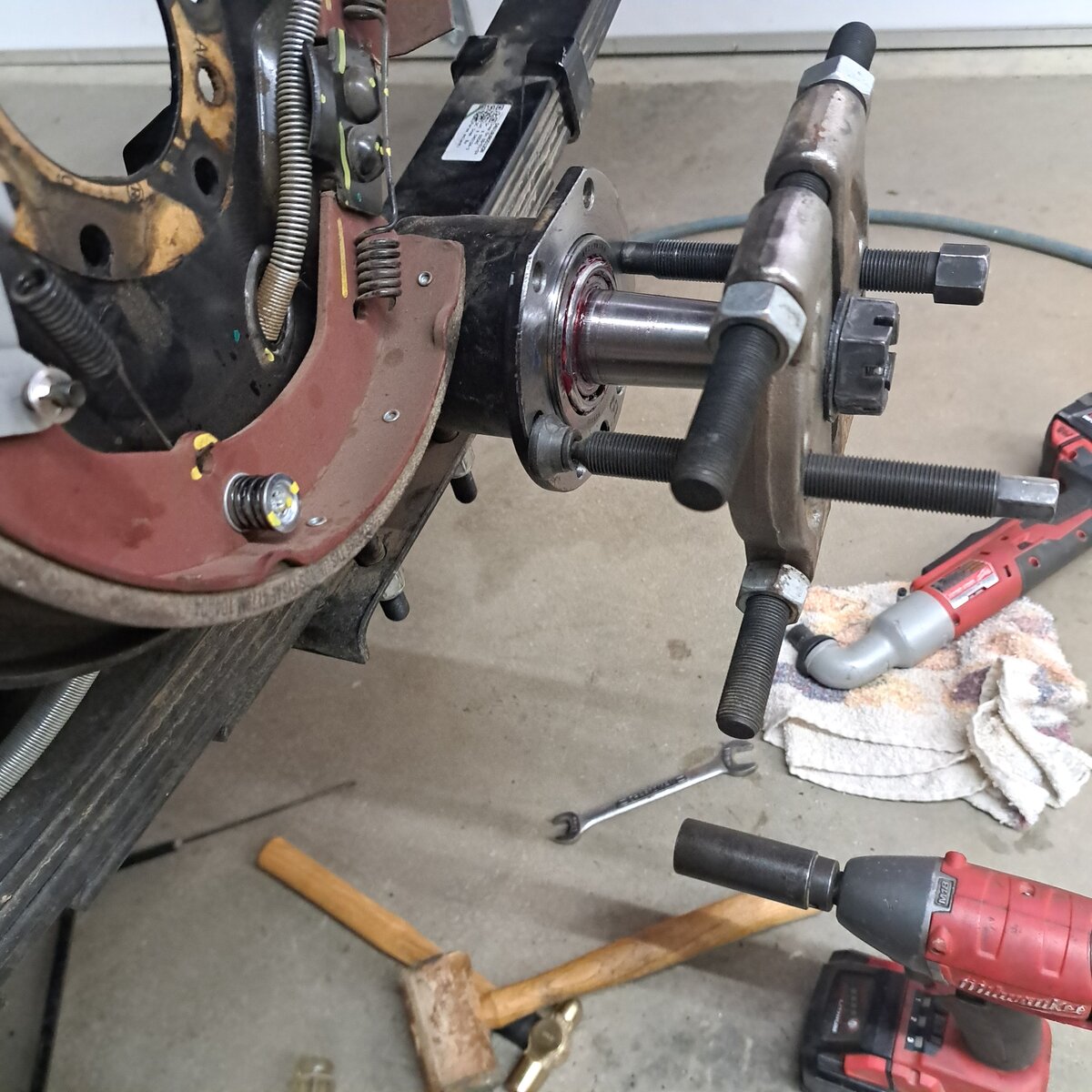

I bought a mechanical puller on Amazon. OTC 7393 heavy duty hub puller. It worked great. Just make sure to use grease on the threads of the puller.
Also, here's a painless way to get the axles out. Use a split bearing puller with the flat side towards the axle nut and washer. I borrowed the 5/8 20 bolts from other pullers.
