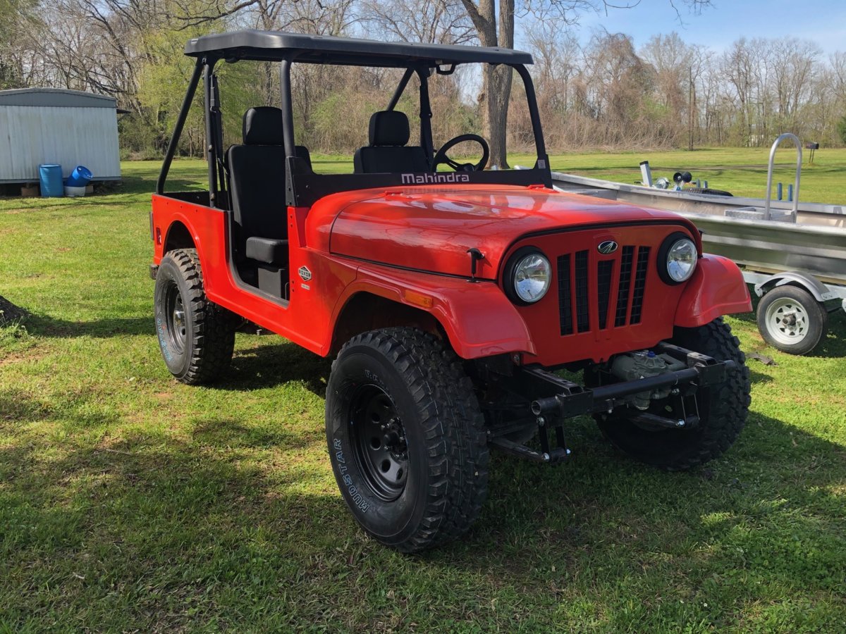

I finally had time to install my Rough Country 2.5" leveling lift this past weekend. In the process, I learned a couple of things that I thought you guys might find useful.

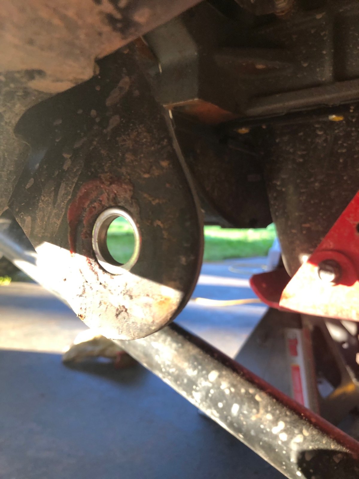

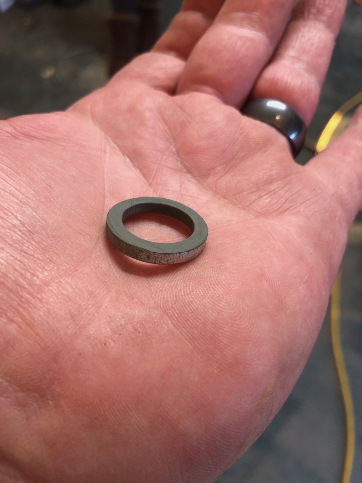

First, I was not happy with the RC solution for bolting the bracket to the rear spring mount since the hole on the inside is much larger to accommodate the stock bolt with grease ports. I realize that the lift bracket has an upper bolt to stabilize this but I was not completely comfortable with it. I bought a 7/8" OD X 5/8" ID bushing at Tractor supply and cut two approximately 1/8" long pieces off of it to put in the holes and make the 5/8" supplied bolt fit snugly on both sides.
