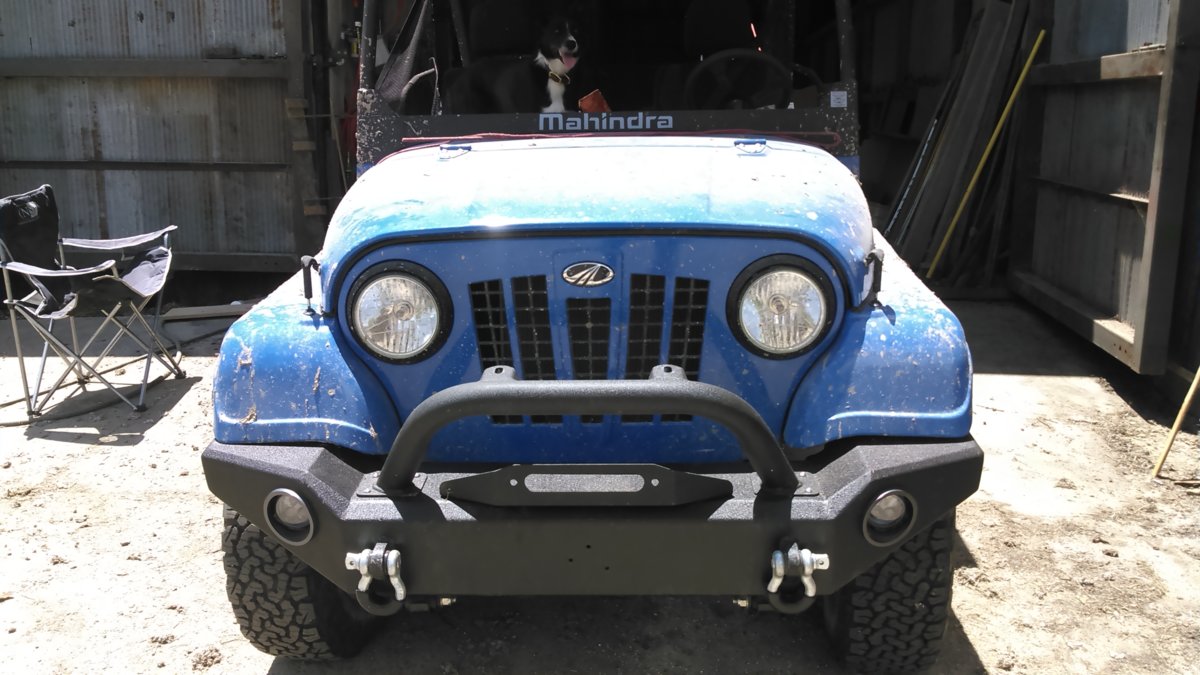

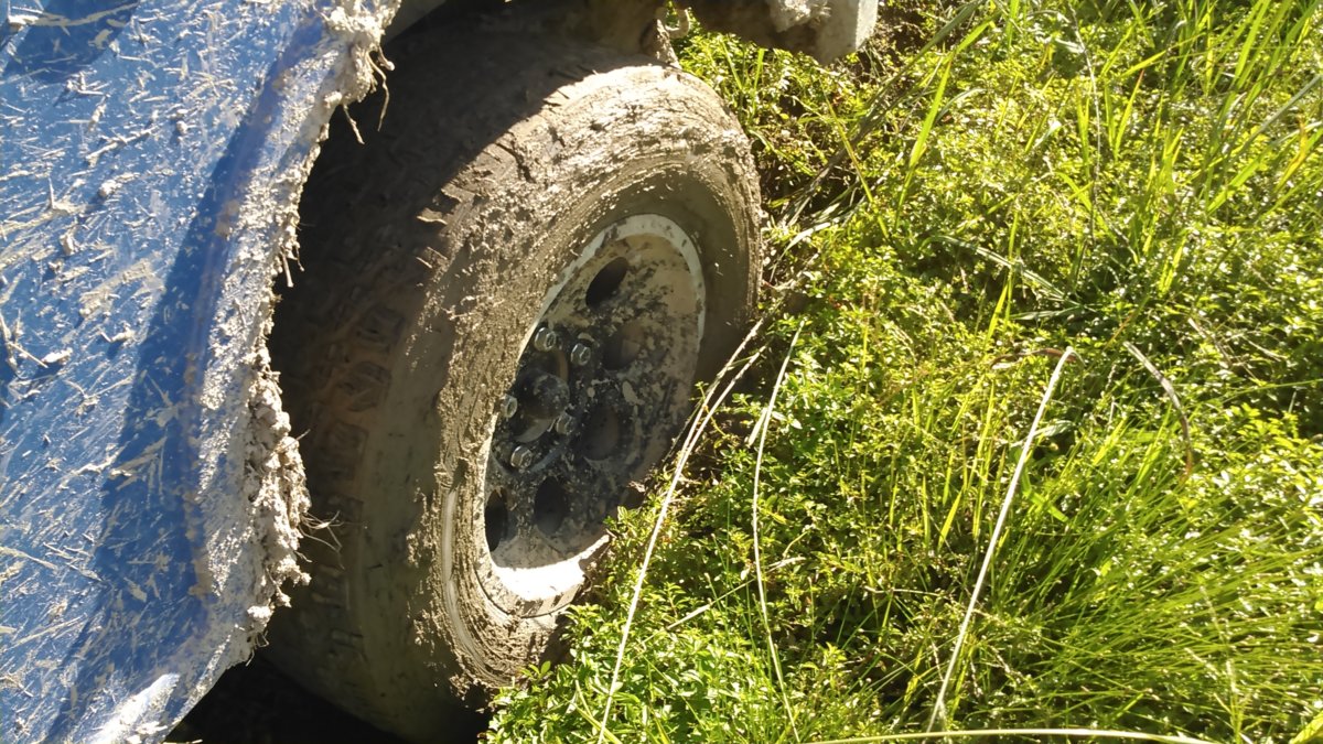

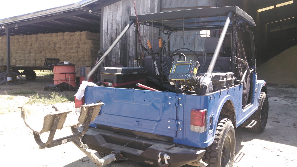

I had a 2005 and a 2011 RTV 900 xt consecutively. I had over 8,200 hours of total seat time on them on this cattle farm. In those years, I only used the rear diff lock maybe 4 times. I avoided swamply areas but general mud and ruts and such I did ok. I did have blackwater evolution tires on the rtv.
On the 2018 Roxor, I bought the plain model . It came with the BFG KO2 tires. That was a BIG mistake for me because those tires were worthless for me and I got stuck several times. They would just spin in the mud and get slick. I sold them to my bil for 300 and they are now on a hay wagon.. I bough some good grippers called Mudstars from simple tire and they changed me from hating the Roxor to loving it. I was about ready to roll it off the bridge but not now. I love that thing. I do have a few issues with it being standard and having so many gates to open in the course of a day , and then spraying fencelines , I need to use 4L to go slow enough. I also replaced the bumpers with some that are cow proof or me proof. ha. and I bought an aftermarket windshield with the hardened surface for 265.. It looks a lot like the oem one but 1/3 of the price. also made a home made roof. and saved $ . I can stand on it to trim limbs as well.
Be sure to check out the tire thread on here. Tire Size Options - Team ROXOR Forum - Unofficial Mahindra ROXOR Off-road Community! Also, sometimes Simple Tire has coupons . :)
edit: forgot to mention that I had a Mule before the RTVs and was never happy with that belt drive of that model ( back then)
also added a few pictures. The middle picture is of the BFG KO2 s which are now on a hay wagon for obvious reasons. Last picture is of the scale for weighing the registered calves.. Love this machine !!
