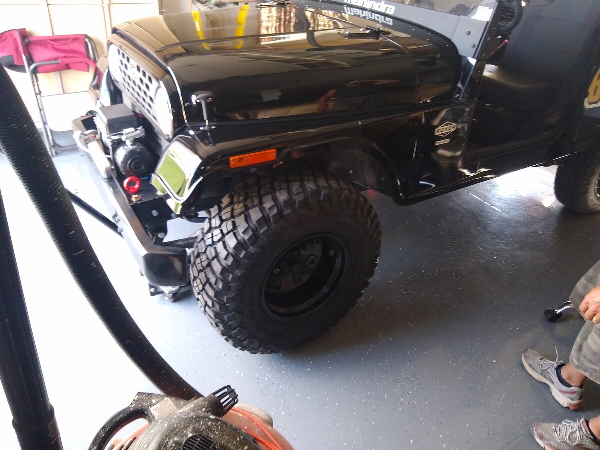

Roxor comes standard with 235/70R/16 which are 29” in diameter. A 235/85R/16 are 31.7” in diameter. I found a tire dealer willing to give me $100 per tire trade to upgrade to the 85R. Looking to increase ground clearance.
So the question is: Without any modification to the suspension, will 31.7” tires work without clearance issues??

Got the 85Rs put on and initial testing very positive. Nice lift on ground clearance! Looks a lot more aggressive. We’ll see how they do with flex. Very happy :)
I’ll verify speedometer with GPS and see if that was affected and report back

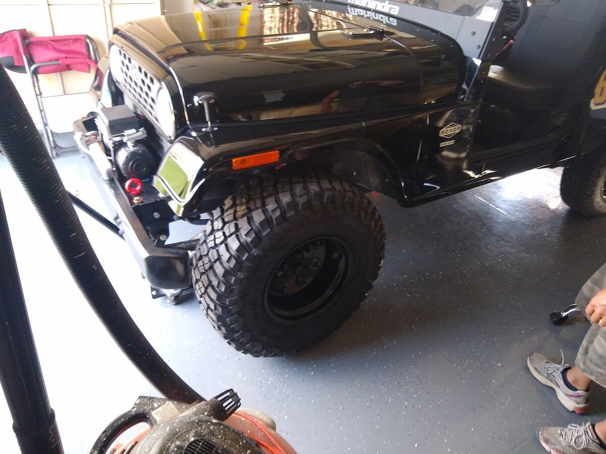

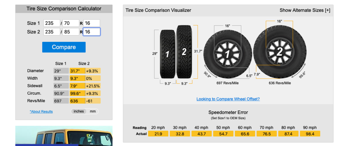

This is a site I have been using to check numbers. Here is a screen shot of the difference between the 2 sizes.
It looks like just shy of 10% difference.

Diesel Freak is programming ECU and I mentioned tire size. They are updating ECU with new tire size!
