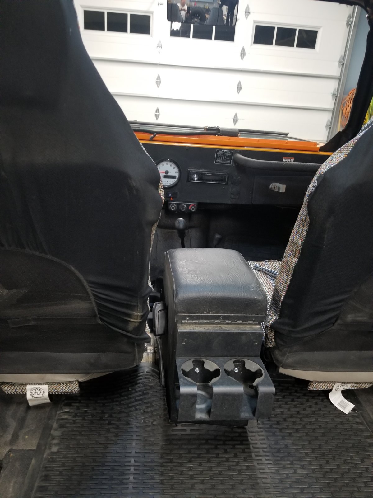

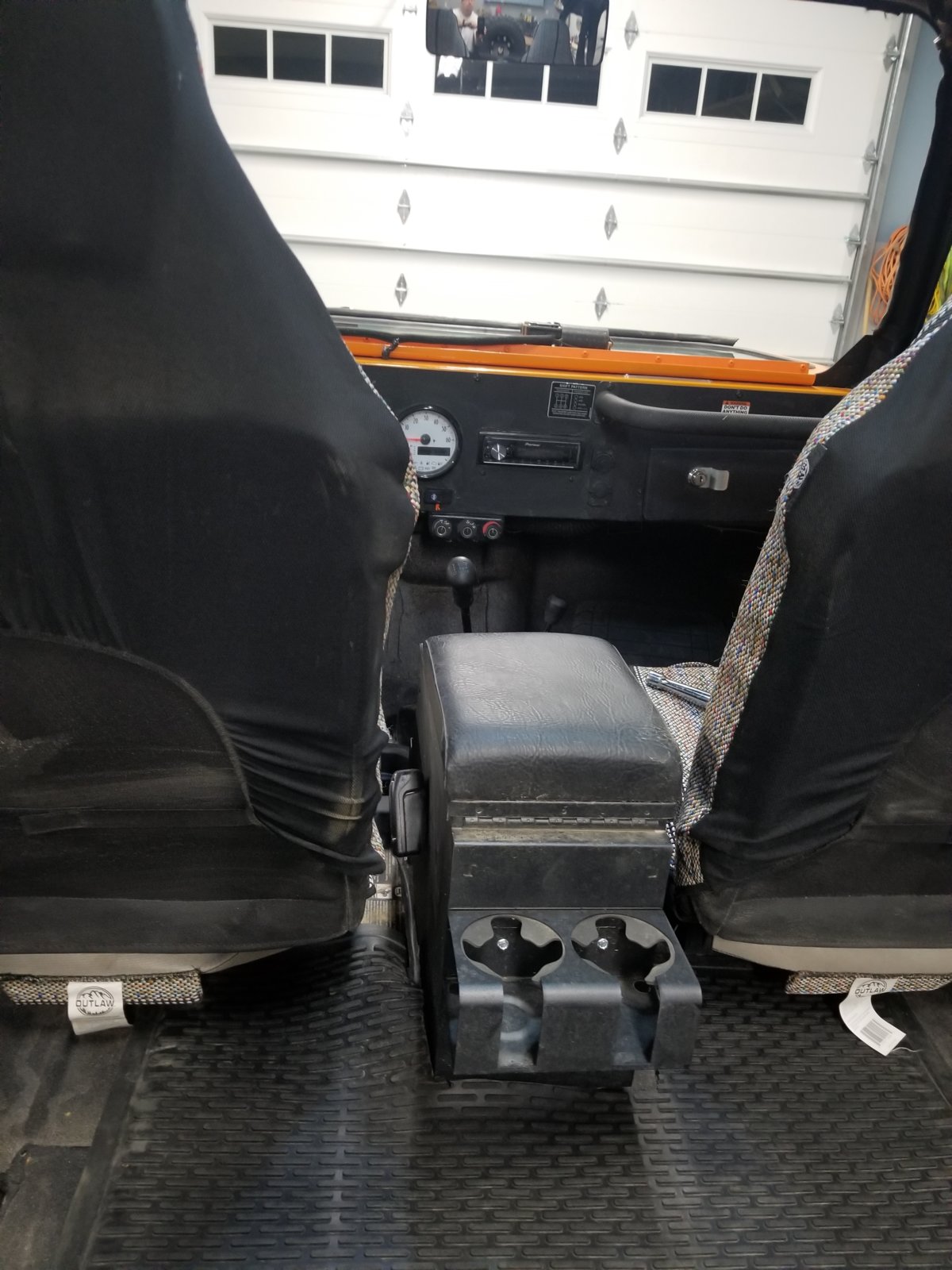

How much room is in the glove box?
both the console and the glove box are made by Tuffy. You can order them on Amazon or direct from the company. The glove box is a CJ replacement and is good sized box. The Console is huge. Both are lockable. The console will require cutting and welding basic fab work-(but easy to do) because of the brake lever. You will have to cut out part of the floor and re-weld it back in at an angle, and also cut out a slot in the front for the lever to be raised. Other than that, it fits fairly well and is nice storage.

Curious what you cut the glove box opening out with. I have one in my Amazon cart now.
used a air cut-off wheel. You could also try a dremmel or similar small metal cutting wheel. I would strongly suggest making a pattern out of cardboard and try to adjust the fit with that. The back of the glove box is a bit irregular and trial fit with the cardboard pattern will save a lot of grief.

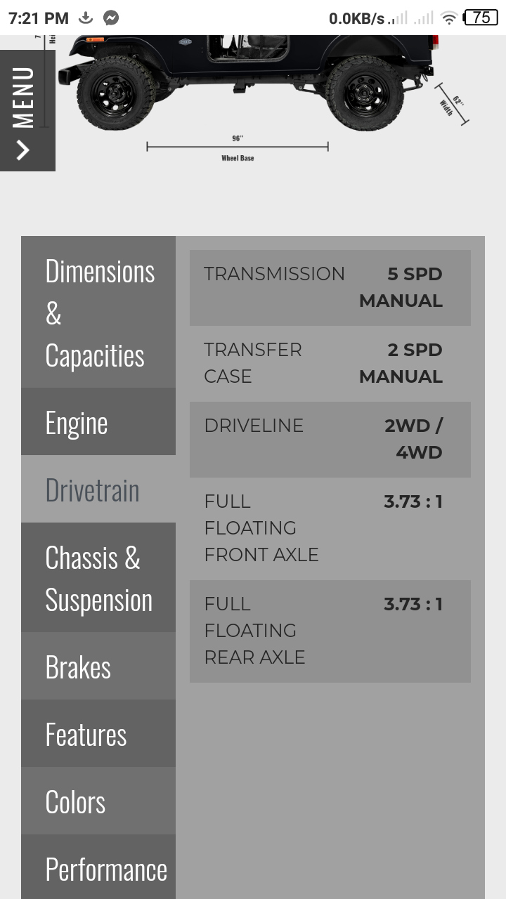

I haven't heard anything change but that used to say semi.
I can still find one place on the website that says semi float rear, and this one that says full float rear.
My guess is the full float is coming, maybe as an option, but is not here yet. I'd expect an announcement from Mahindra when it get's here.

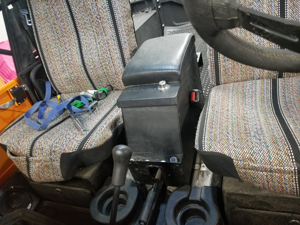

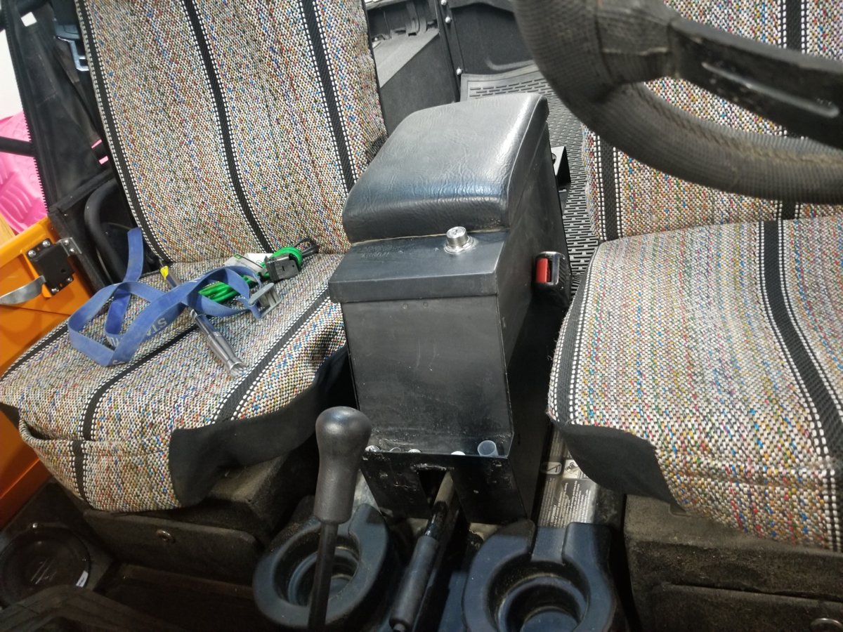

Thanks, here is the locking console I also installed with a little bit fab work due to the emergency brake lever.View attachment 3676View attachment 3677
Nice console! I just mounted a .50 cal ammo box modified so I could put a padlock on it between the seats...works all right and keeps stuff clean and dry, plus it matches my olive green paint fairly closely, and gives it a more military look, but that Tuffy box is really nice. I wish the under seat boxes were a little more weather resistant...I understand needing drain holes, but the big holes in the back wall make no sense to me. You can actually see the rear axle through one of them on each side and after just a short ride on a dirt road, EVERYTHING in the boxes gets covered with a thick layer of dust.
