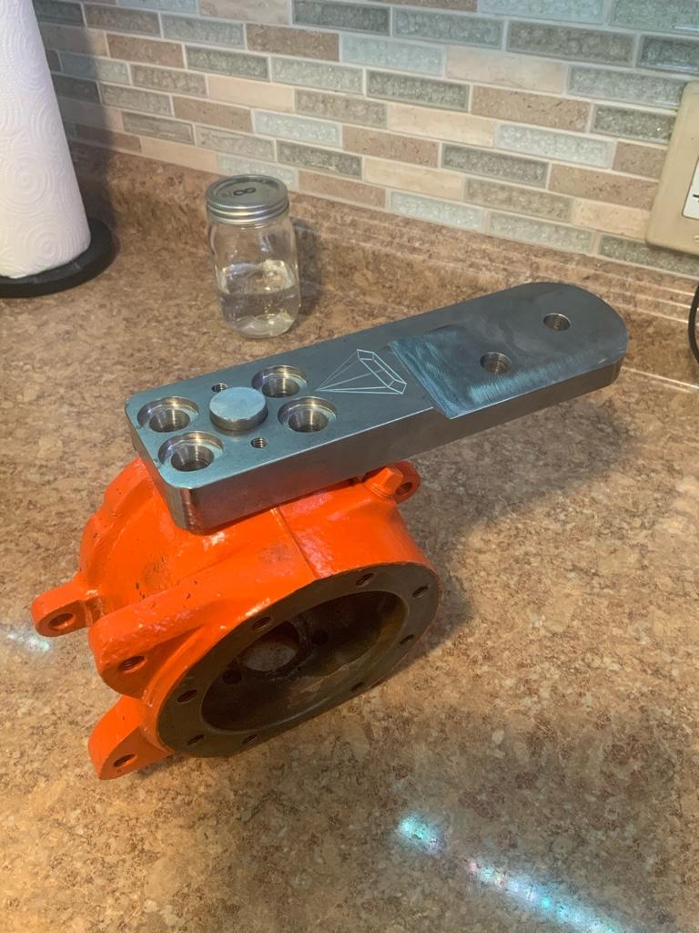

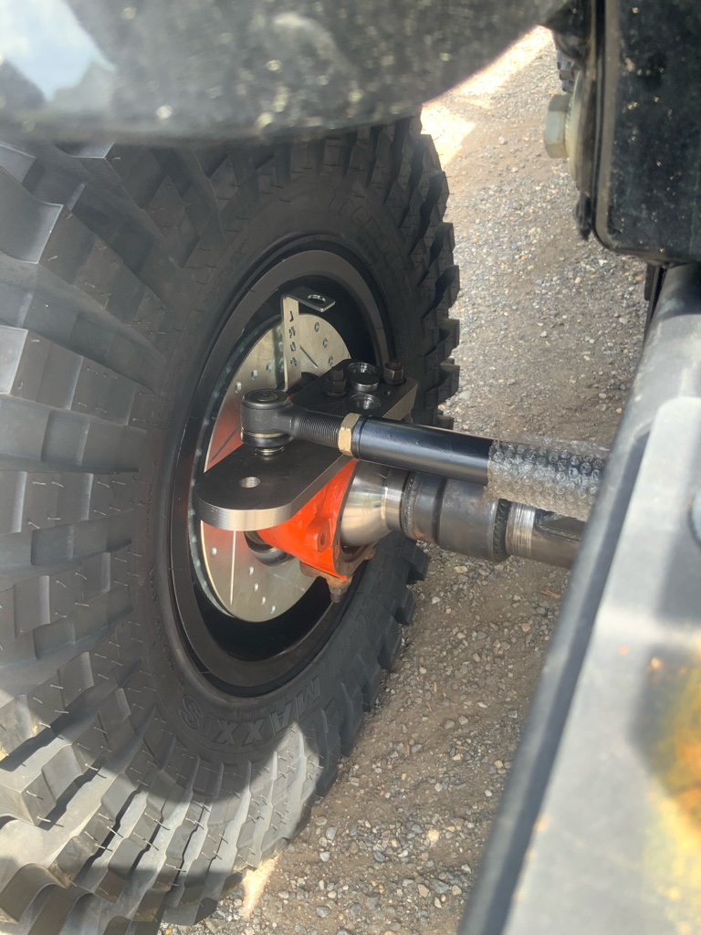

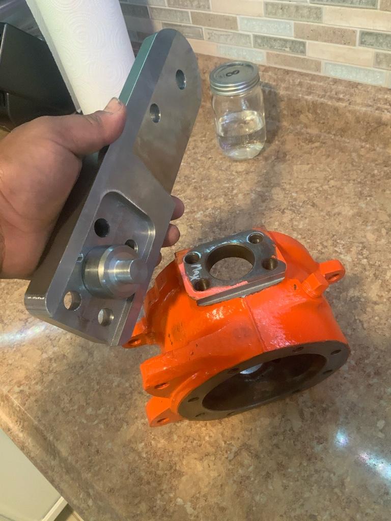

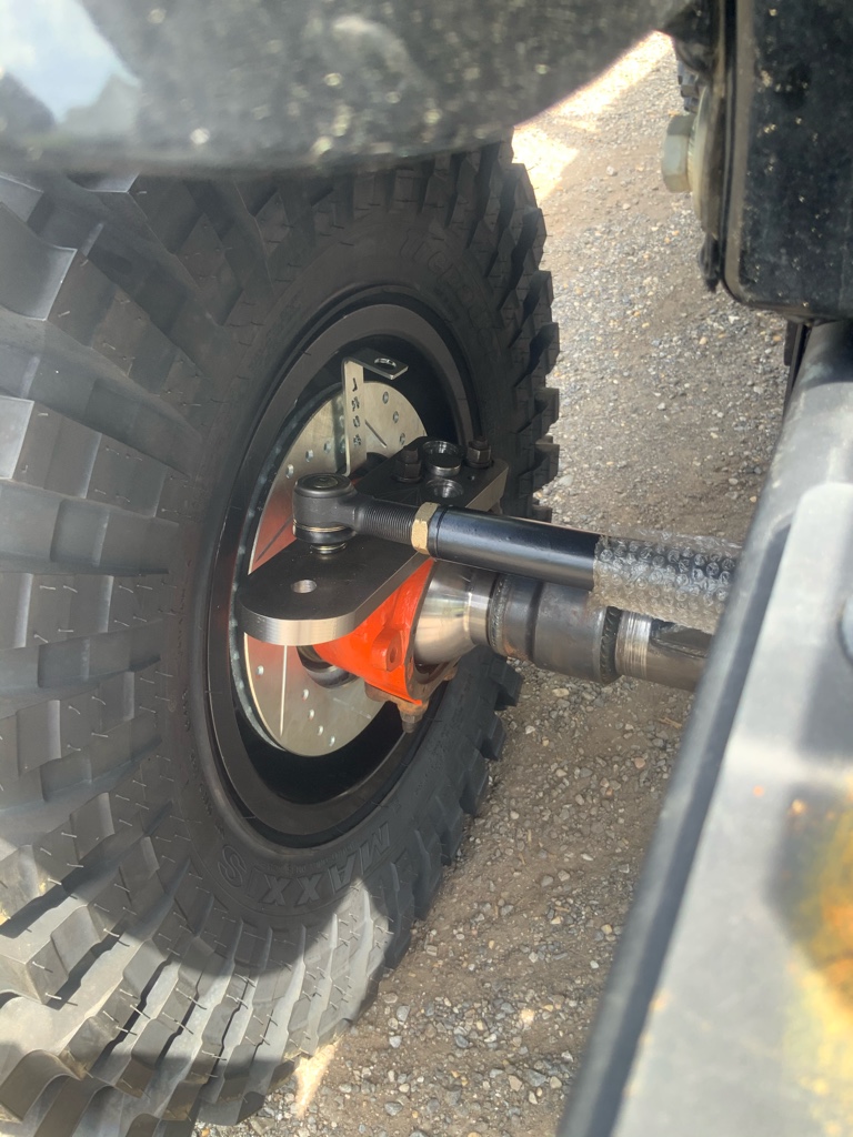

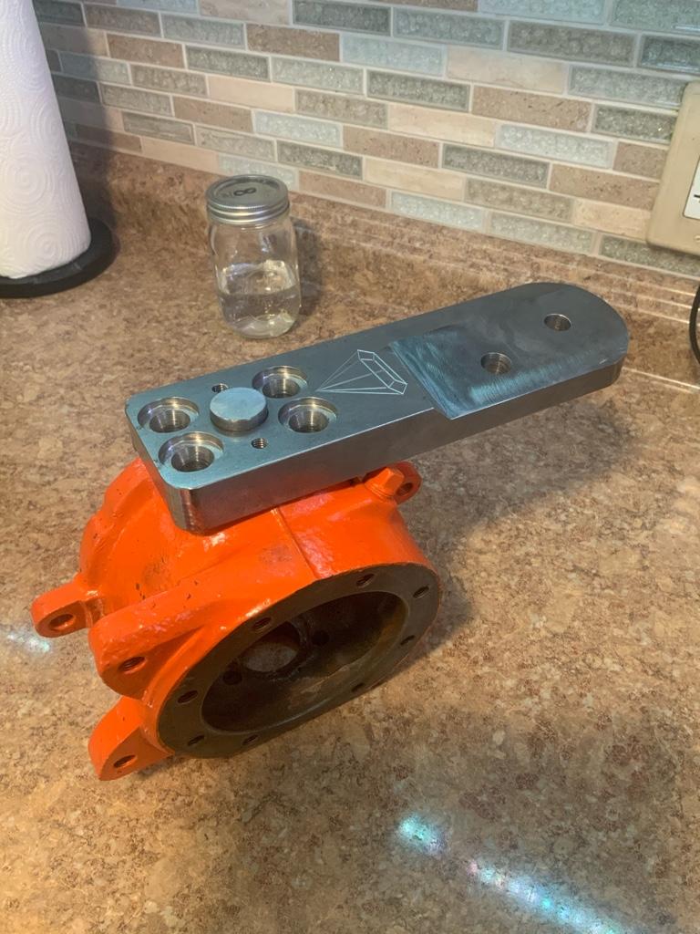

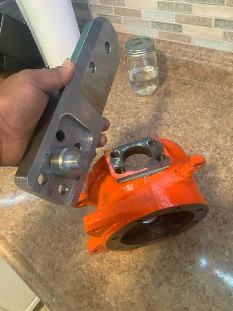

Lookin good dude! Those steering arms are beefage

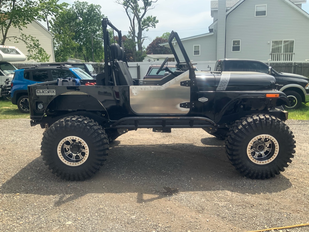

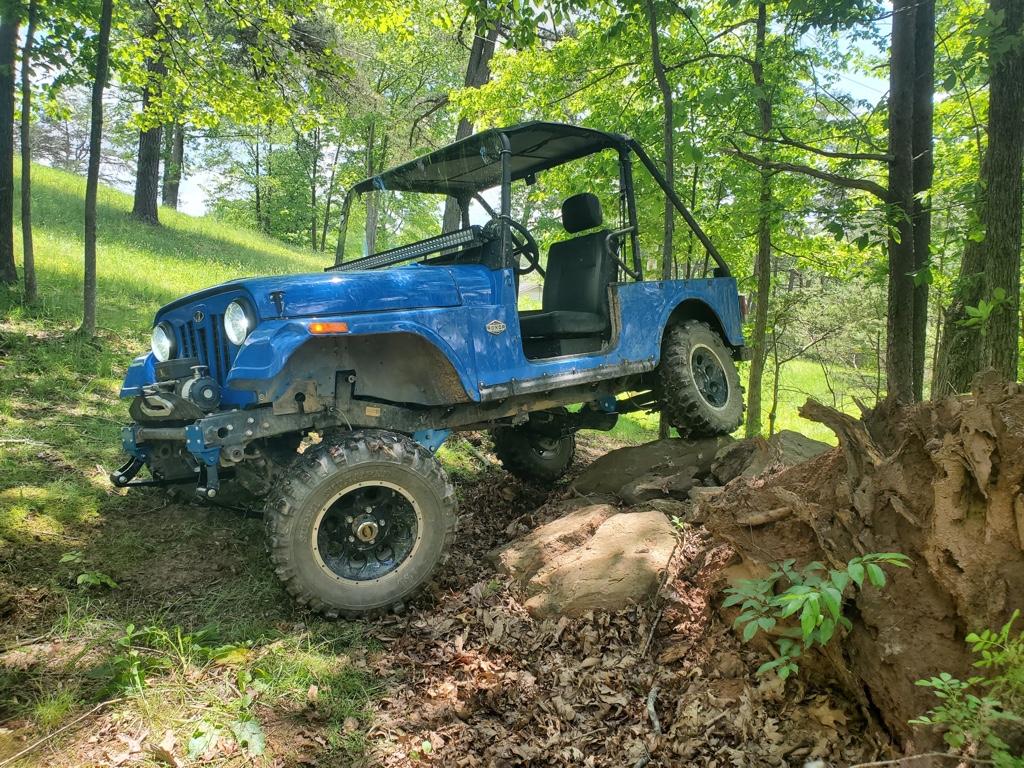

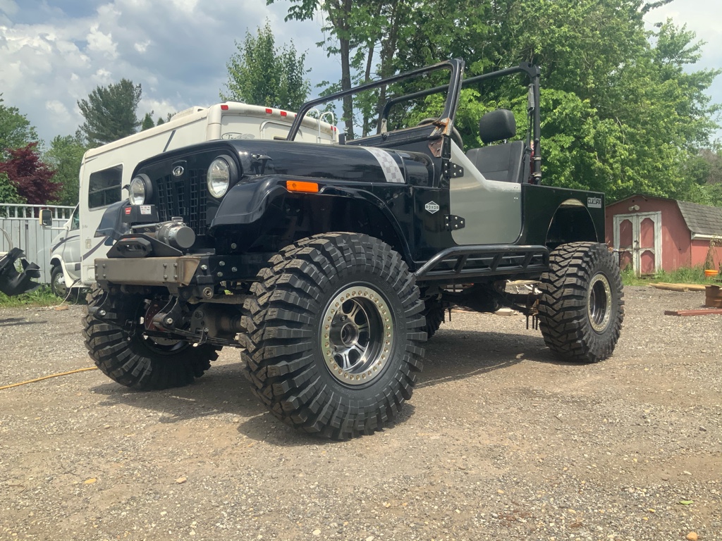

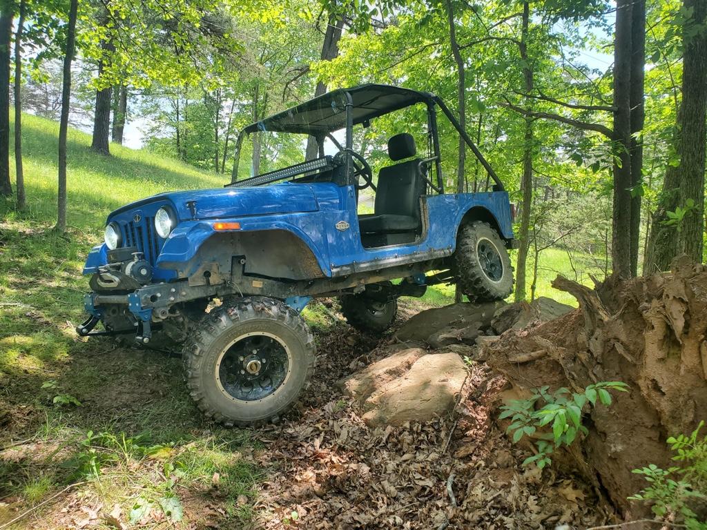

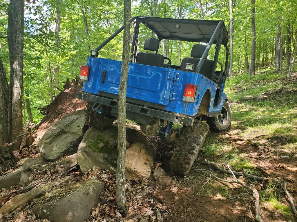

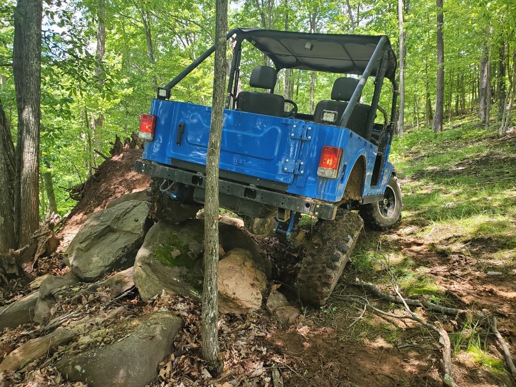

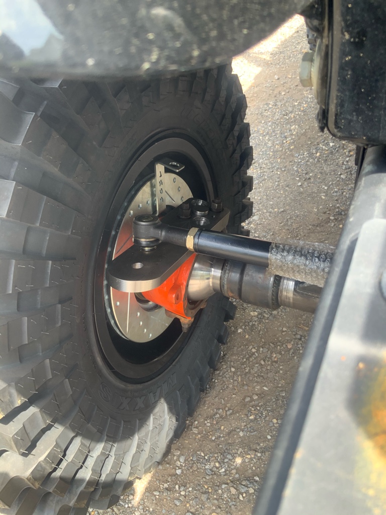

I was able to print out all the parts for the yj kit and send them to a friend for him to give me some feedback. He said it went together pretty easy and we figured out the right shocks to use.
Hoping to get some good feedback since I won’t be able to test it with the stock axles and shock mounts.
He used 2.5 lift yj springs and plans to run 35s. These pics are with 31s. He is still waiting on a front driveshaft before he can really see what it can do.

I was able to print out all the parts for the yj kit and send them to a friend for him to give me come feedback. He said it went together pretty easy and we figured out the right shocks to use.

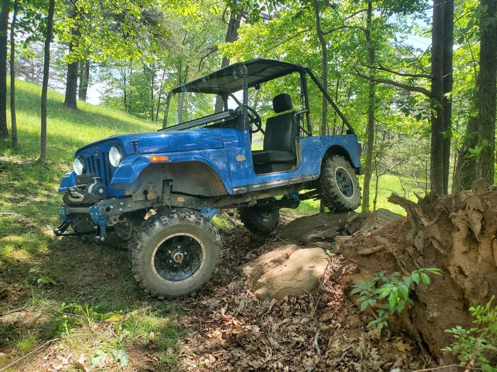

Nice same color and wheels as mine. I wonder if he took before and after measurements? But my MAIN question is how's the ride quaility after?

I know He gained 4.5 inches of lift with the 2.5 inch springs. No ride quality feed back yet until he gets the shocks in. It should ride great though.

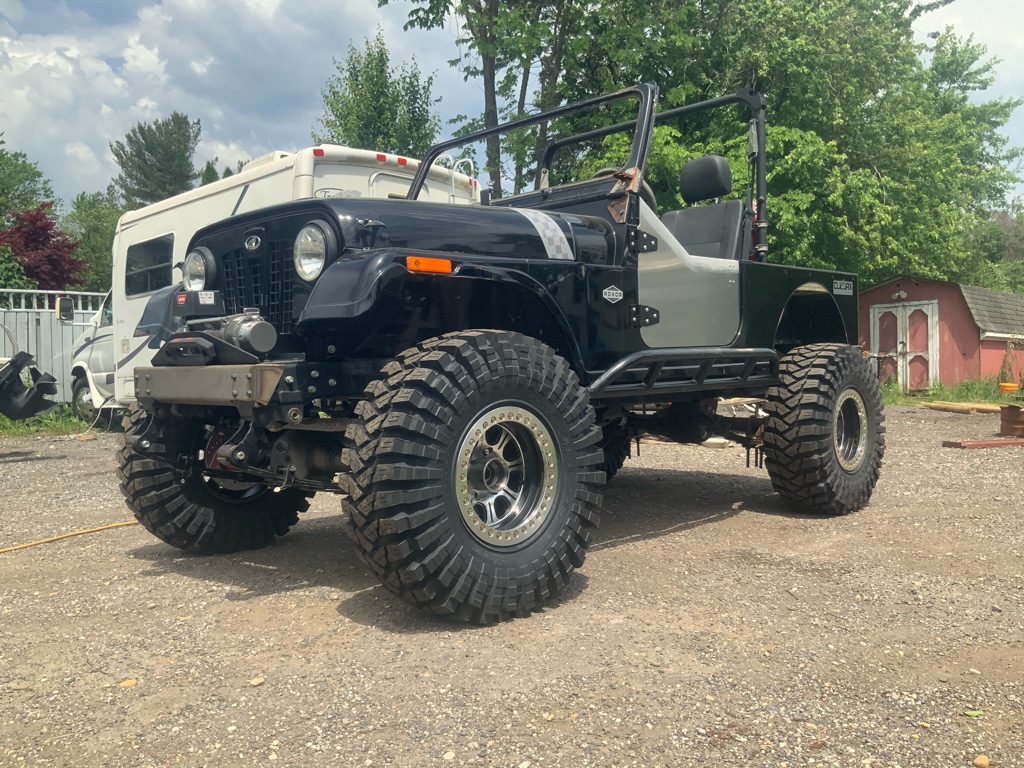

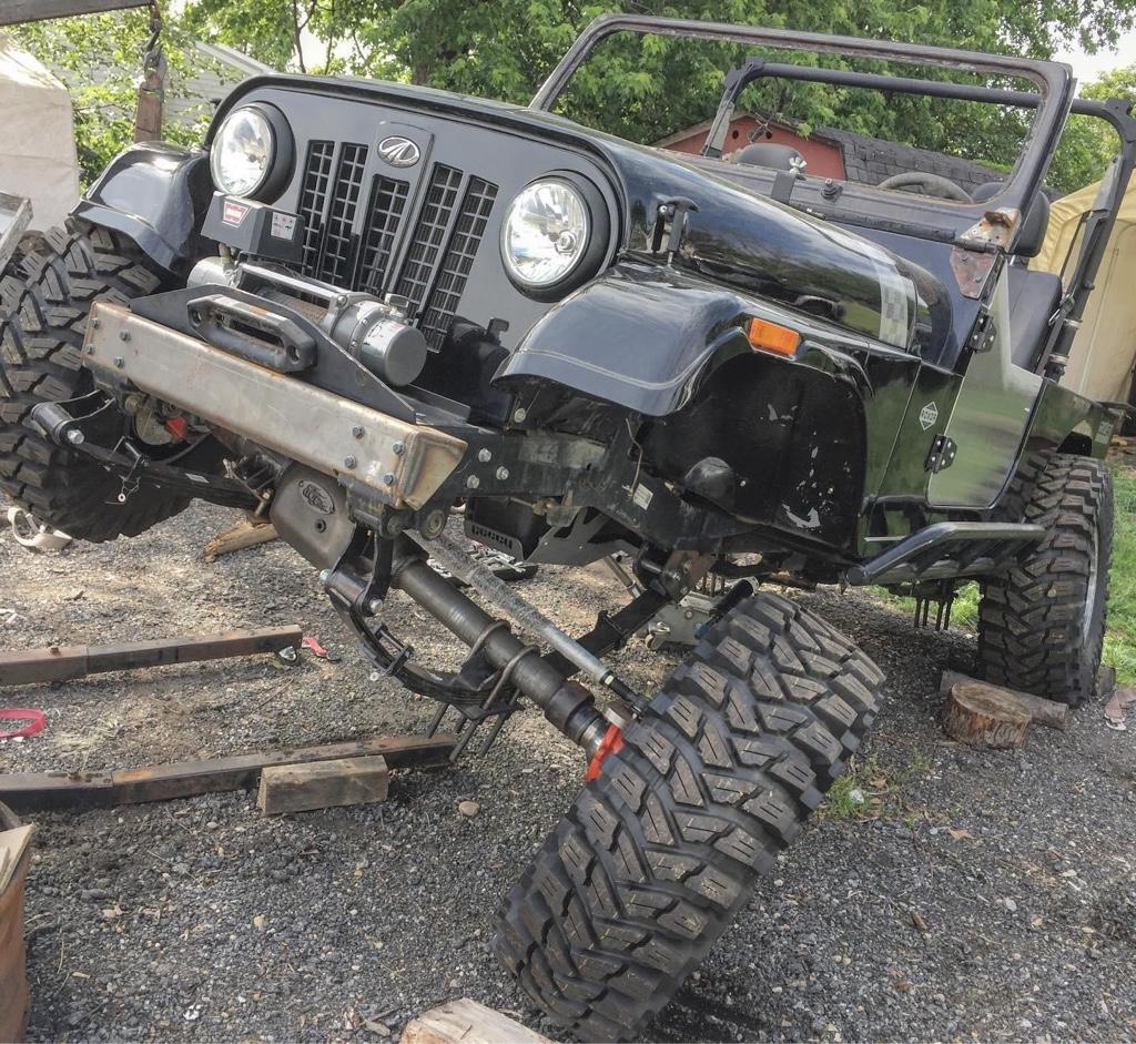

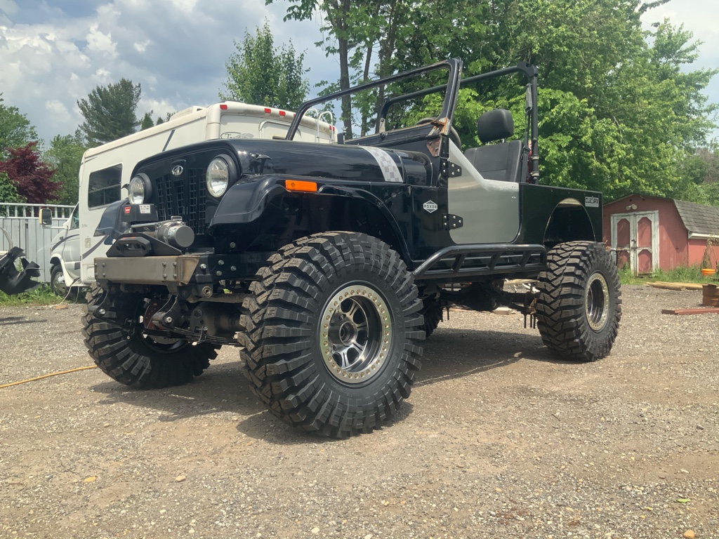

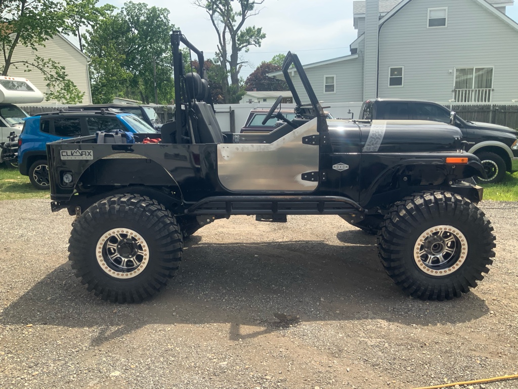

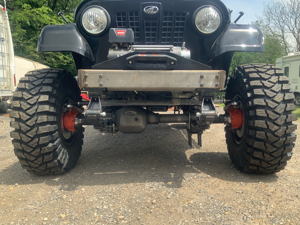

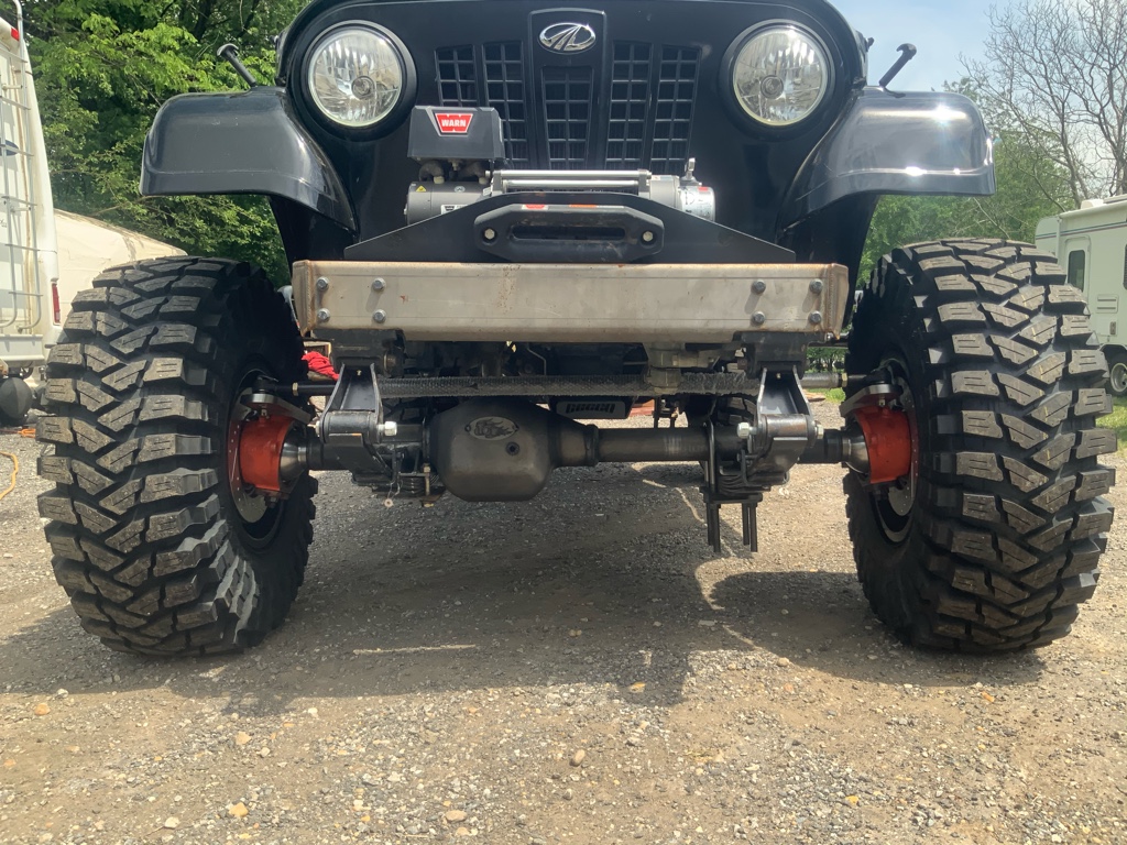

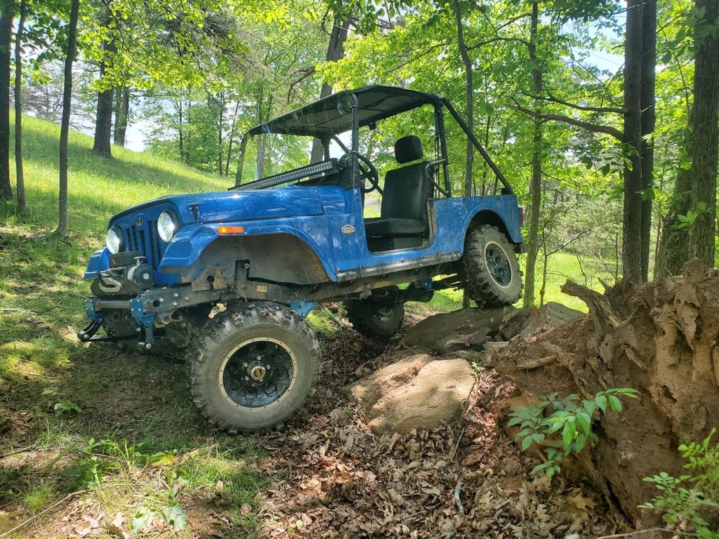

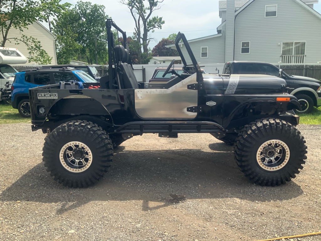

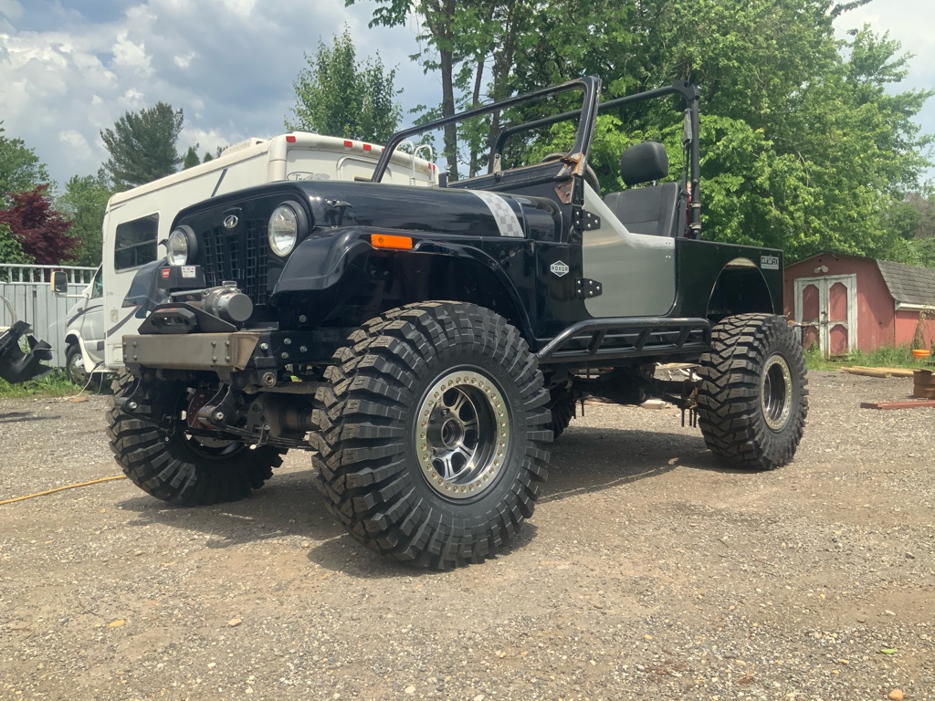

Since [mention]Spanky [/mention] called me out for being lazy I got up early this morning and started a mock up assembly. Got it sitting on all 4s now! Steering seems to clear fine. And there appears to be plenty of room for sock clearance. I’m stoked!

LMFAO!!!!! NEVER crossed my mind that you were lazy! But we did get some updated pics of that BEAST! So whatever works.... You have a gift and an excellent skill set!

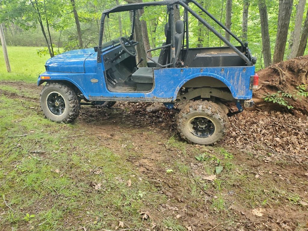

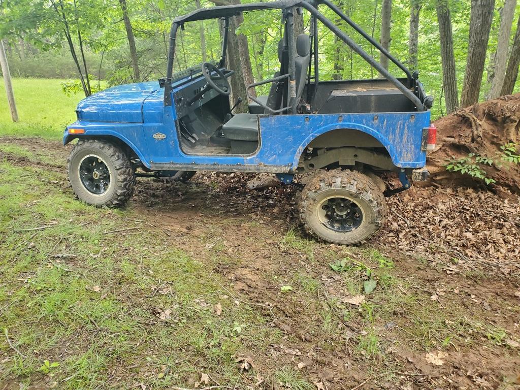

After installing the CJ7 windshield frame, I cut down my roll bar by 4" I believe. Still gotta get the rest of the roll over protection finished. I had to get back to Iowa for a project then the beer flu struck, I've been here since March 9th! But at least I have a job, so I'm thankful for that....
Haha just playing with you man, but I appreciate the motivation, I needed it. It been sitting on jack stands for too long.

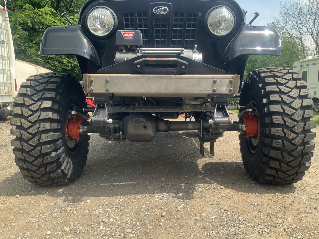

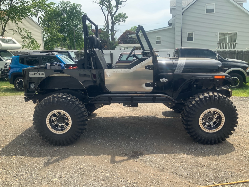

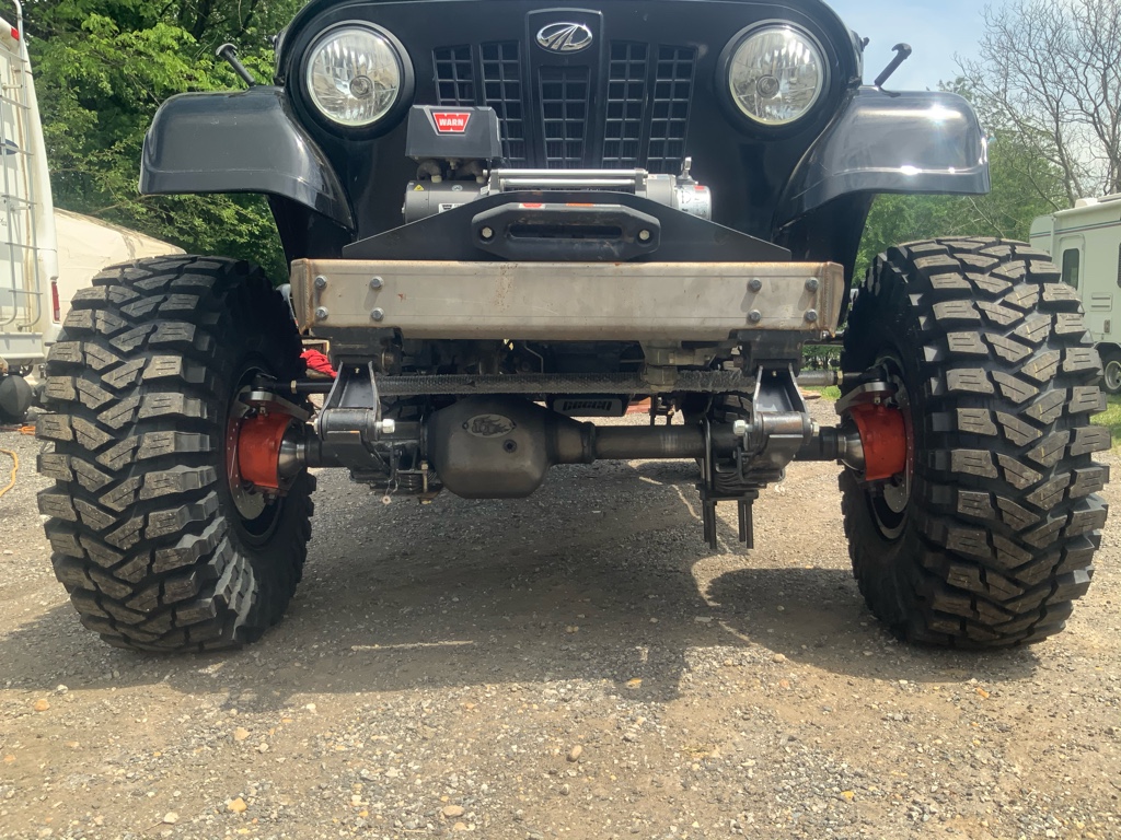

Build specs so far-
Axles: Trail-Gear rock assault axle housings. 61.75 in wide.
Gears: Yukon 5.29 / Timken bearings
Lockers Toyota FJ80 selectable electric
Axle Shafts: RCV
Hubs: Trail-Gear studless
Steering: Front Range Offroad custom machined arms
Springs: Rubicon Express 4 inch lift YJ
Shocks: King smooth body remote res. (F)2.5 12 in travel/(R)2.0 10 in
Bump stops: (F&R) Fox factory race 2.0x2 inch travel
Wheels: Raceline Monster 15x8 3.25bs
Tires: 35x12.5r15 Maxxis Trepador Bias ply
ECU tune: Diesel Freak Custom tune with lower idle and 120hp
Rear Bumpers: Cecco Racing tube
Front bumper: Cecco Racing stubby
Doors: ON THE ROX heavy duty
Skid Plates: Cecco Racing engine skid
Front Fenders: ON THE ROX diy tube kit
Rear fenders: ON THE ROX diy armor and fender kit
Clutch: Diesel Freak
Intake: Diesel Freak connection kit
Still need:
Have custom length drive shafts made
Seats/harnesses
Cage
Safety requirements
Communication
Fuel cell
Exhaust
Lights
Transfer case cross member.
Spare Tire holder
Rear Firewall

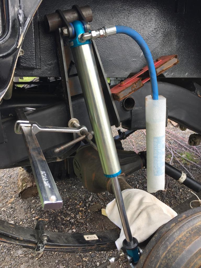

Having a hard time coming up with a shock tower solution for this thing. There is very little room between the frame and the tire at full flex and these shocks are huge. Part of the rules say that I can not modify the inner fenders nor cut holes in the body for the shocks to pass through. This means that they must be outboarded to get the kind of travel I want/need.
There is the first attempt in the rear that did not work. I think I’m going to have to mount the shocks in front of the axle to have the room I need and still have frame available to weld the air bump cans to.
