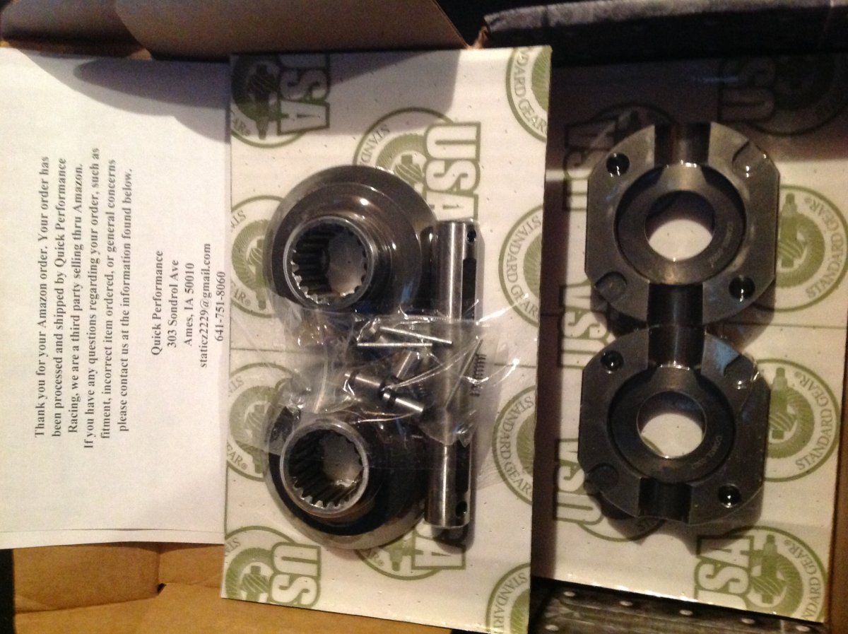

Spartan SL D44-19, from Quick Performance Racing, Ames, Iowa, thru Amazon, for $237. Just a couple weeks ago. I think I read somewhere else on this forum that prices had gone up a lot. Found this one at old prices though. I think.
Amazon.com: Spartan Locker for Dana 44 differential with 19 spline axles, includes heavy-duty cross pin shaft: Automotive.
Haven't installed yet. But looks good in the box.
Thinking about having teenage sons install it while i sit in lawn chair, drink beer, watching.
Thoughts?

Must have video...
