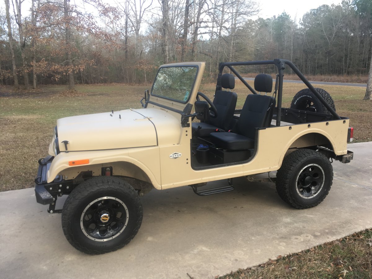

So smart! How does it handle? Did the shackle bolts need swapping? What did you have to do other than swapping the plates?
Jeepish
Jan 6, 2019
224
Wilmer, AL, USA
2936
Bolts, nuts and washers are the same front and back. Rides the same as far as I can tell. Might have changed the pinion angle a little but should be very minimal at 1/2”. All I did was jack up the rear until the bolts slid out easily, put jack stands under it, then jacked up the front and swapped them out. Took 15 minutes tops.

Jeepish, what size tires are you running on your beautiful rig??? How does it ride now vs. stock? Thanks
Jeepish
Jan 6, 2019
224
Wilmer, AL, USA
2936
The tires in this pic are stock. I have on order some pirelli scorpion mud tires in 235 85 r16 to mount on the stock rims. In inches that’s 31.7”x 9.3”. Same width as stock but 3” taller roughly. I plan on posting pictures in mud tire option thread next week when I get them put on.
As far as the ride, the rig is basically stock except for an add leaf in the front along with swapping the front and rear shackles. It rides a little stiffer with the add leaf but not that noticeable really. In total the front is lifted about 2 1/2”.

Are you still using wheel spacers with this revised setup?
I have 1 1/2” wheel spacers yes. Thinking of going to a 2” wheel spacers but I’m going to wait to see what happens when I get the new tires put on. Right now the wheels are still inside of the outside edge of the fender flares by about a half inch. Tires will be here Monday.
