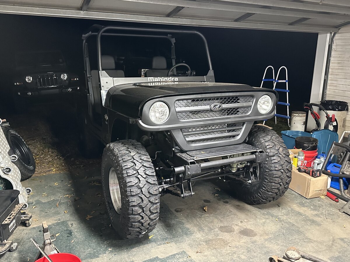

As Ive posted in other threads, I just bought one of the 2023 HDs to tinker with. I started working on the lift yesterday and decided I should start a new thread to document what I am finding so that others can benefit.
Initial Parts Purchase:
Rough Country Roxor 2" Lift (Used to be 2-1/2" (Not sure what the difference is since the components measure the same as on my 2019)
1-1/2" Wheel Spacers
Max A Front and Rear Lift Shackles
Measurements:
OEM Spring Shackles- 3.375" bolt hole center-to-center (My 2019 are 3")
RC Lift- Spring Bracket- 2" center of original spring mount to new location. Lift Shackles- 5" bolt hole center-to-center.
Max A Lift Shackles- Front 5.5" bolt hole center-to-center. Rear 5" bolt hole center-to-center.
Based on all of this, I would have gained just over 2" in the front and just under 1" in the rear using the RC front spring bracket and Max A shackles front and rear. This is a little less than I wanted, but I was ok with it. All went well with installing the RC spring bracket, other than being a pure pain in the butt to drill the holes. Then I started to install the shackles; no good! Mahindra has changed the spring bolt size on the 2023s. My 2019 has what appears to be 18mm bolts and the new ones are 14mm. I tried searching all over town to find some bushings I could make work but no luck and it seems like a bit of a sketchy solution anyway.
After sleeping on it overnight, I had my friend do some measuring of the shackles on his YJ and read some posts from 2018-2019 on the forum about using CJ/YJ spring shackles. I think I can make this work since the bolts are 1/2". I ordered a set of 1-1/2" front and rear CJ/YJ lift shackles and a couple of 14mm drill bits.
Based on my calculations, keeping the RC front spring bracket, the CJ/YJ shackles will give me 2.8" in the front and 1.8" in the rear. I will have to do some measuring after I get them installed to figure out the degree shims I need to correct pinion angles.
More to come......

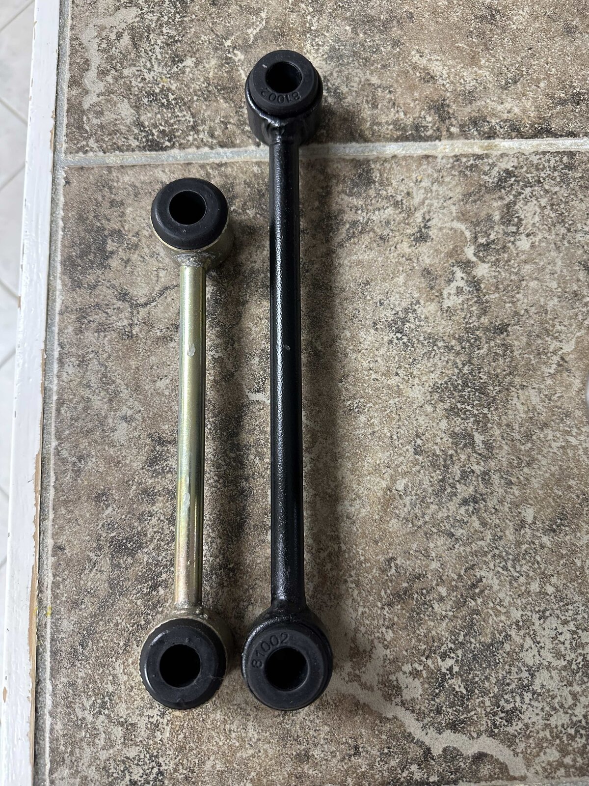

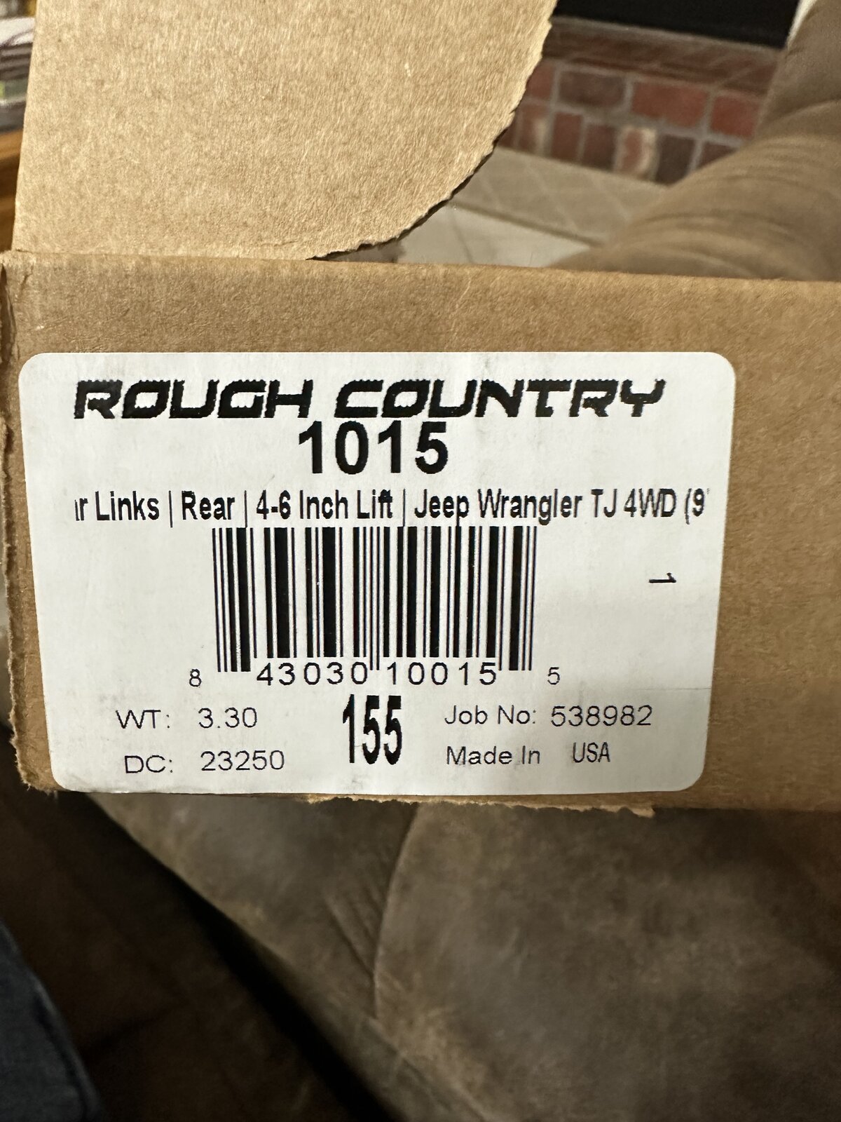

Things are going slow as I wait for parts to arrive, but I do have one small victory to report today. The OEM sway bar links were obviously going to be way to short so I researched as best I could for some that would be a good replacement. I found that ones for the rear of a TJ with 4-6" lift appeared to meet my needs. I installed them this evening and they fit great. They are 2.5" longer than stock so they should match up with my lift plan.
The ones I got are Rough Country #1015. See picture of label.
OEM links are 7.5" eye center to eye center. RC ones are 10" eye center to eye center.

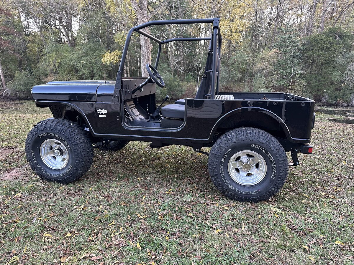

Made some progress today. I tried taking the spacers off but there isn't enough clearance; tire hits the leaf spring. I could probably go with 1" instead of the 1-1/2" ones I have, but no point in buying another set and I'm not sure if the wheel studs would have to be trimmed, which I don't want to do.
I installed KYB 343-403 shocks in the front and have a pair of 344-090 to put on the back. I ended up with 26-1/2" from the floor to the body in front of the rear tire and 26" to the body behind the front tire.
