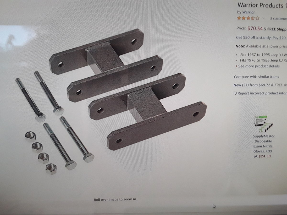

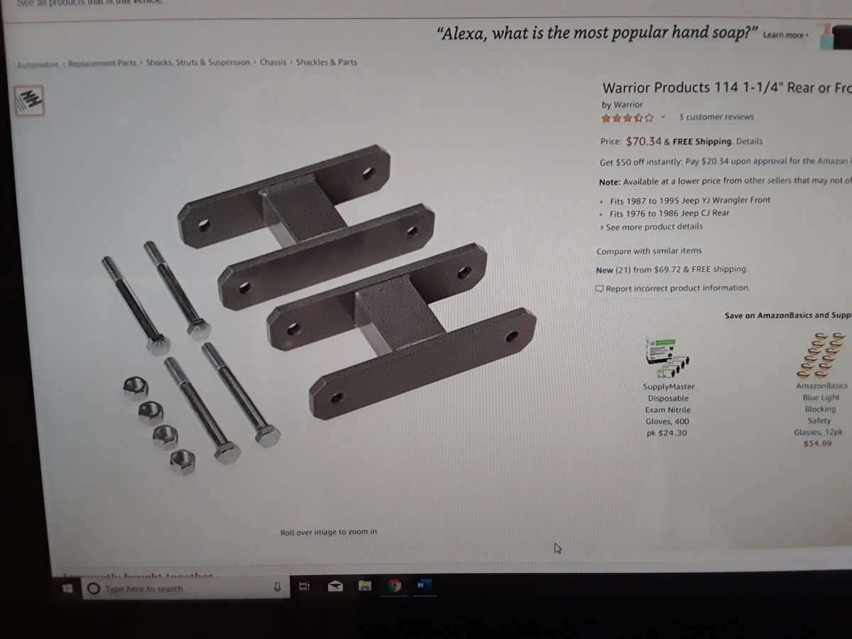

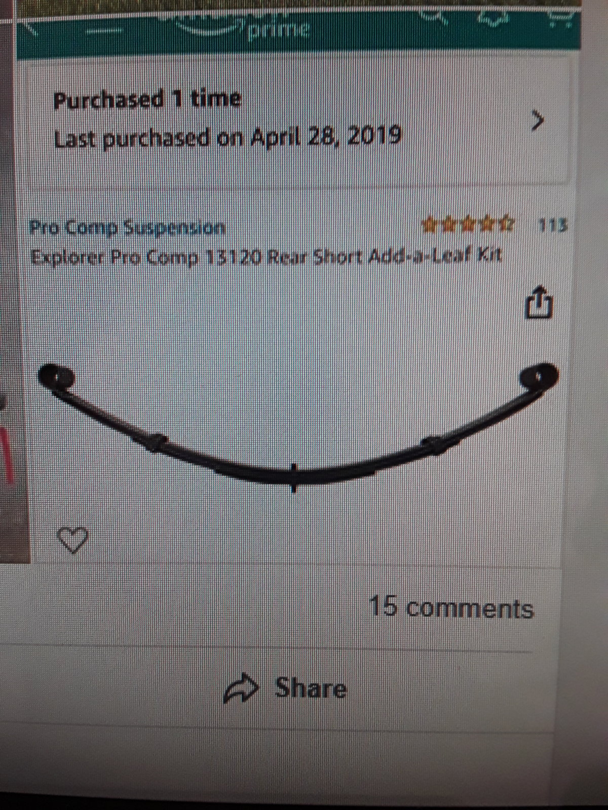

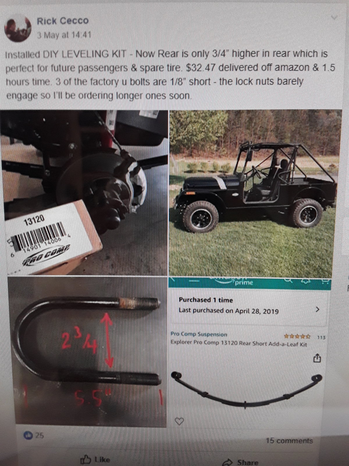

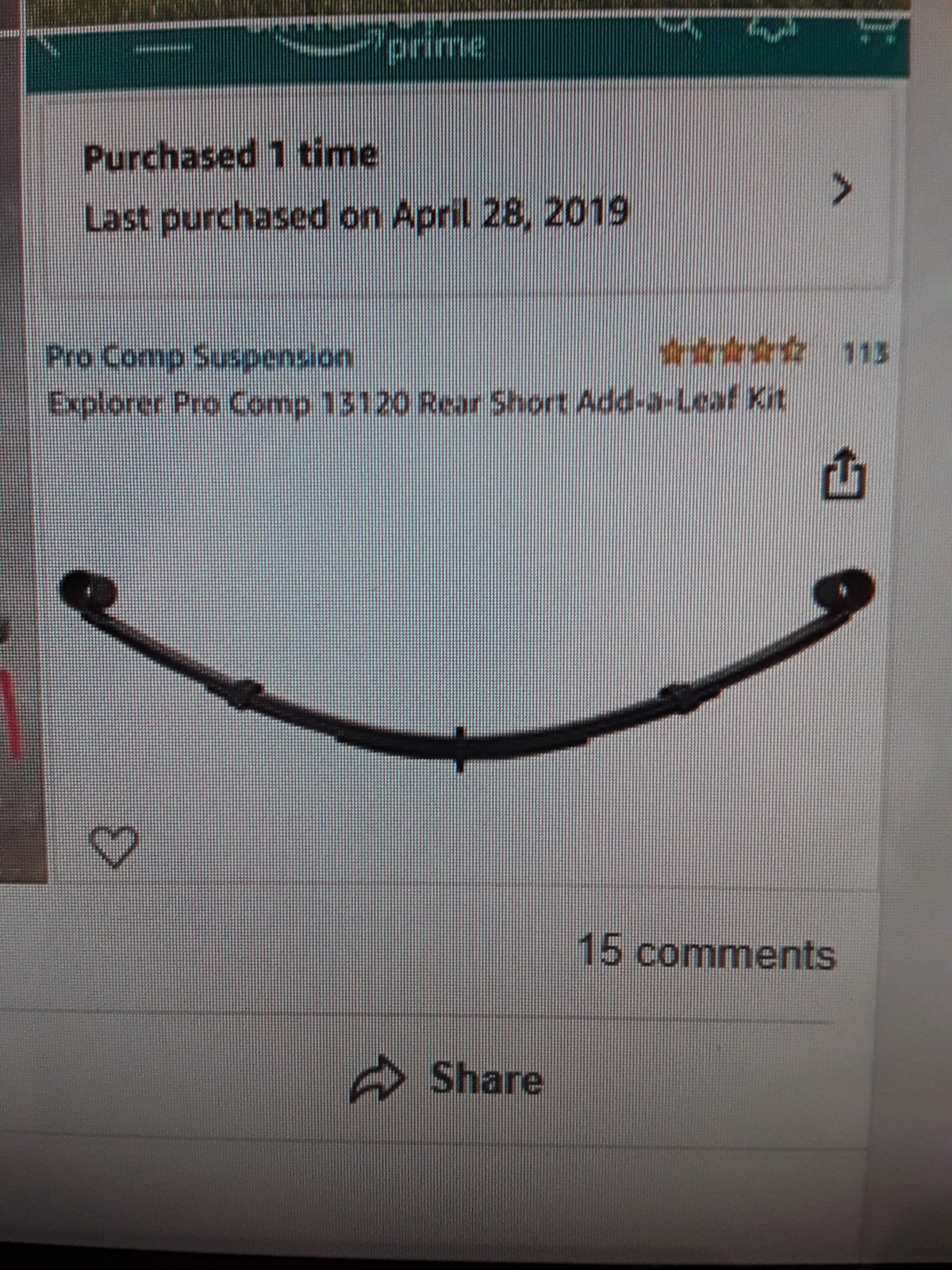

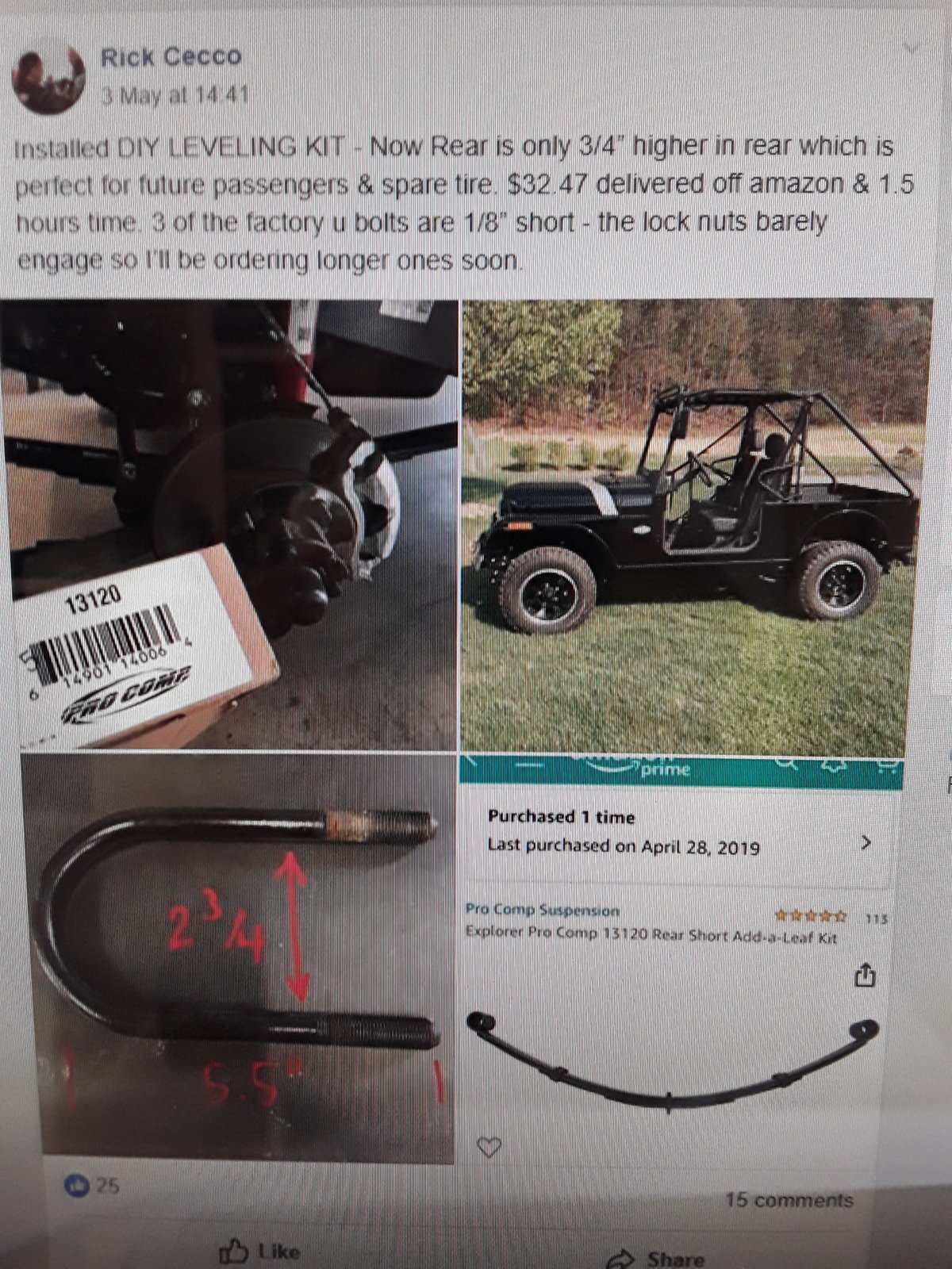

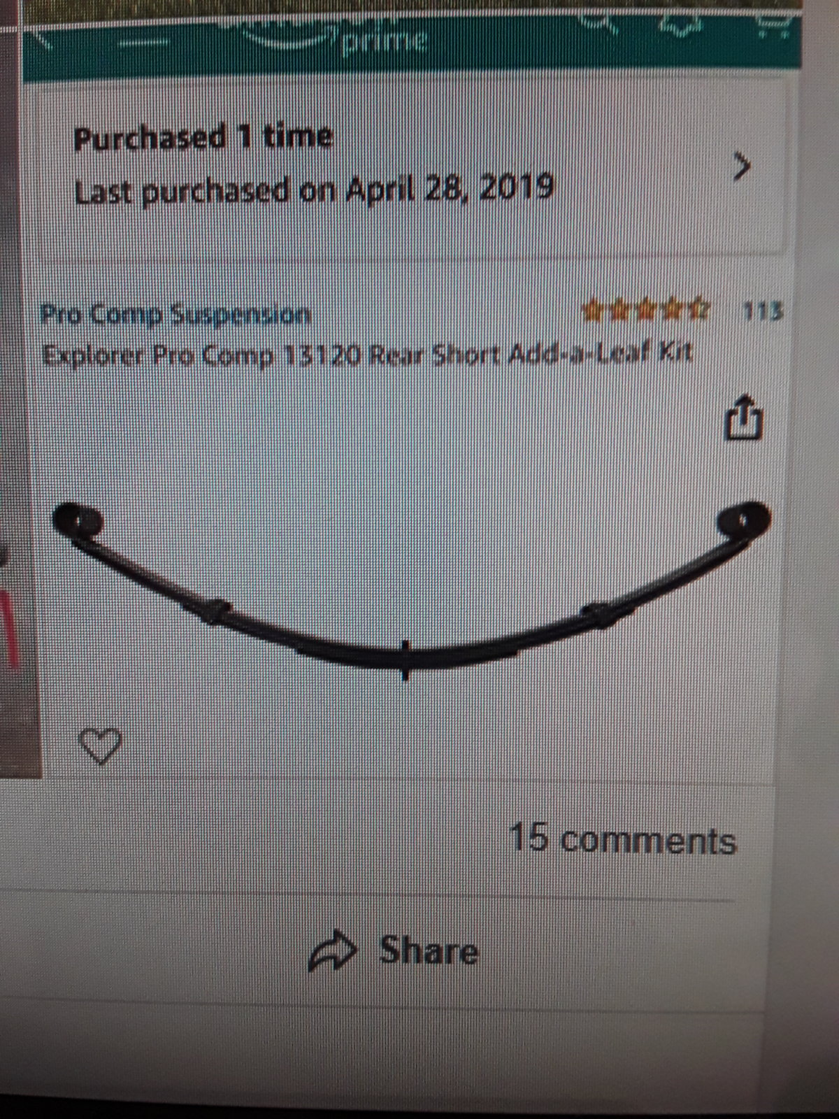

Surfing Roxor owners on Facebook and saw this guy found the right size leaf spring for the front

I found these U Tuff Country U-Bolts 47861 on eBay that may be the best fit for the newly added leaf springs. Also, I will probably switch the front and back shackles to get a more level stance and previously mentioned by Jeepish on previous post.
