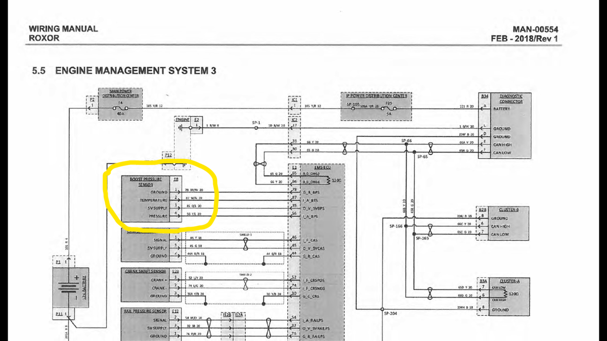

after my tune. the heater turns on even in a 85 day with a warm motor. he said probably a bad sensor. where is that? worked fine before.
771
The Roxor doesn't have an ambient air temperature sensor. It has a Coolant temperature sensor and fuel temperature/Water in fuel sensor. It's going to be one of those. I couldn't tell you which one it is going to reference. I'd guess it would use the coolant temperature sensor.
Which tuner did you use?

The roxor uses a temp sensor/pressure sensor in the intake tube from the turbo to the intake.
After my tune. Diesel freaks mine comes on in all temps. It’s part of the new tune. Just start it up in hot weather don’t wait. It’s fine
